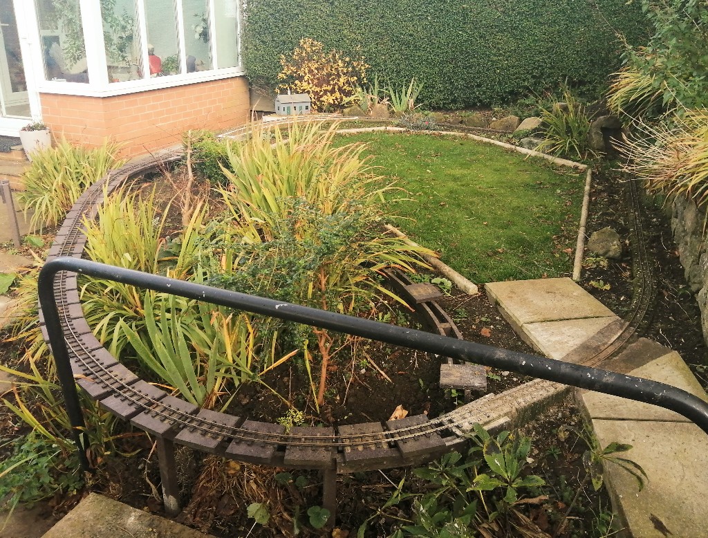

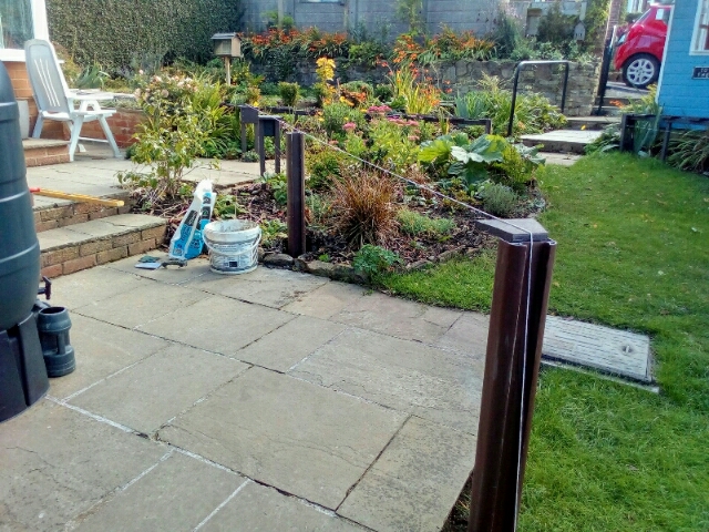

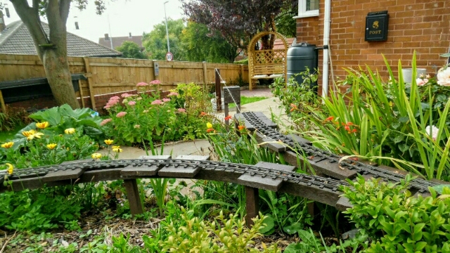

Down in the jungle, something stirred!...... Yes, tis I, back from yet another prolonged break but determined to battle on with Hollycross and get at least the top circuit running asap. So....anyone who remembers my previous antics will know, Lord Hollycross, Albert, balls of string etc all play a part in my Modus Operandi and its been no different these past few days, but as ever, a picture paints 1000 words so.... First off, we need to plot where we're going, cue stringline, half a brick to pull it tight, and an eyeball.... then hole, post, spirit level, Postmix, water. Done!
You'll notice that I'm getting involved with plastic fence posts this time, the lines a bit higher up here so I want a bit of stability. The posts are easy to cut to length with an ordinary wood saw and rapid progress followed.
This view looks the other way and also shows the garden drops away, hence the height difference, and also shows the branch junction. Ive 'borrowed' a few bits of filcris from elsewhere to get a line and set the gradient, more later. Next...

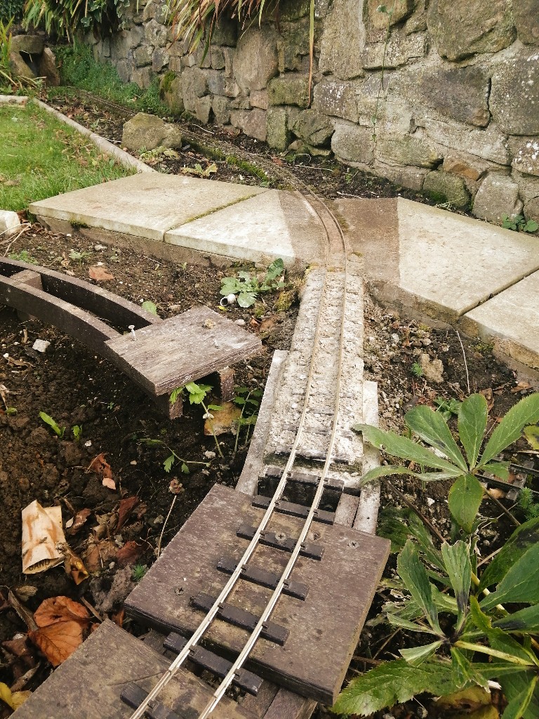

Another post in between, fixed in same as before. Now, this bit is 'interesting'! I've pondered many methods for bridging this gap across the corner of the path, including paving block piers, aluminium bridge deck, brick built viaduct etc, THEN, an old friend who's particular trade for 50+ years, has been building, repairing and trading in boats, and on a recent visit he happened to mention that ' he'd enough offcuts to knock up a portable/removable 6' long wooden trestle viaduct' and he'd love the chance to do a bit to help! Hmmm, so thats currently under consideration but it'd make a lovely and very photogenic addition. Anyway, onwards.. The next bit involves turning through almost 180°, on a curve of just about 5' radius, to line up with the main line again at the point it comes through the steaming bay. So, peg, string line, aerosol paint, and Hey Presto! we have a line marked out on the lawn to guide us along. If you get this bit wrong, mow the lawn, have a beer, start afresh!. I didnt, so after another hour or so, this is the state of play. Good innit!? So we're well on the way with posts etc, theres another one to plant on this curve then filcris rails will be clamped to the BOTTOM inside edge for a few days to give them an inbuilt curve prior to fixing at the correct level. This will help to avoid the tendency of the posts being spread out of true, the filcris is really easy to work with, but is quite flexible but this will be to my advantage at this stage. The inside rail will be fixed level with the post tops first, then the outside rail fixed slightly higher to give a degree of cant in case anyone, Albert!!, is in a rush to get finished! I will also be fitting some sort of boundary too on the raised section, only an inch or so, but hopefully it will prevent any disasters if theres a derailment.
If you're still with me, a couple of photos to close with, which show progress to date. Cheers chaps, and chapesses! More soon!

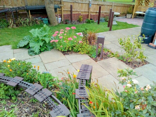

Greetings all!! Back from the wilderness and almost fighting fit but raring to go too!. Had to take a sabbatical from most things Hollycross due to a hiccup with my health, but the last weekend saw some much awaited progress although possibly in a reverse direction at the moment. The railway has had to be somewhat rationalised for now, but I was determined to get Albert et al back to work and see something moving again. Ignore the weeds for now please! the garden in general has taken a back step too, plus it's that time of year but now I'm back into it, it'll start to come right in time. Ok, firstly, the main circuit that was well under way, has halved in size and now runs in a small loop around the top lawn, some at ground level, some on a Filcris frame as previously. It was a case of just needing to get a circuit up and running asap!

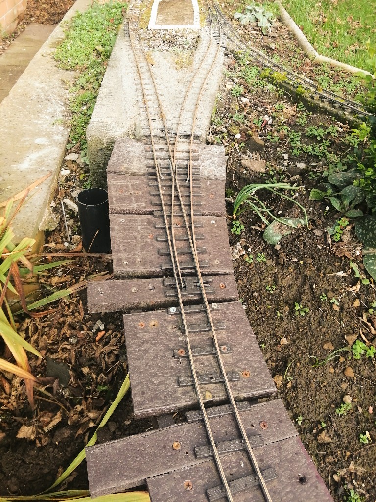

Voila! The planned branch towards the front of the house is 'on hold' for now but certainly not abandoned. Avid readers will recall it left Hollycross Station Junction and began a steady descent for a few feet. This is the current state of play now, the junctions been realigned, relaid and reballasted
Note provision has been made for a point lever and a junction signal! At the other junction, where the main line and the reversing line came together just after crossing the path, this is now plain line but....at a later stage, it won't take much to reinstate a junction to head off down the grade. You'll notice too that the original steaming bay by the tree has also gone.
It's all quite dramatic, but at least it's a little railway again, and things can happen again....

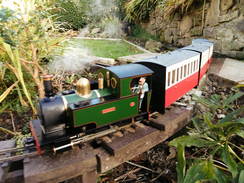

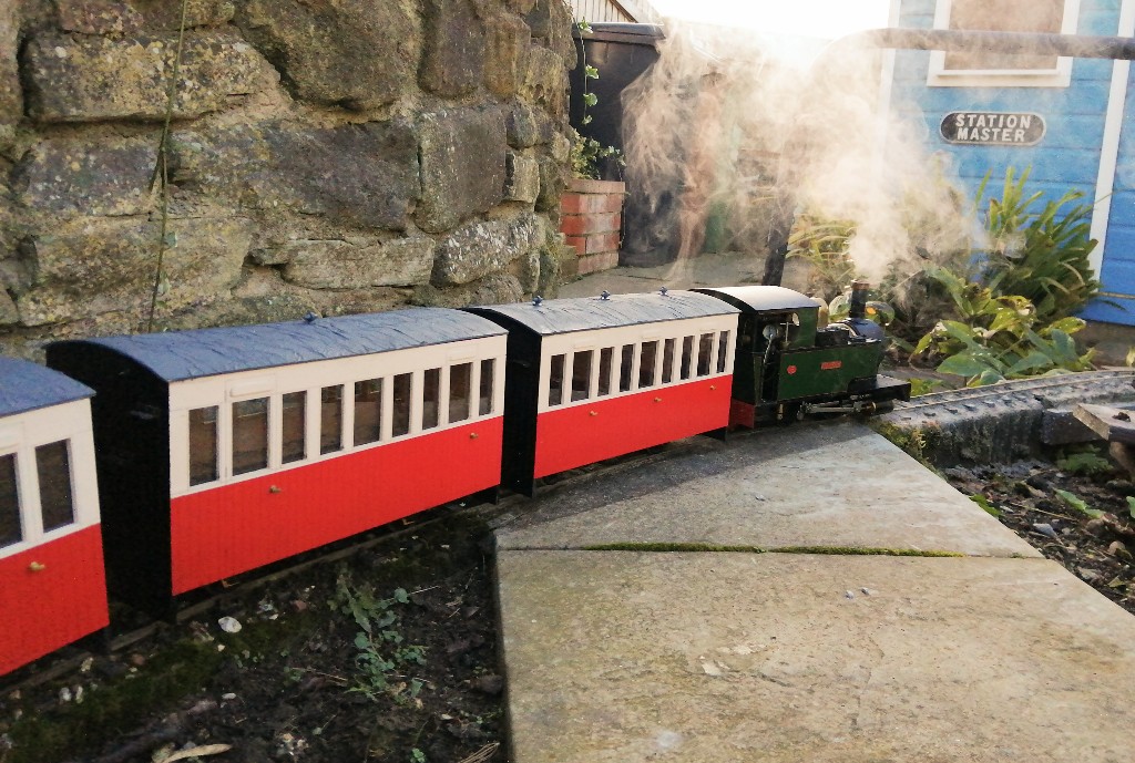

Afternoon peeps! Been a groggy old day hereabouts but I wanted to do a bit more tweaking to the railway to iron out the last few anomalies on the permanent way, so out came the tools and a few odd bits to use as packing. After an hour's crawling about and eye levelling, it was time to get a loco out, get a head of steam, and do a few test runs. And of course, if you're gonna run a loco, you might as well add a train!.....or 3! Enjoy.

Now that looks like a rewarding afternoon! I particularly liked the mixed goods, and also the "express blue"/blood&custard livery combo on the passenger train, and I was VERY impressed with the good running you achieved with all those skips. Love the R/C whistle too - that's on my wish list to sort out one day!

Thank so much Andrew, it was a nice couple of hours. The various liveries add a bit of 'railway' colour I feel, and the Binnie skips and bolster wagons have all got the Roy Wood (RWM) steel replacement wheelsets fitted. So much better having the bit of added weight and they sound great over track joints and pointwork!
