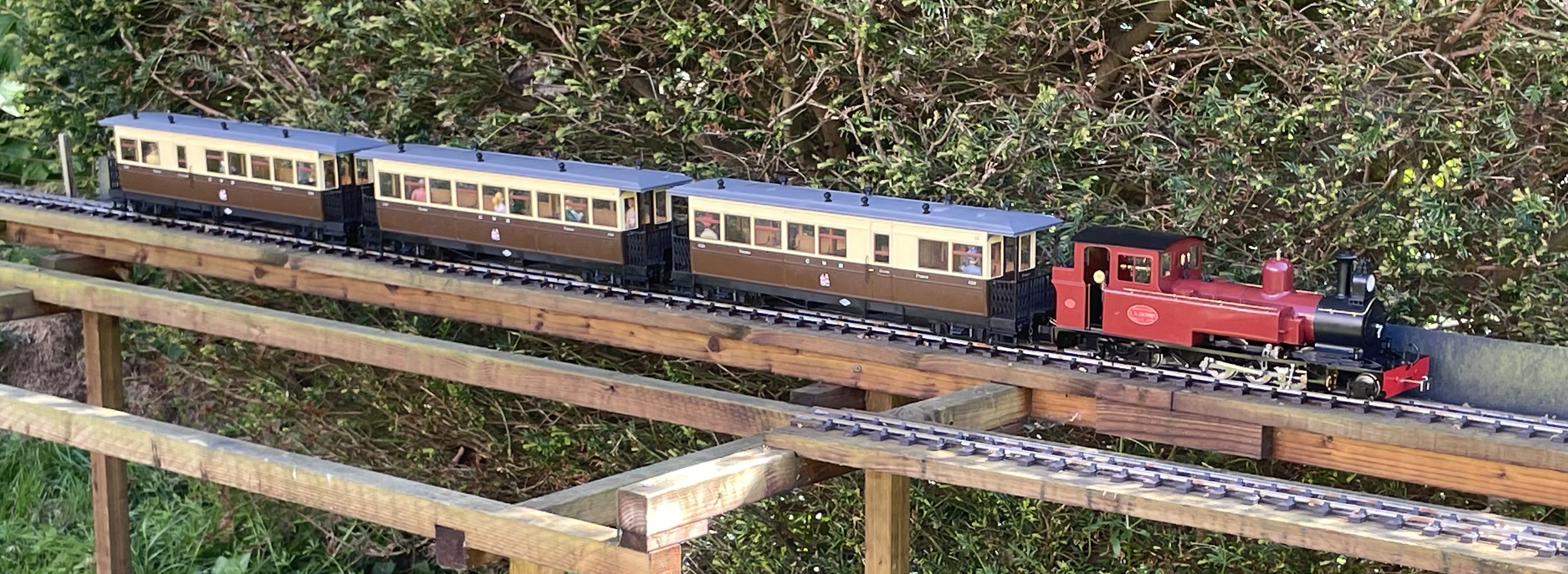

Trevor suggested the two WLLR wagons would look good behind the Pickering coaches. Friends came round for a play this afternoon so such a train was run. Apologies for the variable light conditions.

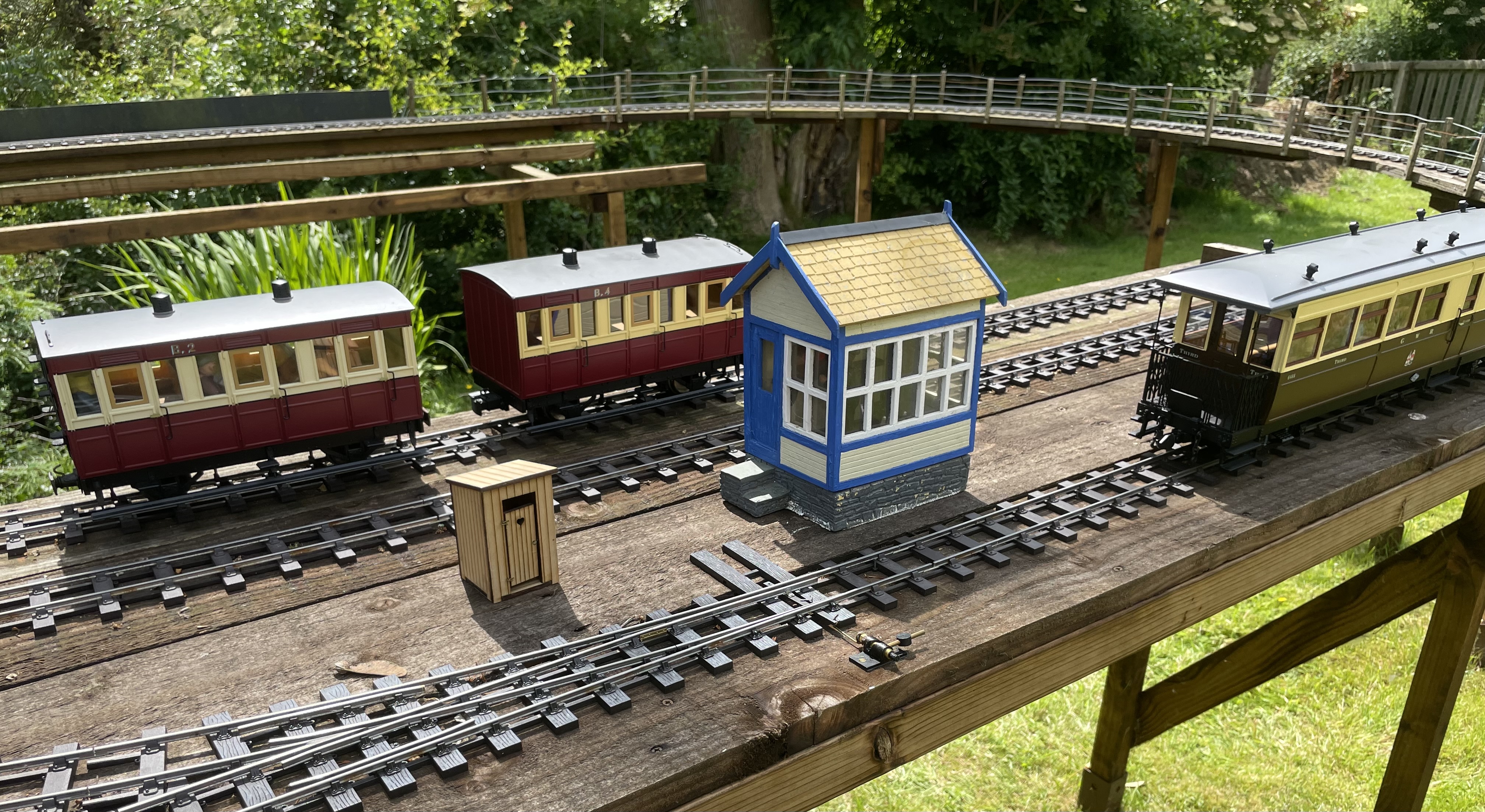

A most enjoyable outing to Llangollen at the weekend for the garden railway show.
Spending was really restrained but I did come home with two additions to the Derwen Fawr station site:-
The coaches were used for clearance testing. I moved the two sidings at this end of the station to create a bit more space for the signal box. The thunder box needs painting.

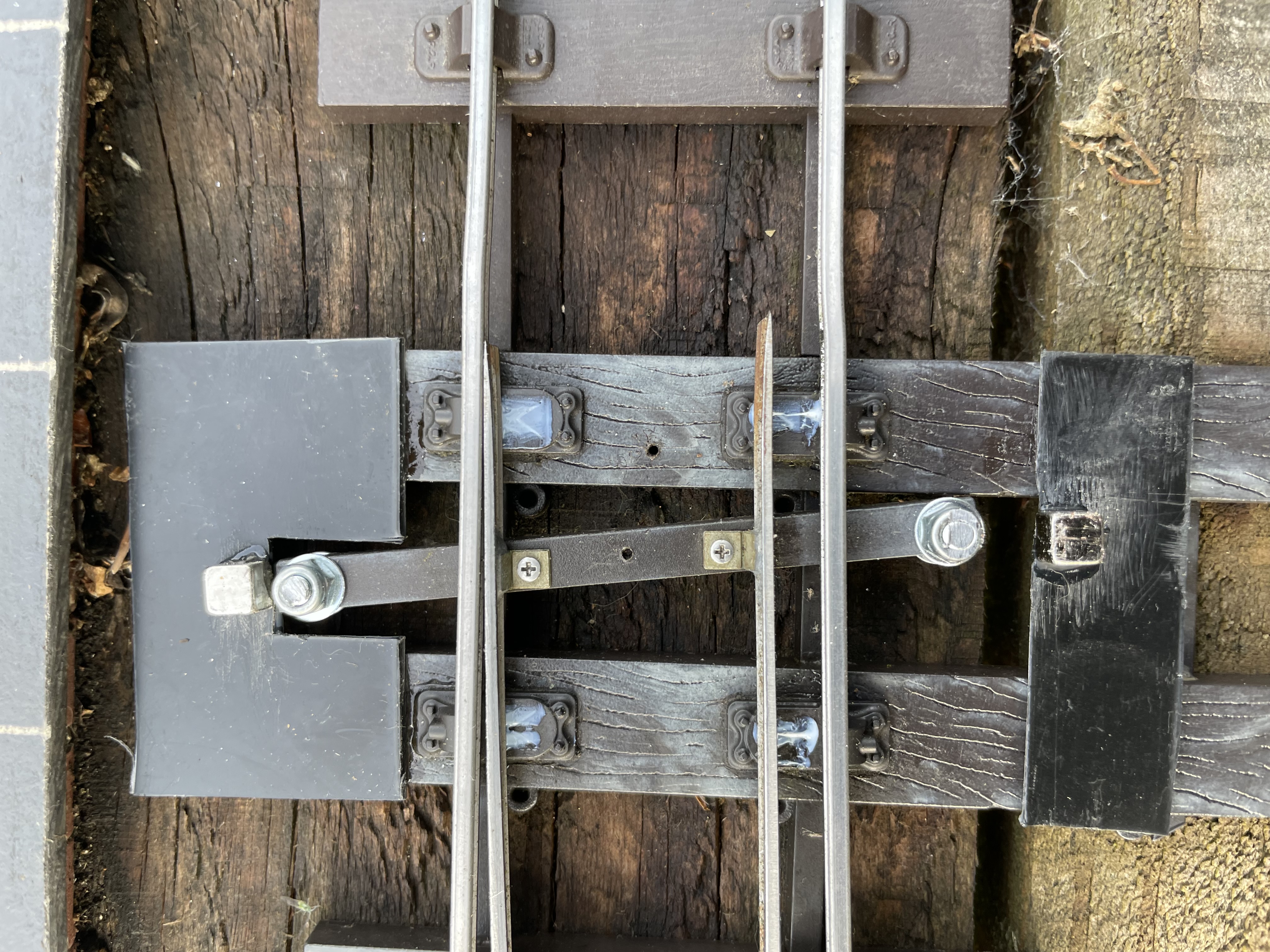

The springing in the Cliff Barker points I have has not been wholly satisfactory with the blades sometimes not being held properly against the running rail such that on Monday my latest steamer derailed completely whilst travelling over one in the station loop.
I have a selection of small magnets and wondered if I could devise a way of using them to effect a different solution to point levers of some sort.
Yesterday I lifted and modified a pair of points.
Here is one:-
on the other I have placed the magnets under the black plasticard where the pull is a bit less as there is less steel in line. The tie bar was drilled to 3mm through the existing holes and an M3 cheesehead bolt put through from underneath with washers either side of the tie bar and a nylok nut to hold all in place.
Time will tell whether these work reliably,
Here is one:-

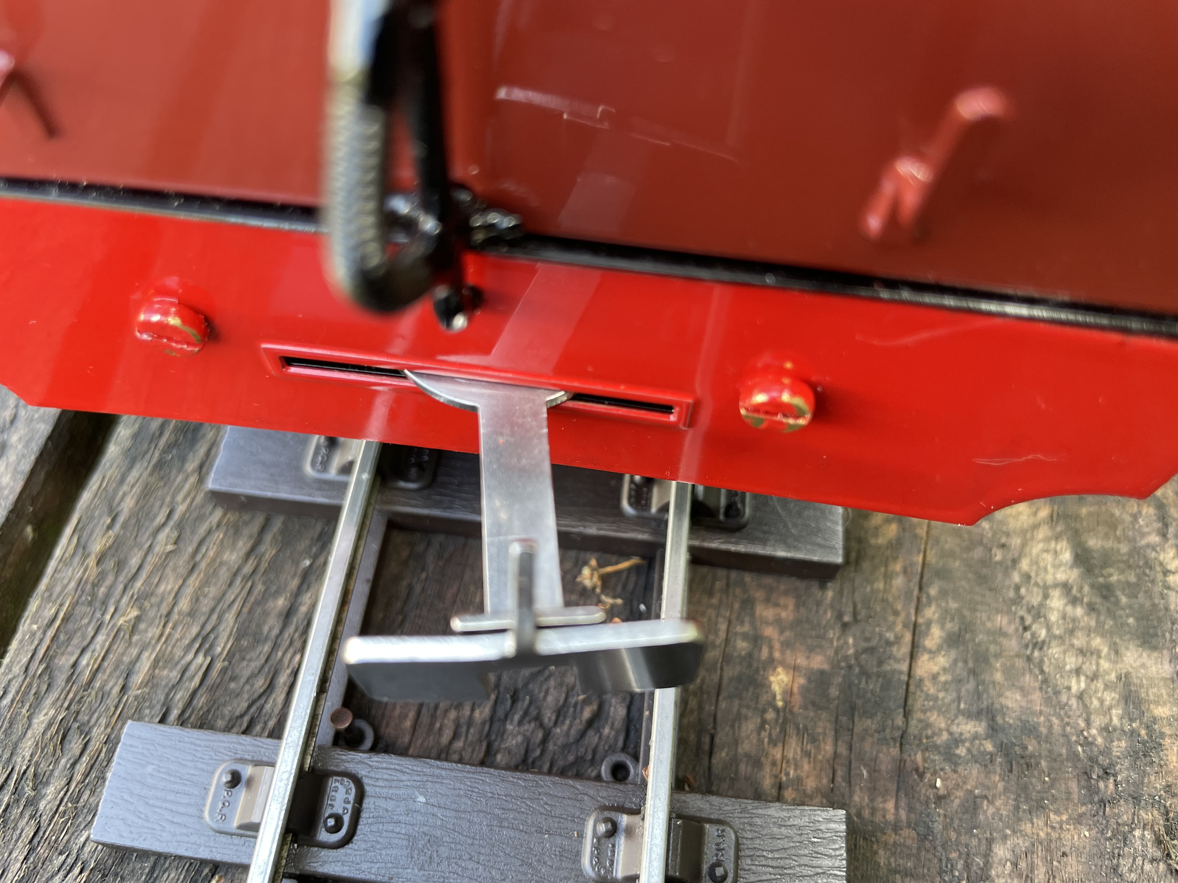

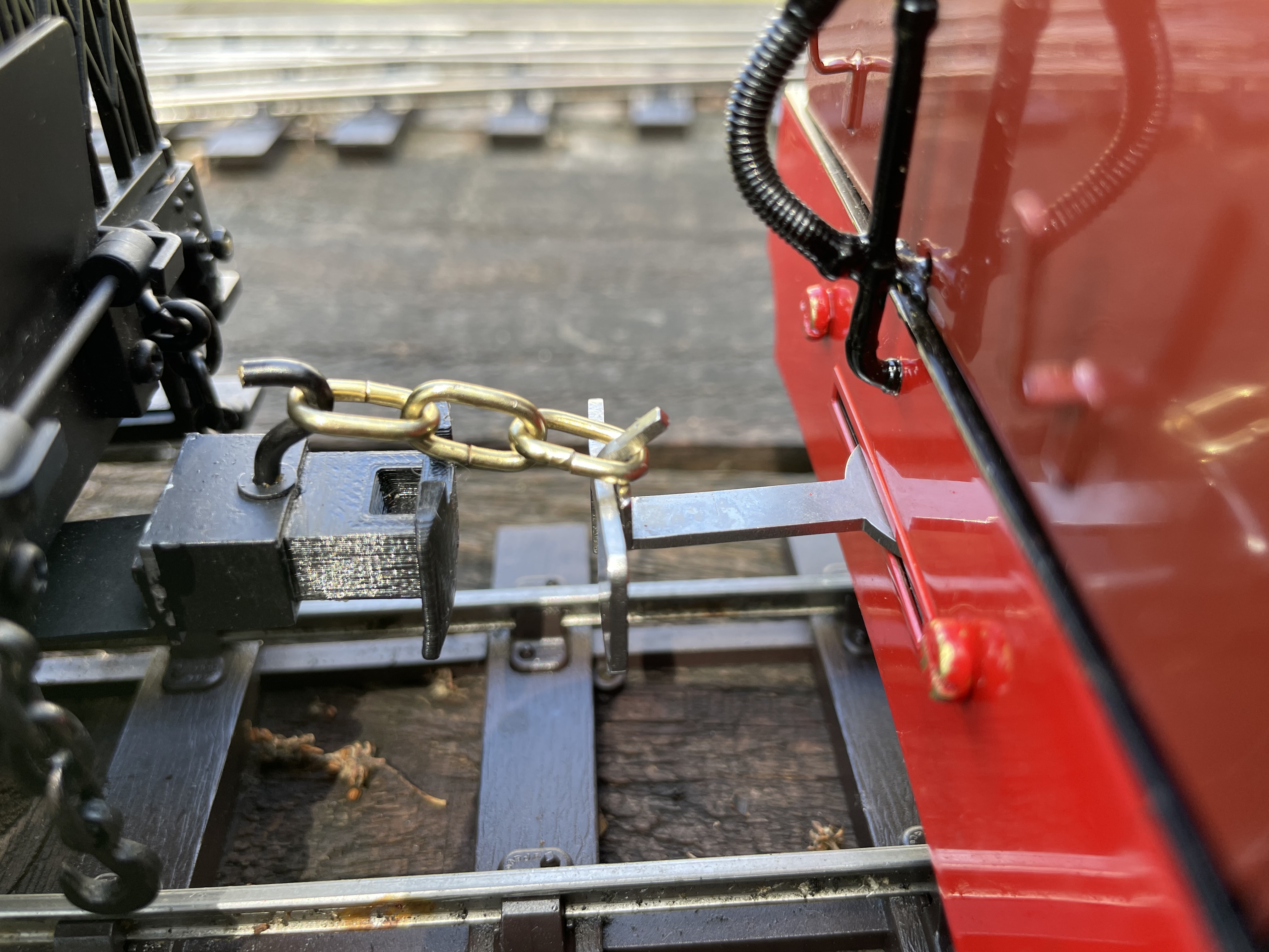

Another use for a small magnet.
The Leek and Manifold buffer, though quite a good representation of that on the prototype is very prone to throwing off a three link coupling.
A solution that seems to work well:-
A magnet glued to the inside face of the buffer
Holds a 'brass' coupling whilst allowing some flexing.

Your use of magnets is interesting. Sorry to hear your point springs are failing. What is it three years since you laid the circuit? I was pondering with using Omega springs, similar setup to the GEM products of yesteryear. I must have miss read your post magnetic brass that's a new one on me.

Neat (almost invisible) solution
