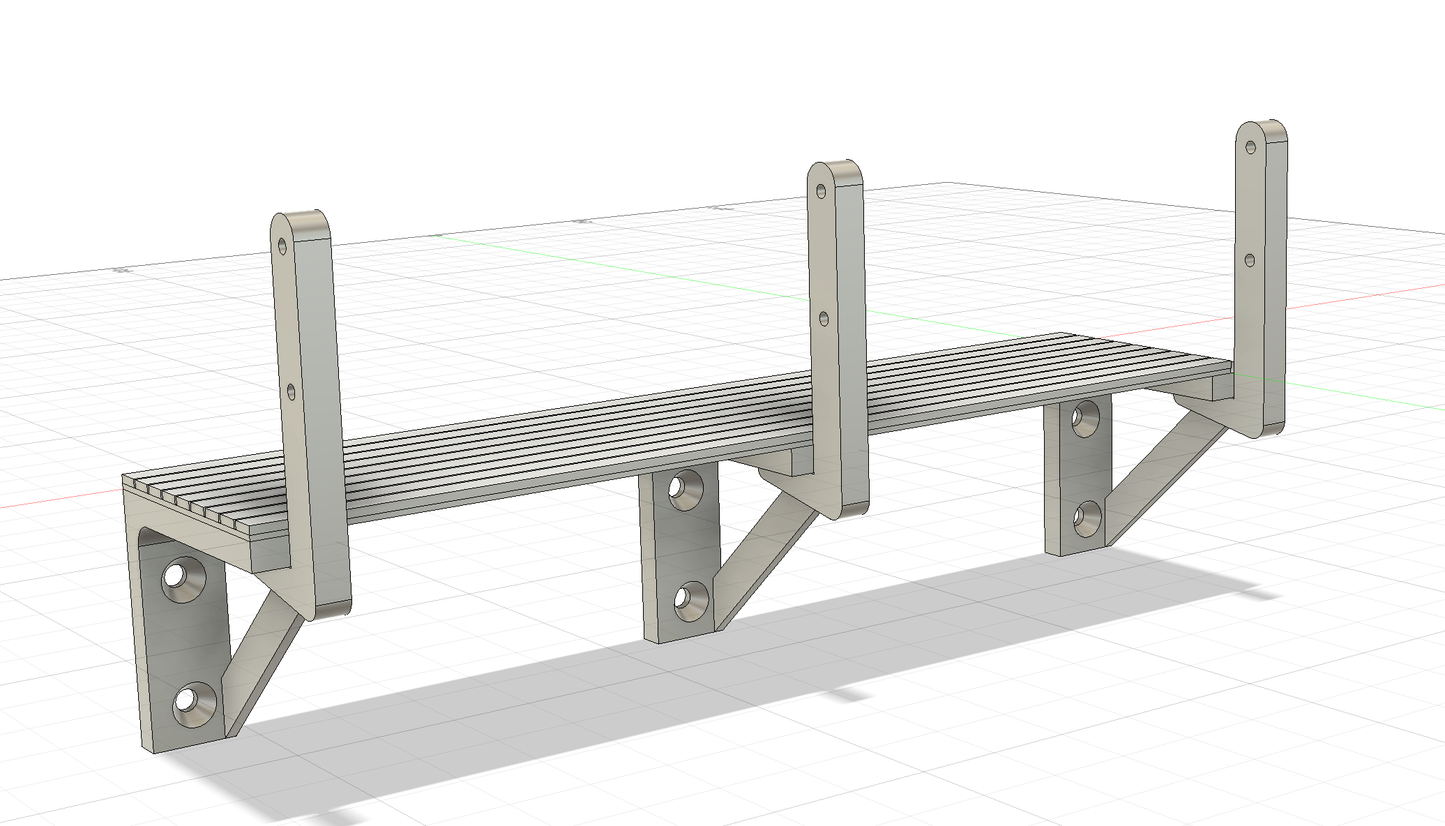

As you will know 3 D printing solves many of my problems, so I wondered if it could solve this one as well. The design for a printable railing( I really do like Fusion 360):
- Screenshot 2025-09-14 at 09.41.07.png (489.54 KiB) Viewed 17874 times
It is in three separate parts, brackets to support the walkway, the walkway, and handrail posts. The first sections are printed. The brackets - which are screwed into the sides of the main beams, and the walkway first. The walkway is twice as wide as the previous one (so I hope my coaches will clear it - but I can work that out as I go along). The first section of the viaduct is straight - and that seemed a good place to start. It will take a while to print and fit, and as I get to the curved sections I will have to make each section to fit each place, but it looks OK so far. The handrail posts are still printing. Photos shortly.

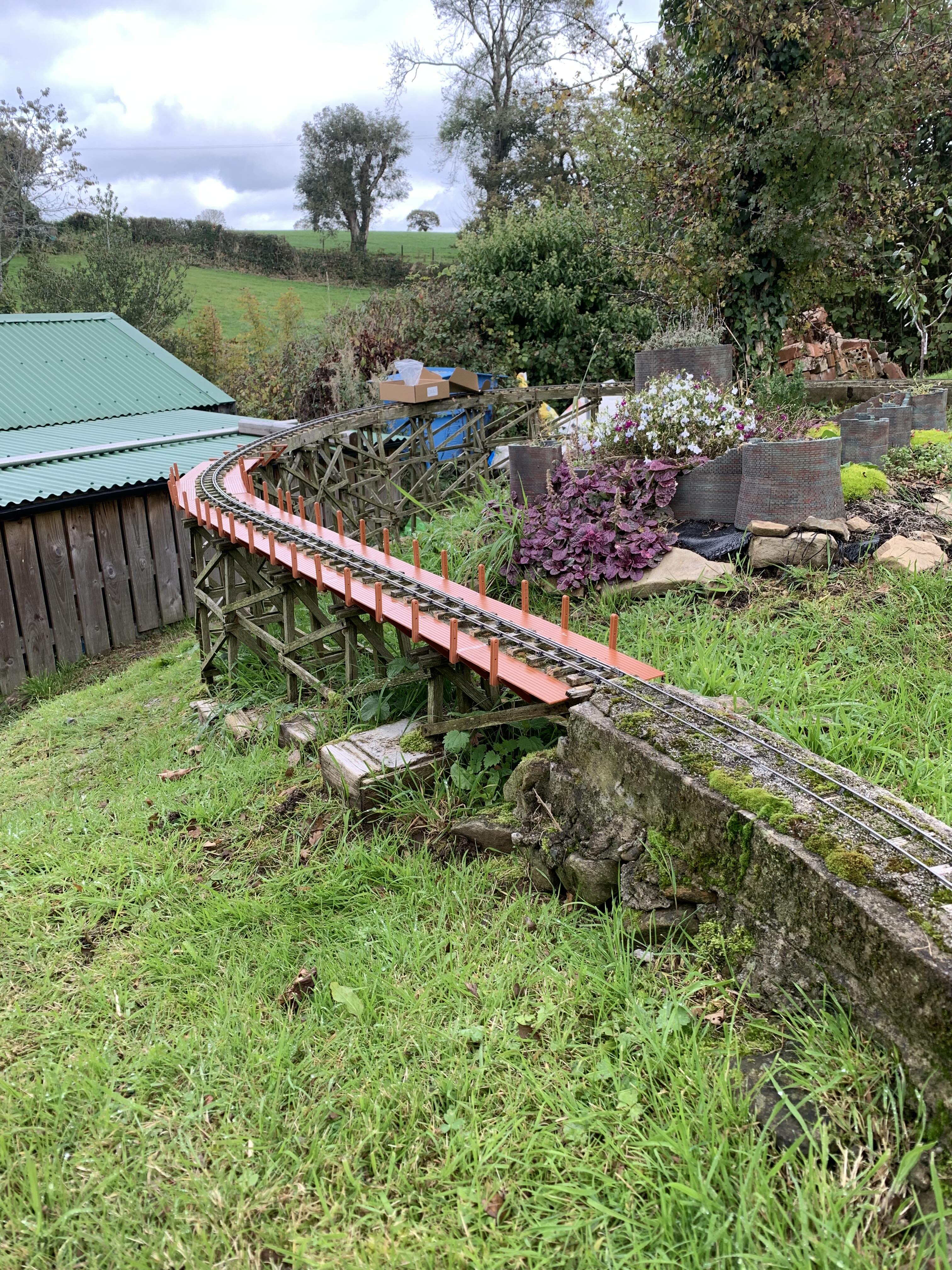

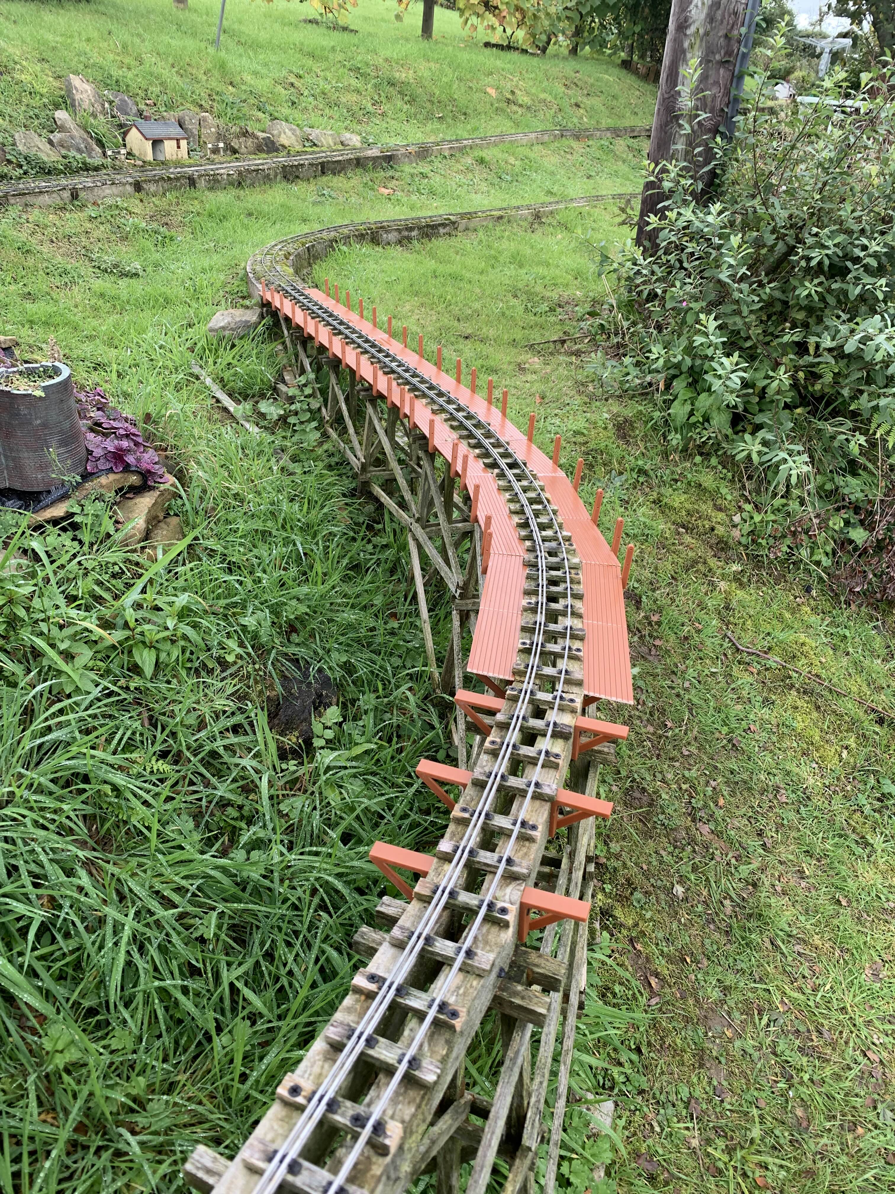

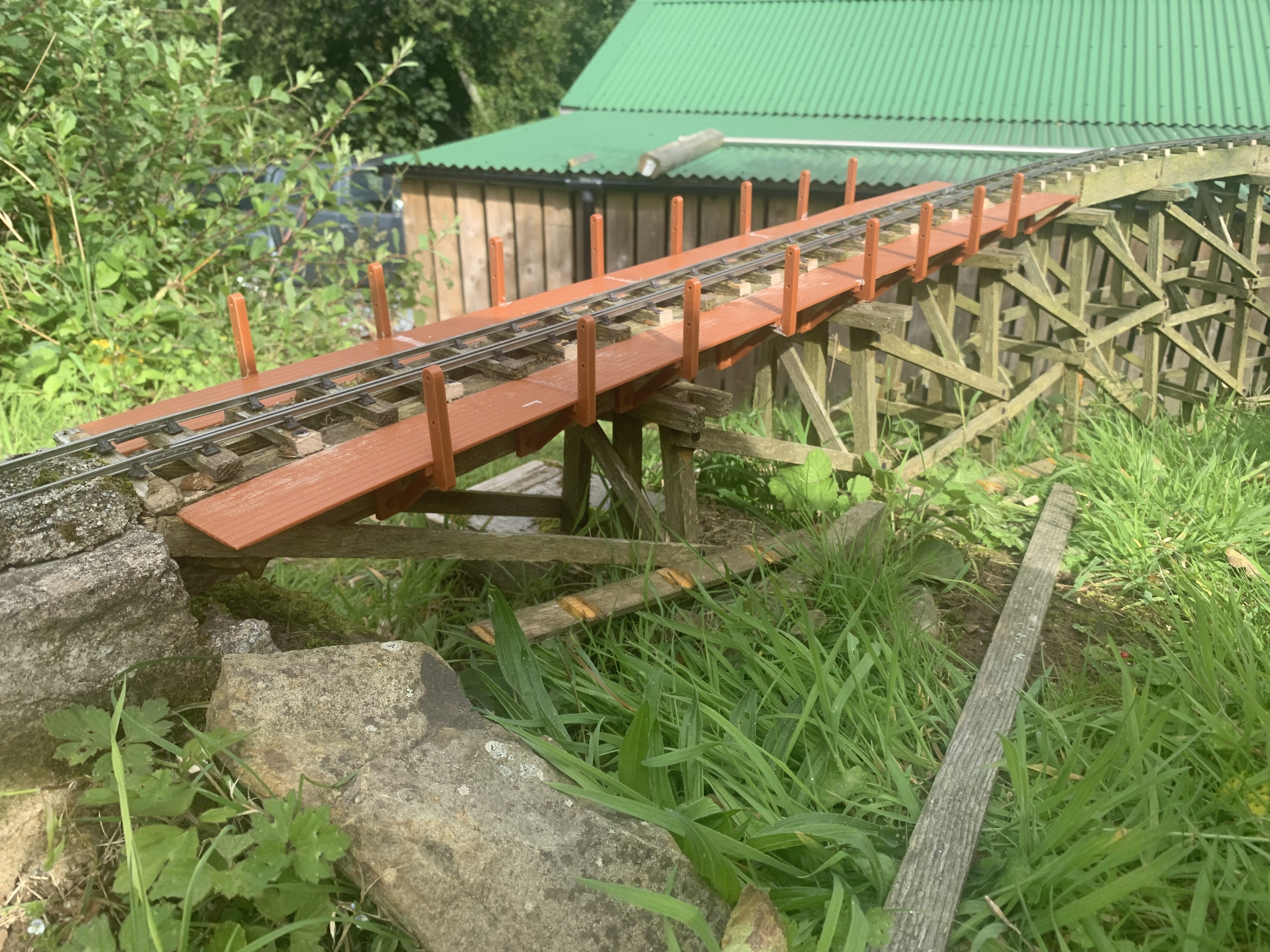

More progress on the viaduct handrails.
I am into the curved section now:
- IMG_4797.jpg (2.27 MiB) Viewed 17221 times

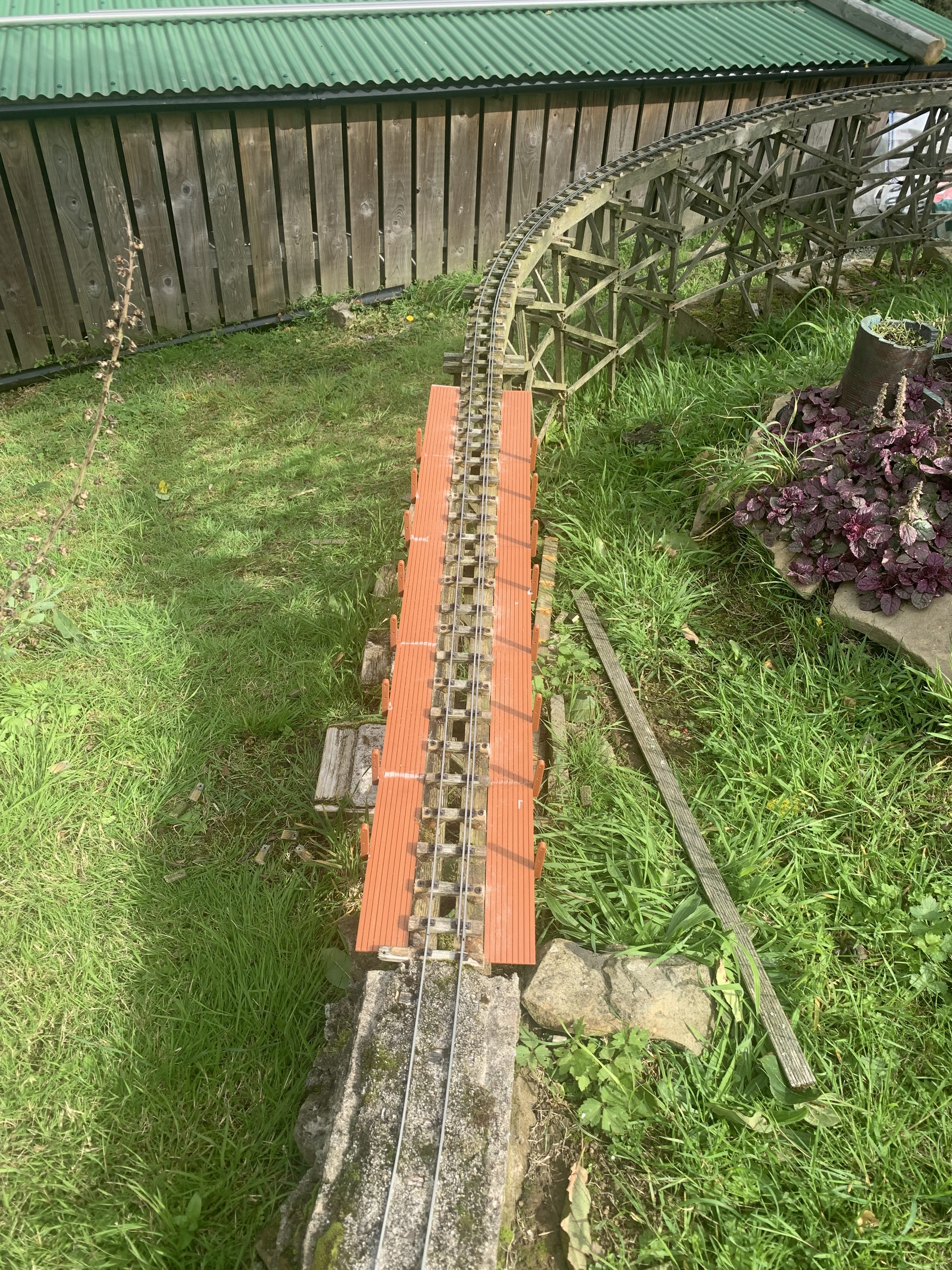

The brackets are going on OK - although I have found that they go on more accurately if I don't pre drill the holes. The sections of decking are all odd lengths and have angled edges. I was going to print each one accurately to size, but I am actually using the first ones I made (for the straight section) and just cutting them to size as I go. I am finding that the easy and accurate way to cut them is on my guillotine - but that does mean marking them and taking them to the other end of the garden for cutting.
- IMG_4796.jpg (2.22 MiB) Viewed 17221 times
Almost half way now.
I think I will paint the plastic when I have finished (before fitting the wires) - it looks a bit "plastic" and artificial as it is.

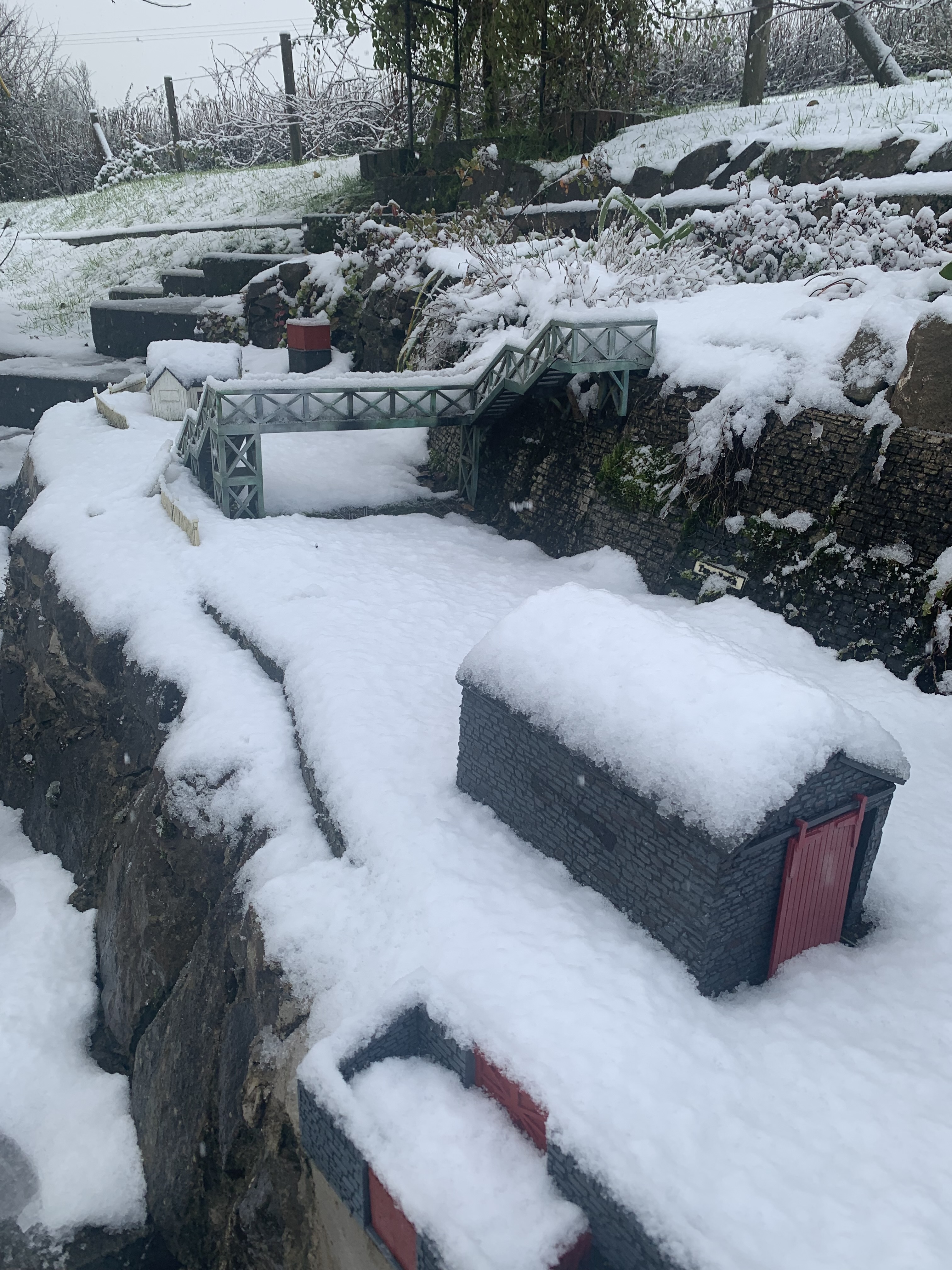

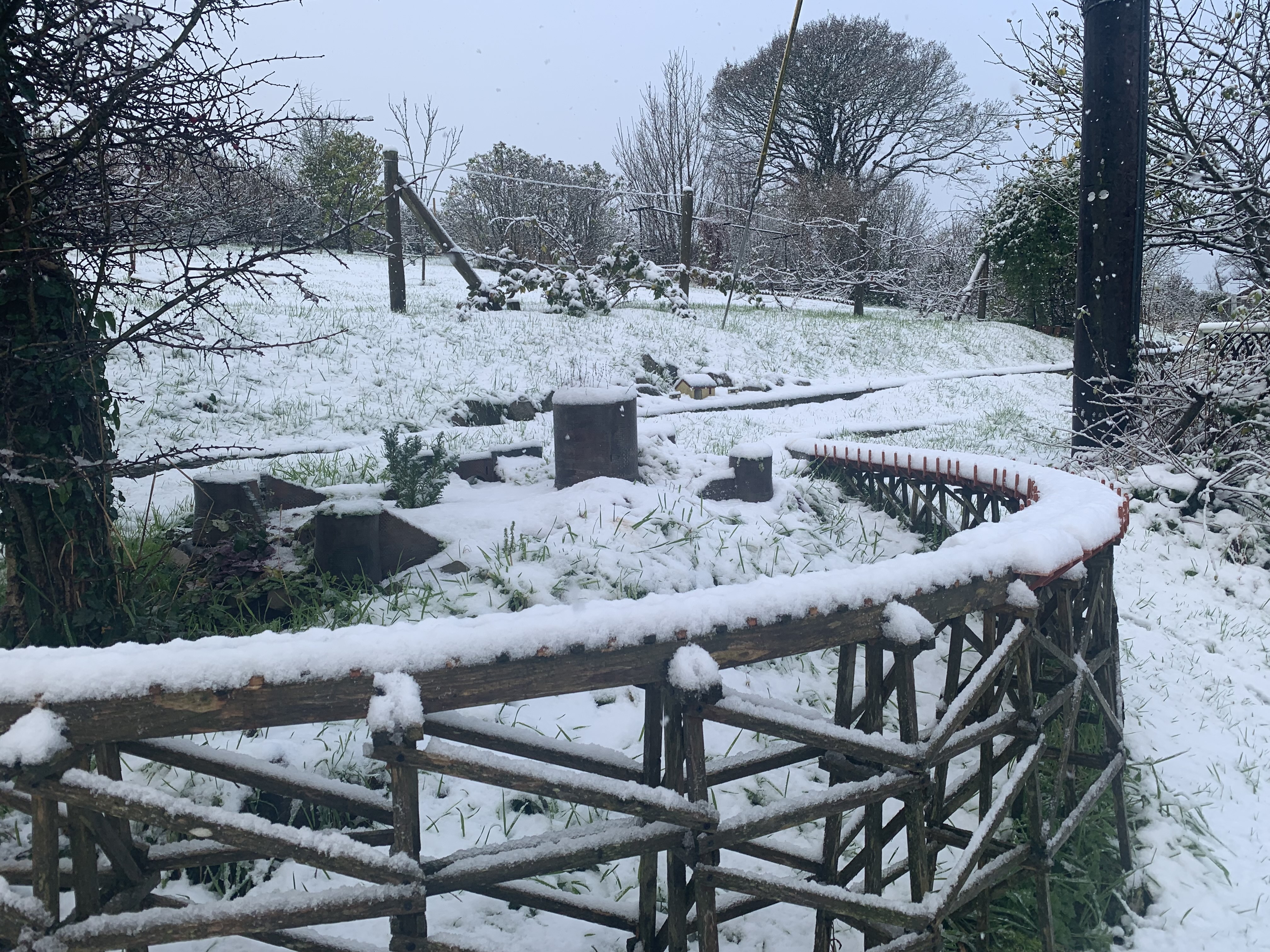

Posted: Thu Nov 20, 2025 10:16 am
by Trevor Thompson

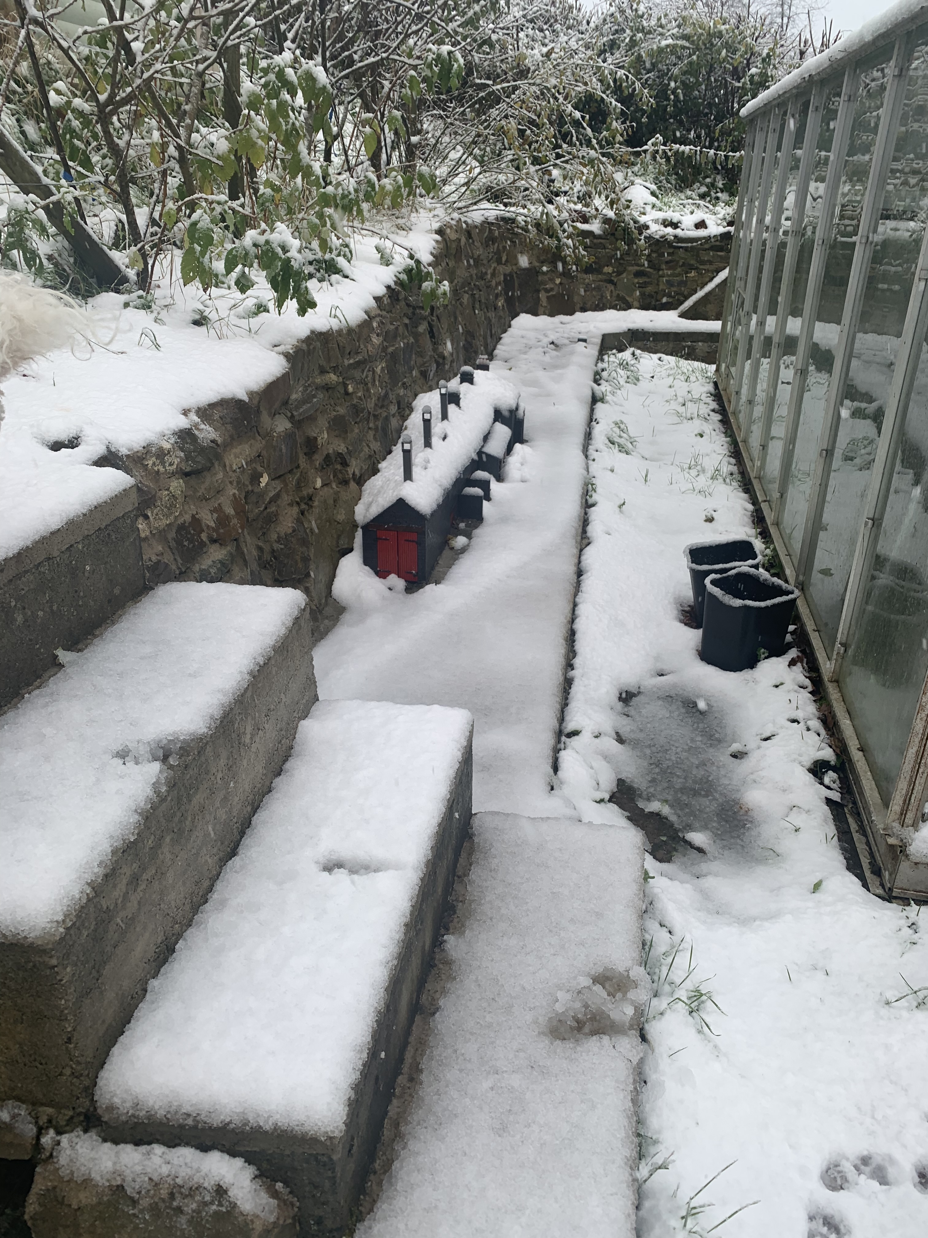

I don't think any trains will be running today!
- IMG_4870.jpg (3 MiB) Viewed 13508 times
- IMG_4869.jpg (2.52 MiB) Viewed 13508 times
- IMG_4867.jpg (2.63 MiB) Viewed 13508 times

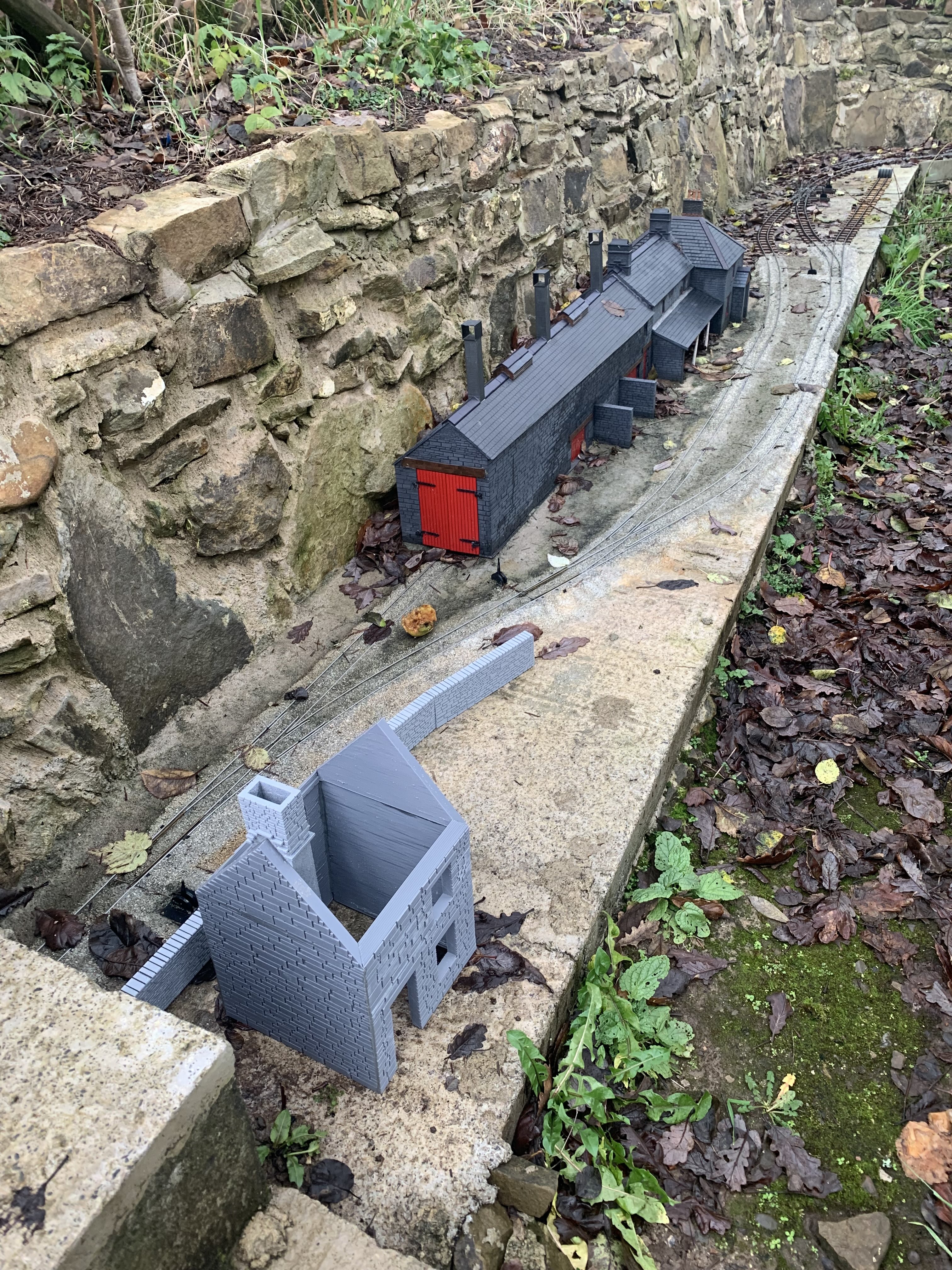

Posted: Sat Dec 06, 2025 1:51 pm
by Trevor Thompson

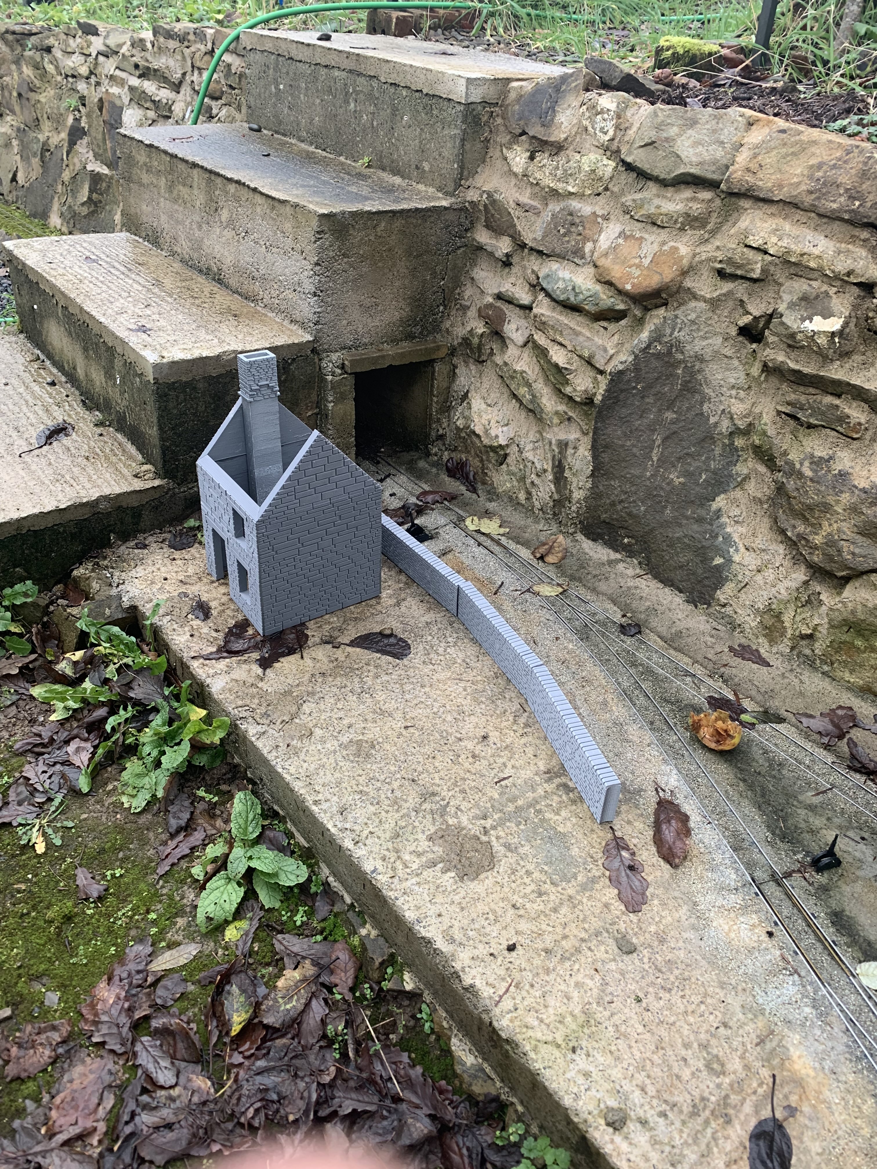

The first buildings to finish off the terminus at Dinas will be cottages under construction, along with the walls separating them from the railway:
- IMG_4894.jpg (2.91 MiB) Viewed 12552 times
- IMG_4893.jpg (2.87 MiB) Viewed 12552 times
The scaffolding and roof beams are being printed, along with another cottage where the walls are only a few feet tall.

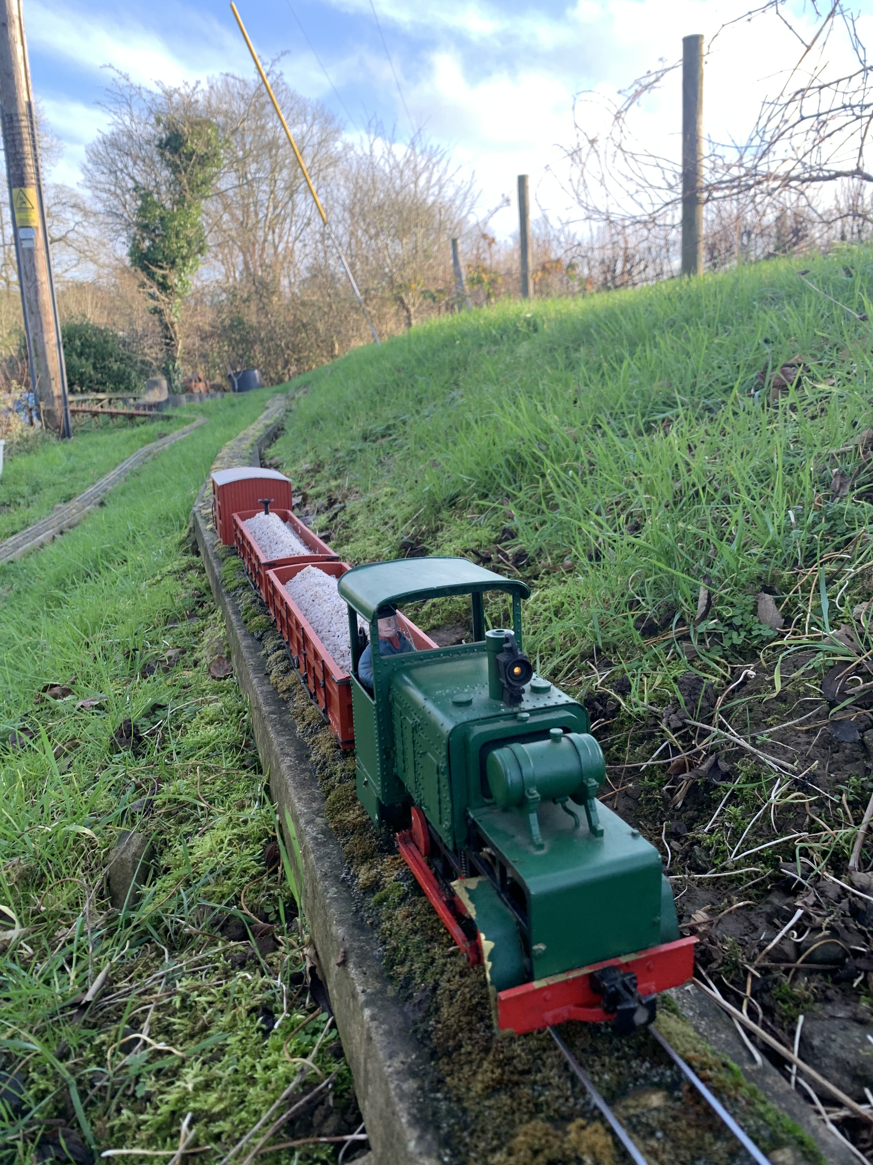

Boxing Day Steamup.

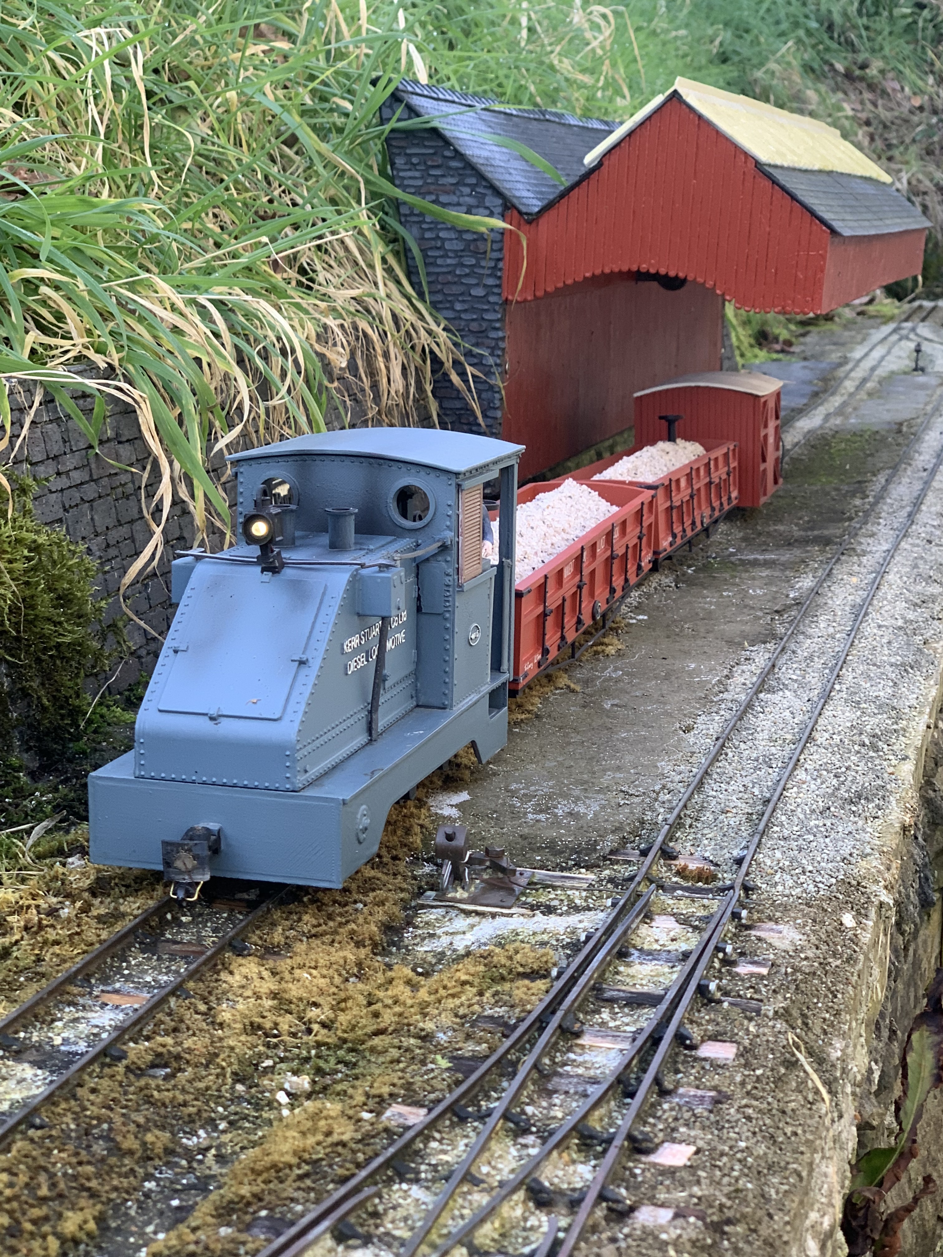

Phil and I started off with the Kerr Stewart sisters ( or should it be brothers) 4415 and 4420. We sent 4415 off up the line with a works train consisting of the bogie ballast trucks, and a brake van while 4420 got steam up.
- IMG_4899.jpg (2.87 MiB) Viewed 10658 times
We soon worked out that the batteries in 4415 were flat. So I went off to fetch Moelwyn - to see if she had enough charge. Moelwyn took the train and set off up the line.
- IMG_4908.jpg (2.84 MiB) Viewed 10658 times

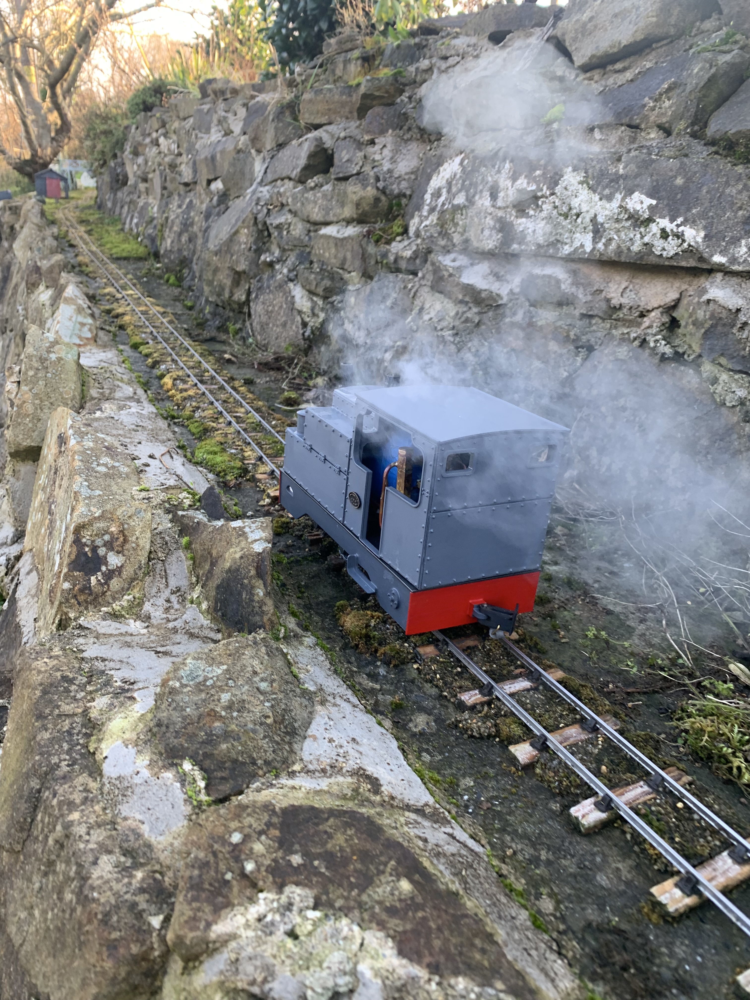

Meanwhile we got 4420 going and sent her off to catch Moelwyn up, with a view of giving her the train to pull.
- IMG_4905.jpg (2.83 MiB) Viewed 10658 times
Unfortunately we had both forgotten that the temperature was only 1 degree celsius, and we were running on Butane. The inevitable happened and she ran out of steam at "Tan-y-Bwlch", when the gas stopped evaporating.
So Moelwyn took the train all the way to "Dinas" ran round and brought it back to the lower terminus.
By that time we were pretty chilled - and we went into the warmth of the kitchen and enjoyed Coffee and Christmas cake by the Rayburn.
