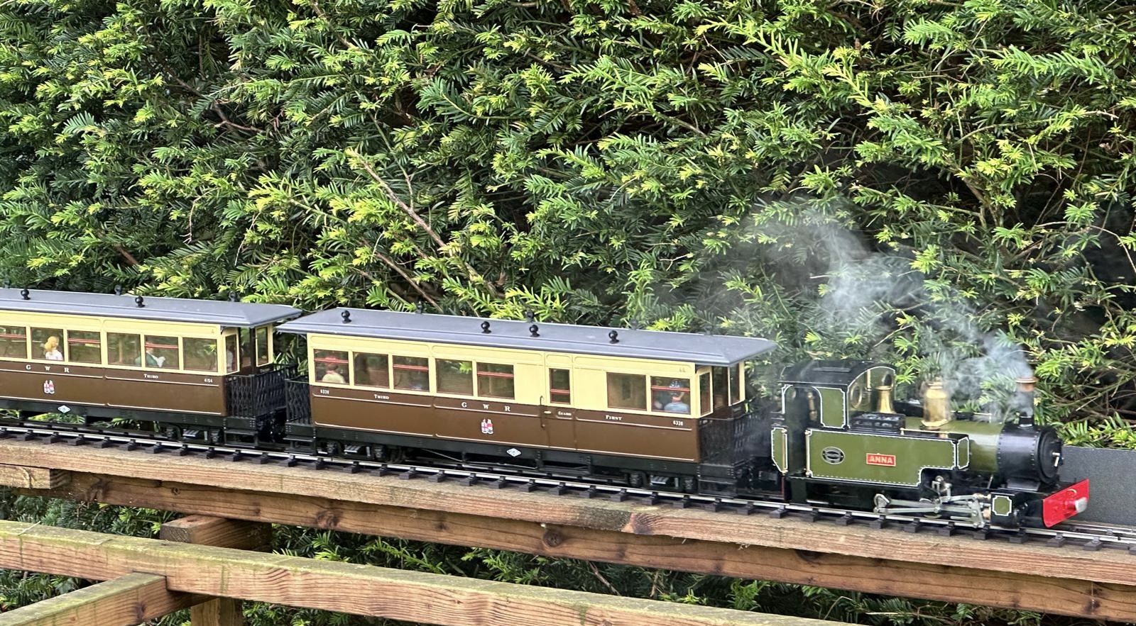

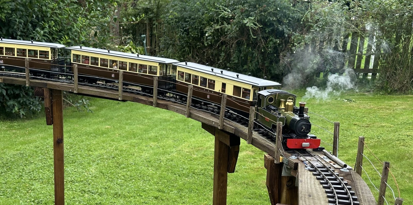

Roger and Jackie from the South West Wales 16mm group came over to play yesterday afternoon. They took this rather splendid piece of video which shows Anna starting off with the drain cocks open (simulated):-
They also took some great pictures:-
Roger had his first experience of driving live steam, I think he enjoyed it!

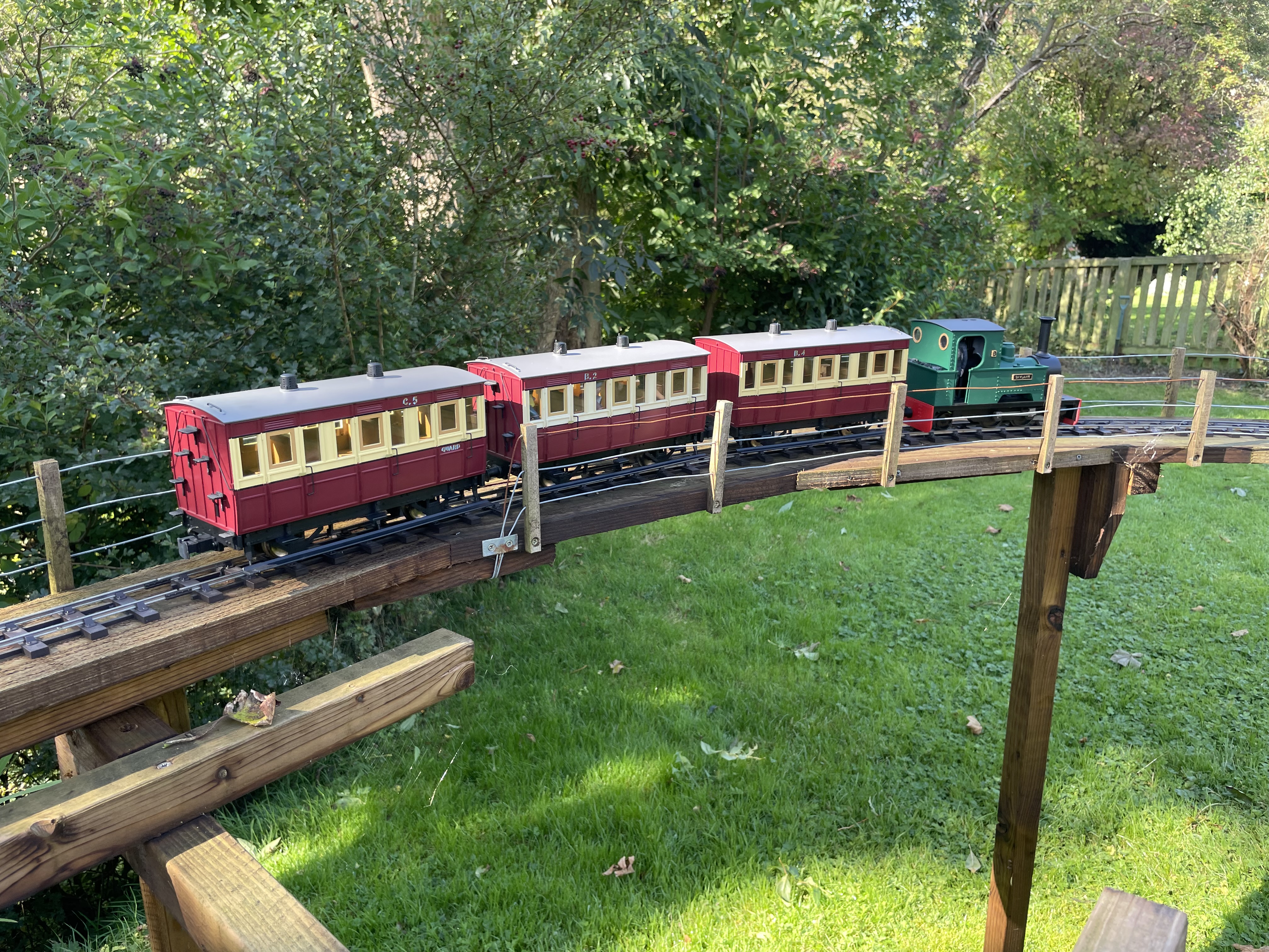

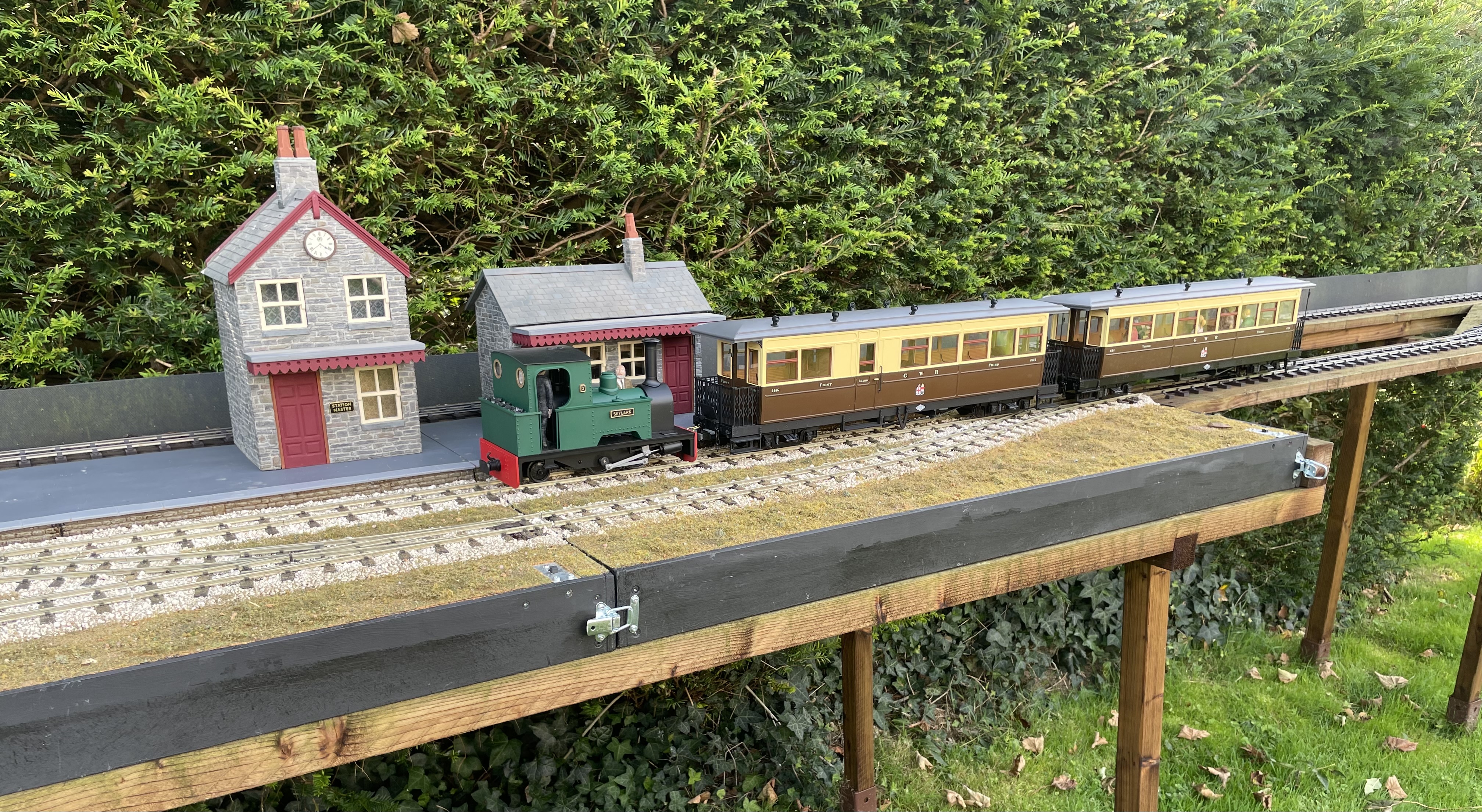

Then there were three:-

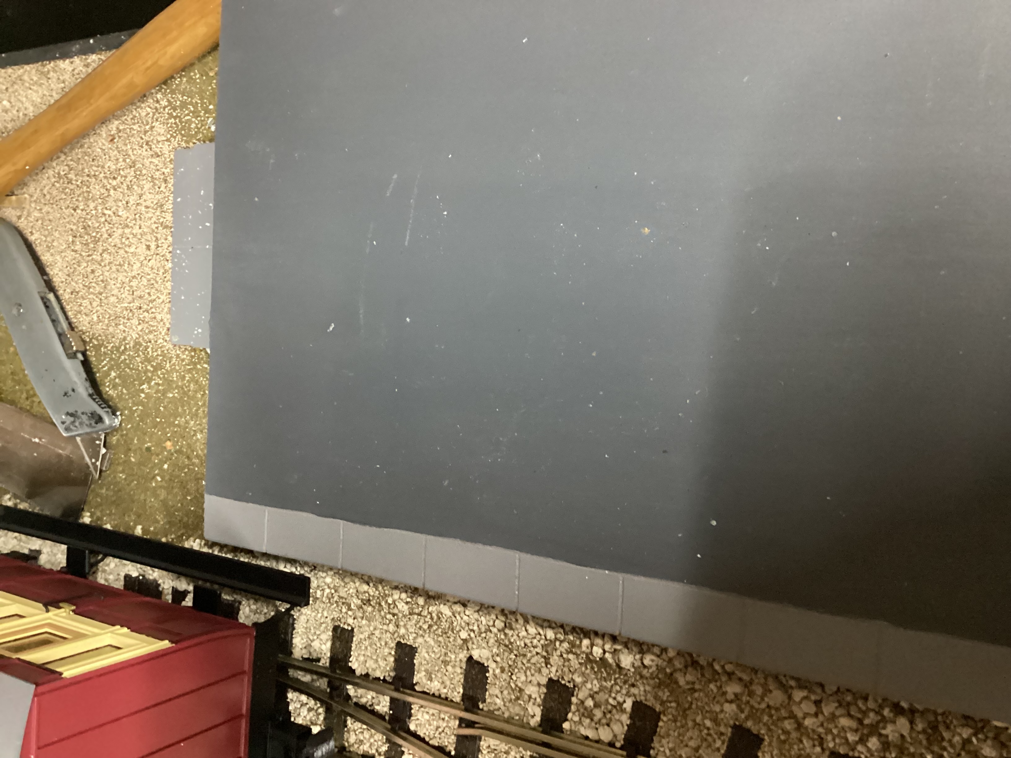

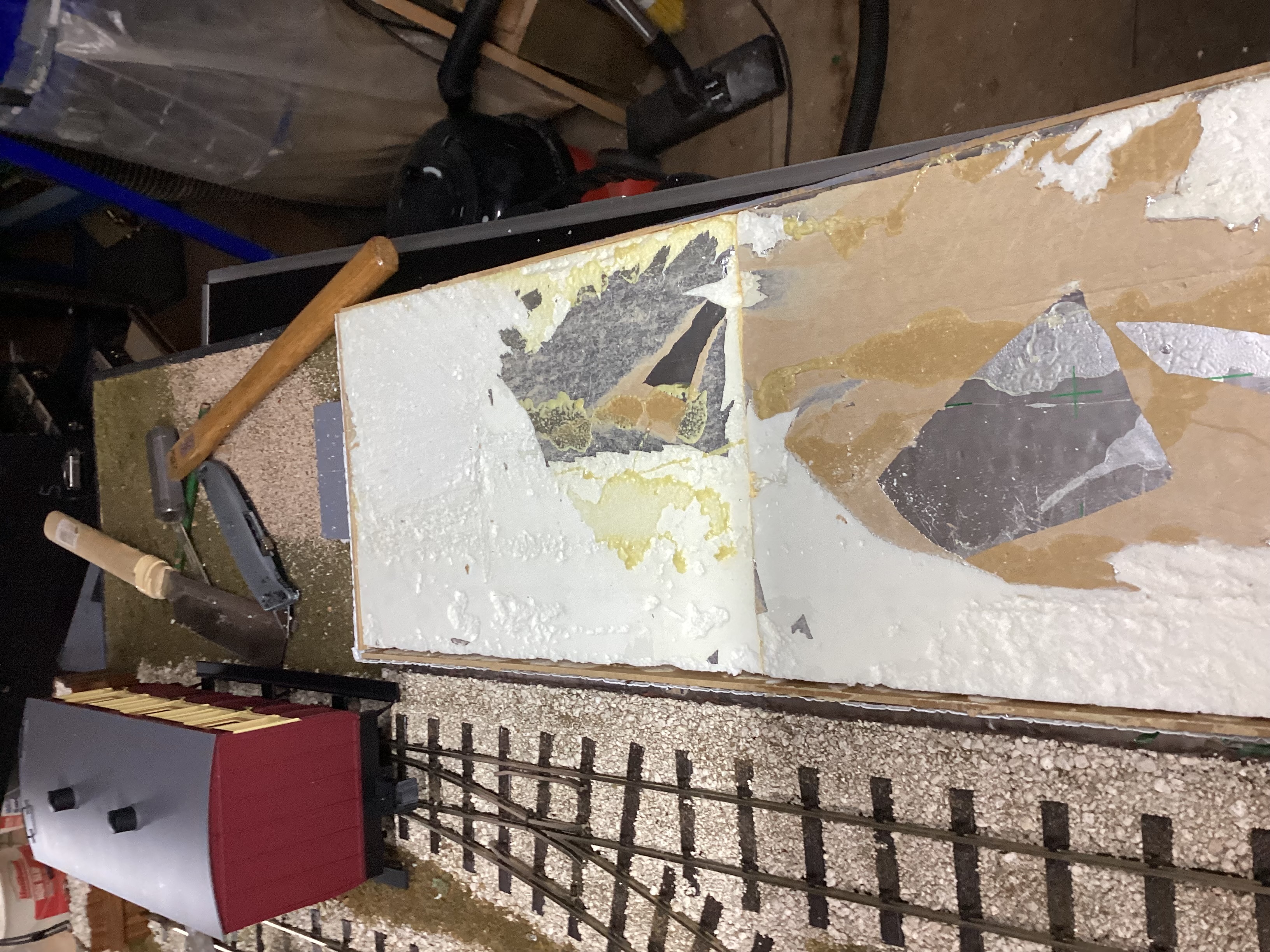

Now how on earth did I construct this platform a couple of years ago? A close inspection leads to my thinking I glued the top onto insulation board so a Japanese saw blade introduced to a gap and waggled about and the top starts to be liftable.
Once removed it looked a fairly simple problem to solve if I just worried about the platform needing to be narrower, height adjustment being much more messy to achieve. Cutting into the insulation about 10mm back from the front edge and use of prodders and Henry lead to a gap. I could then tap against the front stonework to release it from the ballast PVA which was holding it firmly in place.
So we get to this,
and with the surface plonked back to check, this:-
That'll do!

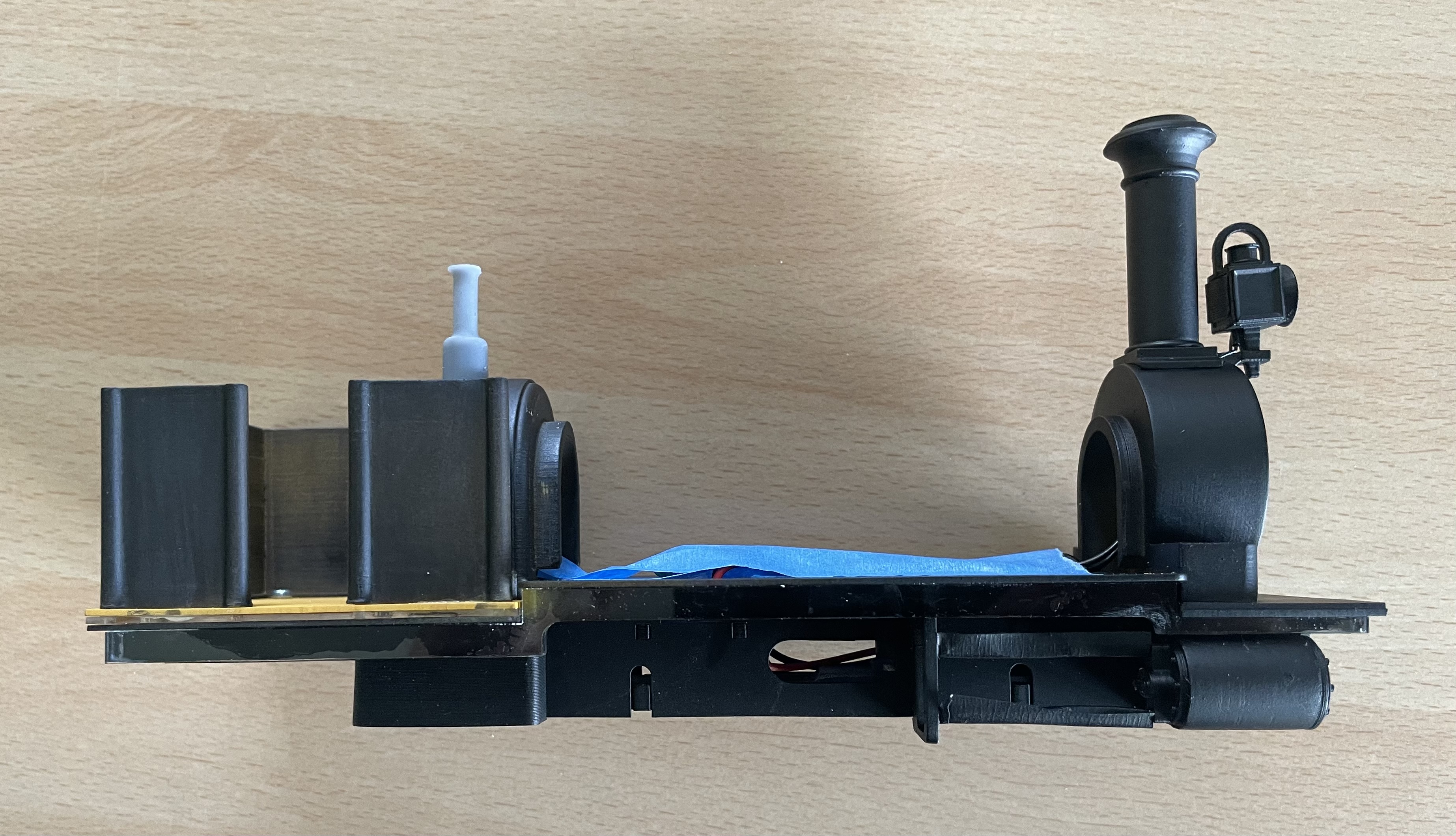

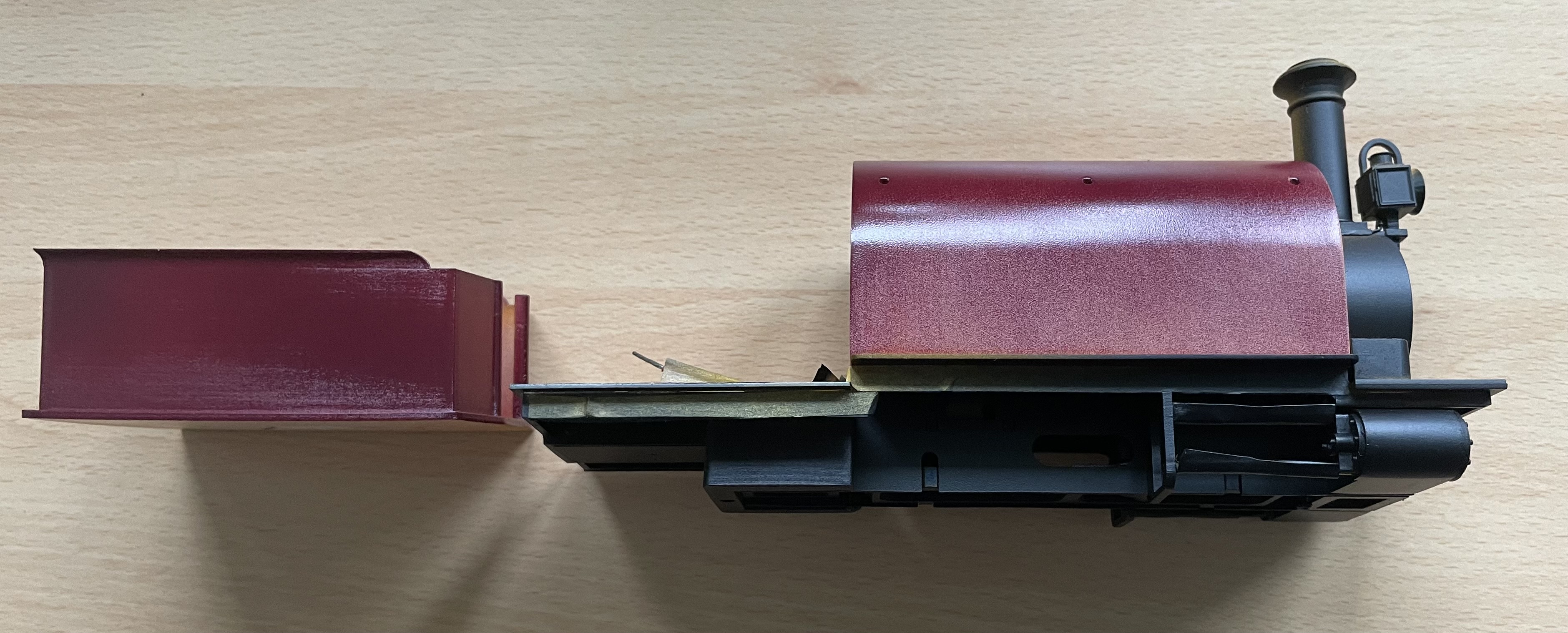

I'm finding when I go back to doing a bit more the 3D print lines need a lot of work. I'm gradually getting there. The cab side plates are particularly awkward and I have now smoothed some Perfect Plastic Putty into the surface and need to do some more rubbing down. I'm hoping that doing them matt black will cover some sins.
I have done some matt black on the chassis, smokebox and chimney assembly from underneath so the cover is far from complete, to get some idea of whether it will do. I've also put a first coat of maroon on the tank and tender. The maroon will be coated in matt varnish.

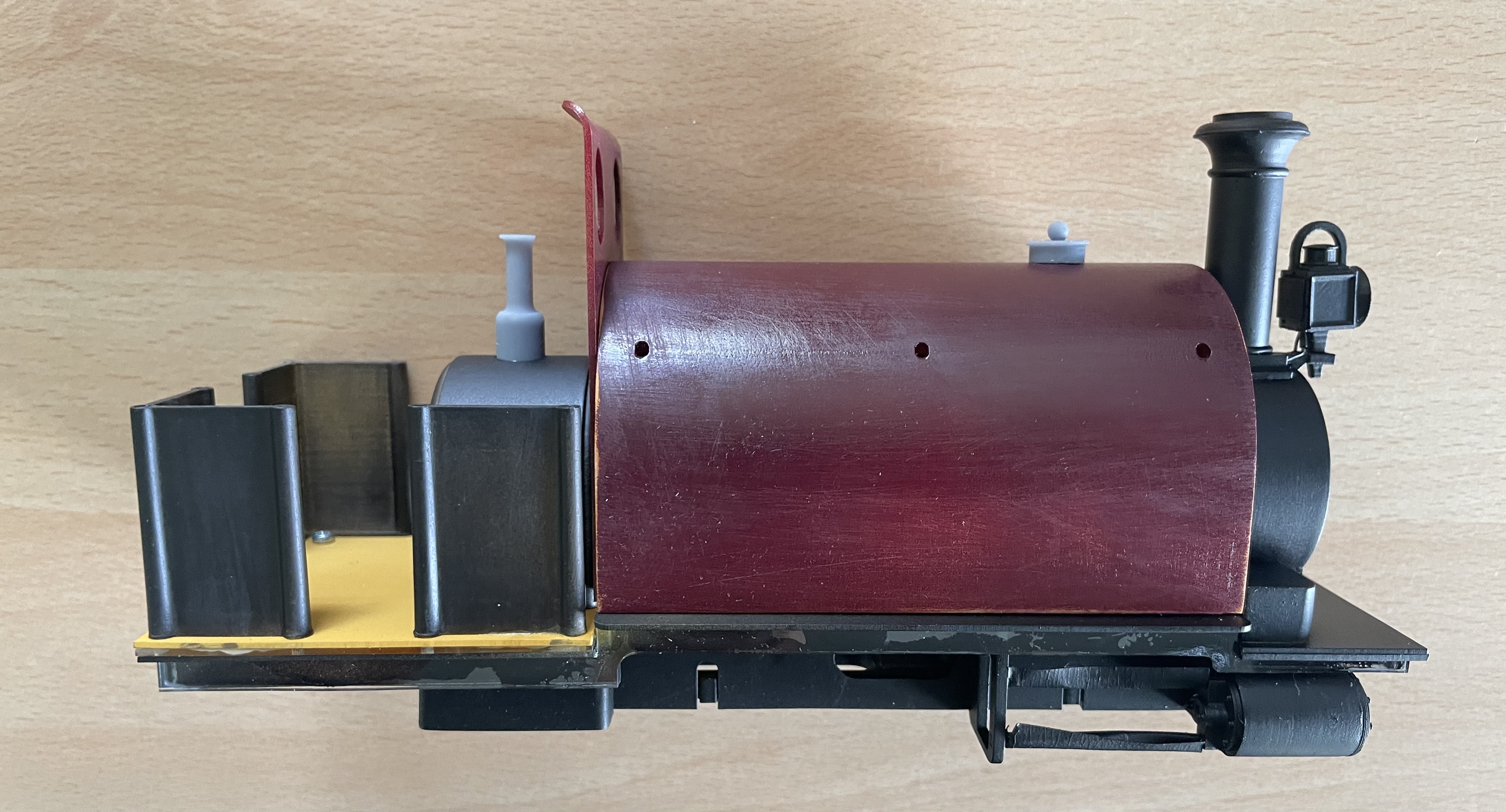

A couple of pictures to show where I am with it.

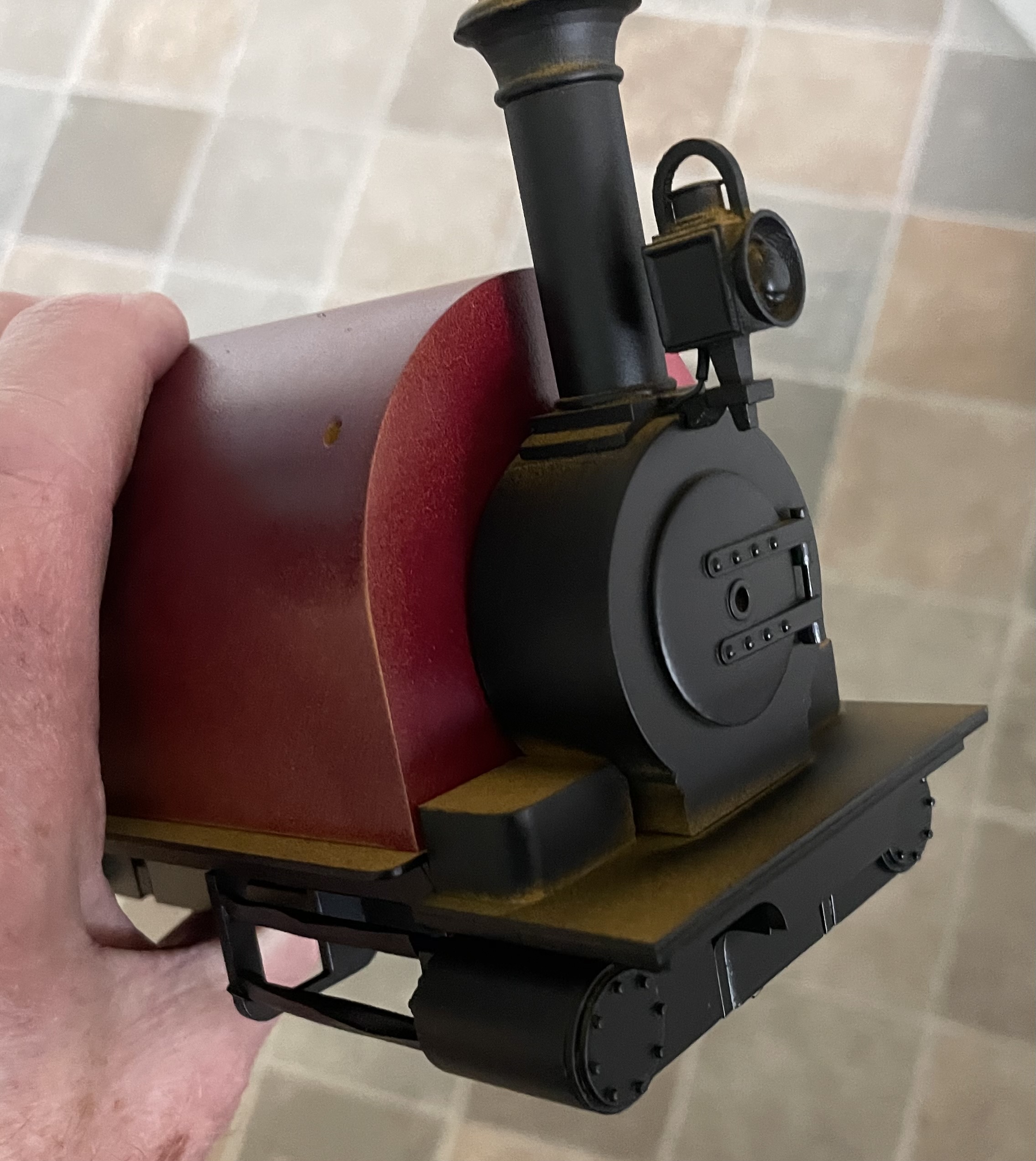

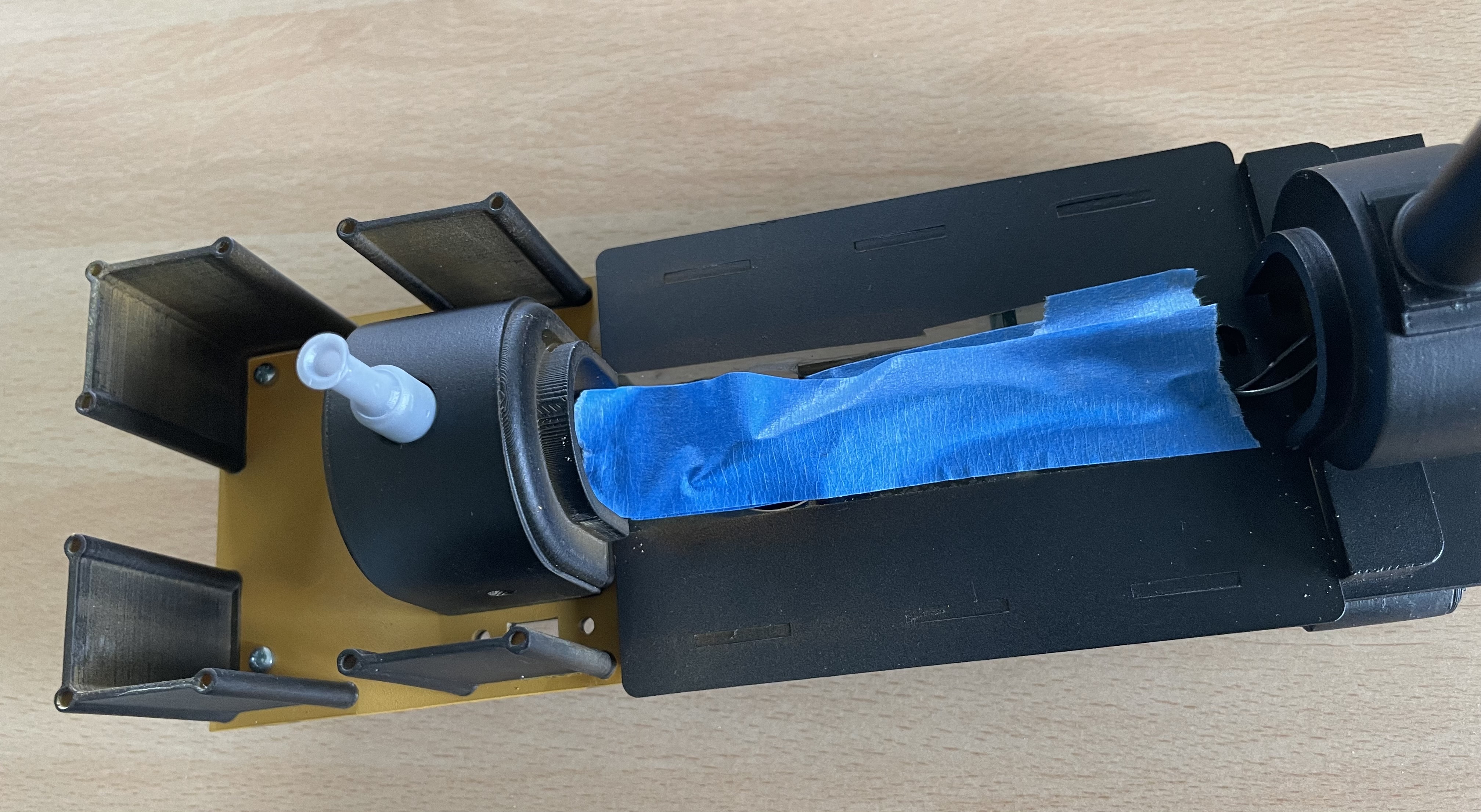

Some more paint and fixing together of the chassis before more black paint. The cab front has been glued to the tank. That assembly is a tight friction fit onto the chassis which is good. In the pictures can be seen two small machine screws holding what are now three layers of cab floor together. The top layer is very fragile, you have to countersink the screwholes for fixing the cab sides from underneath and it cracked when first attaching cab sides. I got a spare from Bootlane and have now bonded that underneath the top layer for strength. This has the effect of raising the firebox by around 1mm so I made the cut out in the rear end of the tank a little taller so it will still sit flat. The cab sides were rubbed down once the PPP was dry and given a coat of black. I think they'll do

Thanks Philip,
it's looking better after the latest coat of paint. I will be making the maroon matt with varnish as it's a gloss spray which is too revealing!
