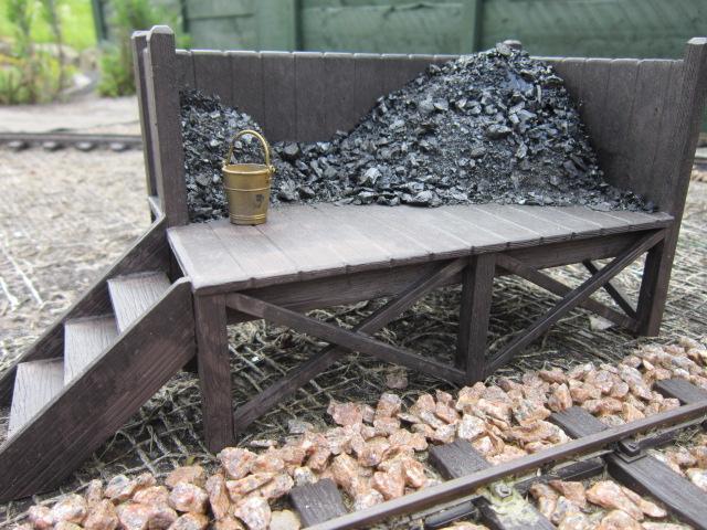

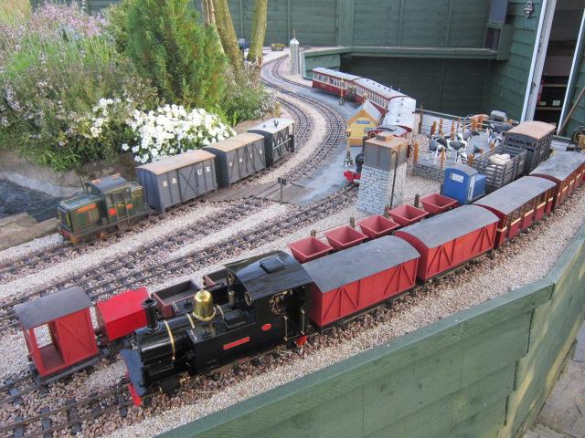

What do you use for the gravel between the ballasted tracks BTW? I've been trying to find something similar for my railway, so far without success.

For ballast I use horticultural grit from our local garden centre. Much of it is over scale so I use a sieve to sort out the smaller bits. It comes in large bags but is cheap enough, the rest is used in the garden anyway.

Rik, I have just re-read your last message and apologise for my rather hurried response which did not answer your question.

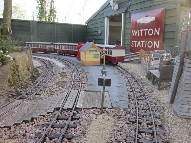

The reply should have been.... the material between the ballasted tracks is made from chicken grit (which I think is actually crushed shell). I paint the baseboard with bitumen and sprinkle the grit onto it and let it set. Then a further application of grit with SBR slightly diluted and with a brown acrylic colour added to tone it down. A variation in colour is possible to add variety of ground effects.
I must admit it looks quite good and will no doubt gather moss etc as time goes by.

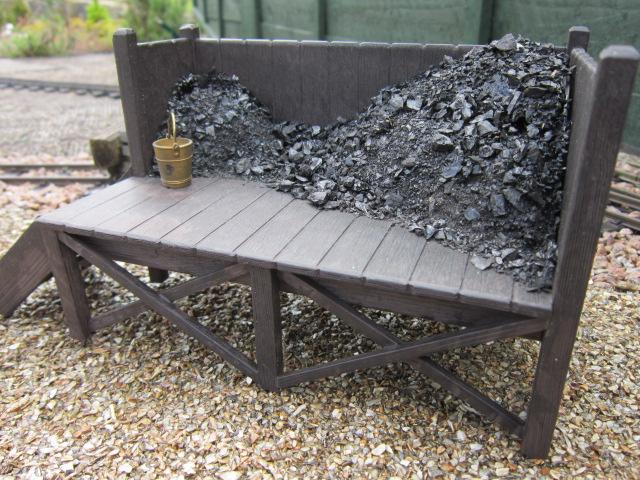

As for the coaling stage.....
The coal was stuck to bitumen as described above. No chance of any light colour showing through and completely waterproof.

That's great, thanks. hadn't thought of chicken-grit. Must get a bag.Peter Butler:110726 wrote:Rik, I have just re-read your last message and apologise for my rather hurried response which did not answer your question.
Really do like the coaling stage - I'll borrow that idea if that's OK - I was considering making mine from stripwood and lolly sticks but, as it will be left outside, I think a plasticard one will be more durable.
Is 'bitumen' the same as felt adhesive - that gloopy black stuff? I always seem to manage to coat my tools, my hands and myself with it whenever I use it. There must be a knack to keeping it under control which I've not yet mastered.

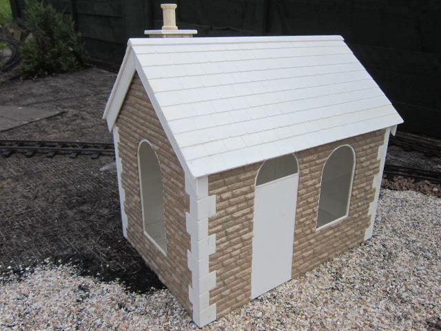

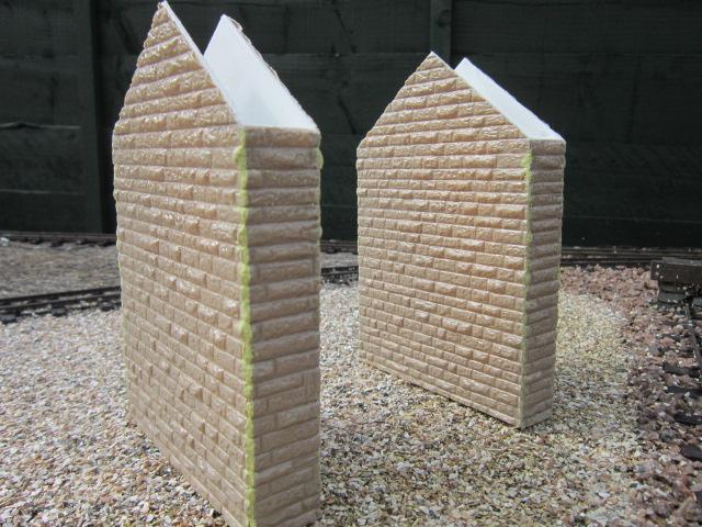

So, having built a coaling stage it suddenly dawned on me that this coal has to come from somewhere! I have been wondering what to do with an awkward space in the centre of the reversing triangle and have decided it will be a coal yard served by a roadway and level crossing.

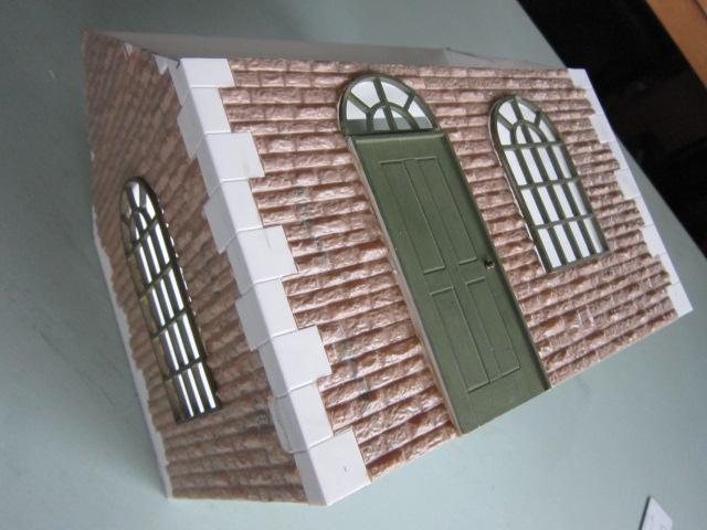

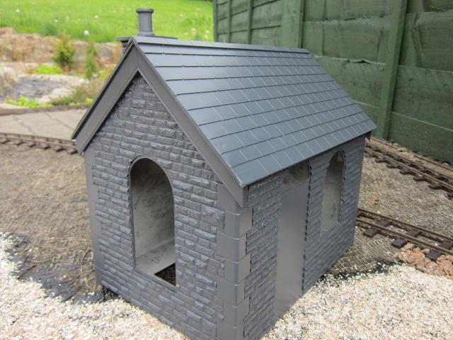

I have experience of building coal storage now so embarked on a new building which will be the coal office. The storage part will follow when I see how much space is left.

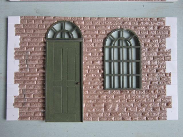

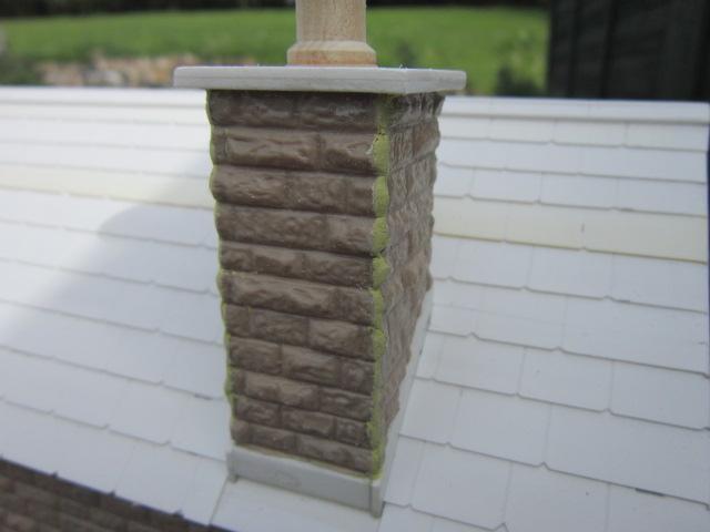

This is my first scratch-built building which will be left outside so I have used Plasticard (what a surprise!). In my materials drawer I have a number of sheets of moulded stonework which I think is really 7mm scale but looks just right. These are stuck to a sub-frame of Plasticard with quoins at each corner. The windows were also stock items so they dictated the size of the structure.
The roof is also Plasicard made of strips which are scribed with a Stanley blade to give the impression of slates, then stuck on overlapping each other.
Barge boards and capping added, along with a chimney...
A coat of 'Poundland' grey primer and we're ready for paint.

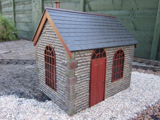

I have to admit I'm pleased with the outcome so far, in fact so keen to finish that despite beginning the build only yesterday I have already finished the painting of stonework, timberwork etc. but it was too dark to photograph this evening..... only the slates to 'weather' and then a coat of matt varnish.

The windows are not available unfortunately. They were made by a friend many years ago and are cast resin. They are the only ones I have, I wish there were more as they suit railway buildings perfectly.

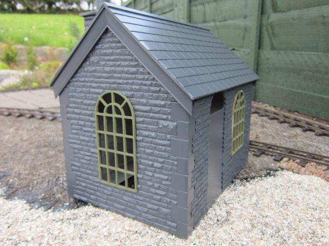

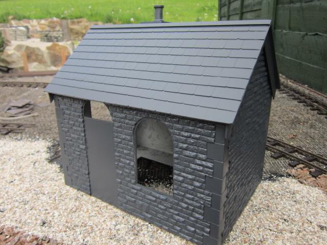

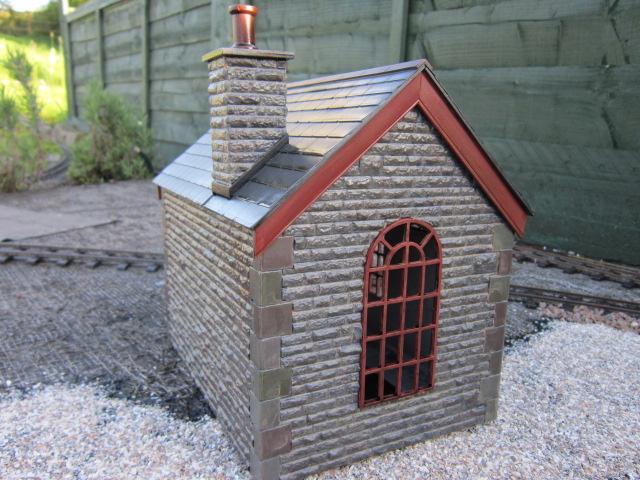

The coal office has now had several colours and washes added to give a slightly grotty appearance that would be associated with its position. I have given a protective matt varnish too so the acrylic paint should stay put!
I still need to glaze the windows and add a sign but that is it.

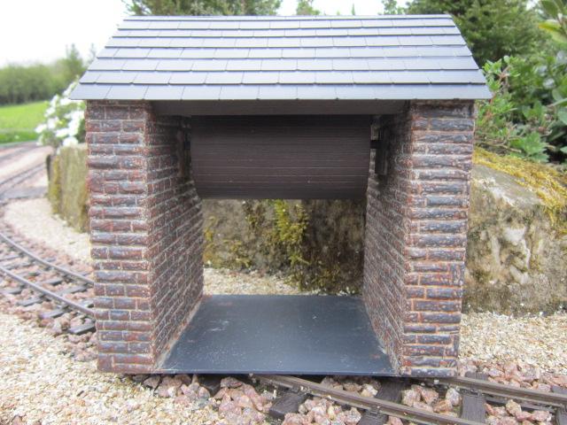

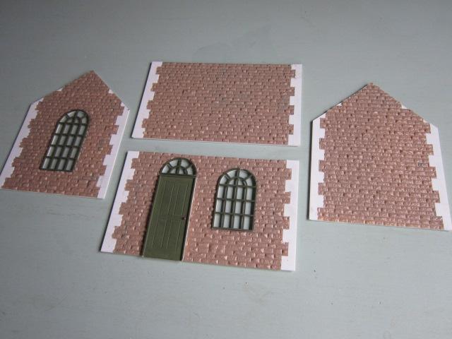

Bit of a building frenzy going on at the moment!..... now I have discovered the stone effect plastic sheet I can't wait to find new uses for it. If it is suitable for permanent outdoor siting I thought about using it for a winding house to put at the top of my incline.
Firstly, the side walls are made as before by using a flat Plasticard former as a base then cladding with the stone effect sheet...
A drum made from scribed Plasticard with a centre spindle which locates into two 'u' shaped channels and a roof of 'slates' made as previously described.
Following a primer coat of dark grey, the whole building is painted with a light emulsion to form the mortar lines, then dry brushed with a variety of colours to represent the natural stone effect matching my landscape material. The drum is painted dark brown to represent wood and finally the whole thing given a tinted wash to add some weathering...
Tomorrow a coat of matt varnish should give some weather protection.

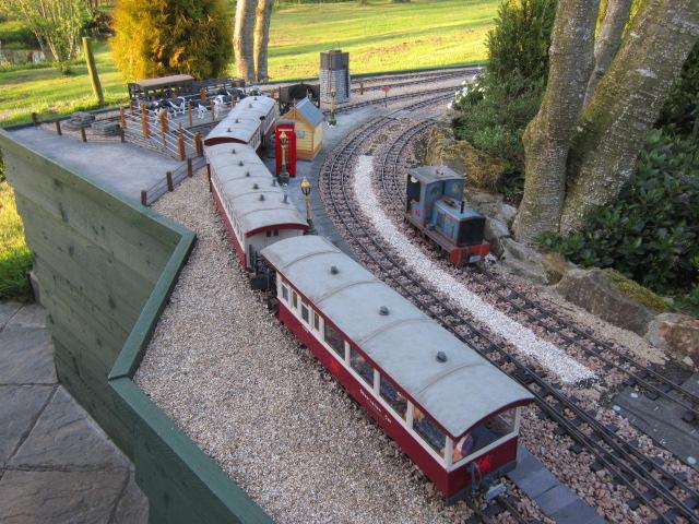

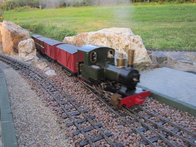

Not often I say this, but this evening we had a running session!
As well as running my own stock I was ably supported by Big Jim's fine collection of steam locomotives and assorted items of passenger and goods vehicles.
The weather has been kind with a warm and dry day and the wind has finally dropped so a very pleasant evening was had. Naturally some liquid refreshment assisted with the proceedings and we will ensure a repeat performance takes place in the not too distant future.
