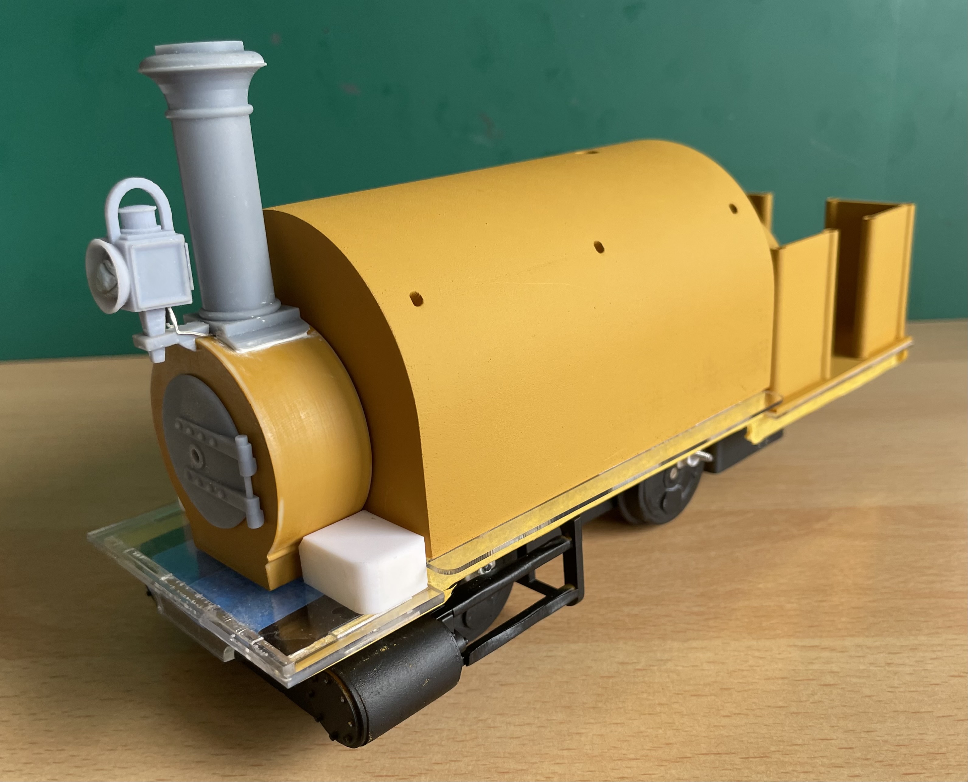

The 3D jigsaw puzzle continues to make progress slowly. Several hours were spent yesterday fitting a bi-colour (red/white) LED into a lamp kindly printed and given to me by Trevor. Both the inside of the lamp and the LED had a couple of coats of black paint, I can scrape as much off the front face of the LED as necessary to let the light shine thro. There is a hole on the bottom of the lamp to take the wires out of, I filled the inside of the lamp around the LED with Blacktack and glued the back plate on after some fettling.
The lamp bracket was modified to fit over the top of the smoke box. The LED wires pass into a hole in the top of the smoke box, which I drilled through to that one passing horizontally through in the centre of the smoke box door position so that I could feed thin flex though to the inside of the tank. I worked small slots for the wires to locate under the chimney. Once all is sprayed black the wires will nearly disappear.
All this much more easily said than done!
A view of the loco so far from the rear.

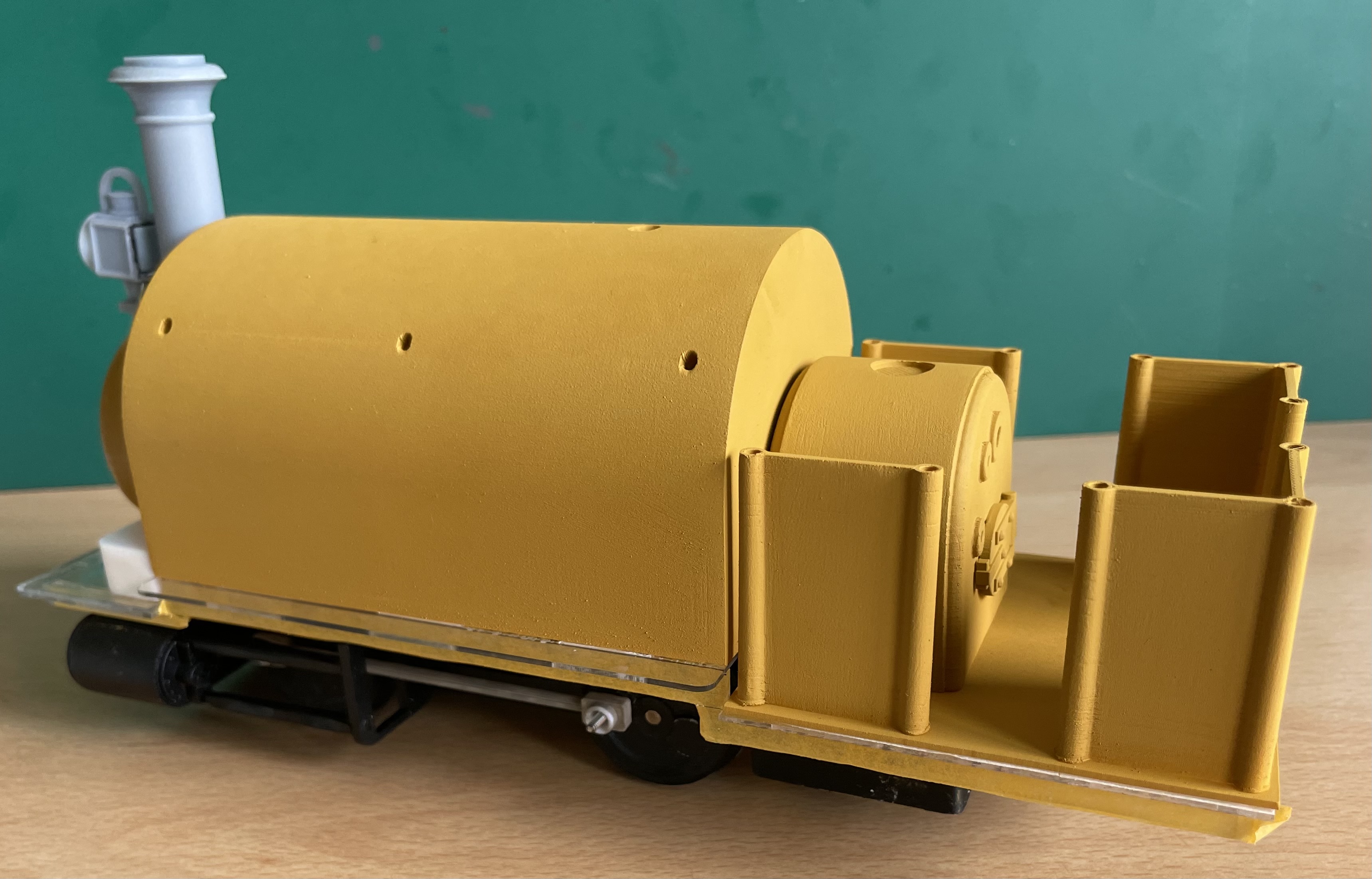

It is very difficult to sand the cab side plates because of their shape. I have not bothered with the insides because I hope that once they are matt black the ridges will not be visible from normal viewing distances. Because of their shapes it would be very difficult to laminate them with thin plastikard.
The tank is coming on quite well, I think, it is due another sanding with fine abrasive to see how well the striations are filling with primer.

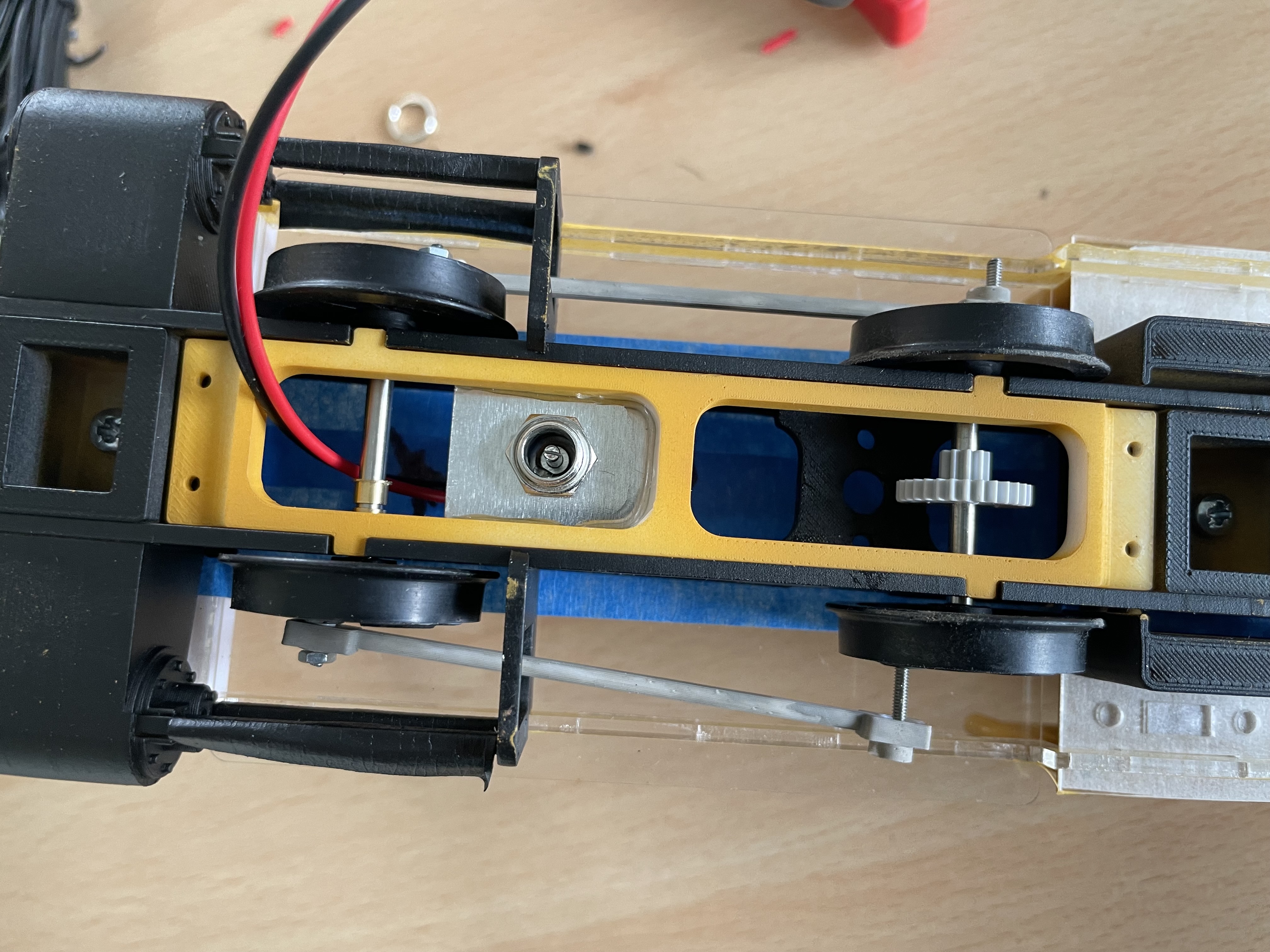

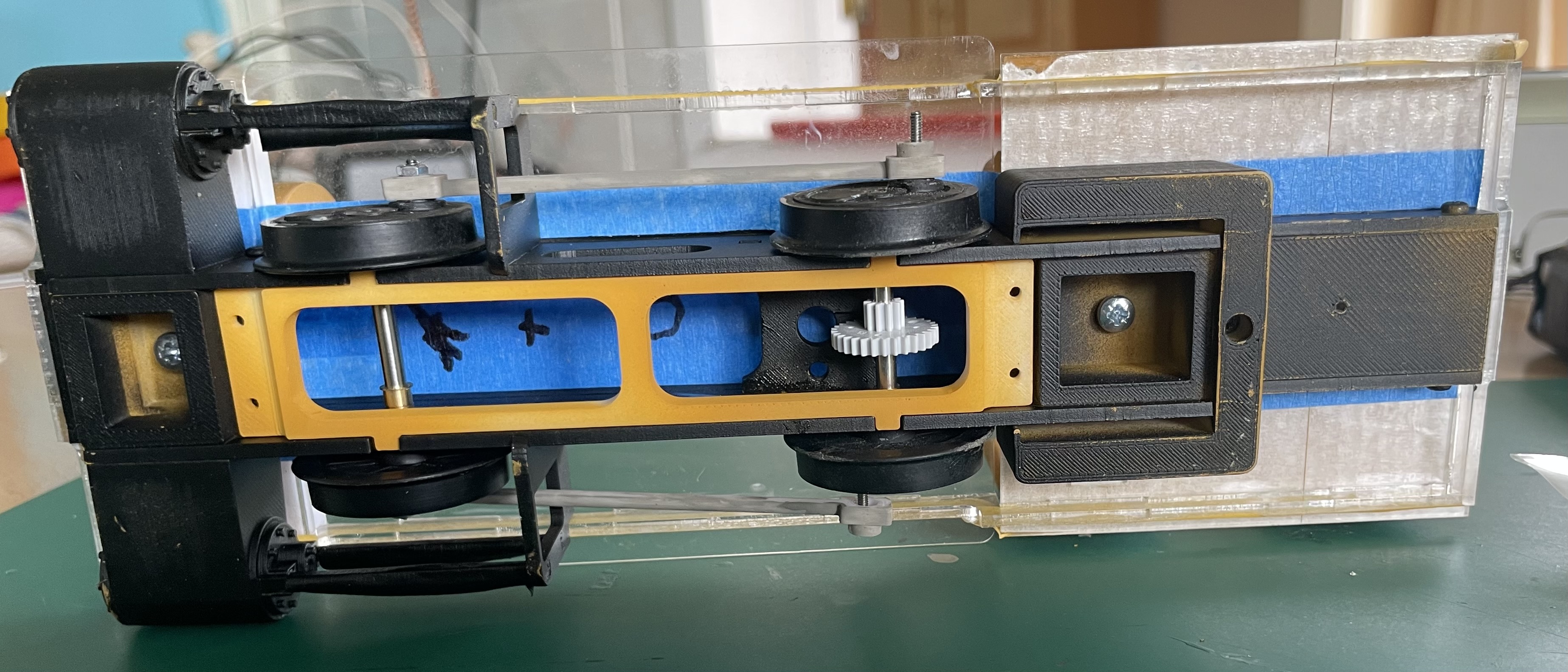

There is a quandary as to what to do about fitting a charging socket to the underneath
I cannot work out where it could go considering all the obstructions underneath and that I want to fit the battery pack centrally above the wheels.

To some extent it depends on what type of batteries you are going to use, but if you are thinking of NiMh, then the simplest, easiest and least space consuming option, is simply to wire up two brass bolts, one +ve and one -ive, protruding from the underside at convenient points, and use crocodile clips on the charger. The spaces around the two fixing screws look suitable, or on the spacer in front of the gear wheel?gilfachphil wrote: βTue Aug 27, 2024 2:09 pm
You could use the same system for LiPo's and put the balance socket at some other location, but it is less simple.
However, either way two bolts take up a lot less space than a socket.
It's a solution suggested to me by Grant and it has worked well for me on several models.

Thanks Philip for your comments. I am using NiMH cells, a bank of 6AA. The charger I use has a 2.1mm DC plug outlet so I prefer to stick to the matching socket if possible. The solution which occurred to me earlier was to mount the socket on a small piece of aluminium araldited to the keeper plate! I can then feed two wires up thought the footplate through a small hole. Hope that works!

I think this will work:-
Nice and neat Phil. Brilliantly done.

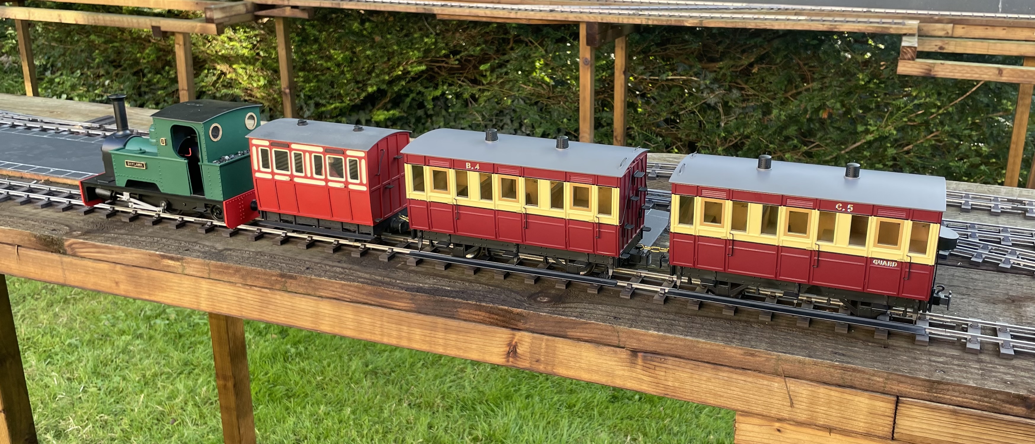

These coaches appeared for a short while in the For Sale section:-
Having commented how nice they are my phone went a few minutes later. It's good when the seller is a friend, thanks Chris.
I changed the wheelsets to 32mm, which is easy if you read the instructions and only remove the axle box assembly from one side.
I have changed the couplings to dummy buffers from Ebay since nearly all of my stock uses three link rather than the Accucraft chopper coupling.
Here they are with a Jerry Irwin victorian coach for comparison:-
- Posts: 5929
They look good in motion and the JI coach goes OK with them as well.

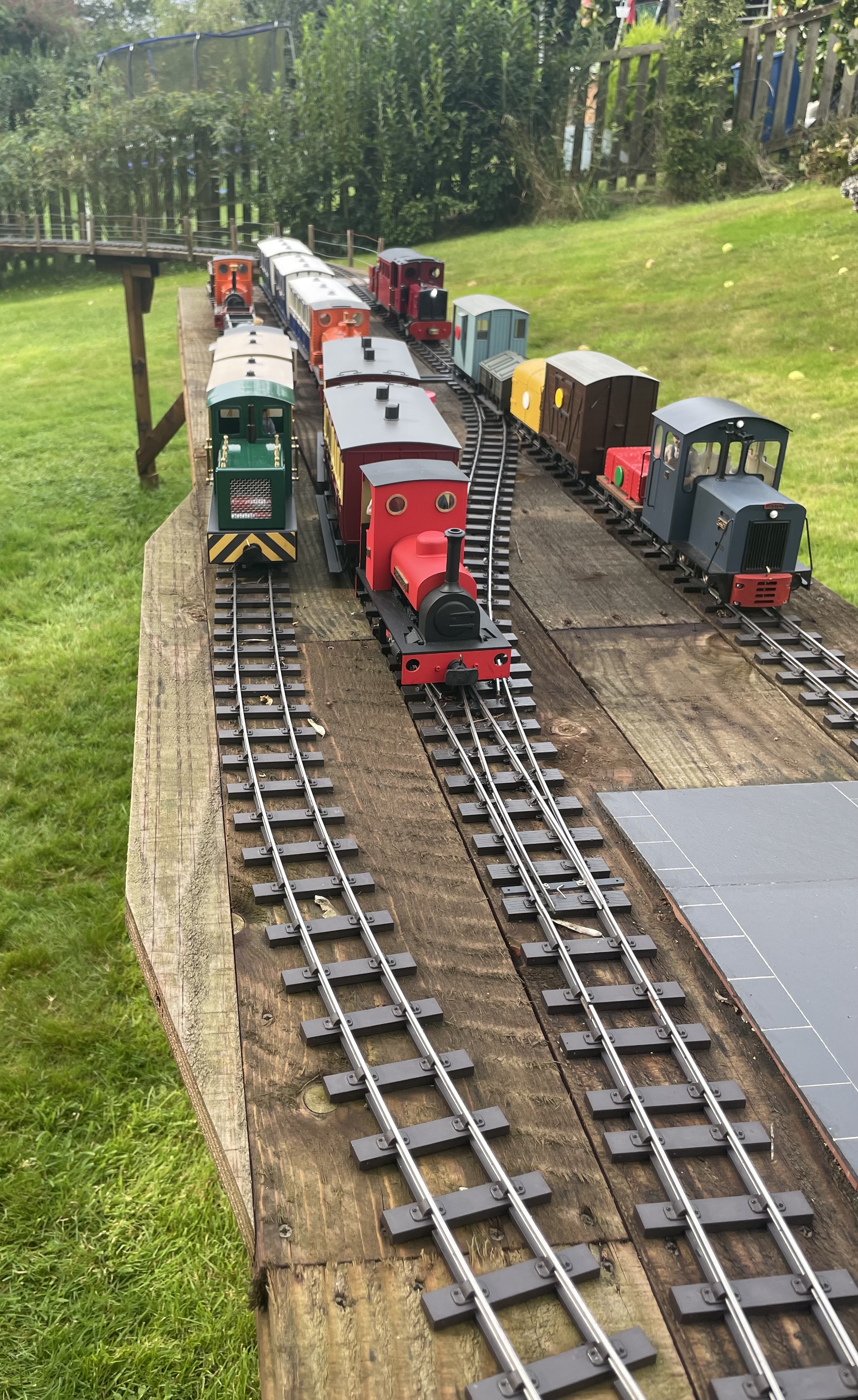

A few friends from the South West wales 16mm Group visited today. To finish our running session we had six trains in convoy round the layout. Here they are all parked up afterwards with a seventh which did not run in the convoy.
Thanks to all who came to play,
- Posts: 5671
A wonderful, dry and warm day it turned out to be. Thank you Phil for the company and Angelo for the delicious cakes.
It certainly looks a lot of fun.
When I read about what you lot over there get up to I wonder if I should move to West Wales!
gilfachphil
- Posts: 429
Would you be allowed in?
- drewzero1
- Posts: 837
- Location: WI, US
What's the little grey diesel on the right? I like the cab!
- Posts: 5671
I would personally see to it that you were made most welcome.
gilfachphil
- Posts: 429
Itβs an IP Glaslyn, actually dark blue. My very first 16mm loco build. It is often the shunting engine for the Inglenook puzzle as it has a low top speed and is thus ideal for members of the public to use. The driver has very thick lens glasses and Iβm not sure he can see where heβs going!

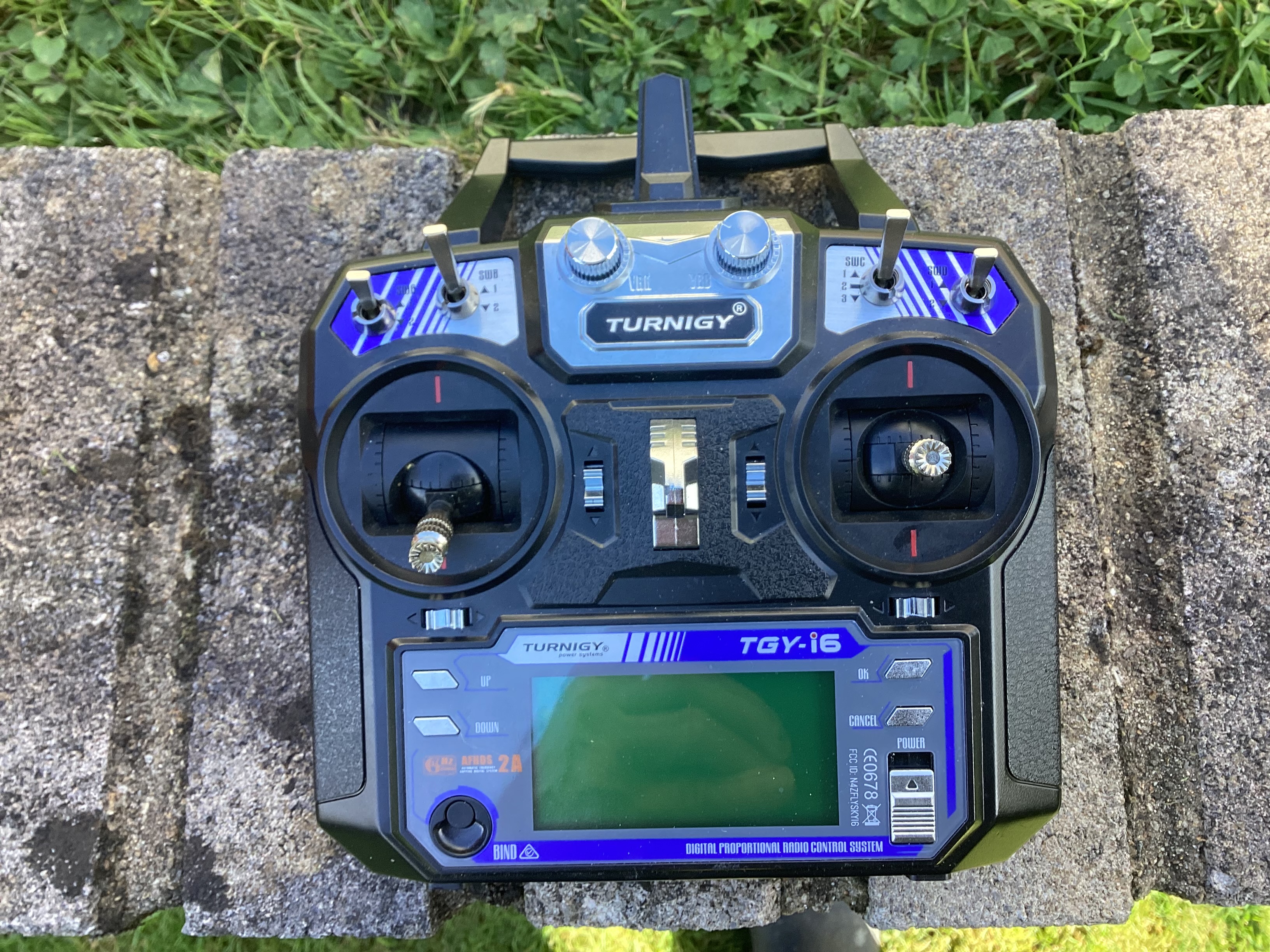

Anna came with the transmitter shown:-
The left hand joystick is the regulator, the right hand one does both reverser and simulated cylinder drain cocks and being sprung needs holding constantly in one of the four corners. I looked into replacing the R/C set up with something like the Micron ones I use for my battery fleet and then found a very helpful YouTube video explaining how one could assign the switches at the top of the transmitter to copy the joysticks. It took me several views but eventually I got the hang of it and have managed to program the reverser to the switch C and the drain cocks to D. This works a treat allowing single handed control most of the time. It is possible to program the transmitter to control a number of models, I did look at adding Russell in as another named model but am not sure whether this transmitter will pair with the receiver in Russell, which is a Planet one, and I find him easy to control with the Planet T5 supplied where the joysticks are not sprung and only two functions are used.
- Posts: 1833
Interesting what you've done with that transmitter Phil. I use the same one for my RC boats, I know it can do many more things, just haven't got round to exploring it all yet.
