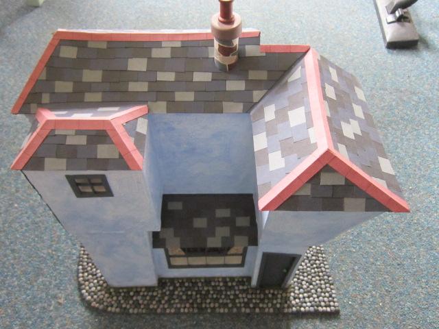

Post by Peter Butler » Tue Mar 31, 2015 9:38 pm
You might have noticed that I was careful not to show the roof on the antique shop building, mainly because I hadn't done it then!
The 'slates' are cut from sheets of art paper in three colours and laid individually, trying not to have too many of a similar colour too close to each other. At the moment they look too fresh but I will brush weathering powder on them which will tone them down.
The chimney is a block of wood with various colours painted to represent stone. Chimney pot is a wooden bobbin from 'The Works'.

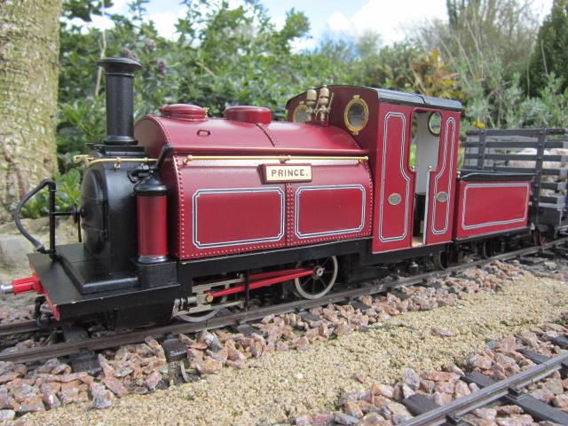

A very welcome visitor to the B.U.R.P.S. today was a newly built Slater's 'Prince'. This little locomotive is quite a substantial piece of engineering. The bodywork is not at all flimsy although detailed parts in the cab are!
The running was extremely smooth with RC and the pulling power quite impressive.

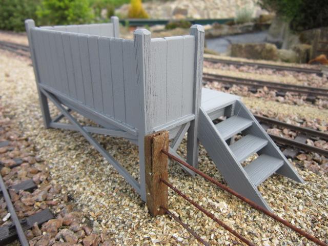

Lots of other work at home and our annual Club exhibition now behind us, time to concentrate on railway improvements!
One thing I have been meaning to make for quite a while is a coaling stage. Not much use having a steam loco without a food source.
I sat down yesterday and cut out the parts from Plasticard (of course) and laminated sheets together for extra strength. The deck is on legs with cross bracing and the back and sides are scribed to represent planking. There are steps for access from ground level.
[img]tp://gallery.myff.org/gallery/1880015/IMG_2813.JPG[/img]
That took about two hours and I am pleased with the sturdy look it has. Today (dry weather!) I was able to give a spray coat of primer

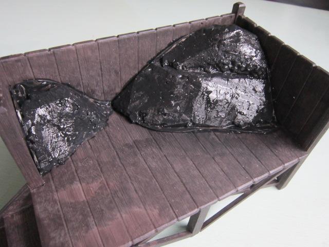

Thanks Philip, paint and grot has now been applied..... dark brown and black acrylic. Also, I have made a start on the coal heaps.
I know they look more like icebergs at the moment but all will revealed.
Each unit is made of Plasticard sides and base with polystyrene shaped and stuck with silicone to form a lump representing a coal heap. This is painted black and will finally be covered with real coal.

Post by Chris Cairns » Fri May 08, 2015 8:18 pm
That is brilliant Peter.
What do you use to scribe the wood effect on the planks?

Post by Peter Butler » Fri May 08, 2015 9:28 pm
Thank you Chris, for the planks I first use a razor saw which I push along in the grain direction a few times followed by a Stanley knife blade point to deepen some of the scores. Afterwards a rough sandpaper to remove the flakes and bits of loose plastic.
When this is painted the grooves tend to hold more paint and leave a two-tone effect which can be enhanced further with colour washes.
I'm hoping a spray matt varnish will give some weather protection.
The coal will be sprinkled on and given a coat of SBR to seal it in place. This seems to work well on my ballast.

Peter Butler:110691 wrote: The coal will be sprinkled on and given a coat of SBR to seal it in place. This seems to work well on my ballast.
Phew! I read down the thread from the top, looked at the pictures on the way down and panicked at the thought, "Noooo! Peter surely cant be satisfied with black painted polystyrene for coal, especially being in Wales!"
I'm glad and relieved to find that there is a finishing layer still to be applied. :lol: :lol: :lol:
