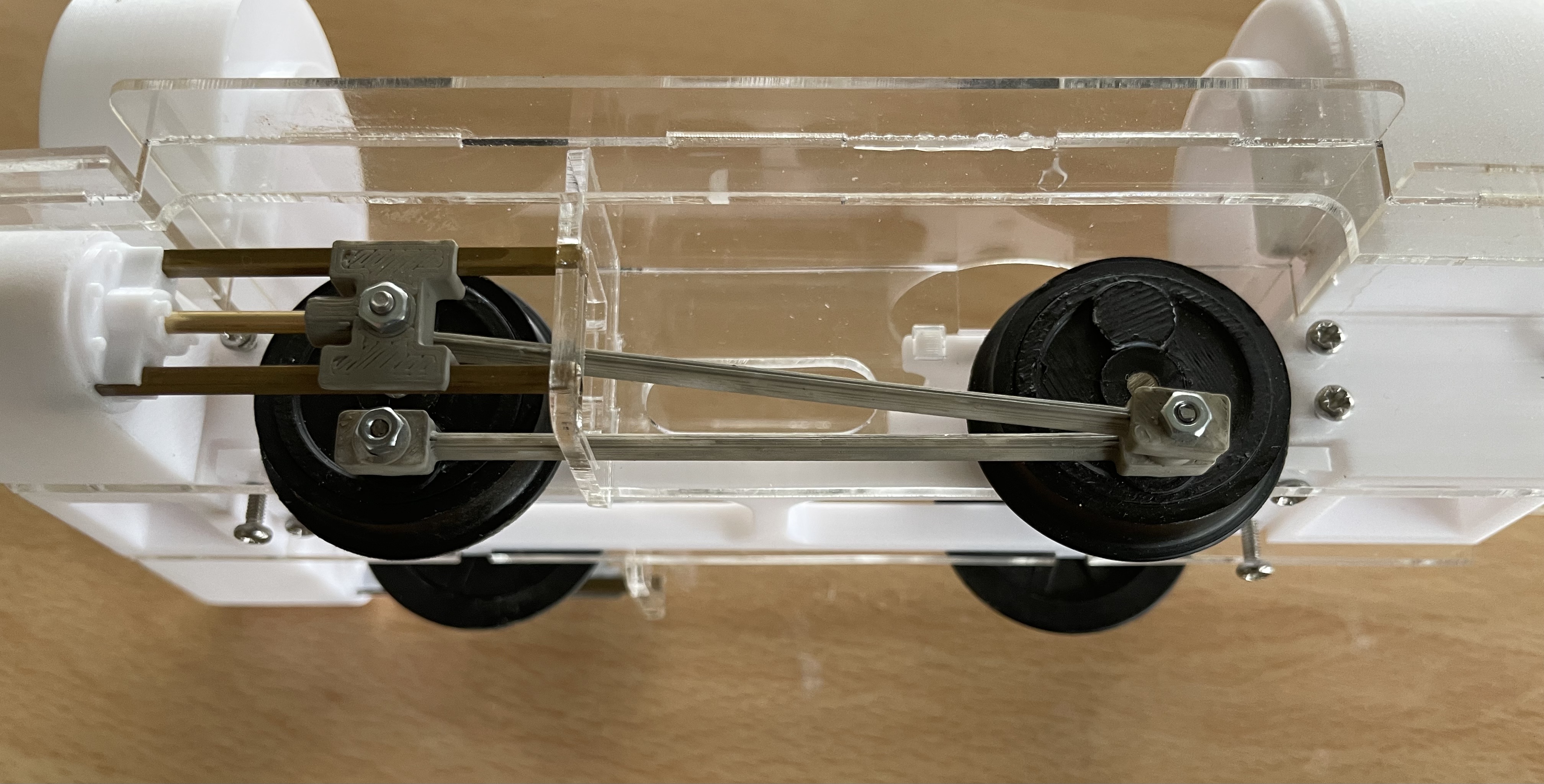

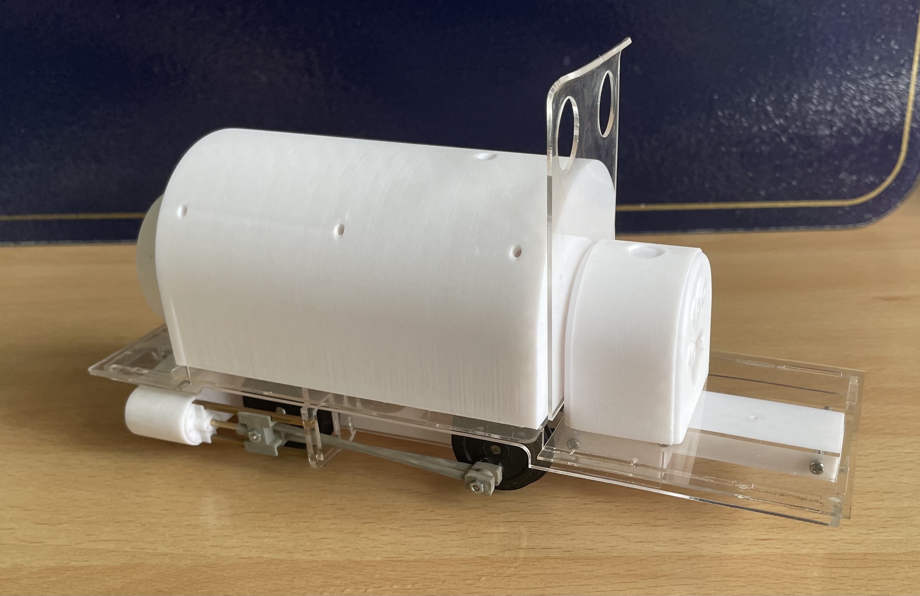

Post by gilfachphil » Thu Aug 15, 2024 5:24 pm
A little progress with Bakewell:-

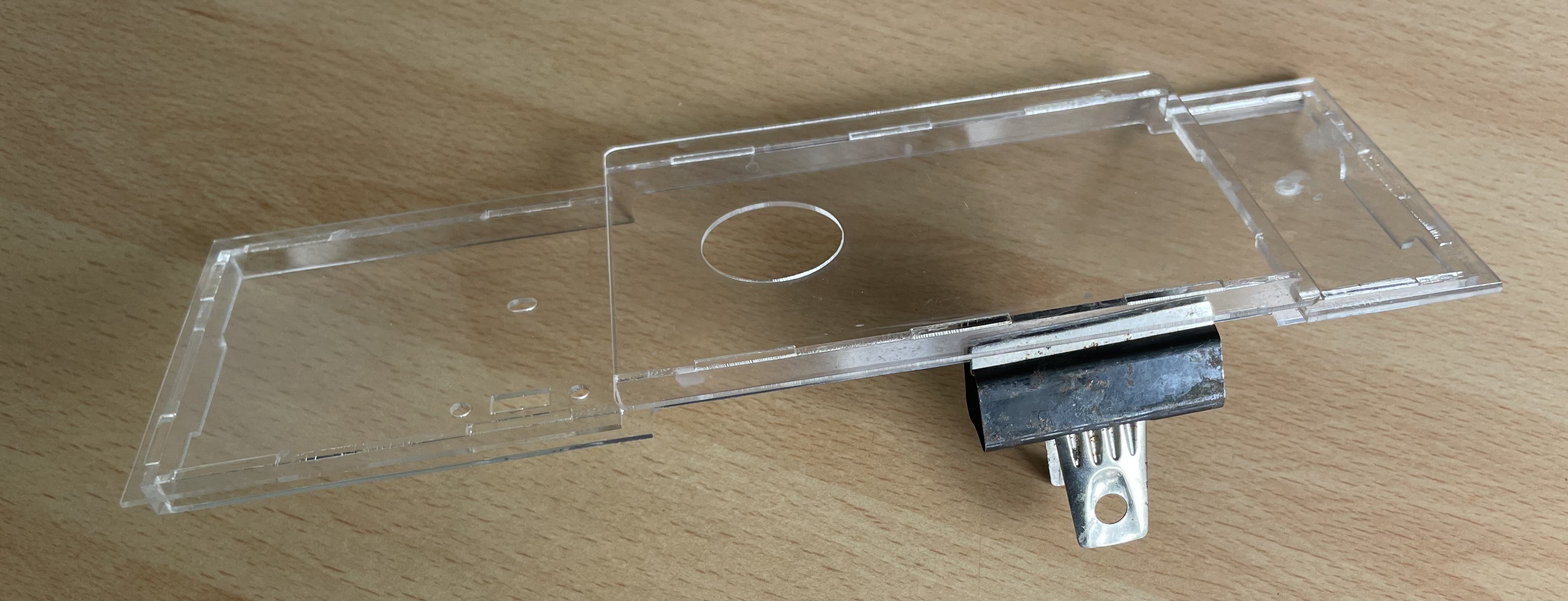

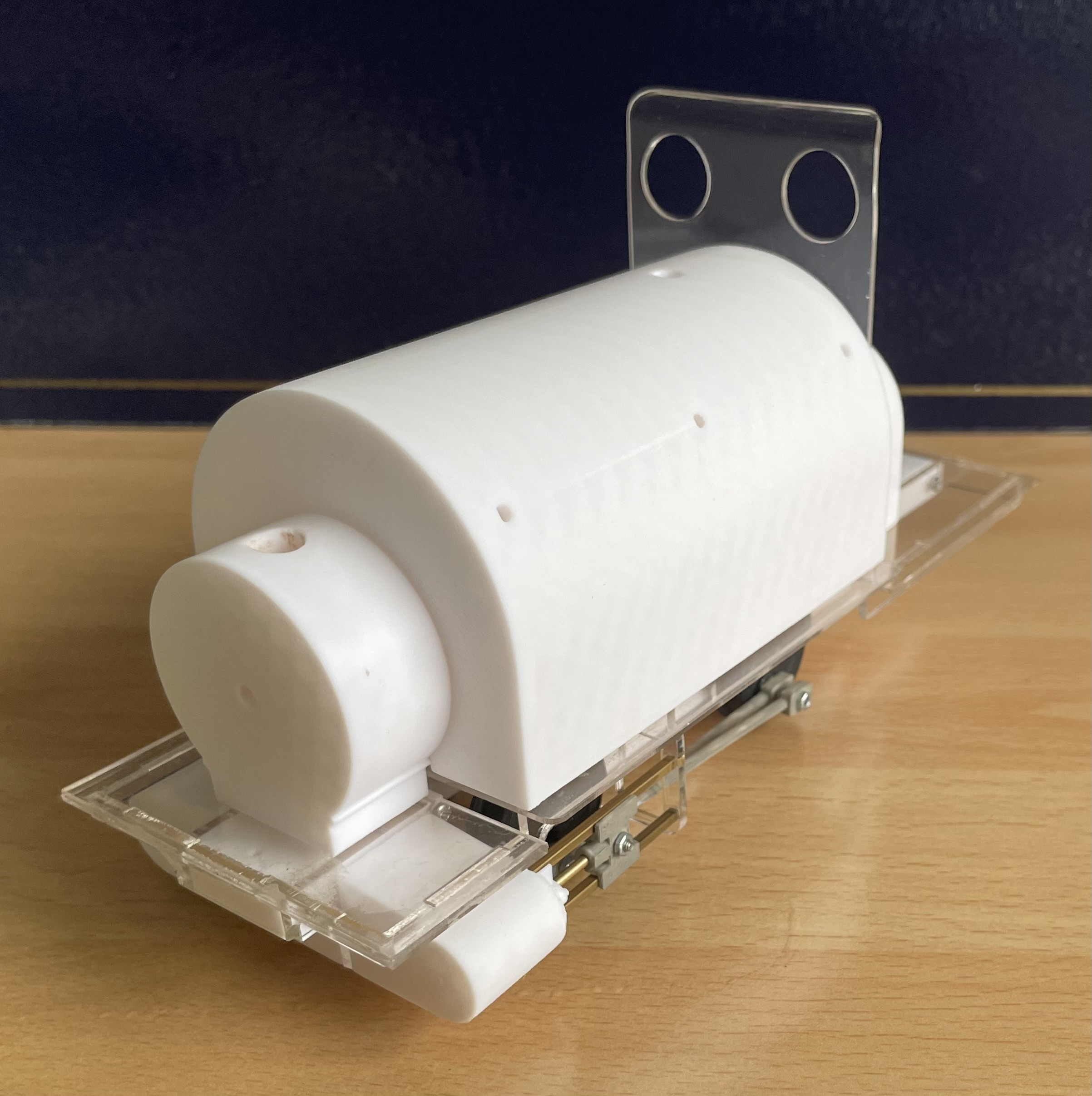

This is the footplate, it has an extra layer of side to go on each. There is a second layer of 1mm acrylic as the cab floor but this has the cab sides screwed to in from underneath so cannot be added at this stage. It is rather flimsy as it stands so I think I will glue it to the chassis once I have some paint on that. I shall have to mask the top edge of the chassis or it won't glue.
There is quite a lot of test fitting together to work out how best to complete the loco. The sample on display is very smartly painted and lined, such an intricate finish is beyond my skills so I am contemplating having the boiler and cab front sheet burgundy and most of rest of the body black. The boiler and cab front will be removable for access to the electronics and charging socket. The firebox and smoke box both screw to the chassis via the footplate, holding everything together.
The following pictures give a good idea of this. The observant amongst us will also spot wheels. See next post.

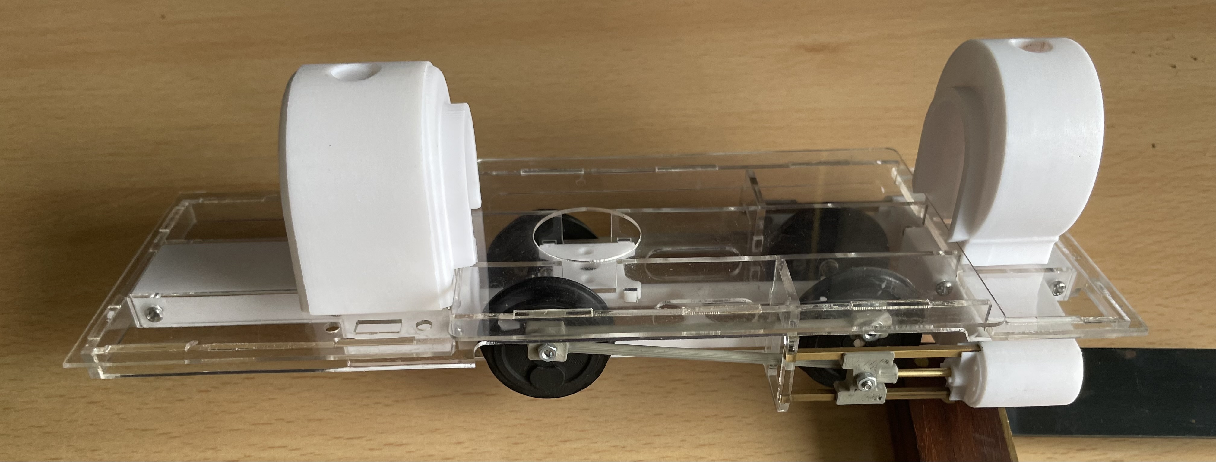

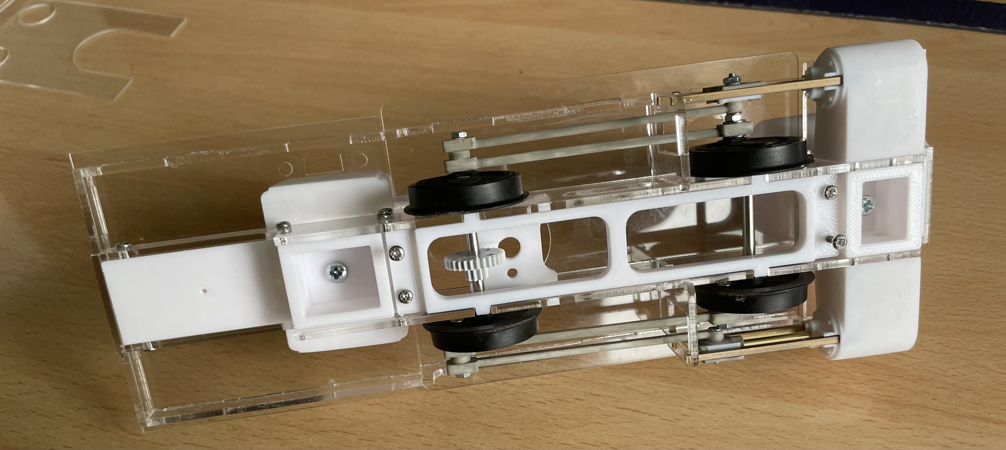

Post by gilfachphil » Thu Aug 15, 2024 5:38 pm
Wheels for Bakewell.
The kit uses Binnie spoked wheels and printed inserts which are a tight compression fit. They have a countersunk hole enabling a machine screw to be inserted from the rear for the crank pin. They are squeezed onto the axles, not forgetting to add brass bushes beforehand, adjusted for back to back and the crankpins aligned at 90 degrees to one another to give the quartering. This is a clever feature of these kits.
The connecting rods and crosshead were painted with grey primer. They are assembled onto the crankshafts using a plastic sleeve around the crankshaft, this is cut to length to protrude slightly beyond the one/two rods, and the nut can then be tightened gently against the sleeving, leaving a little thread clear for later application of thread sealer of some sort.
At this point the chassis should roll nicely, it does! The crank nuts unscrew very easily so this rolling test should be made on a clean surface so as not to lose any.
Here are views from the side and underneath:-
The pictures show what I intend to paint black, a few more parts to be added above footplate level. In order to do this the wheels have been removed, there is a keeper plate holding them in but there also needs to be disassembly of some of the conrods because they pass through the cross head slide bars support piece.
It will be much easier to get the cylinders painted with the footplate removed.
It's all a bit of a 3D puzzle to work out the order of painting.
More to follow. It was wet today so indoor work took place, more platform scribing tomorrow I think as it should be a lovely day again.

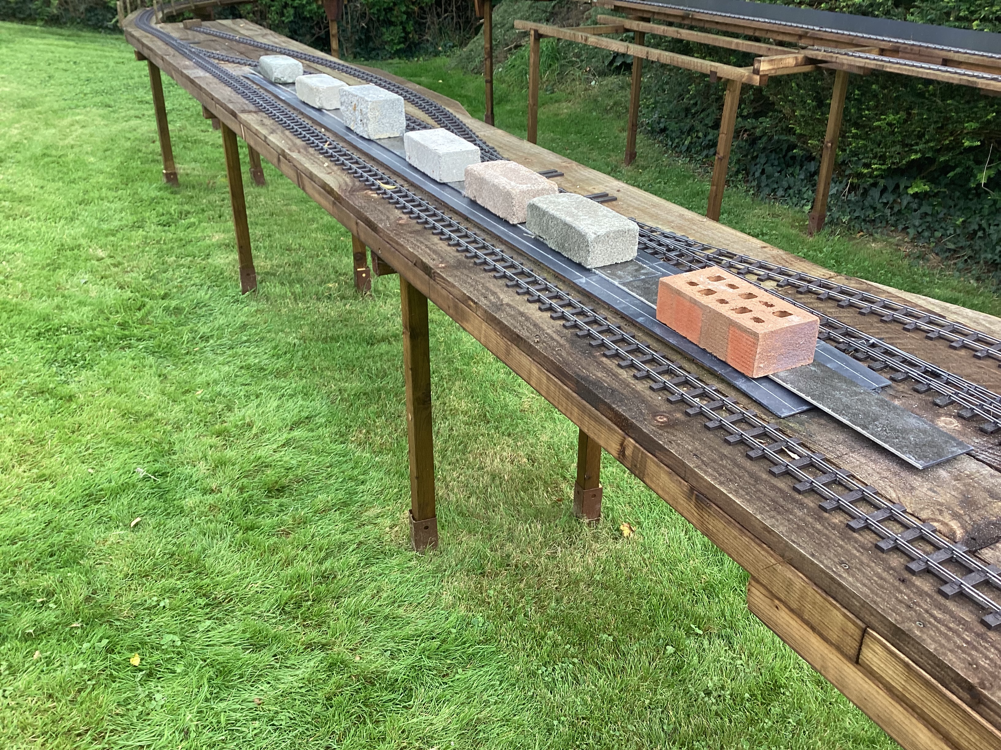

Post by gilfachphil » Fri Aug 16, 2024 5:39 pm

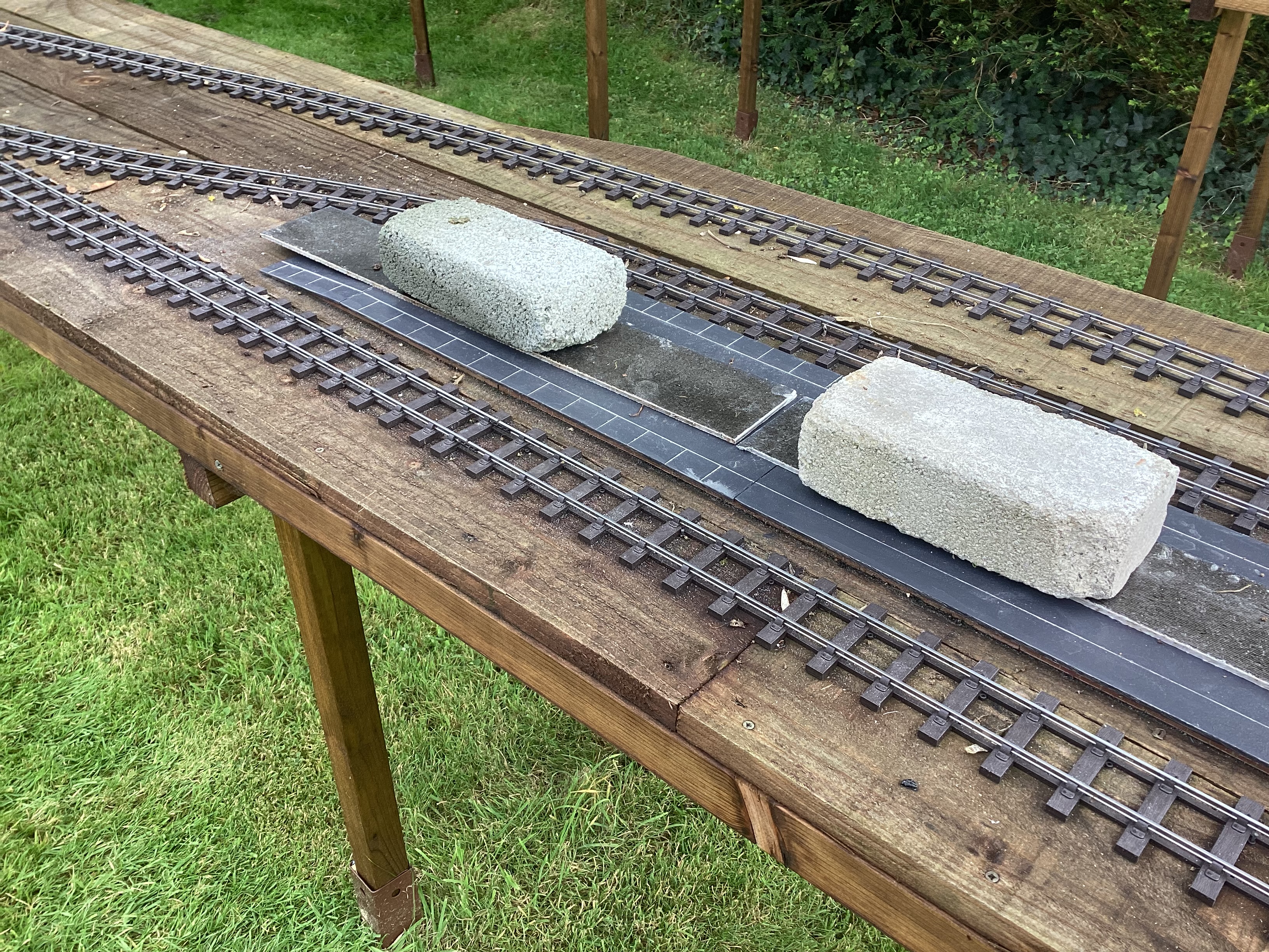

Shopping trip this morning, one item I collected was a tube of grab adhesive from Screwfix.
Outdoor work this afternoon. I scribed the longitudinal lines on all of the platform pieces and did the cross lines on the curved end (mostly) whilst doing which I decided it would be easier to do the rest once the slate was glued down.
At close of play the situation is:-
The full length, all now glued and weighted whilst the glue sets
The curved end with stones marked along both edges.
I painted all the cut edges with dark grey masonry paint. This is also much easier before the cross scribing is done which can easily be partly filled with paint.
Rod, I thought about the random slate idea but since each scribe line takes several strokes of the scriber following your suggestion would involve many errors!

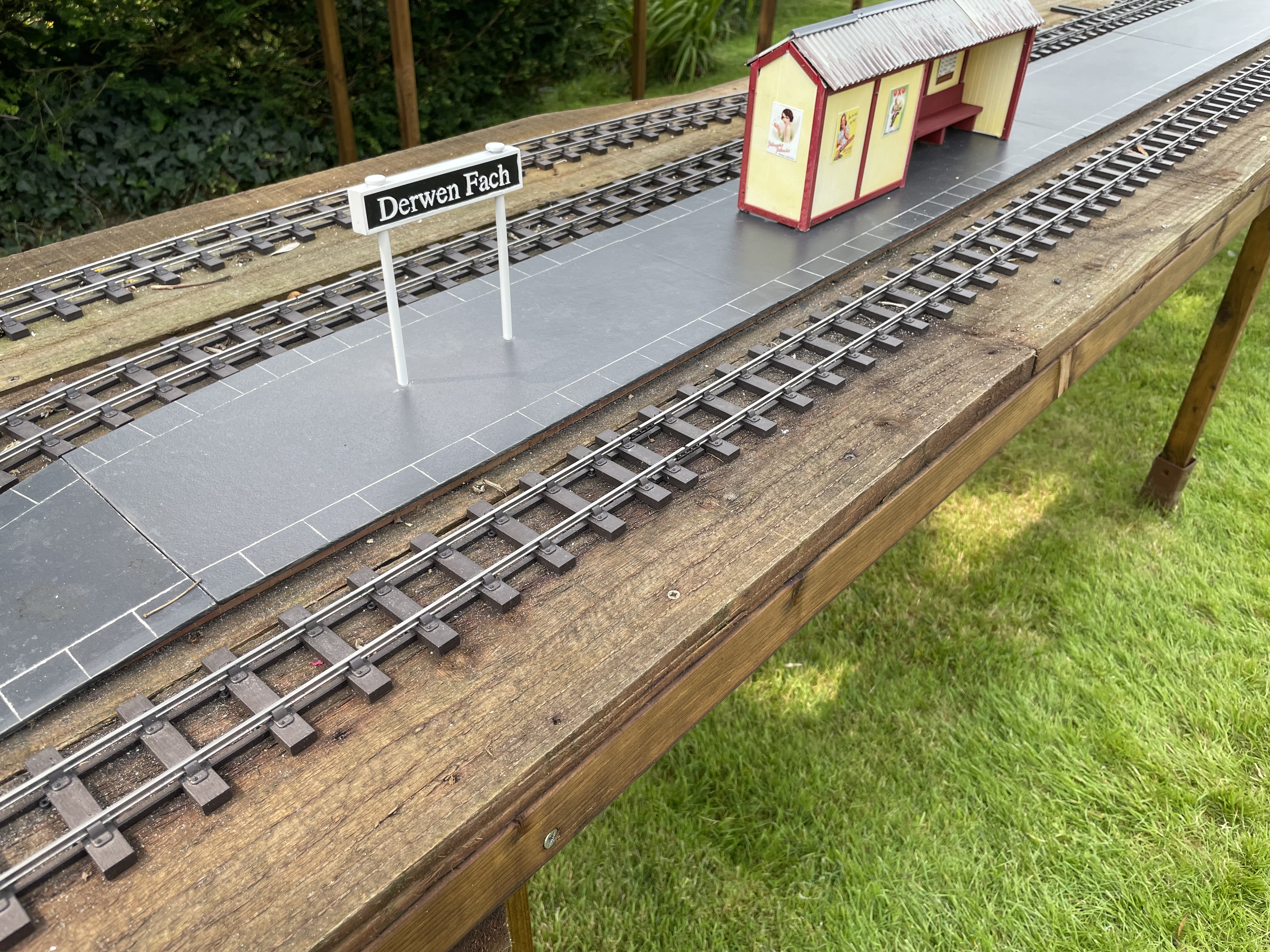

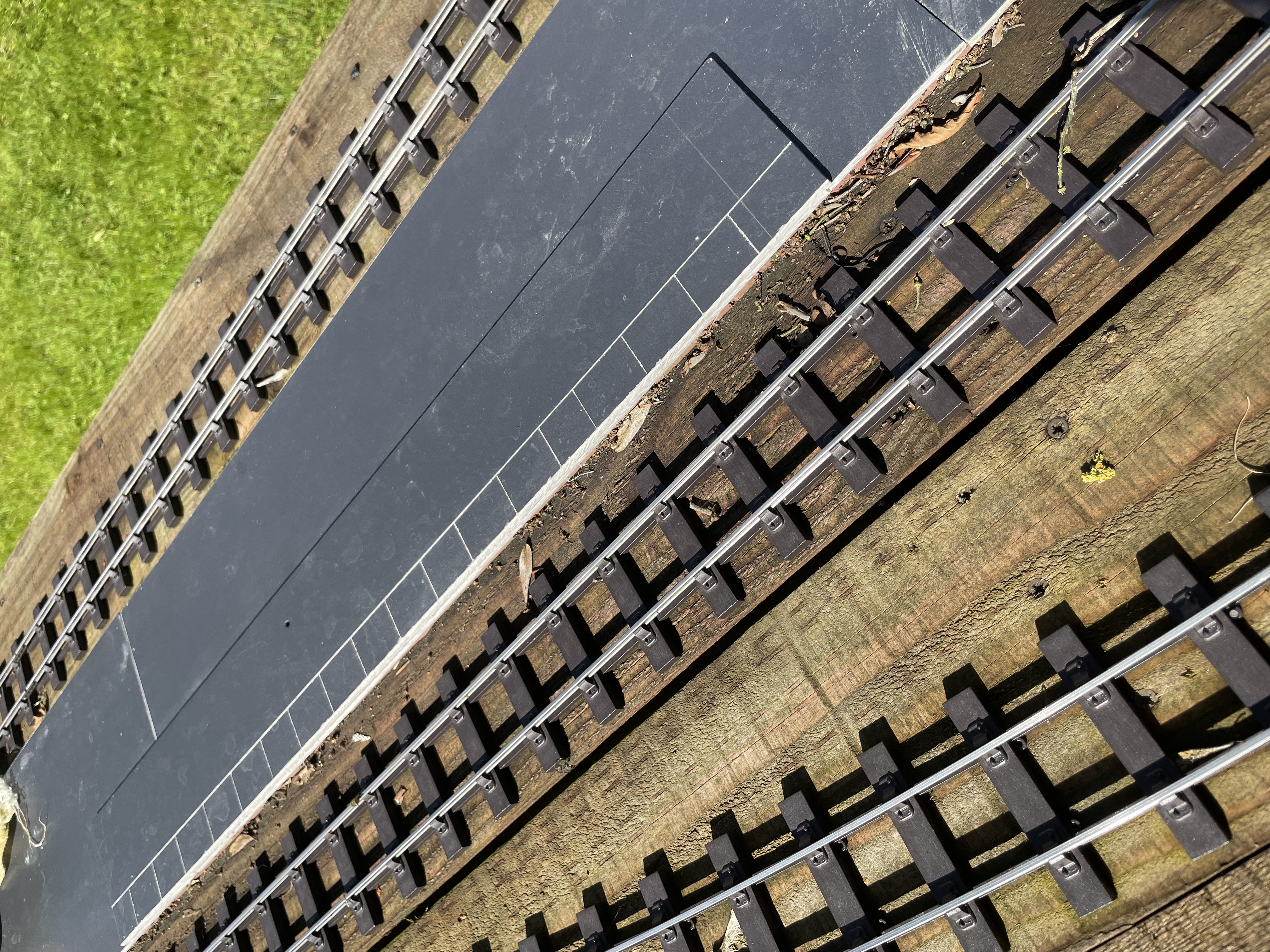

Post by gilfachphil » Sun Aug 18, 2024 1:47 pm
How about this?
Posts: 5671
Post by Peter Butler » Sun Aug 18, 2024 1:55 pm
Just the job Phil. Very tidy, and permanent!
Posts: 5929
Post by philipy » Sun Aug 18, 2024 2:17 pm
gilfachphil wrote: ↑Sun Aug 18, 2024 1:47 pm How about this
Cracked it!!
That looks good Phil
Posts: 7768
Post by ge_rik » Sun Aug 18, 2024 3:21 pm
Very neat.
