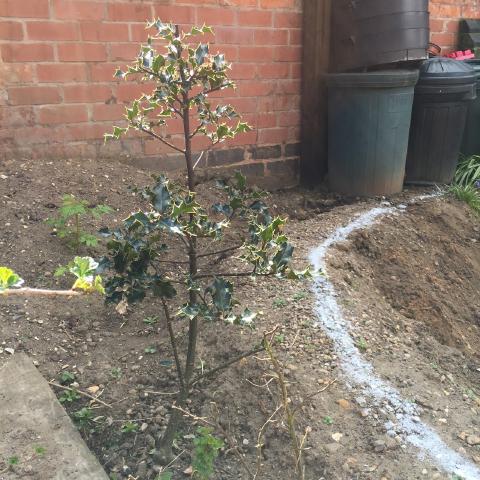

On the edge of the railway a small self set holly tree was already growing. I've decided to try and prune this into a (large) miniature. It's a long shot as it's really far too old to try miniaturising but there's nothing to loose by trying. At least it feels like a positive step and a first piece of my 16mm world!

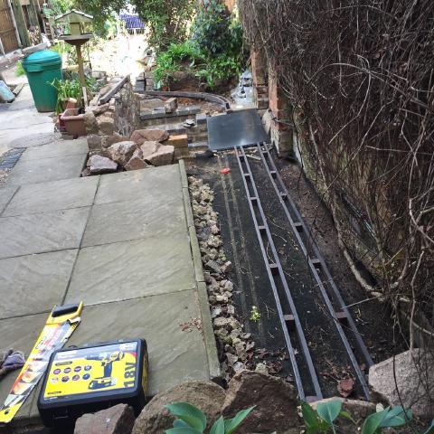

Well, progress indeed today. Filcris componenets have been assembled and a start made on installing them. This is only scratching the surface and some significant ground works will be required before I can progress further. These works involve the breaking out of more concrete (the hardest stuff I've encountered so far!) some wall demolition and, most disruptively, the demolition of some of the temporary pathwork that I put in at the end of last summer to avoid a Winter wading through mud! This will mean some very temporary surfacing whilst this section of line is completed. For that reason I need to have all my ducks lined up before I start. I need to keep this phase as short as possible. I have to construct the branch first (rather than the circuit in the main garden) as it has the most severe gradient (1 in 50) anywhere on the system and will set the level of the garden loop.
This is the station site, looking from the buffer stops out towards the rest of the garden. You can just see the line curving away to go round the honeysuckle arch. the main circuit will be in the garden beyond.

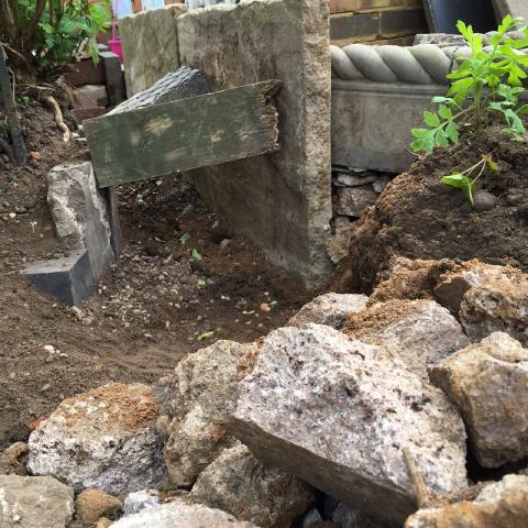

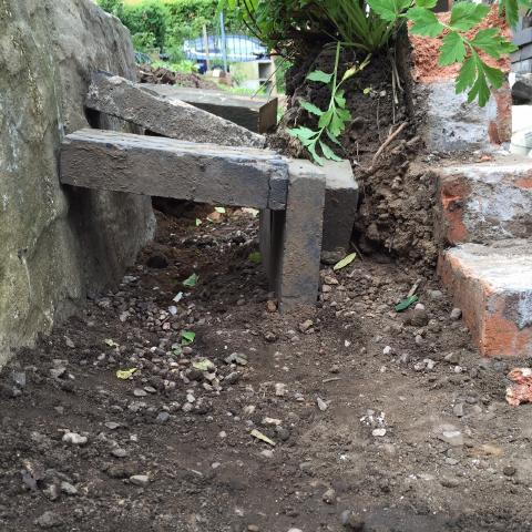

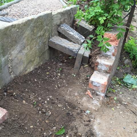

I've been working on the basis of the branch from the top station passing through a tunnel to get it under the 'pinch point' where the main path squeezes between the corner of the wood shed and the archway over the old path sloping down into the lower main garden. Once I began building up and installing the Filcris road bed I began to see that a tunnel was going to be tricky.
I was intending to use S&T cable troughing as the tunnel structure but the only stuff I could beg off the GCR S&T lads was 1'-0" deep and 1'-6" wide. This would mean the path being quite high and to maintain even levels would need two units side by side. The units are 1.0m long and so long enough in themselves for the tunnel but being straight meant that the railway would need to curve round to the tunnel mouth in the open. This would cut right into the already narrow path and create a significant hazard.
I took some levels yesterday to work out how the line would cross the top of the old slope (which I need to maintain as an access to the bottom half of the garden). These levels revealed that the line would be so high at the location where it was planned to go into the tunnel that the path would have to be raised (with a step) by at least 4", right at it's highest point and in an area where I really wanted to lower it by the same amout. Neither do I want a step in the path. This confirmed that a tunnel was not an option.
I realised I needed to come up with a way of squeezing in the path and a railway cutting through the narrow space available between the outbuildings (leaving room to add an additional building off the end of the current row) and the wrought iron arch carrying the honeysuckle over the aforementioned slope of the old path. Just to make life interesting one of the honeysuckles is rooted in the same space and I really didn't want to dig it out to replant it; I would have had to cut it off at ground level and loose years of growth. Some VERY careful measuring ensued and I decided I JUST had room to use some old blue brick pavors on end to line the cutting on one side and some stone effect concrete slabs on edge to line it next to the path and to provide a little bit of an upright barrier between the path and the railway cutting. I think it's going to work out ok, the intended dimensions have been achieved. I didn't manage to extend the Filcris bed through the cutting area today though, as I ran out of time.
The bricks and timber across the cutting are only temporary! They are keeping the walls apart until everyhting is firmly bedded in place. The cutting looks deep enough to have been a tunnel in these shots but is actually much deeper than it's intended finished level by about two to three inches. It has been over dug to allow room for the Filcris road bed to go in with some clearance on it's underside for 'tweaking' levels.
