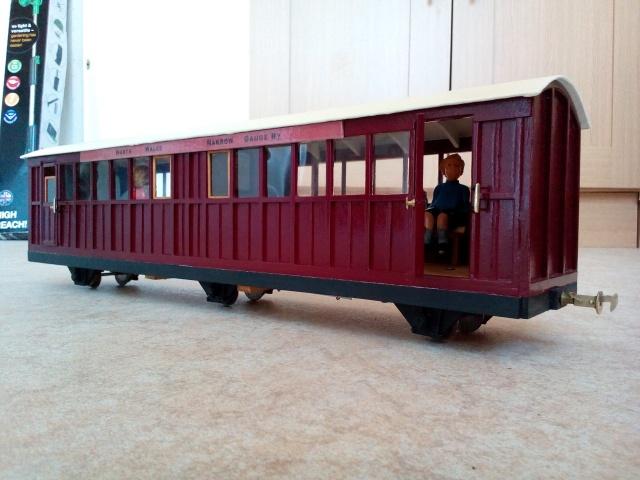

Hi all.
Update over the weekend.
Nearly there.
The poster is a reproduction of the only NWNG poster I could find, in the book ' MORE ABOUT THE WELSH HIGHLAND RAILWAY. The poster is dated 1896 and advertises tickets from Dinas to ( Snowdon) station.
"Conveyances to Beddgelert meet all trains at Snowdon Station and passengers should secure Cheap Return Coach tickets at that station. fare 1/3d.
David
Nearly there.
David

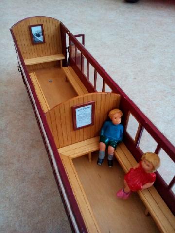

Hi David, sincere apologies for not commenting on your carriage build but I have been awestruck throughout its construction method and your patience and determination to get it right. It is a remarkable piece of work which you can be proud of... I wouldn't have attempted this myself as I prefer to work in Plasticard and that might be a task too far for a vehicle that size. Congratulations.
- River Lin
- Posts: 411
- Location: Leicester
Thank you both for those kind words. It has taken a long time though. Looking back I seem to have started it early last summer.
One problem I have come across is that with the roof not being glued on, the body is quite flexible being made primarily of 3mm square timber and glazing matertial above the waistline and only supported at the ends and the central partition. I have to be careful how I pick it up and not squeeze it. The best way is one handed in the middle or two handed at the very ends.
It has been an enjoyable project and I can't wait to try the coach on a garden line next Sunday, with my other homebuilt NWNG/WHR stock, as I don't have one of my own. Hopefully the weather will pick up again.
Pictures will follow.
David.

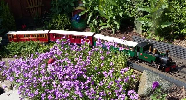

Yes please! I'm sure they'll be a sight to behold, it's a lovely carriage.River Lin:117948 wrote: It has been an enjoyable project and I can't wait to try the coach on a garden line next Sunday, with my other homebuilt NWNG/WHR stock, as I don't have one of my own. Hopefully the weather will pick up again.
Enjoy your maiden run!
PS Next time you're at The Signal Box do let the owner know that his old "Russell" is still going strong and being very much enjoyed! I bought it from him at Peterborough about 5 years ago...

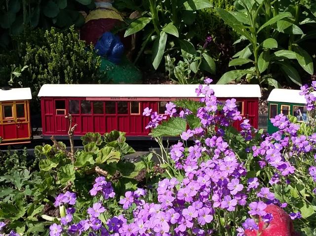

Hi all.
There's good news and not so good news!!!
Firstly the carriage looked lovely in the afternoon sunshine on the Disney Bridge Railway.
But.
She misbehaved a couple of times on this particular curve (not a tight curve) and decided that instead of being towed she would rather walk and put her wheels into the two foot.
On an inspection underneath, not very ladylike but it had to be done, I found the following -
It seems that for some reason the end bogie turned too far and allowed the wire strut to become detached and caused the carriage to jump the track. I suppose teething troubles occur and need to be sorted.
So I have made a start on the folloiwing-
Fit longer wire struts.
Use thicker and stiffer wire for the struts.
Fit stops to limit the turning of the bogies beyond a certain point.
Remove some of the play and 'loseness' of the bogies.
Any other thoughts please share. Overall though, I am pleased with the carriage.
David.
