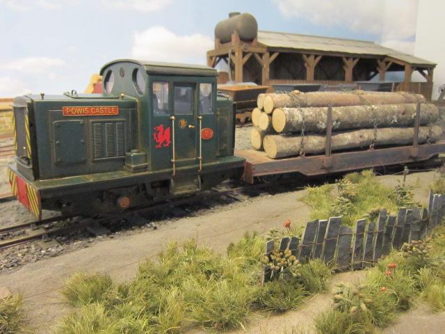

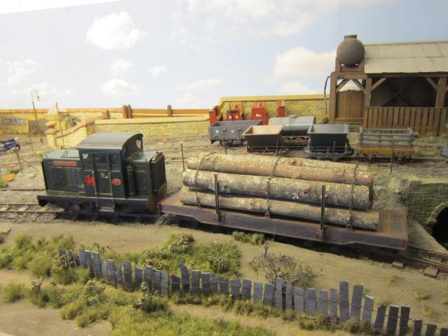

Today I put the loco in a working environment and I think it fits in quite nicely!

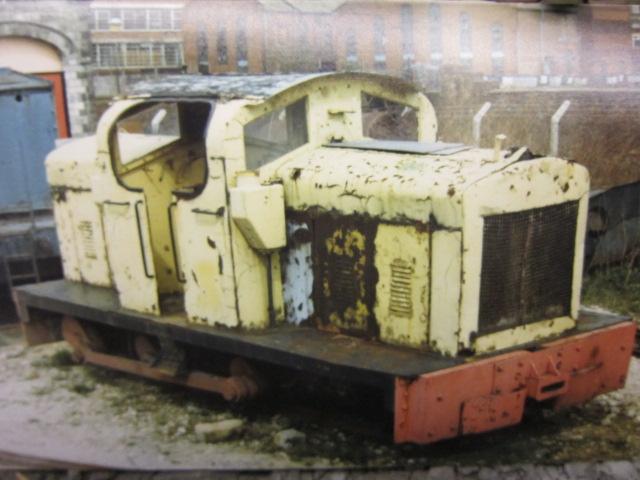

I also found a photograph of a similar locomotive which I saw at some point in preservation. Unfortunately, I can't remember where I saw it as it must have been 20 years ago, but even at the time I was clearly impressed with the type. I'm sorry if the image is not perfect as this is a photo of a 35mm photograph.

That was one of the Fowlers at Butterley - they were stored near the fence beyond where the garden railway now is. That picyure, however, was taken at Armley Mills in Leeds - look at the background!

Another splendid job Peter. I do like the wethering, nothing like a bit of grime.

I'd completely forgotten that Brian. Weren't there two of them? Any idea what's happened to them now?

Thanks for the comments about the weathering Jim, and for the benefit of Bazzer 42 it was done after applying a thin spray coat of Windsor and Newton clear matt varnish, then a rust colour of acrylic paint applied by a fine brush with the right hand (as I am right handed) and immediately softened with a larger brush held in the left hand so that it is not allowed to dry before being worked.
Finally another finish coat of the same varnish and job done!
The varnish is made for the fine art market but is suitable for this purpose as it can be removed with white spirit and has no adverse effect on acrylic rattle can paint.

There were two at Butterley at one time - one had been stripped for spares so was scarpped - the other one is the one you photographed!
