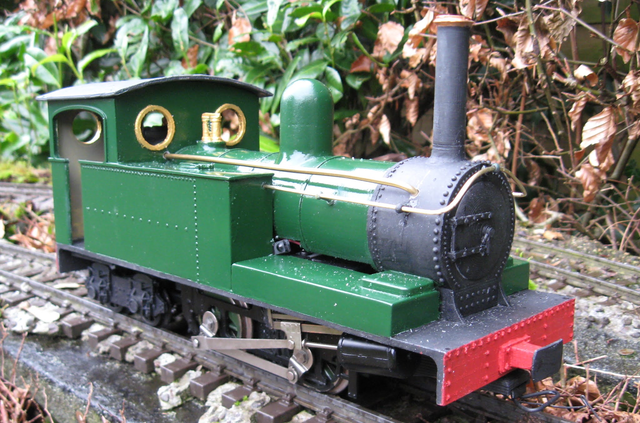

ge_rik wrote: Tue Jan 27, 2026 11:46 am A bit more progress. Not finished yet, a few more details plus a final rub-down, top coat and varnish. Also, awaiting the delivery of some 18650 cells to do the electrics
At present, she's very tail-end heavy - the balance point seems to be just ahead of the rear drivers, so I'm going to have to be judicious about where I put the weights. I can't help wondering if the real loco would have been a rocky ride for the crew. She's crying out for two-wheel bogie under the cab, but the original was without.

tommygander1941 wrote: Mon Mar 09, 2026 4:17 pm
I've only just noticed Rik, that it has the smokebox door opening to... the left :o
Oops. No photos of the front of the loco so it was a guess. Maybe a wrong guess..... 😲🤥

ge_rik wrote: Mon Mar 09, 2026 5:57 pm
Ah I see, well most of the time locomotives had the door open to the right, seems like a typical Manning Wardle smokebox otherwise. Matthew Murray is a good reference :D
Posts: 1716
Re: Any ideas as to the origin of this loco?
Post by GTB » Tue Mar 10, 2026 1:39 am
ge_rik wrote: Mon Mar 09, 2026 5:57 pm Oops. No photos of the front of the loco so it was a guess. Maybe a wrong guess..... 😲🤥
Some John Fowler & Co locos have the hinge on the left, as do their traction engines.
Things are different in the freelance universe......
Maybe the PLR loco needed a heavy overhaul in the late '20s and Manning - Wardle had closed, so Fowlers got the job and it came back with a l/h smokebox. 8)
Posts: 8003
Post by ge_rik » Tue Mar 10, 2026 7:36 am
GTB wrote: Tue Mar 10, 2026 1:39 am
Thanks Graeme. Good to know there's a possible plausible explanation.
The door was printed as a separate item and when I came to glue it on, it somehow looked better to my mind's eye hinged on the left. I wonder how many front end shots of locos I've seen over the years and never noticed the orientation of the smokebox door hinge. Mind you, I sometimes mistake right and left, something I inherited from my mum.
Posts: 8003
Post by ge_rik » Tue Mar 10, 2026 10:10 am
Just cast my eyes over my loco collection and found another loco where I'd hinged the smokebox door on the left. My sort-of Naismyth & Wilson (ish) loco based on one which ran on the Schull & Skibbereen Railway.
Darn it! I thought, this is becoming a habit. This too was constructed based on photos.
But..... wait a second! One photo of the original loco shows its smokebox door hinged on the left (unless the photo has been flipped)!
Vindicated (for this loco anyhow).
