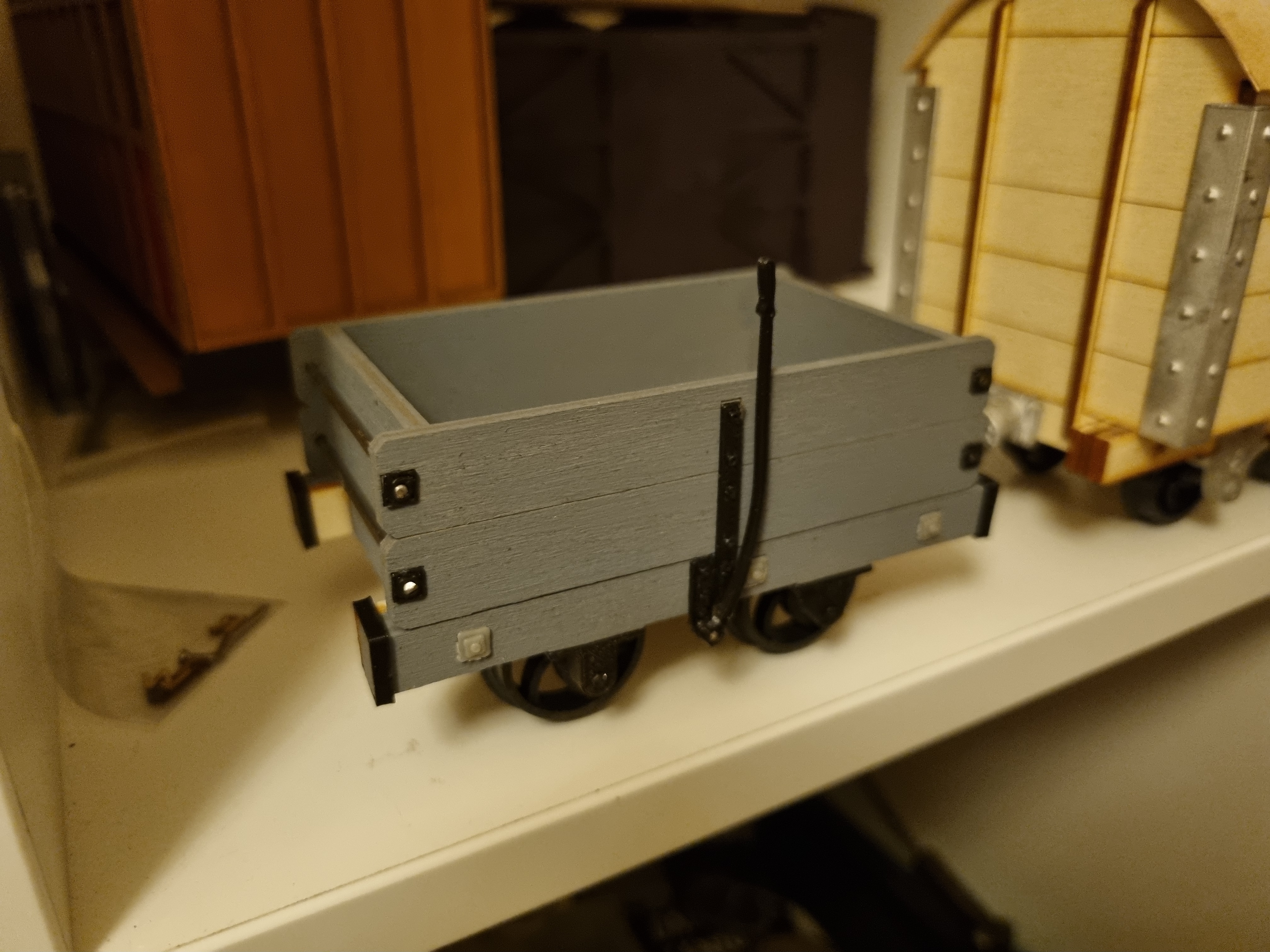

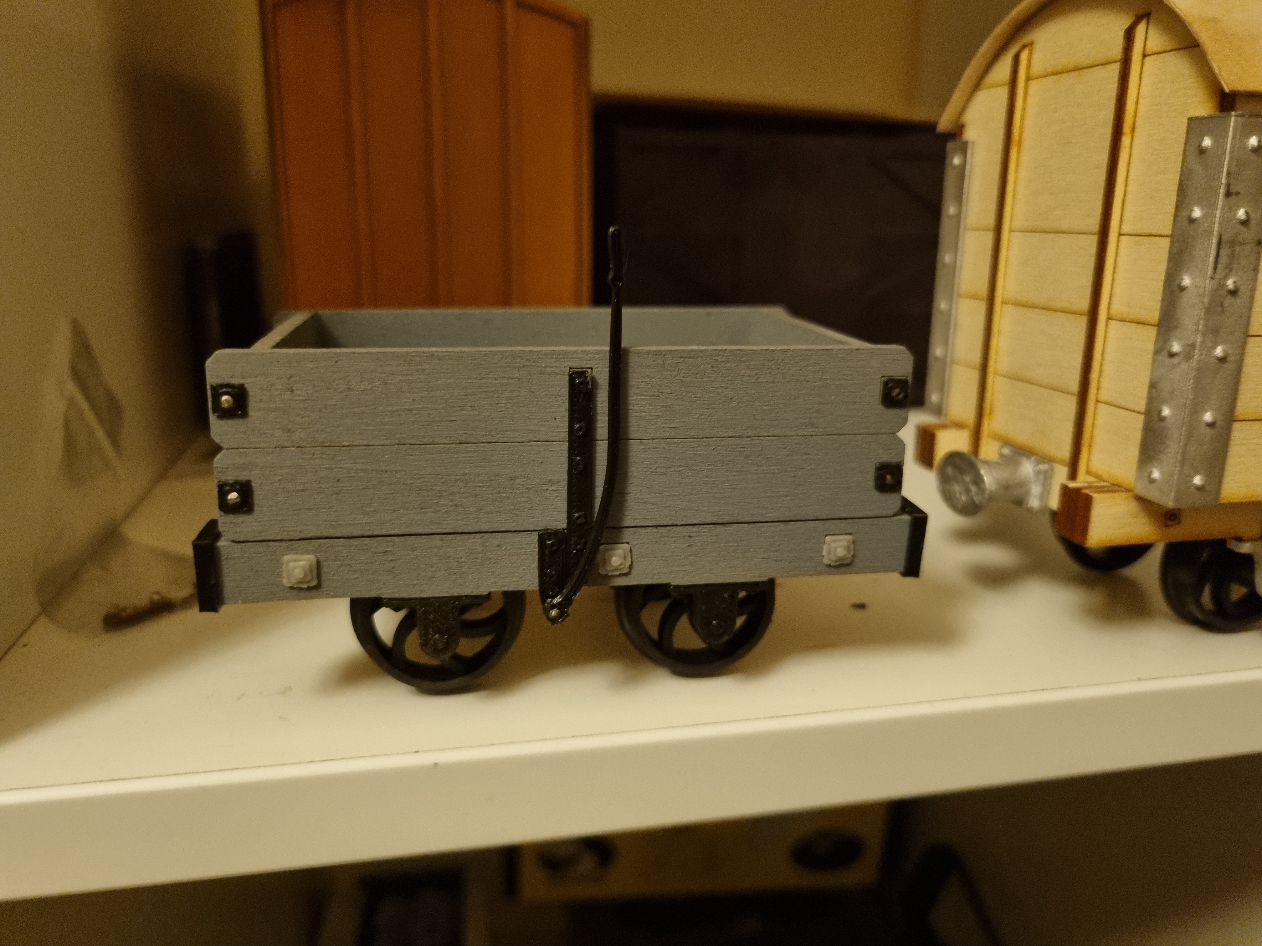

I knocked this up on recently which is a Aberllefenni wagon from IP Engineering. Easy kit to make & a nice little prototype.
I will finish it off with a few more bits of paint then a subtle weathering to finish.

What a lovely little wagon, and nicely built too.

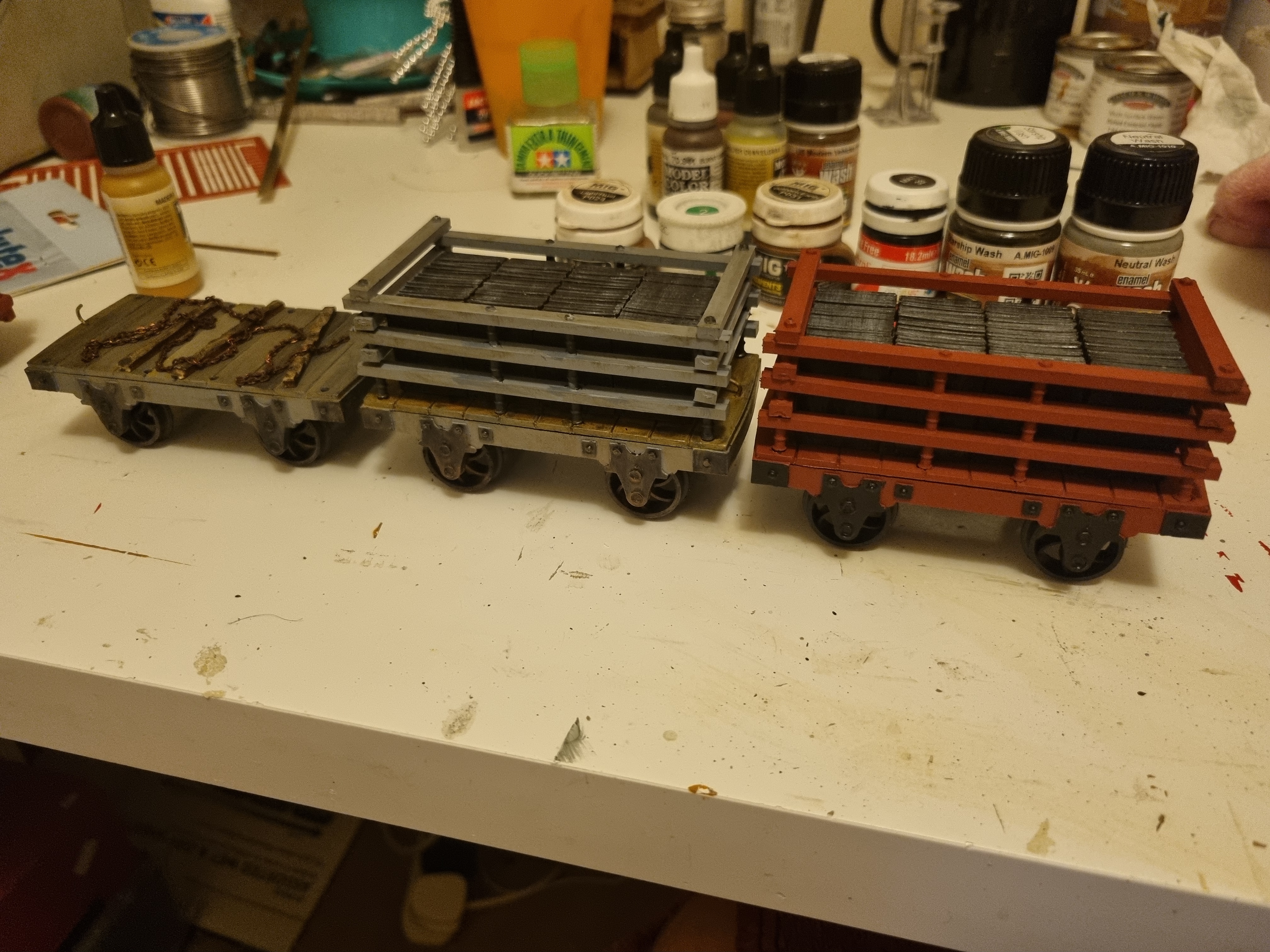

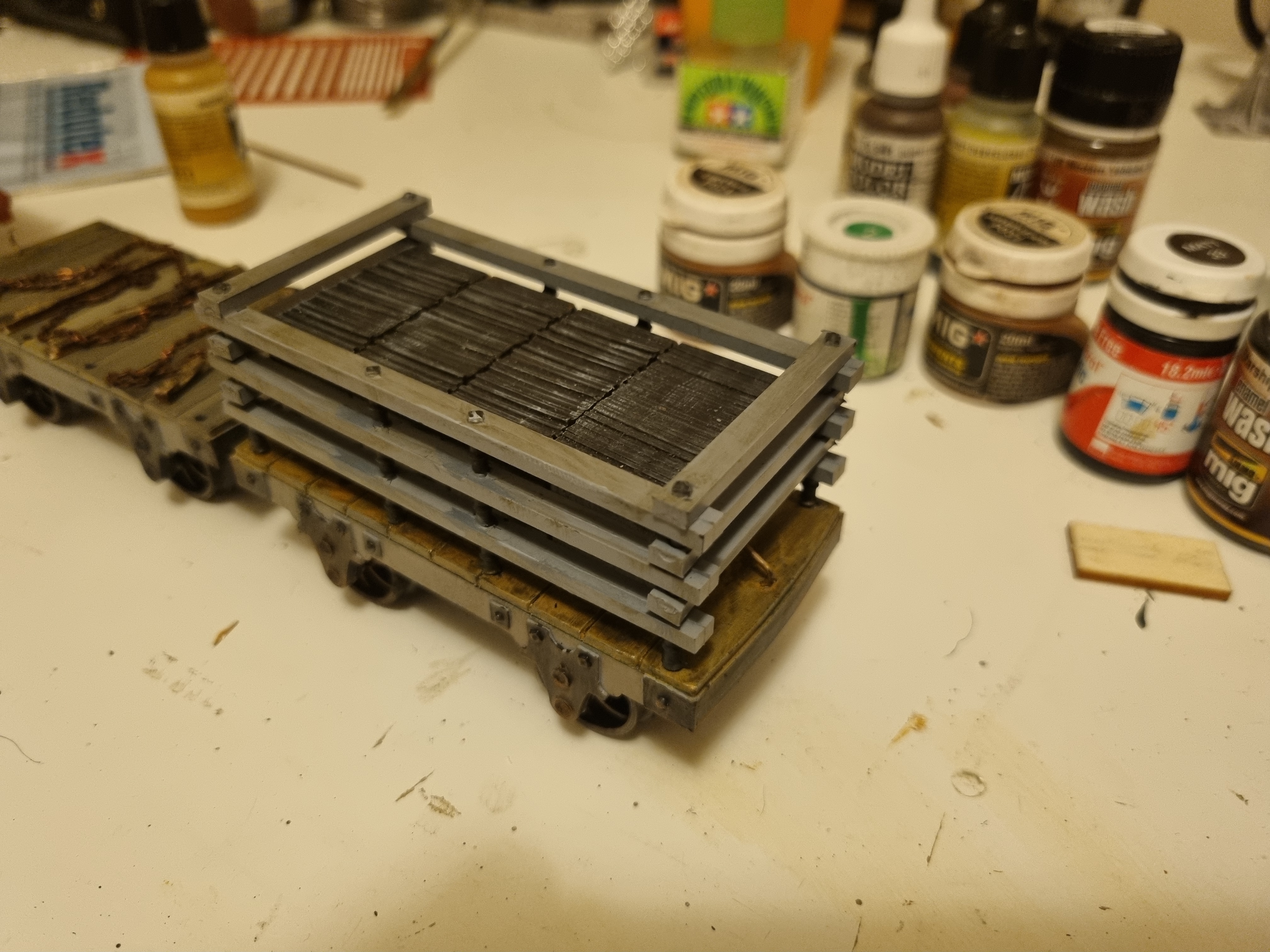

My wife this evening wanted to study for her course so I have made a start on bringing the binnie slate wagons to life.
I have 6 in total, so I took out a red & a grey painted wagon. Both have been treated the same with basic halfords primers.
The whole rake was assembled & painted a good few years ago so I think the primer has hardened off.
I painted all the blackwork on both wagons & then used the same techniques I used on the slab wagon to weather the grey wagon I had selected. I've done it a little different to give variation.
I've ordered some trenarren models slate loads to complete the rake & I'm now going to chip away at the rake a wagon or two at a time until this rake of wagons is complete.
I've a good selection of live steam engines but I think Lilla looks great with this rake of slate wagons. I'm looking forward to seeinging them complete on a sunny day.

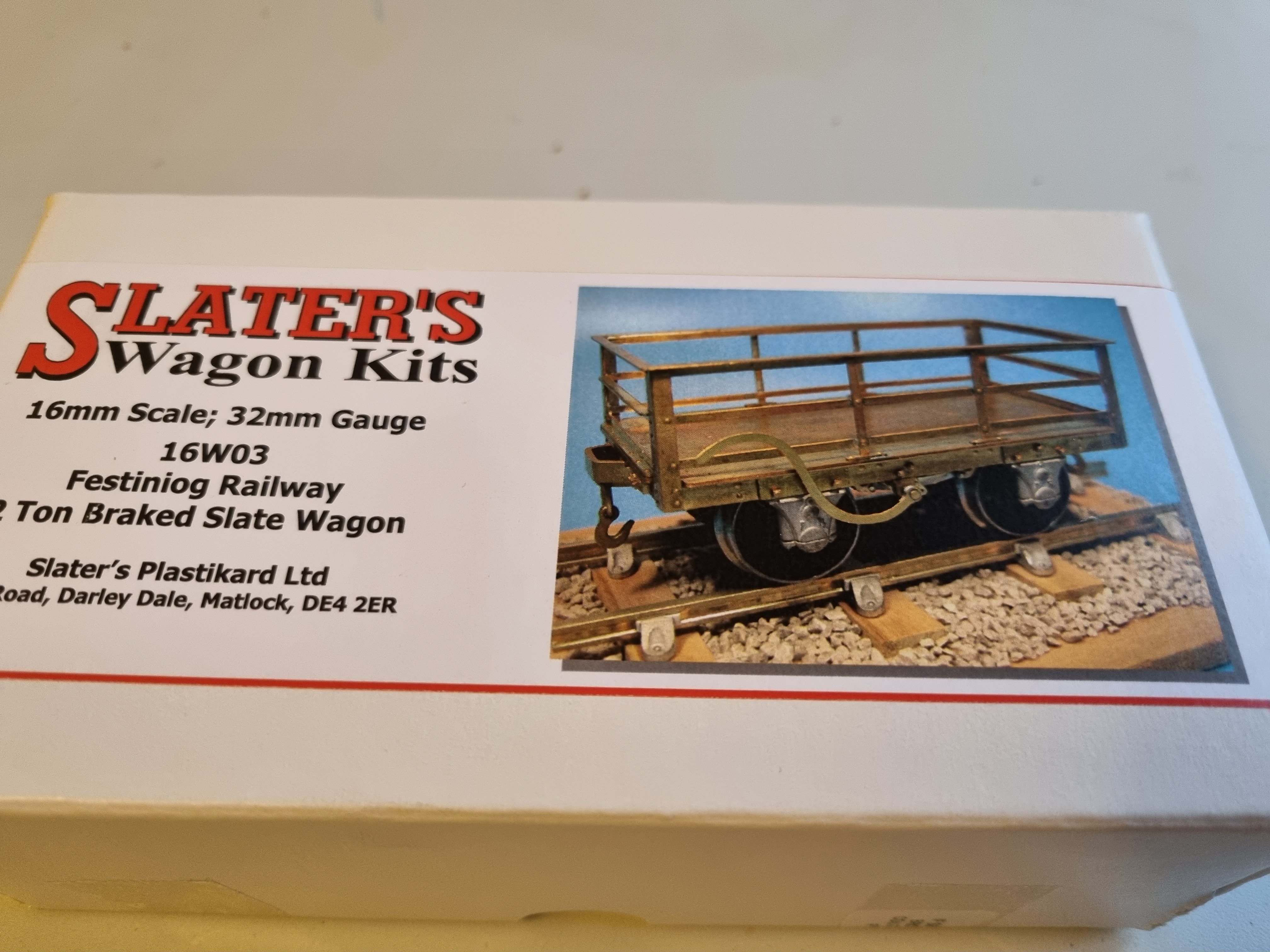

A new arrival today for the fleet. These go together exceptionally well, I do enjoy slaters kits, I enjoy making etched brass kits too I just don't have the time I once did. Wagons thankfully are easy, the plan is to do a slaters Alice class hunslet when winter arrives again.

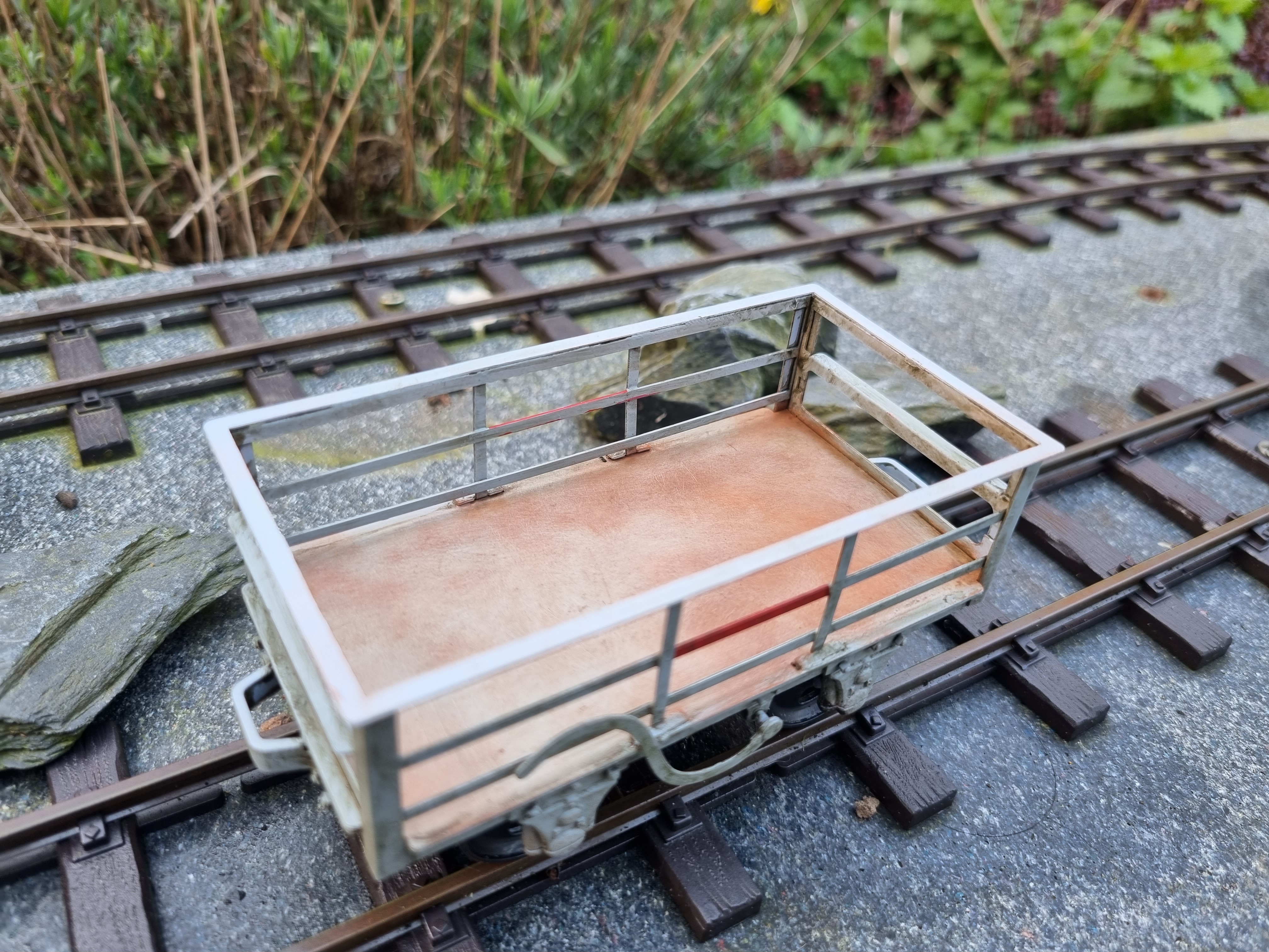

I've had a few sessions on the Ffestiniog slate wagon & got it to a stage where I am now painting. I didn't really take many pictures during the build. The other one I have to make I will document a bit better.
I got home from work early today so had time to get some primer on. I used upol acid 8 which is excellent spray primer that sticks to brass like that brown stuff on blankets. It's a lighter grey than the standard primer I used on the binnie wagons so it gives a bit of contrast to the others. I've added a red line for the Greaves, Llechwedd quarry on the centre rail of the wagon as per prototype.
I've started weathering it back now using mig starship wash. It's a good earthy, wash that I think looks good on grey. I slap it it on thick with a brush & allow it to settle for a short while before using a tissue & wiping most of it off. A few coats & it gets into those nooks & crannies. I've still a long way to go with this one before it's anything like. The deck of the wagon will get a spray of vallejo air rust before darkening areas with burnt umber & some powders. I might even ding it up a bit with a small hammer on some of the darker areas on the deck & add a little gloss varnish to give the impression of water sat in the slumped areas of the deck.
I will keep chipping away until it looks right.

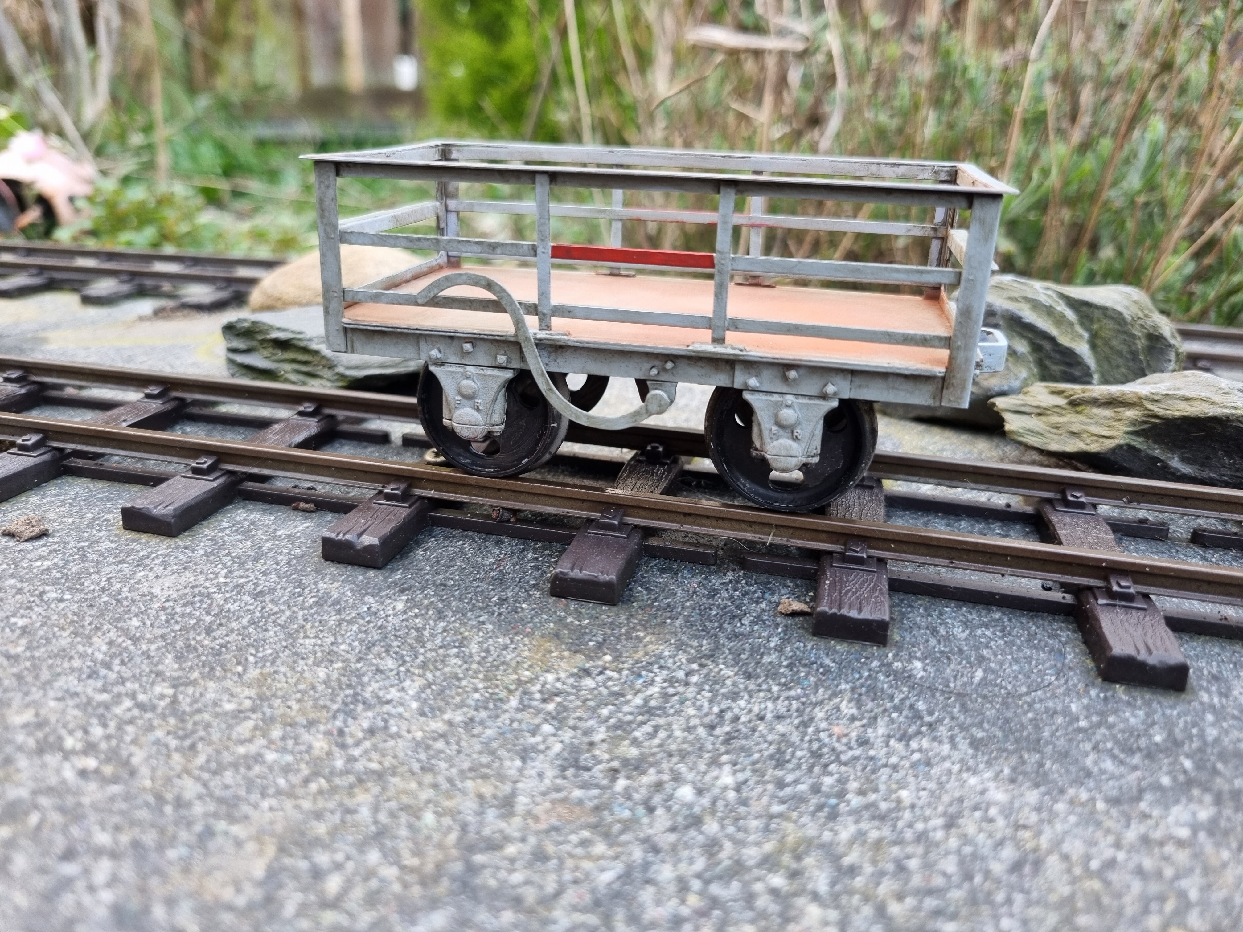

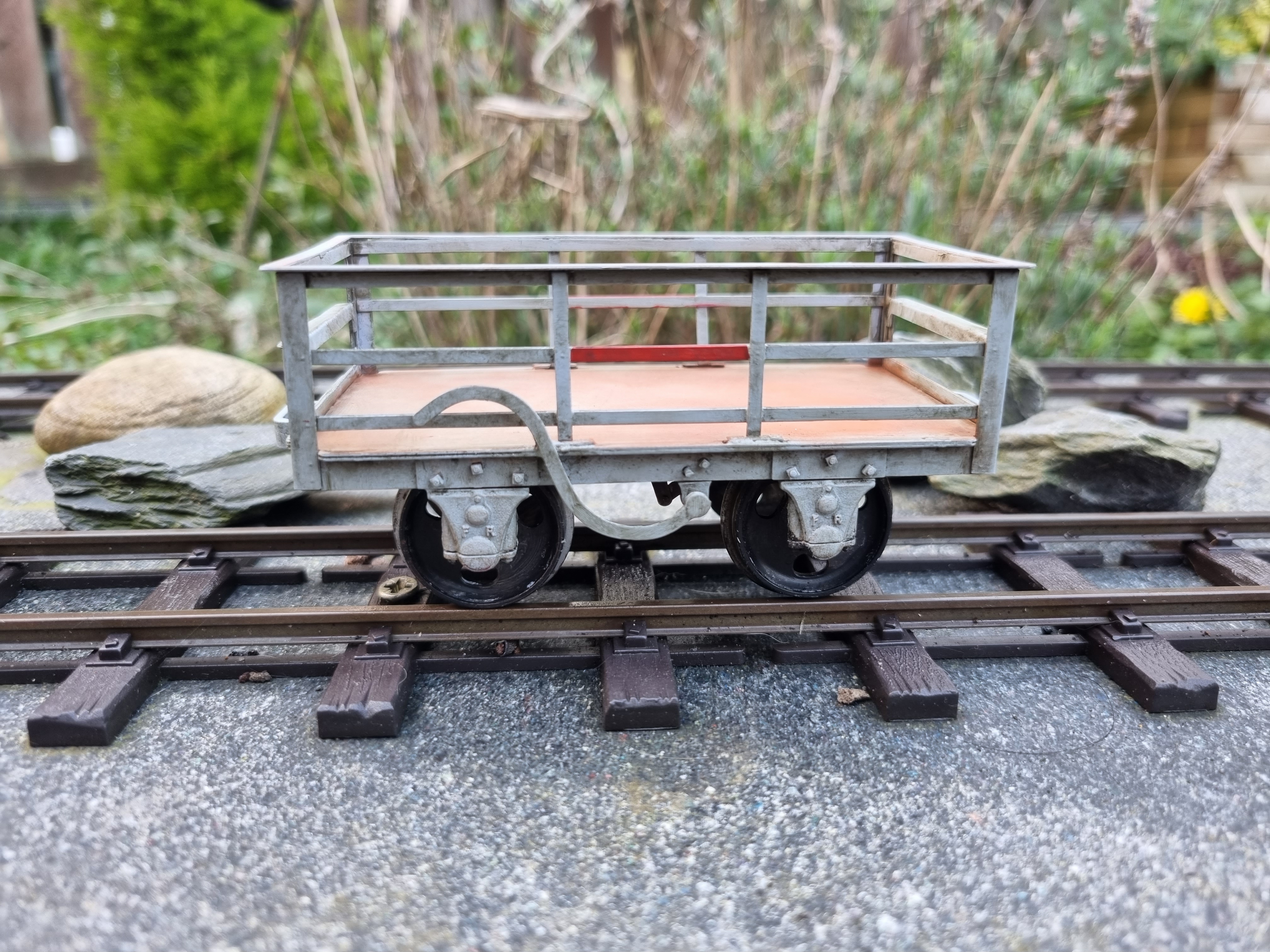

I've more or less finished the slate wagon from Slaters. It's turned out rather nicely & happy with the weathering. Another unbraked version arrived today so I am already preparing the etched & cleaning it up for assembly.

Really good quality - very crisp.
Why is the middle bar on each side red?
- Posts: 6033
Re: This weekend I have been mostly building....Slaters slate wagons
Rik,
To quote Simon's own post bit further up," I've added a red line for the Greaves, Llechwedd quarry on the centre rail of the wagon as per prototype. "
I don't know the details but I believe quarries each had a different colour code to make sure they got their own wagons back from the ports.
- Posts: 7974
Sorry, missed that ....philipy wrote: Thu Mar 24, 2022 9:45 amRik,
A bit like smearing dye on sheep, then?
