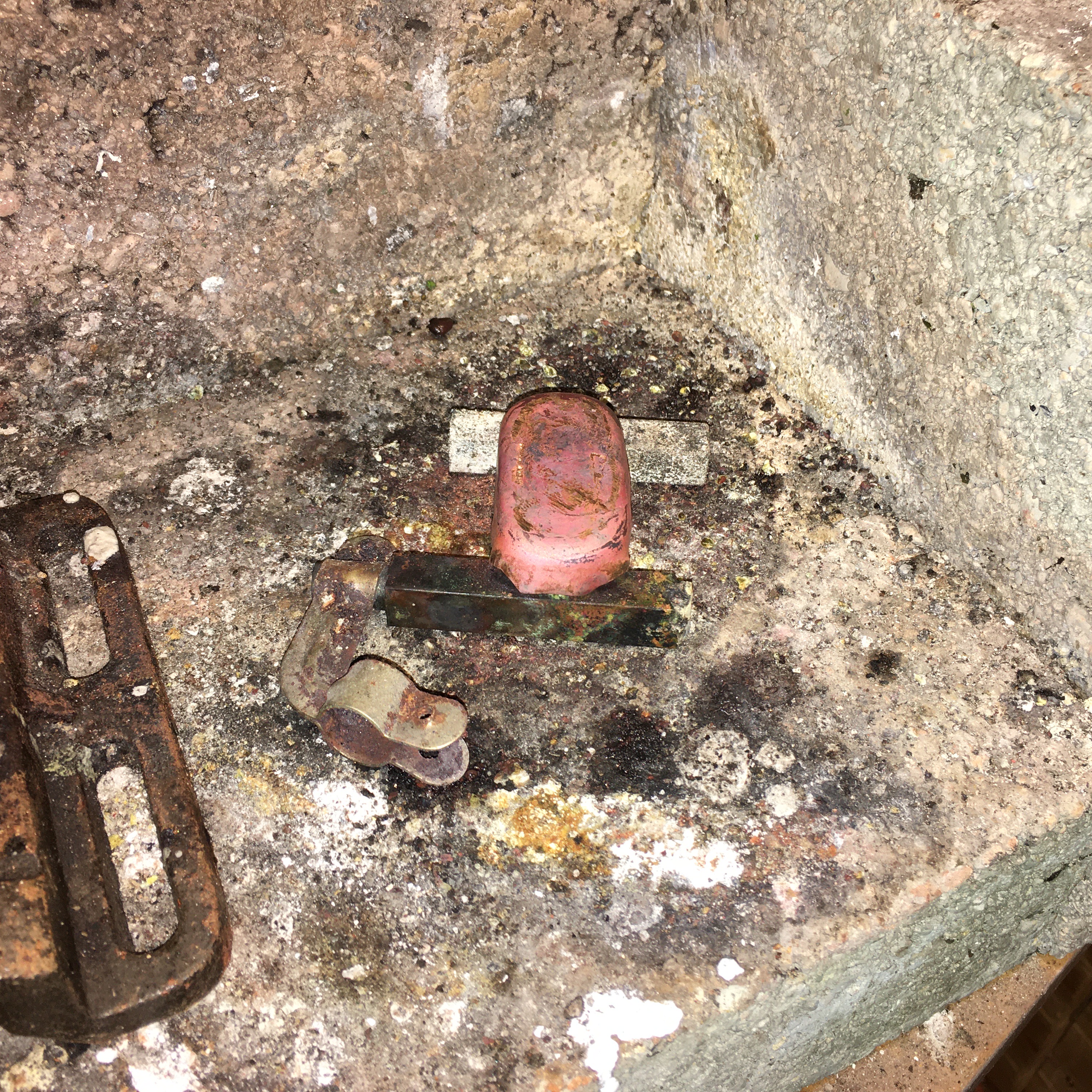

No I am not using different temperature solders - that is a technique which could be used - but I don't find it necessary.-steves- wrote: Mon Jan 24, 2022 1:12 pm Trevor, are you using different temp solder for each stage to stop the pervious solder melting? If so what are you using and where from? If not, how do you do it without the previous solder work just falling apart??
I suppose a bit more detailed explanation is in order:
When a joint has been silver soldered then the combined materials seem to need a higher temperature for the solder to reflow. I seem to remember reading that somewhere in the distant past. In this case, just to make sure I placed the bare barrel on its side so one flat plate was uppermost. The idea was that if the plate came free I hoped it would stay where it was. I thought the lower plate was unlikely to get hot enough to have any chance of the solder melting. The stays, 3mm diameter, were a reasonably tight fit in the 3mm diameter holes. Sufficiently tight that I hoped they would stay in place. So I tried to concentrate the heat on one stay end at a time - not easy with a huge flame roaring away. Perhaps I should mention that this requires a high pressure torch connected to a calor gas propane cylinder. Such a torch does not have a normal pressure regulator like you get for a BBQ - but something which can be varied - and it really is high pressure. The big cylinder is also necessary because its the only way to provide gas at the required rate for this length of time. Perhaps I should try to get a photo of this for the next stage.
Anyway back to the main point - when it is eventually hot enough - the stays can be soldered one at a time. A matter of getting the solder to flow around the one stay - while the rest isn't quite hot enough. Then move to the next, taking advantage of the whole thing being almost red hot. Then when they have all been soldered, let it cool a little, to make sure nothing is close to the melting temperature, turn it over with tongues, and solder the stays on the other side, trying to take advantage of the whole thing still being pretty hot.
The challenge will be to get the end plates hot enough to solder. Not fear of the rest becoming unsoldered - just straight forward can I get it hot enough!
I am using the silver solder which is sold by Mac Models, they only have the one type on their website, and easy flow flux which they also sell.
By the way, I find the above much more difficult to do with ordinary solder - the type you would use for plumbing joints. A gas torch gets things too hot too readily, and it all falls apart. That is much easier with some form of hot bit.
So for both types of soldering I think it is really about balancing the rate that heat is entering the job, and the rate heat is leaving, so that you can just get it hot enough for the solder to flow, and when you remove the heat it solidifies quickly.

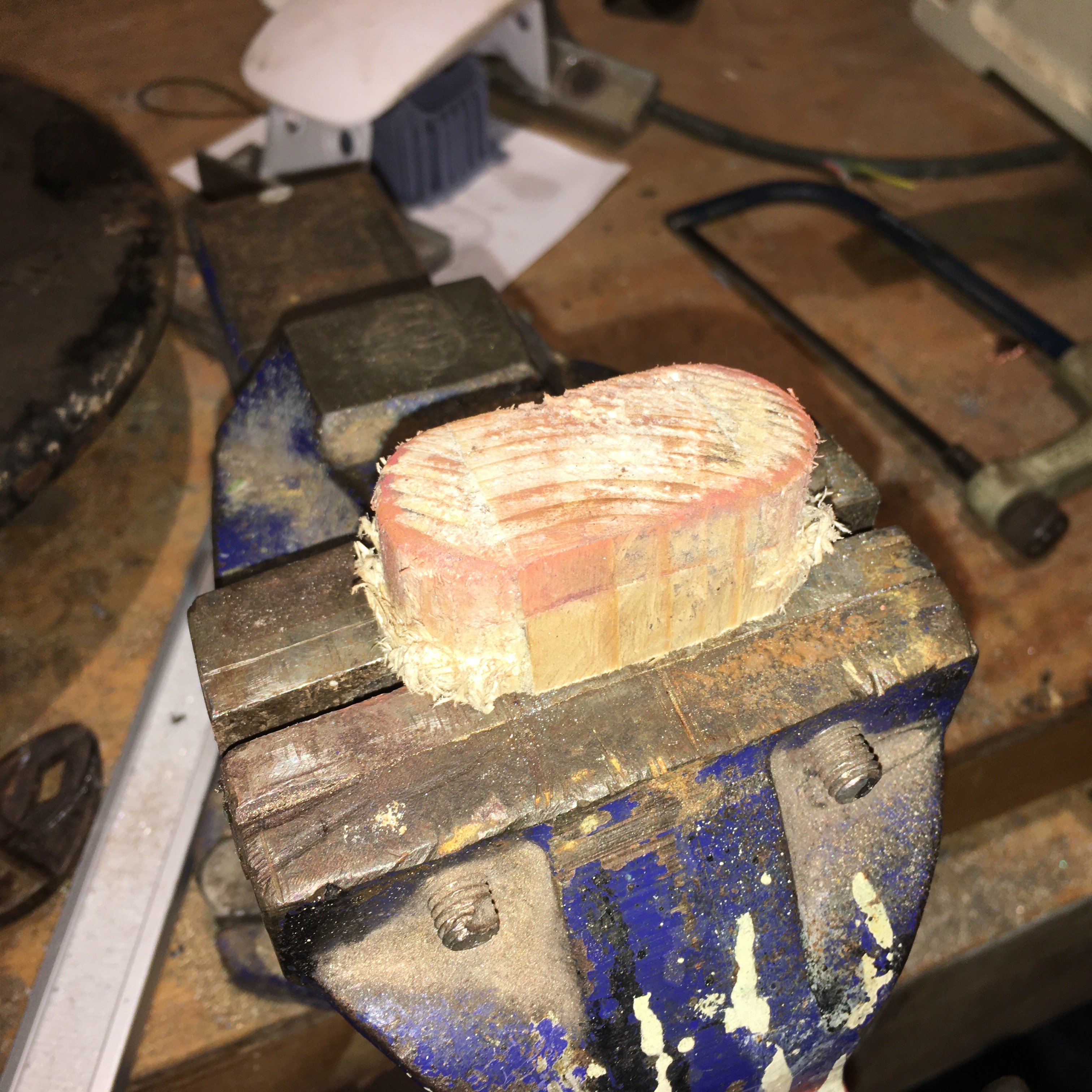

I have made some slight progress on the boiler.
I made a wooden former for the end caps. It consists of a rectangular block and a circular block cut in half and each half glued onto the ends of the block. It has worked so far - but I really need to remake it from a solid offcut of hardwood which I found in the workshop.
A piece of copper sheet, cut oversize, has been repeatedly annealed and bent to get to the point where it is almost the right shape:
It needs trimming to size and a final few attempts so get the curved ends just right.

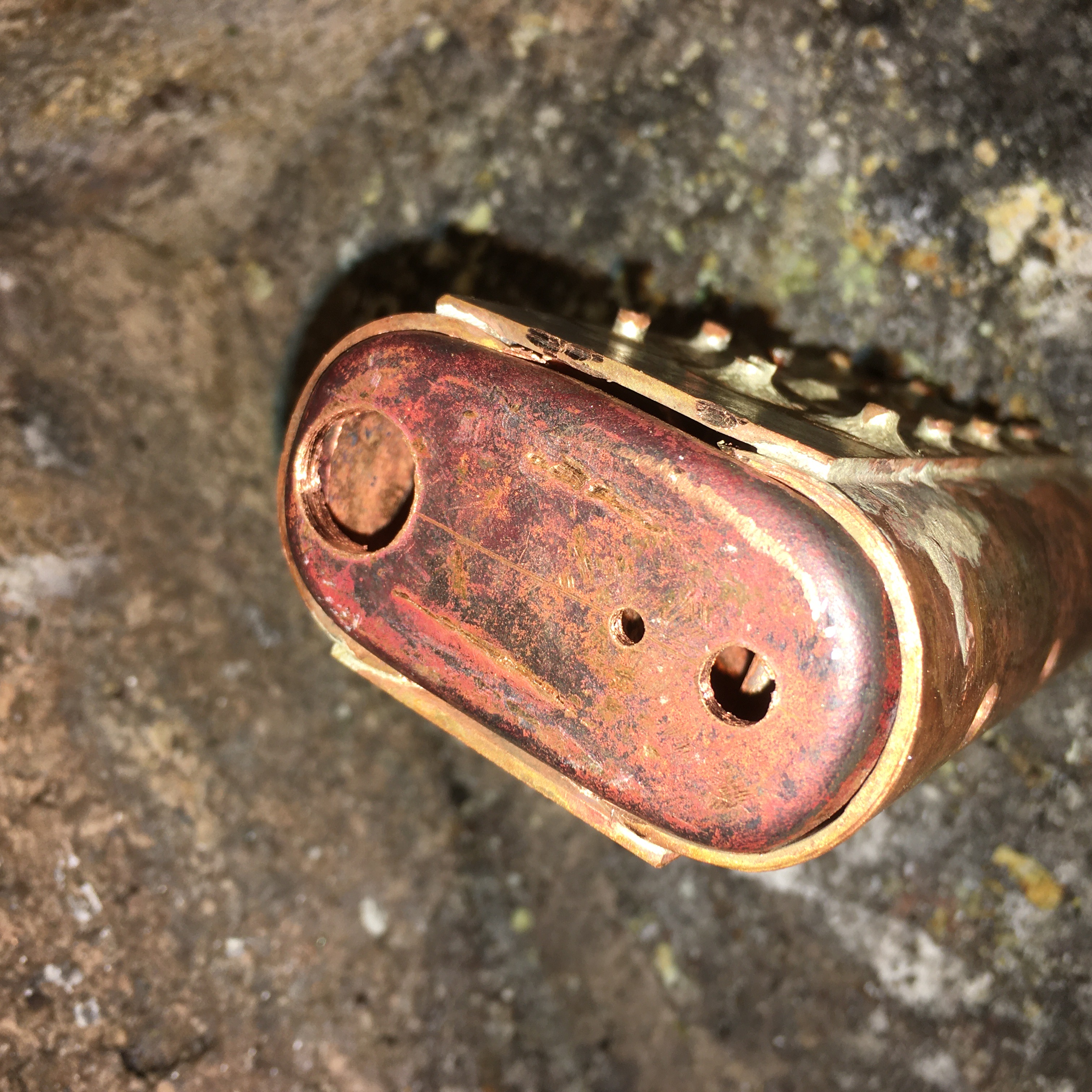

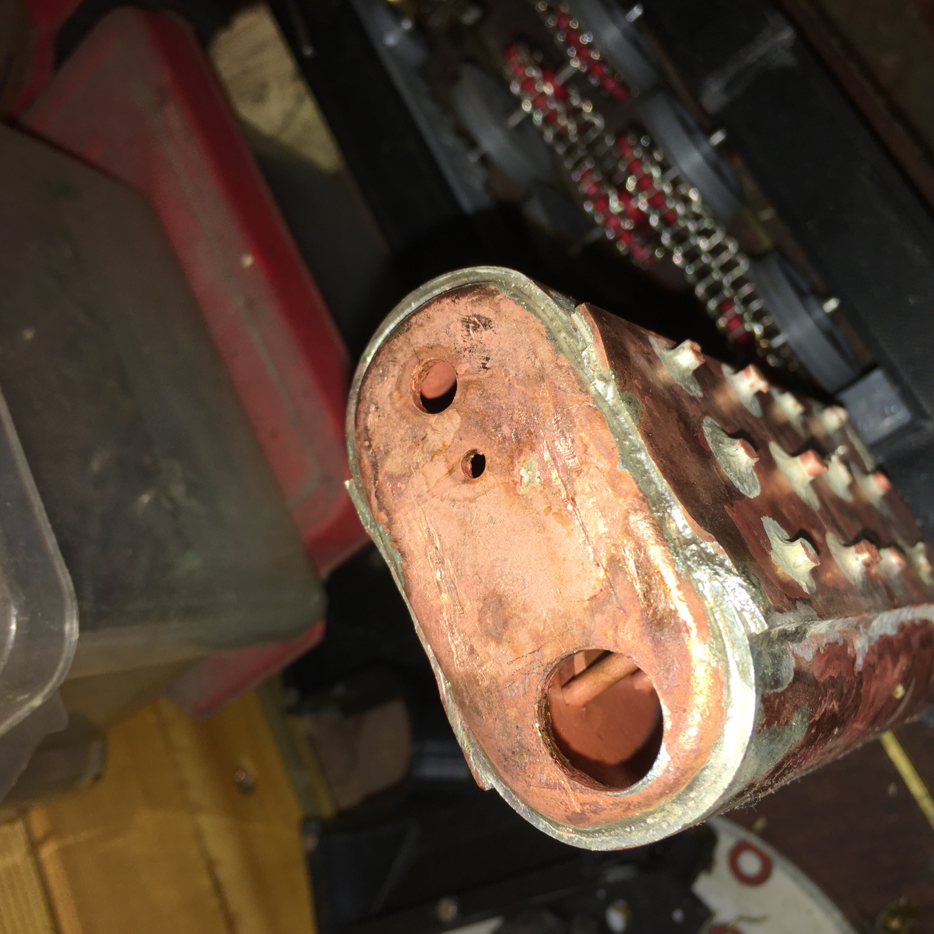

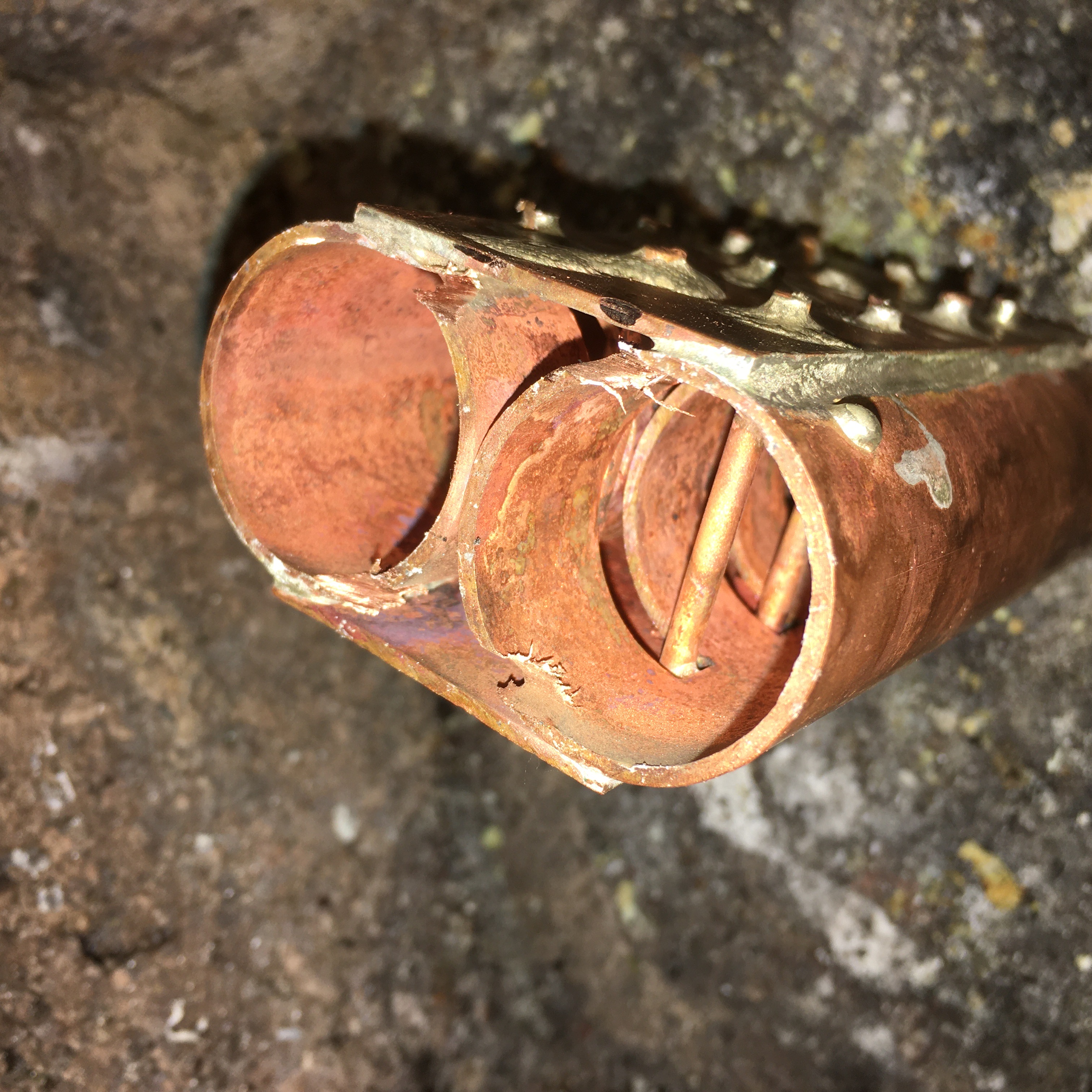

I have done some more on the boiler.
The inside parts of the two tubes have been ground down to allow the flanged end plate to slot in:
The flanged end plate is finished, and drilled and it fits (where it touches):
The large hole is for the burner tube, the small one for a stay, and the other for the steam take off. Yes there are gaps at the sides - but the curved parts which fit properly were silver soldered. Then it was pickled to clean the flux off and the gap gently closed up with a hammer. The sides were then silver soldered:
I think that looks like a good soldered joint. So on to making the front flanged plate.

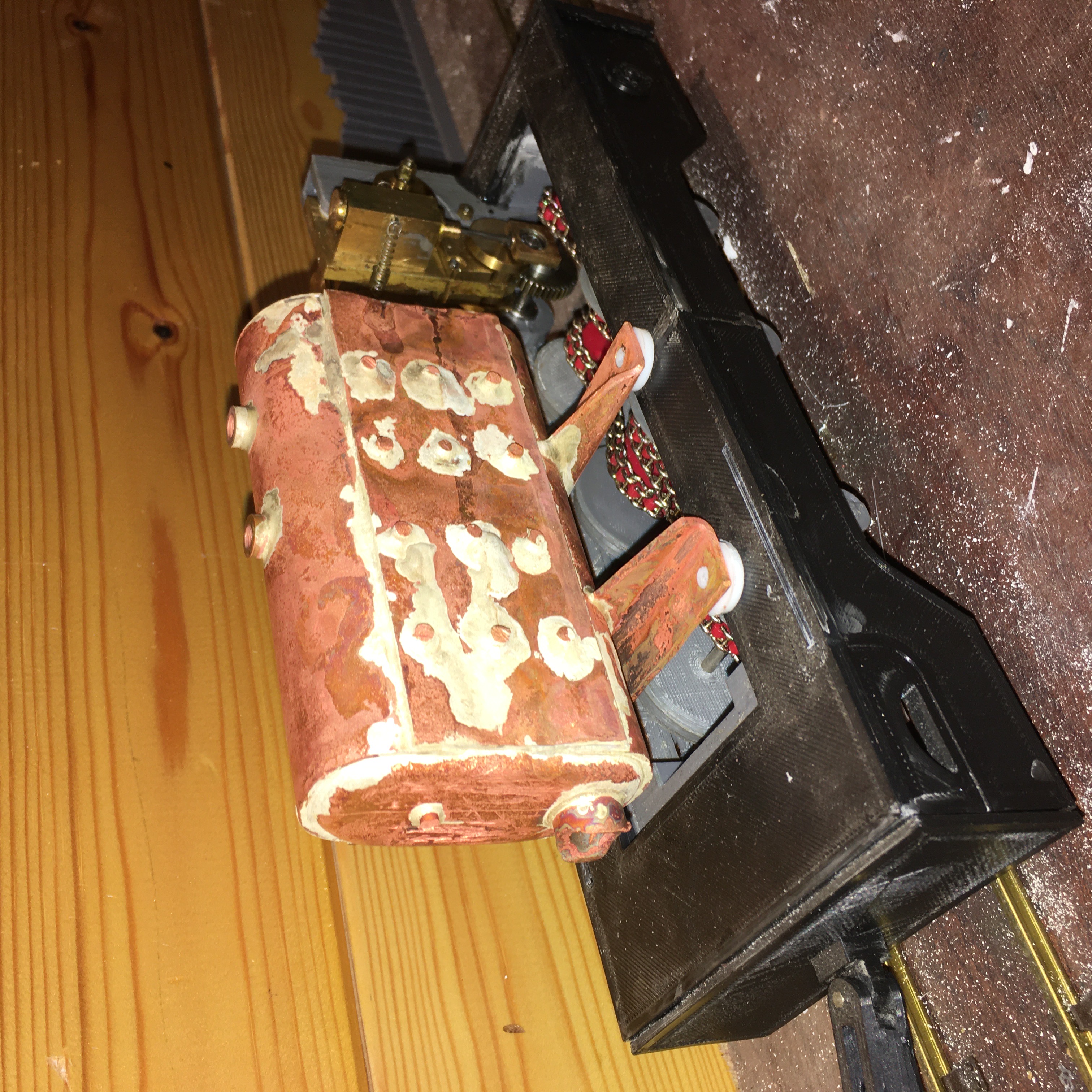

I'm back to working on this one again. I think it is time to see if it can be made to work.
The boiler is finished, a second flanged plate for the front end, the tube for the burner inserted, the stay in, and the bronze bushes in place. I have made up feet to support the boiler clear of the plastic footplate. All soldered up ready to pressurise it to see if it holds water:
You can see the PTFE top hat bushes between the boiler feet and the footplate in the first photo. I am hoping that there will be enough room between the motor and the boiler to get the jet out when it gets blocked.

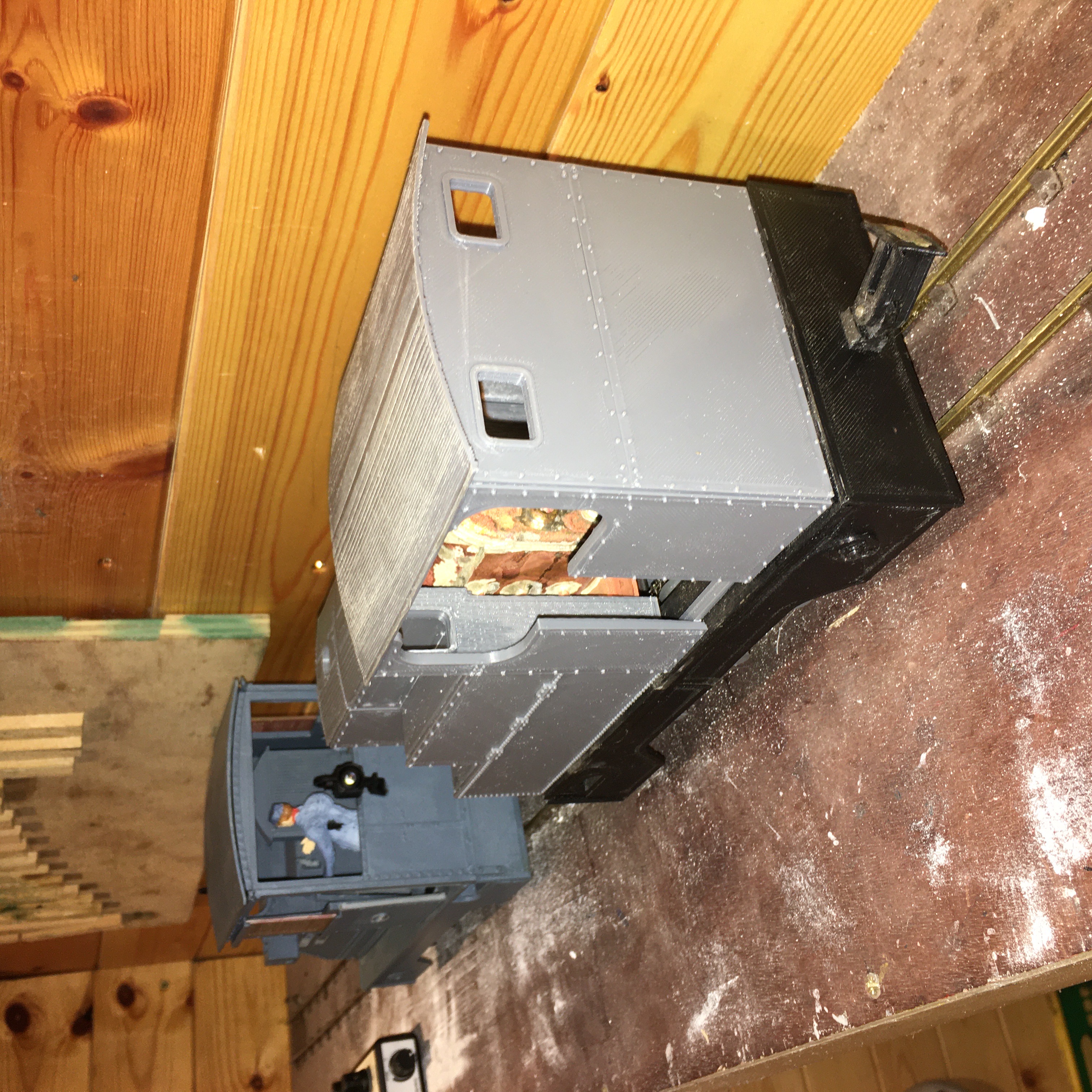

I have drawn up the bodywork and printed out the parts. It is s strange looking beast for a steam locomotive!
The body is just sitting there loose at the moment. I wanted to get some sort of attempt at the bodywork so I could make sure that I was fixing the boiler in the right place. I think some adjustments will be needed for the smokebox end of the body to make sufficient clearance for the flue.
And that is 4415 sitting in the background - which shows the similarities and differences between the two locomotives.

Fantastic.
How did you make the PTFE boiler feet? Turned on the lathe?
Really interesting to see the bodywork. It is a strange looking loco, but while it's hard to deny it looks like it's had an encounter with the ugly stick, it's actually far more appealing to my eye than drawings suggested to me.
I know it's not your plan to, but looks like there's lots of room in the tanks if one were to R/C it (reverser linkage running under the cab floor perhaps?)
