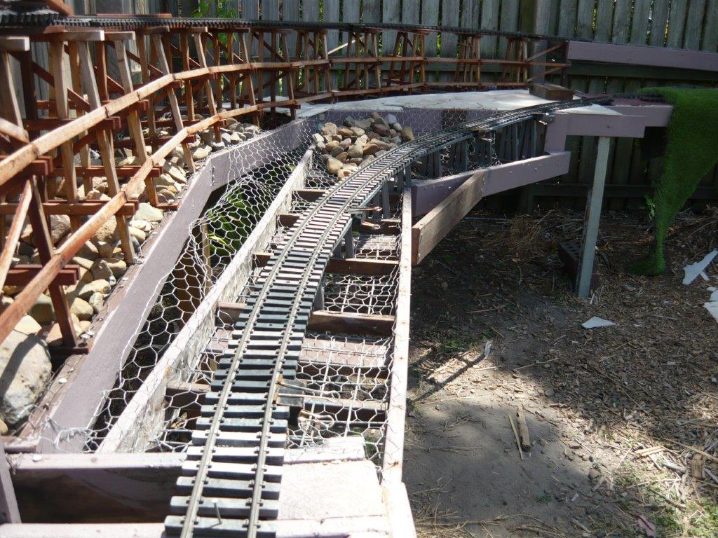

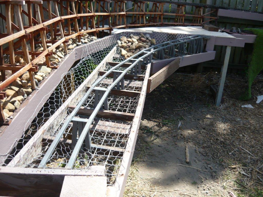

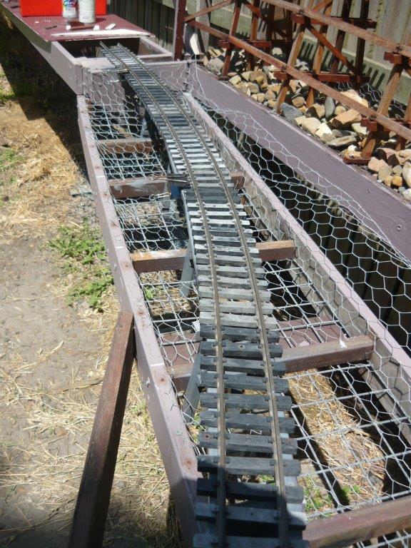

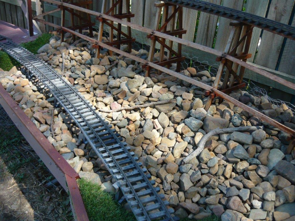

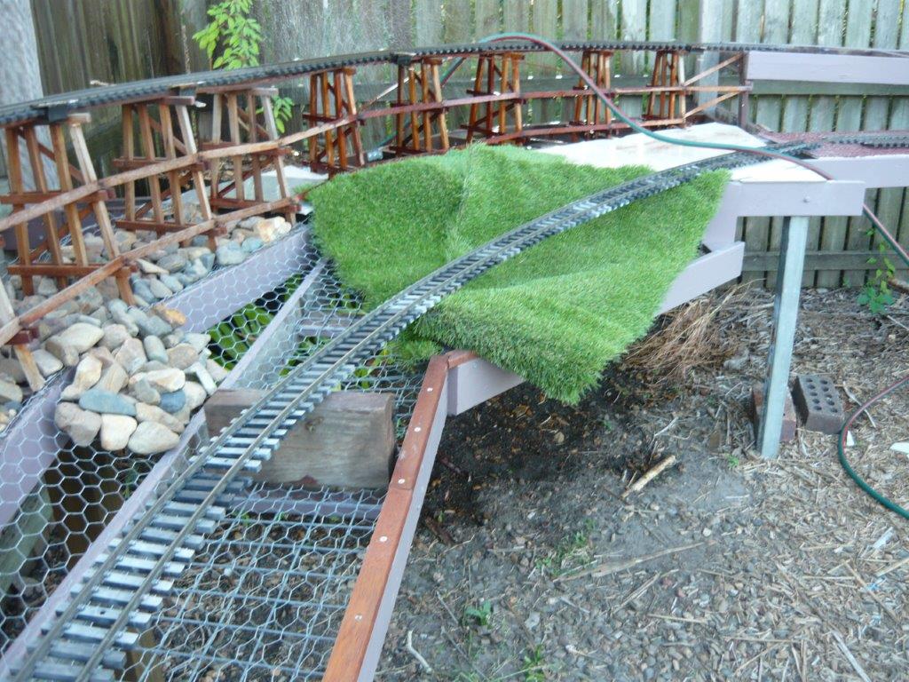

Work on the low trestle area has started.
A few pictures to show the work, I have put some stones and roughed in some turf to get a feel for what I am trying to do.
Blog to be updated.

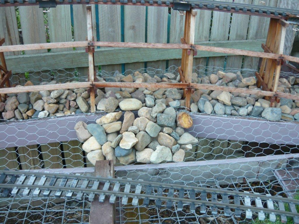

Rocks roughed in.JPG (166.25 KiB) Viewed 12131 times

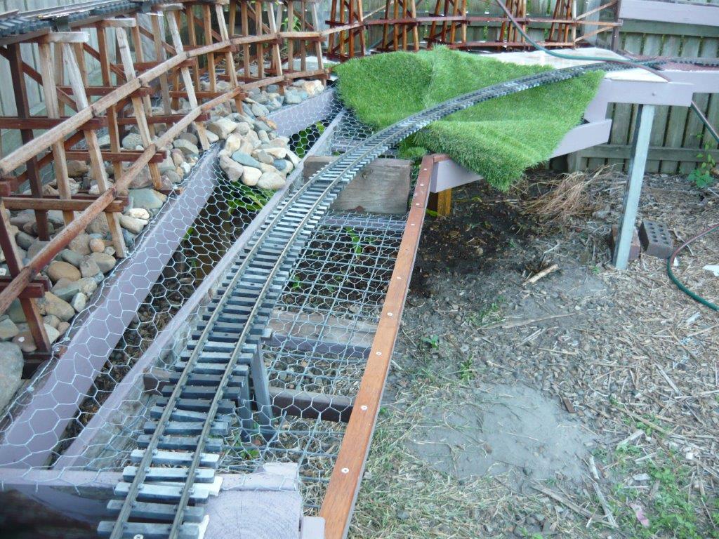

Mesh detail.JPG (190.54 KiB) Viewed 12131 times

Using the chicken wire to support the stones to contour the slope/gap is a very clever idea, I do like that.
GAP
Posts: 694
Re: Ringbalin Light Railway
Post by GAP » Tue Mar 17, 2020 7:17 am
Using the chicken wire and mesh allows the rainwater to pass through and air to circulate, so hopefully there will not be any rot due to the timber staying wet.

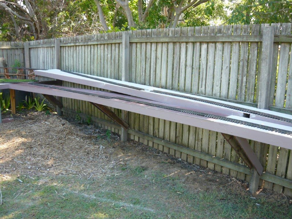

The "Low" Trestle has been finished and baseboard either side installed.
Low Trestle Lengthwise.JPG (193.55 KiB) Viewed 13709 times
Low Trestle Lengthwise Track Roughed in.JPG (188.47 KiB) Viewed 13709 times
Low Trestle Lengthwise Track Roughed in 1.JPG (125.53 KiB) Viewed 13709 times
Baseboard Side Fence Lower.JPG (82.2 KiB) Viewed 13709 times
Baseboard Back Fence Lower.JPG (81.2 KiB) Viewed 13709 times
Blog will be updated later

Coming on well, it's a great feeling when you get on a roll!
Just a thought, if it were mine, I would be sooo tempted to fill in the triangle between the RH corner at the end of the low level section and the first angled board joint on the brown boards, just to make it 'flow' visually.
Post by tom_tom_go » Tue Mar 24, 2020 11:06 am
Having built a raised railway gaps are good for drainage.
Posts: 5168
Post by philipy » Tue Mar 24, 2020 1:45 pm
tom_tom_go wrote: Tue Mar 24, 2020 11:06 am Having built a raised railway gaps are good for drainage.
Agreed, but I was referring to the front tringle not the rear gap.

philipy wrote: Tue Mar 24, 2020 1:45 pm
If you are referring to the brown board at the front that was put in at the last minute because one of the trestle bents was sitting right on the edge.
It is still brown because that is the colour of the old deck that the boards came from and I could not paint it last night because it was going to rain.
The intention is to fill in the corner area with turf (the rocks that are there were just dumped there while I repaired the sunken bent and have not been returned to their place.
To add some interest I have a water tank that I am considering using in the upper area with a water bore, a pump house and a water spout in the lower area. The pump house will explain how the water got up to the upper level.

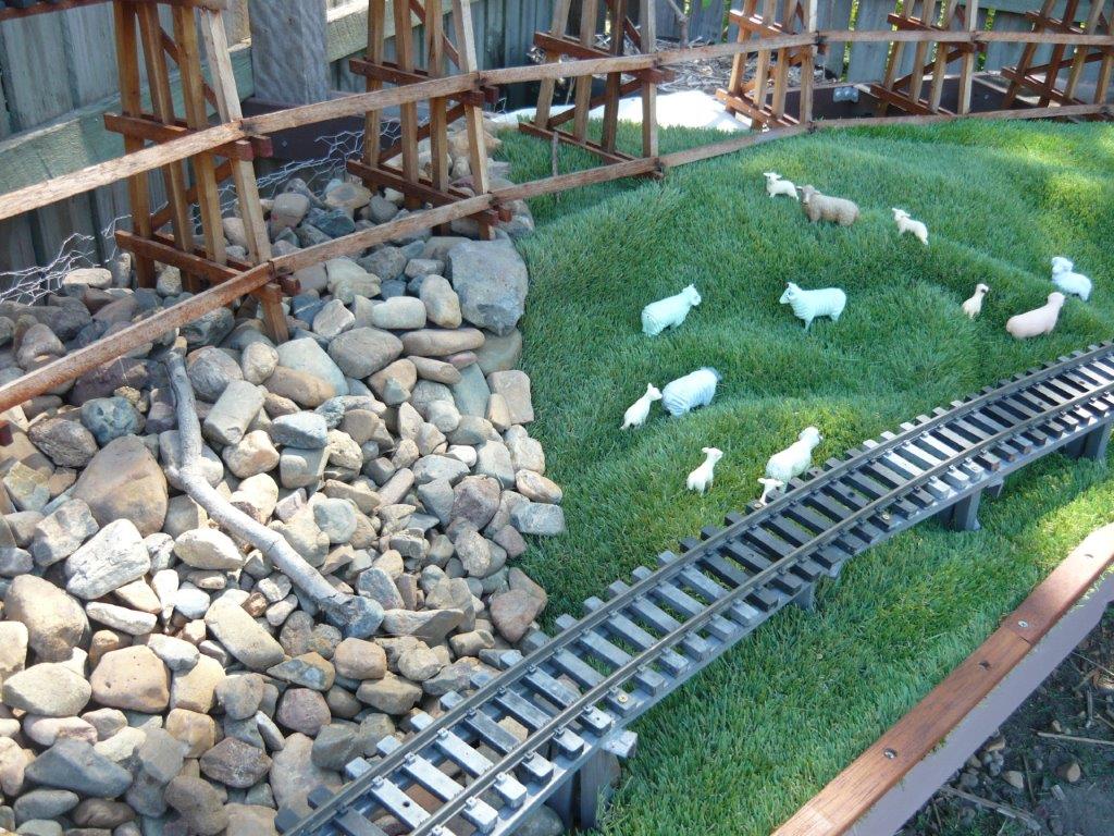

Work has progressed quite quickly thanks to COVID-19 isolation
The line on both the high and low trestle have been screwed down and the scenery underneath both has been finished.
I am still contemplating whether to put an edge on the high trestle or not, plus I am thinking about some sort of safety rail at the back to catch any rolling stock that may derail.
I am leaning toward the safety rail at the back but leaving the front as it is, a check rail is in the mix as well.

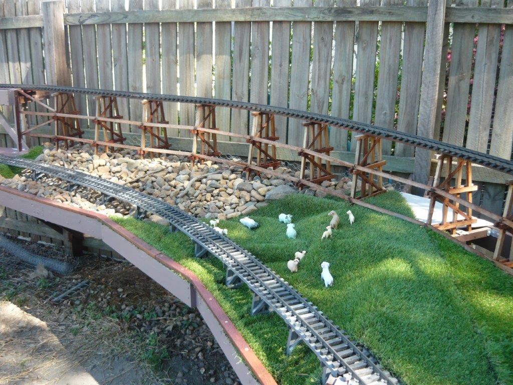

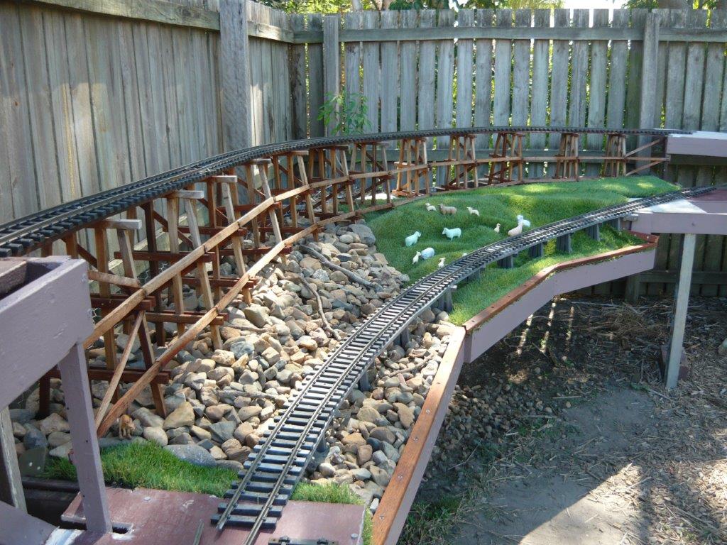

Trestles w-scenery.JPG (179.53 KiB) Viewed 13488 times
Trestles w-scenery (2).JPG (186.04 KiB) Viewed 13488 times
Rocky gully.JPG (163 KiB) Viewed 13488 times
Rocky gully w trestle.JPG (181.83 KiB) Viewed 13488 times
Rocky gully and paddock.JPG (199.46 KiB) Viewed 13488 times

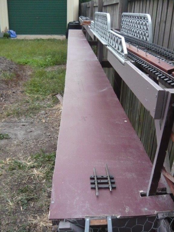

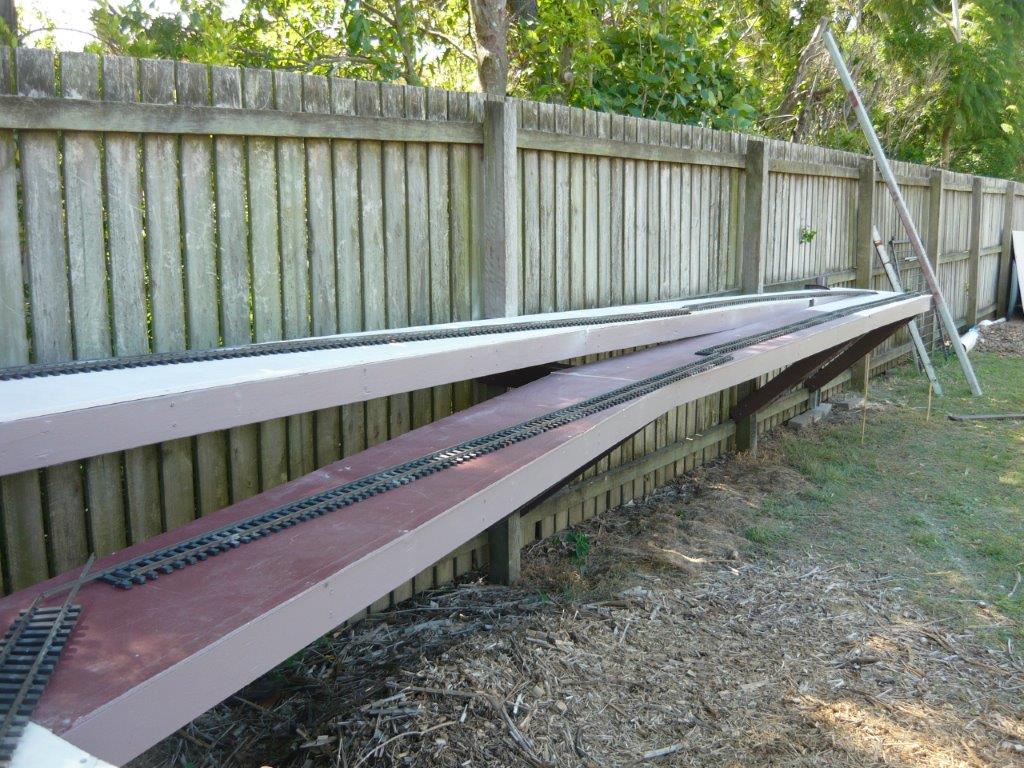

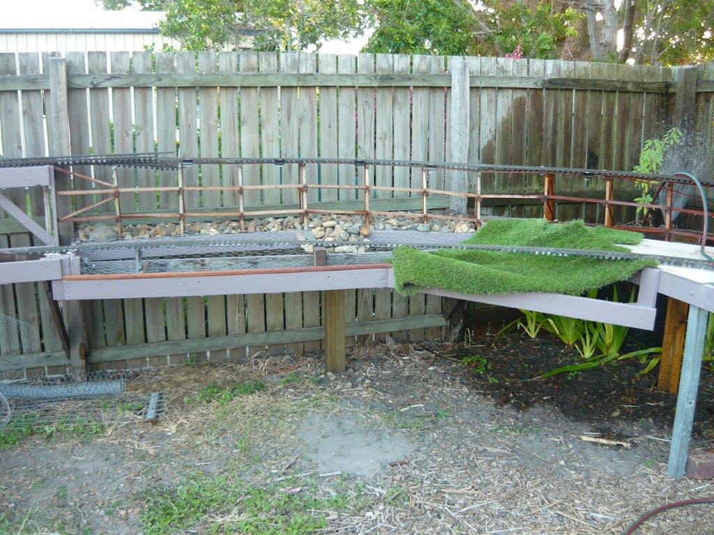

Work continued on laying baseboards across the back fence on the lower level and down the side fence on both levels, the upper level across the bridge and along the back fence is next cab off the rank.
I am considering a temporary switchback so I can run a loco and a few wagons to do some testing/playing.
At the end of baseboards the track will loop back and do some sort of "S" to take it to a "Town" area to be built on table which of course has to be constructed.
After that getting a line back to the upper level from the "Town" is going to be an engineering challenge and there is of course the spur that will run into the shed leading to storage yards.
Across the back fence
Baseboard back fence.JPG (171.9 KiB) Viewed 13487 times
Down the side fence
Baseboard down hill side fence.JPG (192.82 KiB) Viewed 13487 times
Baseboard down hill side fence (2).JPG (182.55 KiB) Viewed 13487 times
What to do about disguising the level change to make it less visually obvious, possibly a stone cutting face?
Any thoughts welcome on that.

GAP wrote: Sun Mar 29, 2020 8:00 am
What about slate, vertically it will hide the gap and should whether nicely.

Jimmyb wrote: Sun Mar 29, 2020 8:58 am
Worth a thought
