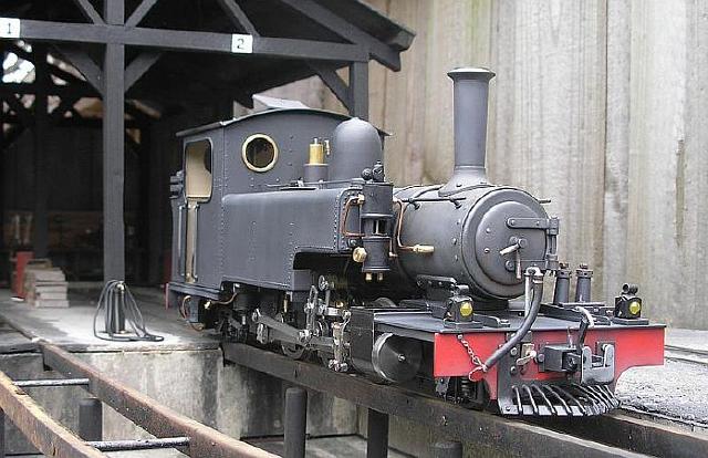

Ha ha, Sorry, I just saw your response!LNR:117036 wrote:PROOF!
Just for you Keith, blowing a bit of a gale but I steamed up the loco again today. Lighter train, but once again no mess. Don't know
if this shows it "no mess Charlie"
Like I said, black thing in a black hole.
After running bunker first back to Leawarra, the smokebox and frontplate would usually be spattered with fine oil and water.:lol:
I'm pleased that I managed to get you to show us more photos of that lovely engine!

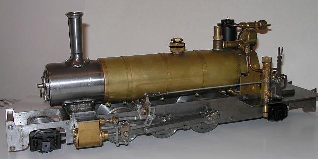

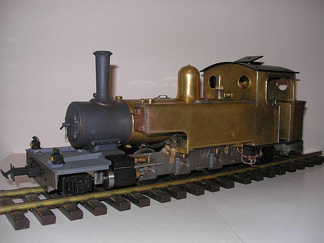

Hi Tom and thank you,
The loco is a home build, but using a Roundhouse Katy boiler and cylinders, axles and some motion, with my own frames, rods, body, wheels, trucks etc. I bought a Katy frame and boiler kit, used the frames wheels and axles to make my petrol/mechanical loco, and the boiler cylinders and gear for this loco.
I wanted to build one of the 2ft. gauge Bagnalls from the Sth. African Avontuur line, but found outside frames on a leading four wheel truck at 45mm gauge would'nt negotiate my points, so the loco is a freelance 2-6-2, with I'd like to think a hint of the said Bagnalls.
The smokebox is quite long as it actually extends back to nearly the first boiler band, so it's a good echo chamber. It steams well even on 42mm wheels, and is quite heavy so has plenty of momentum.

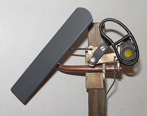

When I built an interlocked signal and ground-frame on the mainline of the LNR, it started me thinking about a platform mounted ground frame operating a couple of signals, and maybe a set of points. Somehow the thought of a set of levers, maybe three minimum, open to the operating side intrigued me, and I have re-visited the thought repeatedly.
Firstly, let me say I don't profess to know much about signalling, but I have worked out that Leawarra could support a home signal on the main, with perhaps a dwarf signal on number three road, and maybe some point control. Now whether these become inter-locked only time will tell, but to start things off I am building another home signal.
Being able to make an exact copy of the previous one I thought this would be easy. Silly me! You don't have to be far out to totally change the angles that the signal arm and spectacle assume when moved by the control rodding. I should have known better.
So when I finish the signal, and if I have any hair left, we shall think about interlocking and the dwarf signal.
One step at a time, this is definitely a work in progress and to quote a bard on this forum, "this is what keeps us awake at nights".

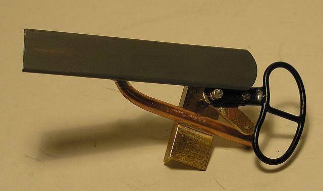

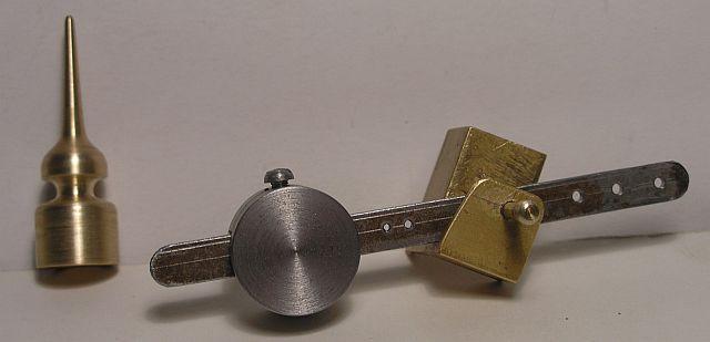

Well Rik, that patience was surely tried today. Made the finial (brass this time) and the operating lever bracket, then the lever itself. Easy!
Then the horror job, Worrying (engineering term) a slot 1/16thx7/32" through a piece of 3/4" M.S. bar for the lever weight. My longest 1/16th end mill was about 1/4" long, so three 1/16th holes in a line, join them up with the end mill to 1/4" deep then the rest of the afternoon wearing away the bit in the middle till I could finally get a needle file through and really get to work.Ugh!

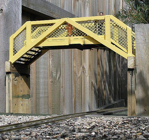

This signal will be on quite a short post as it is to go close to the footbridge that provides a photographic end to pics. of Leawarra yard.
I know possums run through here, and I'm not sure if they go over the bridge or under it. A pointy finial sticking up higher than the footbridge could be asking for trouble. It's also got to be in line with the gap under the bridge so that the interlocking (if we go there) can come through from the set of points further up the line.
- Posts: 5715
A classy piece of work there Grant... beyond my engineering capacity I think!
I love the idea of Possums using your railway footbridge, a tiny Vole joined me yesterday as I was working on my track, at least they are good company in the absence of real people.

Those signal fittings would be the envy of any S&T department in any scale Grant. I just know that you will have fitted the counterbalance weight with a working clamping screw! I look forward to seeing the finished signal in operation. I'd be simply delighted if I had manufacturing skills and facilities only a tenth as good as yours. :oops:
