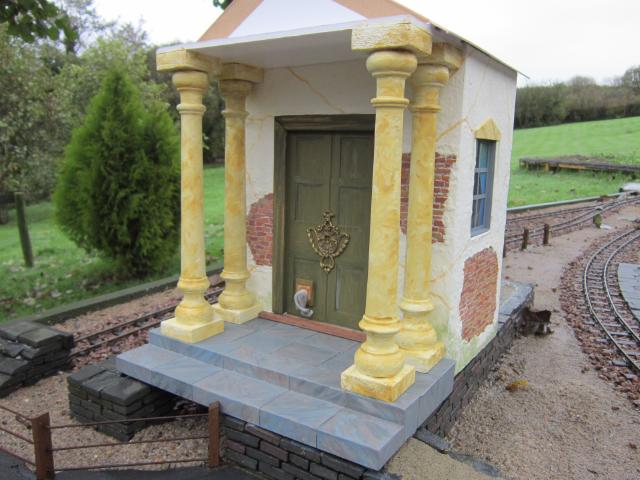

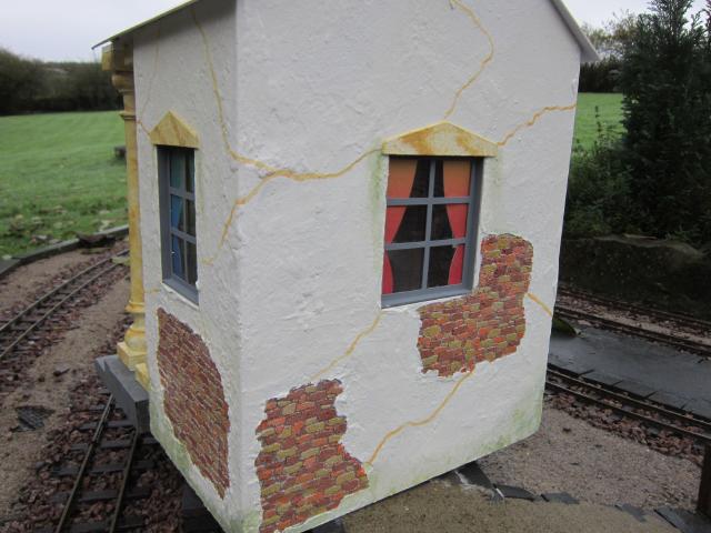

Anyhow, further progress on my Emett building which now has cream emulsion painted walls with green acrylic paint at the base to simulate rising damp. Also, cracks in the plaster to give reason for the stonework to be exposed.
Glazed windows with curtains are fitted all round.
At the front, the steps and columns have been marbled, and the front door with heavy door furniture and cat flap is in place.

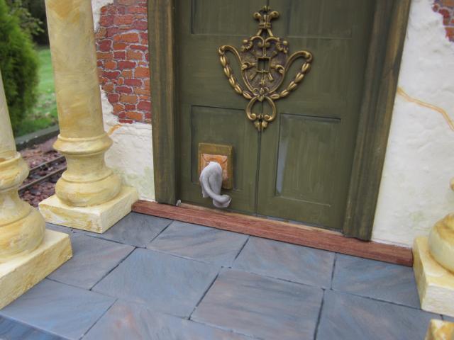

Many thanks for the comments....
The door furniture is a genuine antique drawer handle escutcheon plate which I cut in half (I do have misgivings about such vandalism but I am not likely to use it for its intended purpose).
The cat flap is from a doll's house fittings supplier (which I personally would not recommend) but I do use their products.

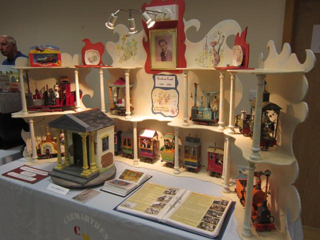

Back from a pleasant day exhibiting at a local model show with my Emetts...
The house had its first outing and was well received. I have managed to finish the roof slates with individual coloured paper squares (3 colours) stuck down with PVA and finished with weathering powder and matt varnish. Also the pediment is made from plasticard and sprayed grey primer waiting for top coat to match the columns.
There is still work to be done to complete the piece. A small garden with lawn, path, fencing and gate, also a stovepipe chimney. More to come...

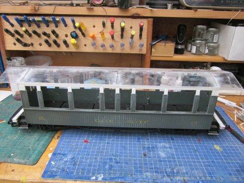

I've raised the height of the roof and opened out some of the windows to resemble those on the L&M coaches. These had pent roofs so have used acrylic sheet (cheaper than plasticard and more rigid). I'll start a thread when I've got a bit further and figured out some of the tricky bits (eg the toplights).
That's really useful info. I usually position them and then apply solvent, which often results in them floating off. I then try pushing them back with a scalpel blade but it's then difficult to get them back into position - even half a millimetre out can be noticed. I'll try your technique next time - sounds a whole lot more successful.Peter Butler:105202 wrote: The Cambrian bolt heads are so fiddly to deal with, especially as they are cone shaped and can't be picked up with tweezers. I cut a few off the sprue and place the right way up on a piece of paper. The solvent used shouldn't make much difference as they work in similar ways but my method is to put a small dab on the spot where the head is to be attached and then, with the brush still wet, lift the head with the brush and place it on the spot. You can see why they are on paper as any excess solvent would bond to plastic! You do need to work quickly and be confident, although it is possible to slide them fractionally using additional solvent.
Progress so far.Peter Butler:105202 wrote: Good luck with your Bachmann coaches, I look forward to seeing them.
Thanks for the tip. My railway is set in the 1930s but I've had some success in modifying modern figures by adding hats, scarves, longer skirts etc using GreenStuff. Might give these a try.Peter Butler:105202 wrote: If you are fitting passengers there is a site on ebay where you can get G scale, unpainted moulded plastic, seated figures direct from China. The company has the wonderful name of 'wehonest' so you just have to try don't you? There are 3 packs of 5 different figures (15) for £14.99 plus £1.99 postage and mine arrived in about a week from order. I have used them twice now and am completely satisfied. Painted in different colours and placed separately you can't tell they all have twins!

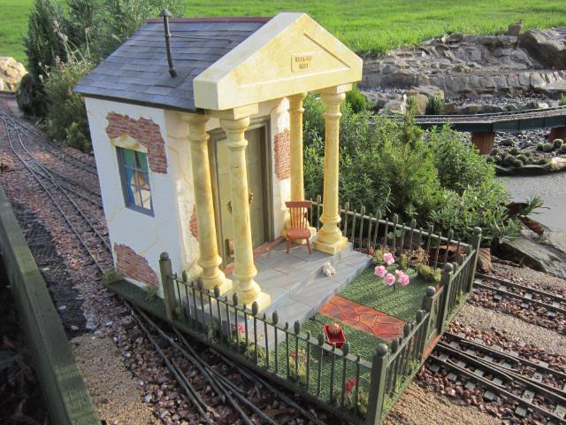

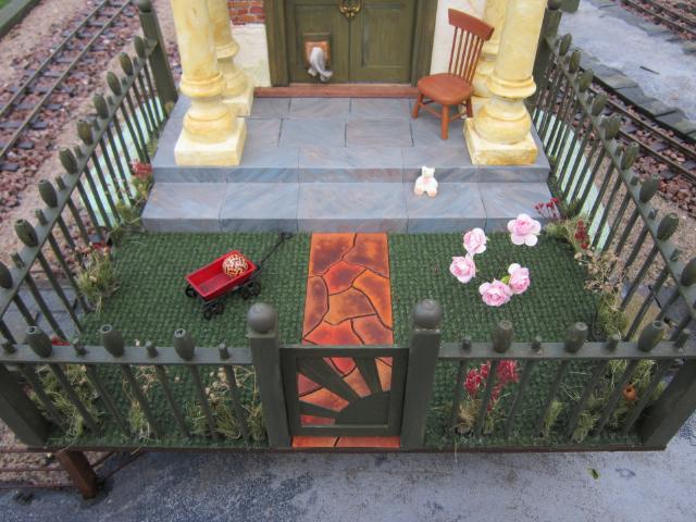

Although other projects have been causing some delay, the Emett style house has now been completed.
It has a garden with wonky railing fence, crazy paving path, flowers and weeds (there are always weeds!) children's toys and a chair on the steps.
It is interesting to analyse this cartoon as Emett shows a large country house being demolished (financial ruin?) and the component parts being re-used by locals in the 'make do and mend' era following the shortages caused by the war. This particular house incorporates the grand entrance taken from the mansion but meagre structure at the rear. As a token to the modern age, he has drawn a 1940's style garden gate which is totally out of keeping with the rest of the building.
