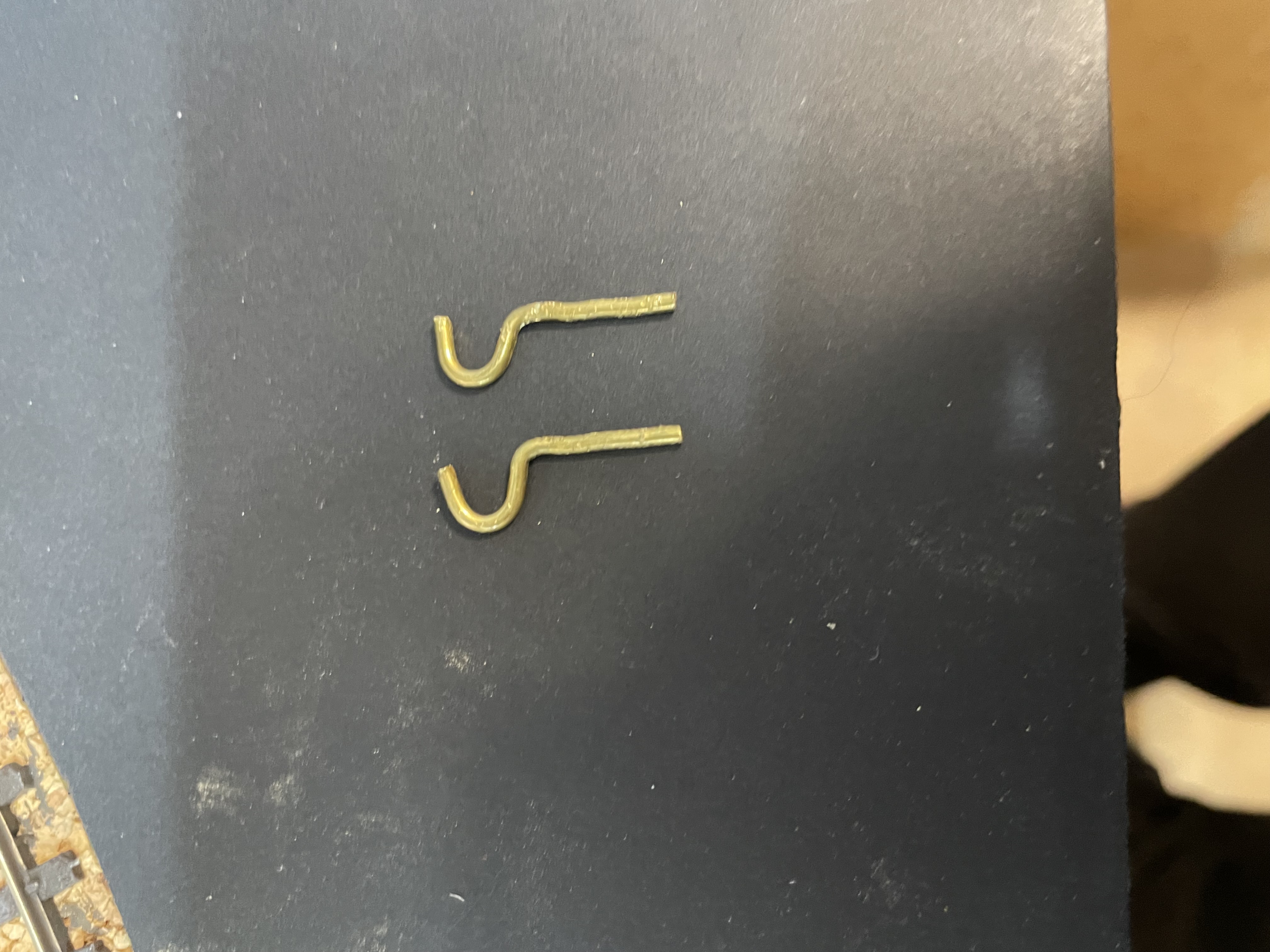

Last autumn I acquired two GVT type wagons which had been made by a former member of our local model railway group and at Christmas was given an FR sheep wagon.
These three wagon had couplings based on hoops and loops fixed underneath which meant they could only be marshalled together and would not couple to any other rolling stock I have which all have Binnie type couplings. Following much head scratching I recently bought two sizes of Binnie Carmarthen couplings to play with and have now altered the wagons, each differently, to end up with:-
The wagon nearest is the sheep wagon to which I have fitted a medium Carmarthen coupling. This wagon was 3D printed by Trevor Thompson of this parish. The middle wagon is a Coopercraft kit. There I have used the small Carmarthen coupling, cutting some away so that it looks as if the end door may still be able to be opened. The furthest is a Binnie GVT granite wagon, there I have cut away the existing fittings and drilled through from underneath to fit a brass hook.
The wagons can now be coupled with three link chains and so will run with any of my stock. A quick test to make sure they would not uncouple was carried out and here is a clip of them running:-
The brass hooks were made by unbending a single coupling loop from a brass chain. Much use of pliers and vice lead to:-
