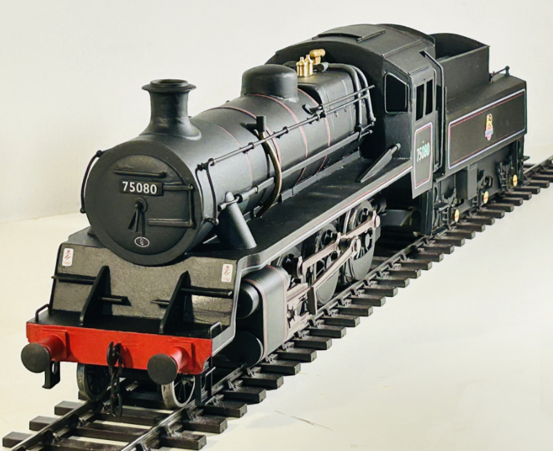

A bit like a BR Standard (but not too much)
A few months later, I’ve at last got round to painting it (I was busy) and, after several failed attempts, getting a set of DIY waterslide decals that worked. It took ages to figure out it was the spraycan acrylic varnish at fault (wouldn’t cure?), not the new inks or decal paper. A new can and it was all OK.
I now have to somehow secure the battery in the smoke box and then screw it all together. Somewhere I’ve got some suitable crew too — I boxed them up 18 months ago, before the recent house move and haven’t yet stumbled across the right box.
I’ll do the glazing when something arrives in appropriate packaging. Hopefully, a cake
Posted: Mon Aug 17, 2026 7:45 am
Wow!!! That looks brilliant. The finish on the paintwork is perfect.
Posted: Mon Aug 17, 2026 7:16 pm
by BertieB
Thanks Rik. My guilty secret is spraycan Railmatch Matt Enamel Varnish on gloss paint (mind you, I don't show the scruffy bits that don't look so good).
Posted: Tue Aug 18, 2026 8:20 pm
by Lonsdaler
That's all looking good Bertie. The close coupling is worth the hassle too. I've printed my own decals previously but the quality of the paper I used changed, and they all seemed to break up. What brand do you use?
Posted: Wed Aug 19, 2026 9:26 am
by BertieB
Lonsdaler wrote: Tue Aug 18, 2026 8:20 pm “I've printed my own decals previously but the quality of the paper I used changed, and they all seemed to break up. What brand do you use?”
I’m afraid I can’t recommend my preferred decal paper as it appears to be no longer available, so I recently bought a few small packets from different manufacturers to try. Unfortunately, I also bought new, not-OEM inks and new spraycan varnish. When it all went horribly wrong it took a while to arrive at changing the varnish (and being super conscientious about applying it). The paper that then worked happened to be from Hayes Paper Co — but I don’t know about the other ones yet.
