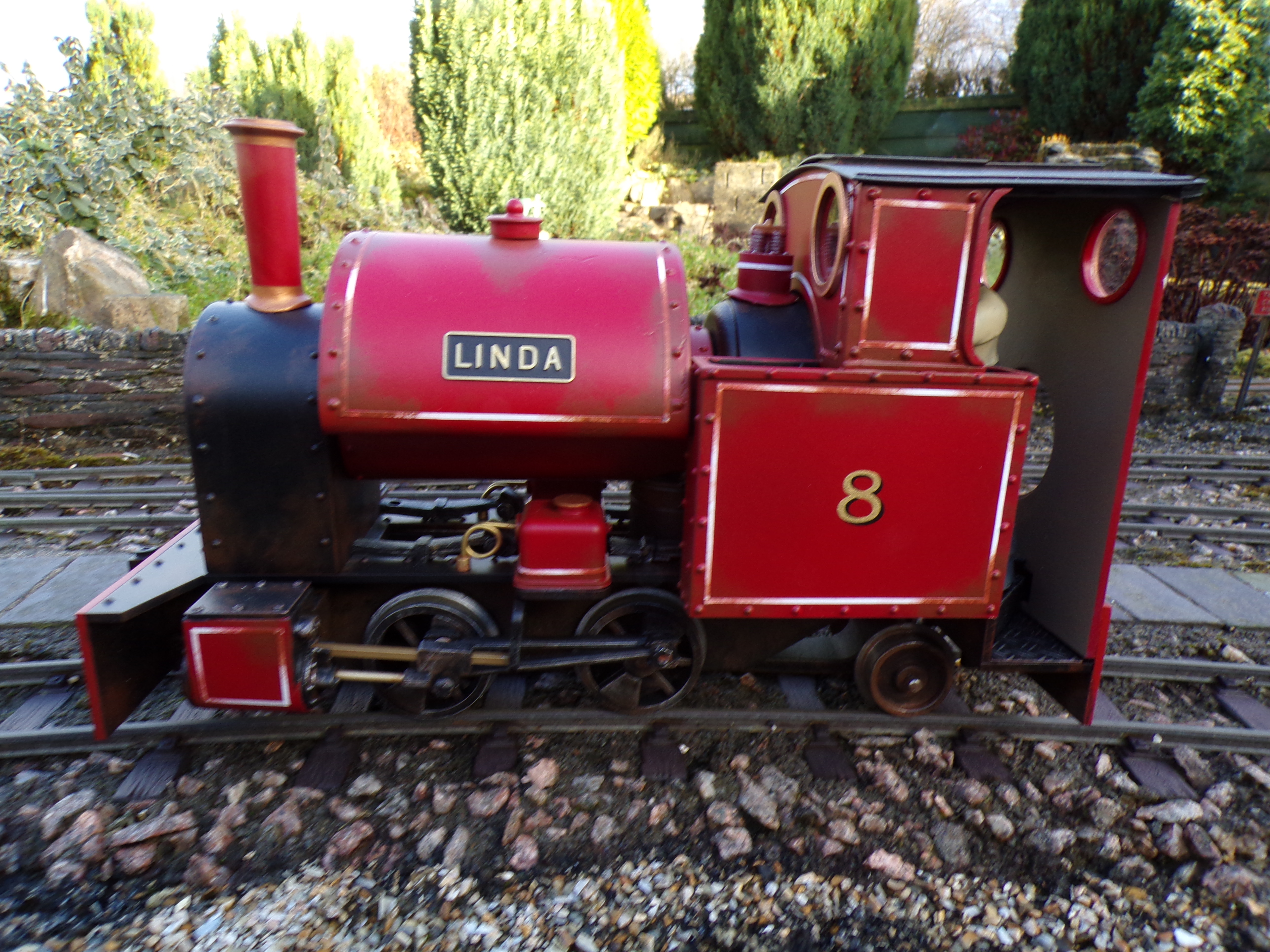

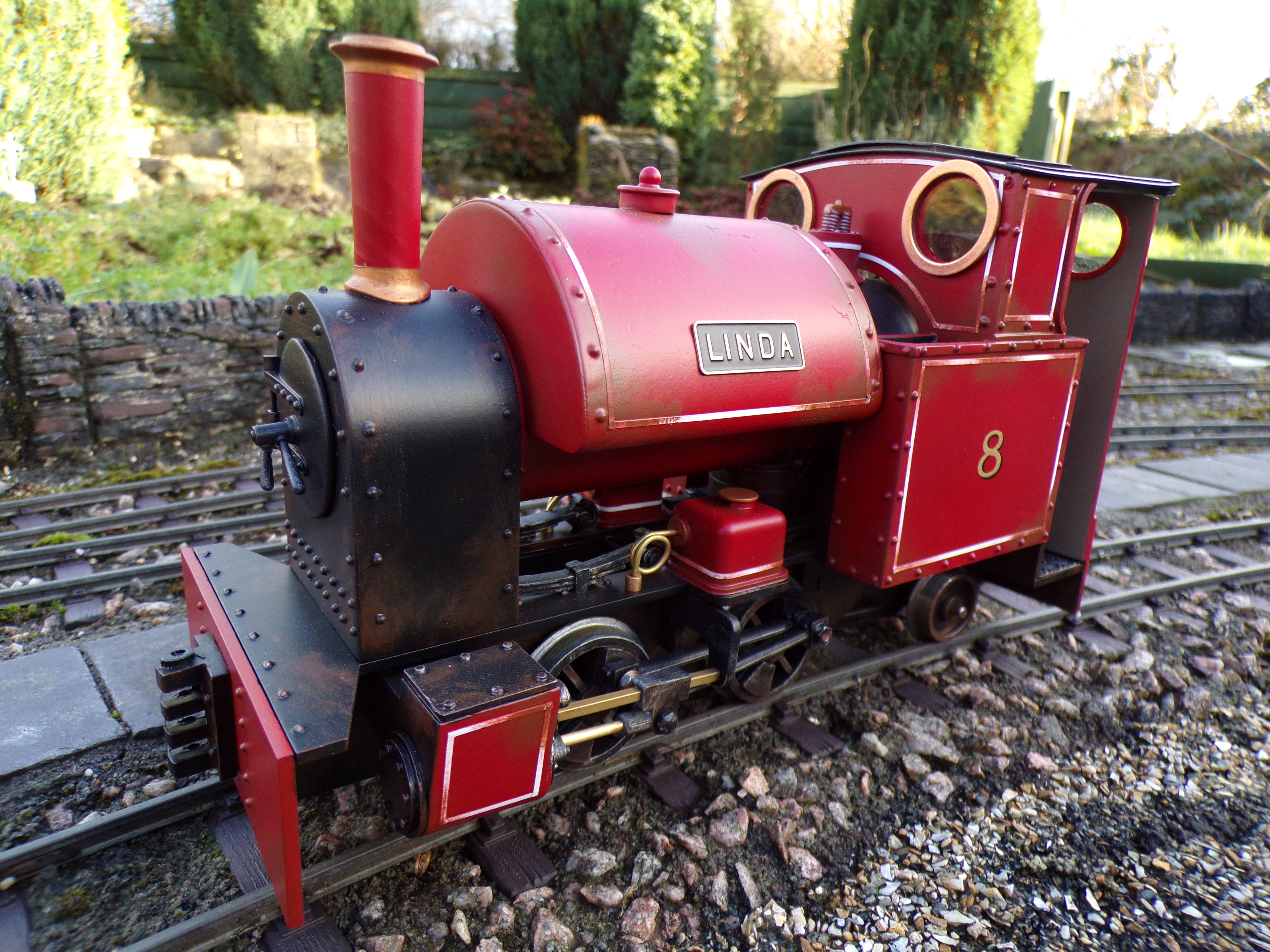

For various reasons (excuses) I have been unable to give you the final images of the Kerr Stuart built, Hunslet overhauled loco, which now runs as Edward Thomas on the Talyllyn Railway. The Boot Lane Works kit enables the builder to choose which version to make as parts are included for both.
As previously described, the only problem encountered was to get a smooth surface on some of the flat areas of print, common to the method so hardly unexpected. Other than that it is a well produced kit of parts which all fit very well. The long awaited AAA rechargeable battery pack fits comfortably inside the boiler and is easily accessible by removing one screw from underneath the smoke box, releasing both boiler and smokebox together.
Plenty of space for the RC Trains receiver inside the saddle tank, which is also removable.
Additional weight was necessary on the trailing pony truck, even after fitting solid steel wheels to replace the printed ones supplied, also in the smoke box.
Looks great, Peter. Love the colour scheme and, of course, the name.
Looks like a well designed kit. Always a pleasure to see space between the boiler and chassis.
- -steves-
- Posts: 2445
I am not sure I would have the guts to line a loco so well and then cover it with weathering, that takes some doing
Looks lovely ![:D](./images/smilies/icon_biggrin.gif)
![:thumbup: :thumbup:](./images/smilies/thumbsup.gif)
Very nice that Peter. Love the colour and your weathering is brilliant as always. ![:thumbright: :thumbright:](./images/smilies/icon_thumleft.gif)

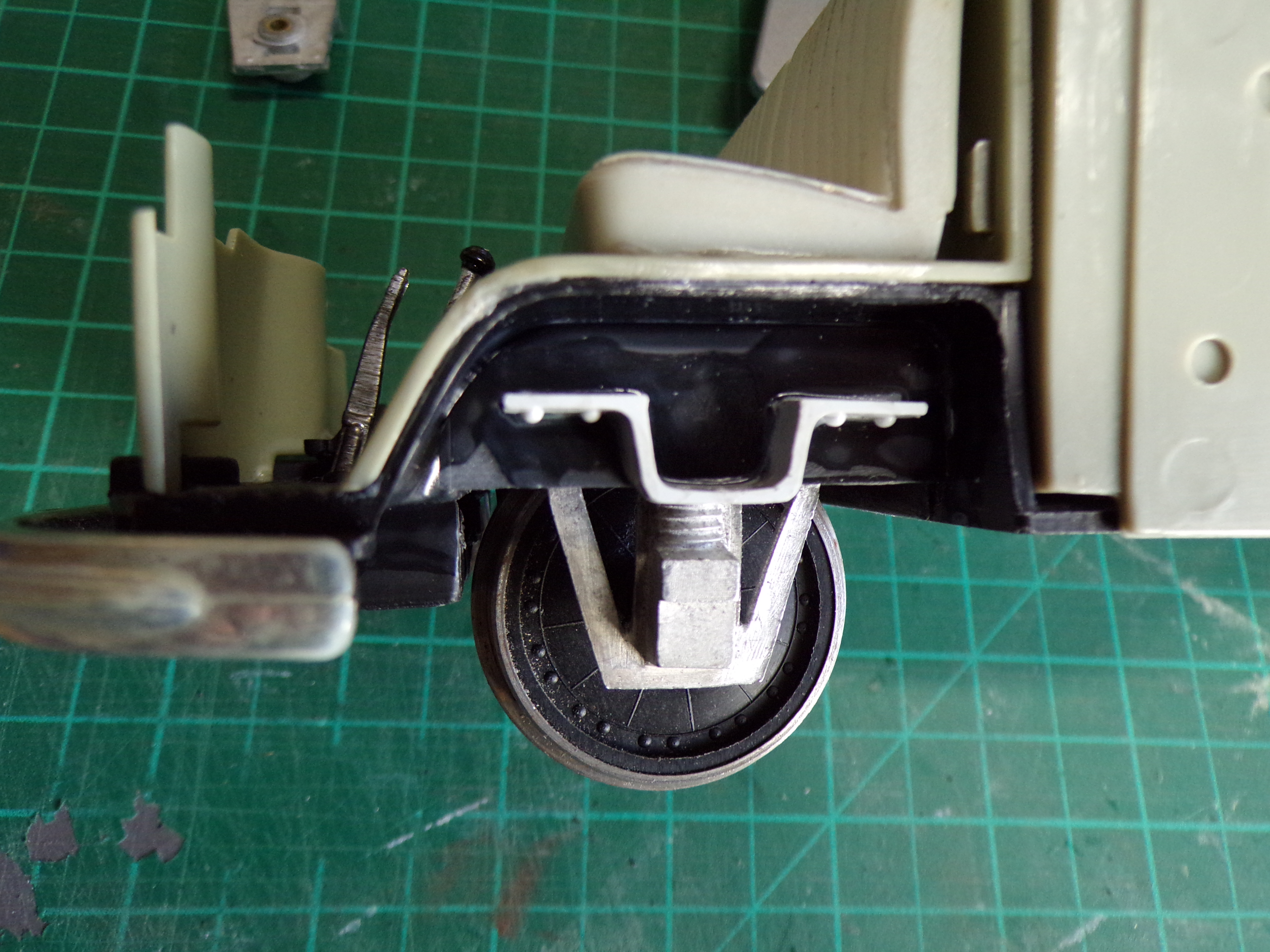

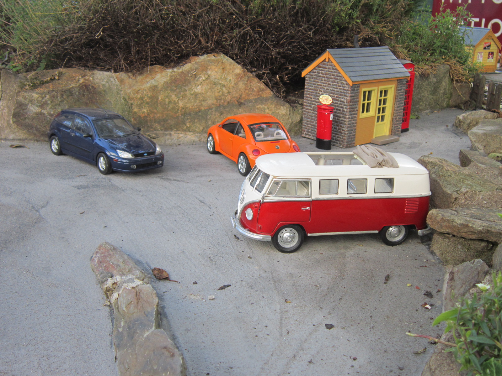

Constantly thinking about what to do next my eyes gazed upon an item which I have shown in the past. This is something I decided not to modify, but time has a habit of changing things and so I set about it as my latest project....
It is the VW camper van, which I have seen real-life photographs of, having been converted and even extended to run on standard gauge line....
So I thought I might give it a try....
It is a nice model, well detailed die-cast body with opening doors, sliding sunroof, detailed interior etc.
Way back in about 2014 I did convert it to RH drive but had no plans to cut it up at the time. Once separated it looked possible, although tricky, as the plastic chassis appeared to be anything but keen on the idea. However, there seemed to be room within the body to accept the flanged wheels of the same diameter as the road wheels, so out with the razor saw and off we go!
This is going to be interesting to see Peter, but all your builds are interesting to watch it develop into something that truly inspires me and I guess other members too.
