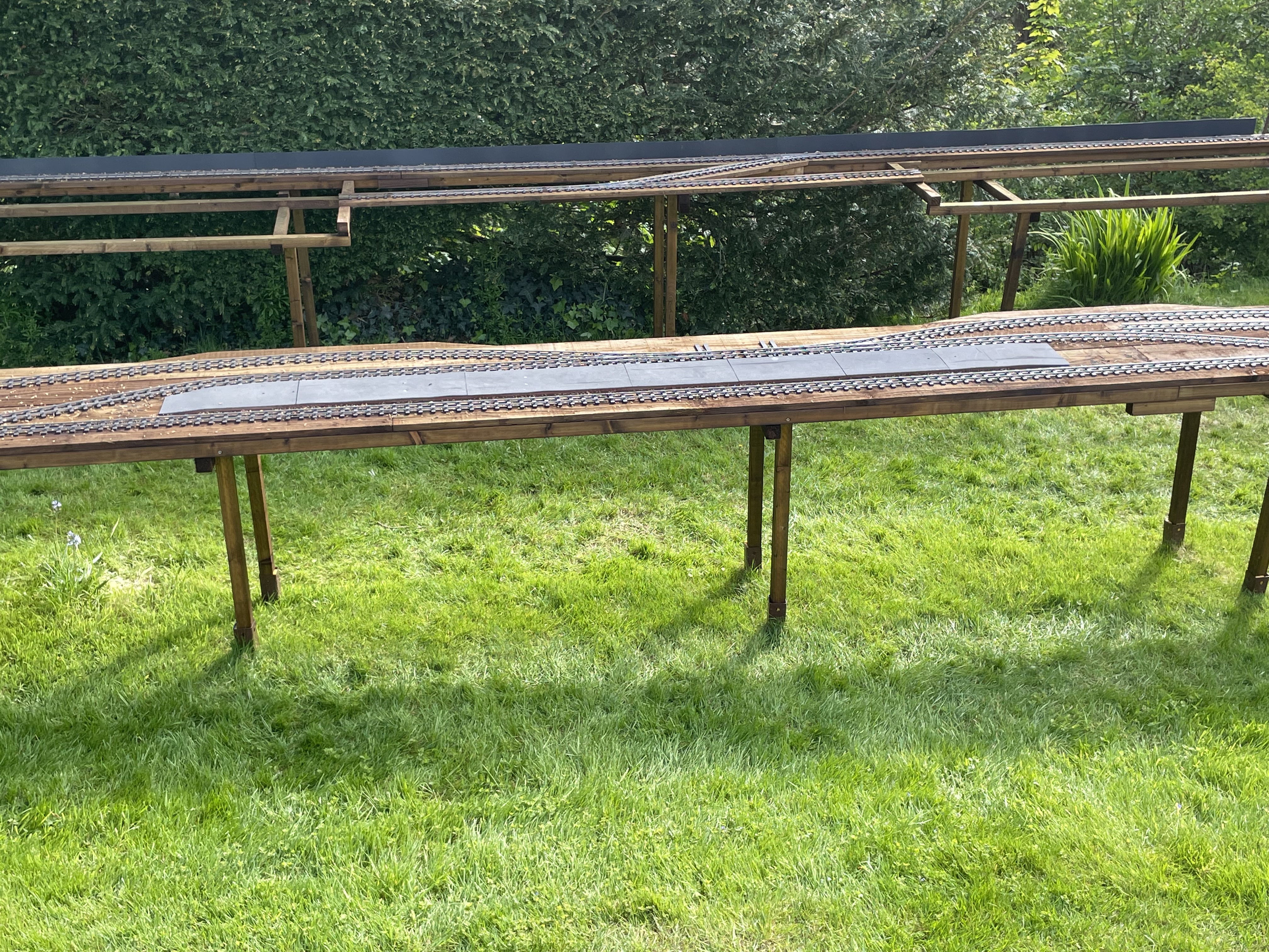

I have family visiting at the moment. A running day was held in mostly sunshine today with much of my stock in action:-
Given a good ration of hot sun on the platform surface it was found that the 2mm gaps I had left for expansion were not enough so further thin slices were excised. The black foam board was curling away from the glue so it was replaced with the original piece of recycled plastic. I think this may now work as, so long as the gaps are big enough that they ends do not meet when hot the material will probably stay fairly flat. The gaps do not detract too much from the appearance as far as I am concerned.

gilfachphil
- Posts: 429
Hi Rod,
Thanks for your suggestion. I think it would need a very special grade of plywood to survive outside in the climate of West Wales. I know that there is a totally waterproof form of MDF but it is very expensive.
At the moment what I am doing seems to be OK. It has been hot and sunny today and the material does appear to have stayed flat mostly so I think I will persevere with it as it is inherently waterproof and here!
