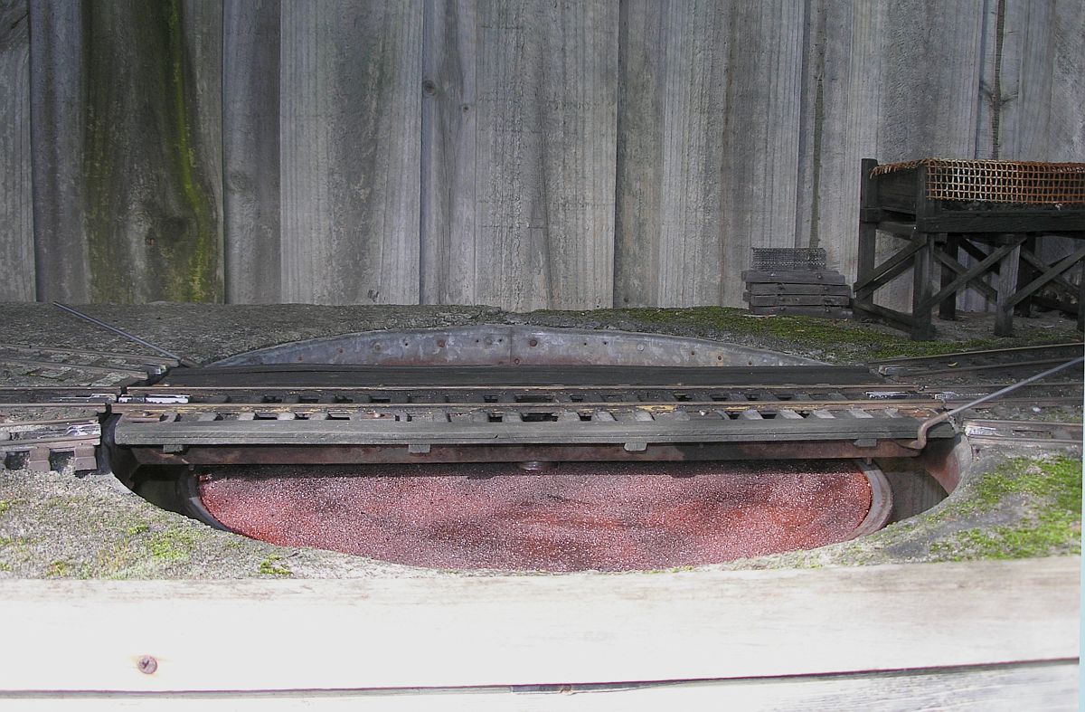

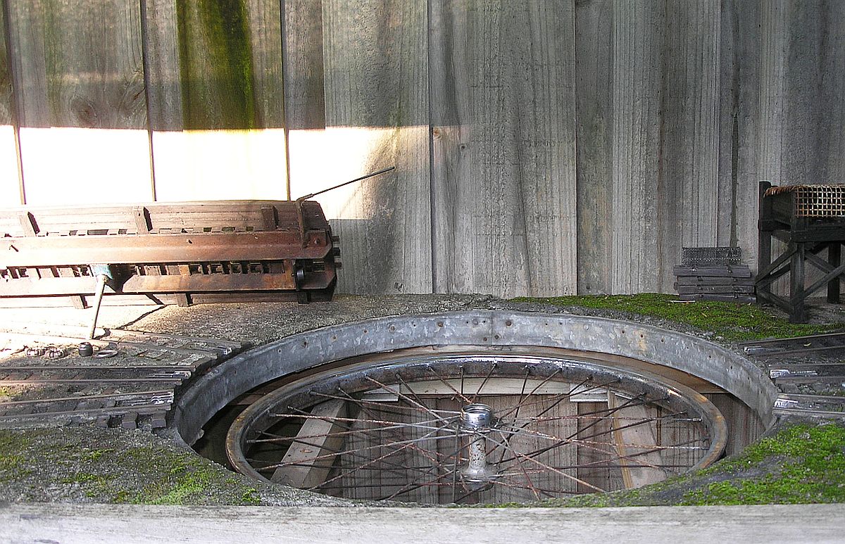

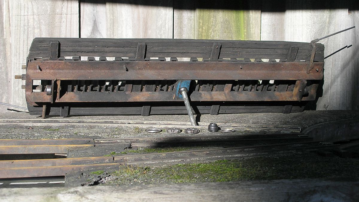

A week of sunshine has got me in a maintenance mood, so thought I would attack the turntable at Leawarra. The ply "ground" under the table had swollen up and was impeding the action of the table. Cut out some new ones, and two coats of paint saw them (two halves) ready to go back in. Removed the table and cleaned and replaced the grease in the ball bearings, spread some sand in a third coat of wet paint topped with another coat and Bob's your uncle.
Turntable underneath and bearings.

The "pit" which looks a lot like a bicycle rim :shock:

And the finished "ground"

Now there's a novel use for bike parts. :salute:

I really liked that too!

I like the mechanism for the turntable. Neat bit of lateral thinking.
