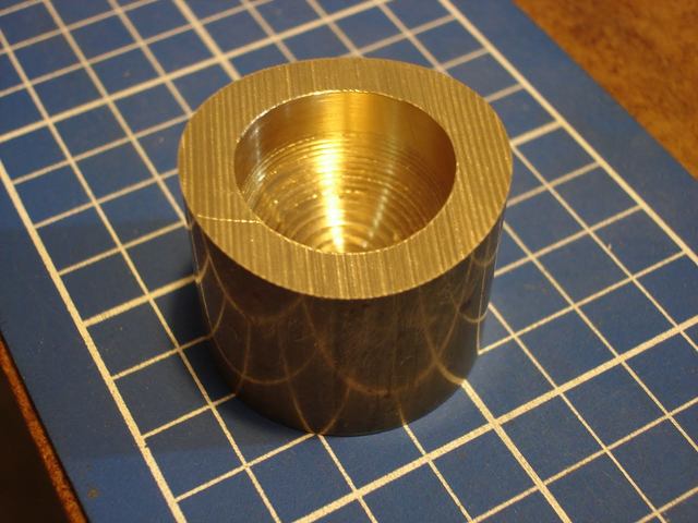

I used CNC technology to produce the required radii for the dome, it was so enjoyable that an internal radius was generated too
Dome base -
Dome bore -
Superglued onto a mandrel. Many increments on the exterior, so quick to smooth with a file

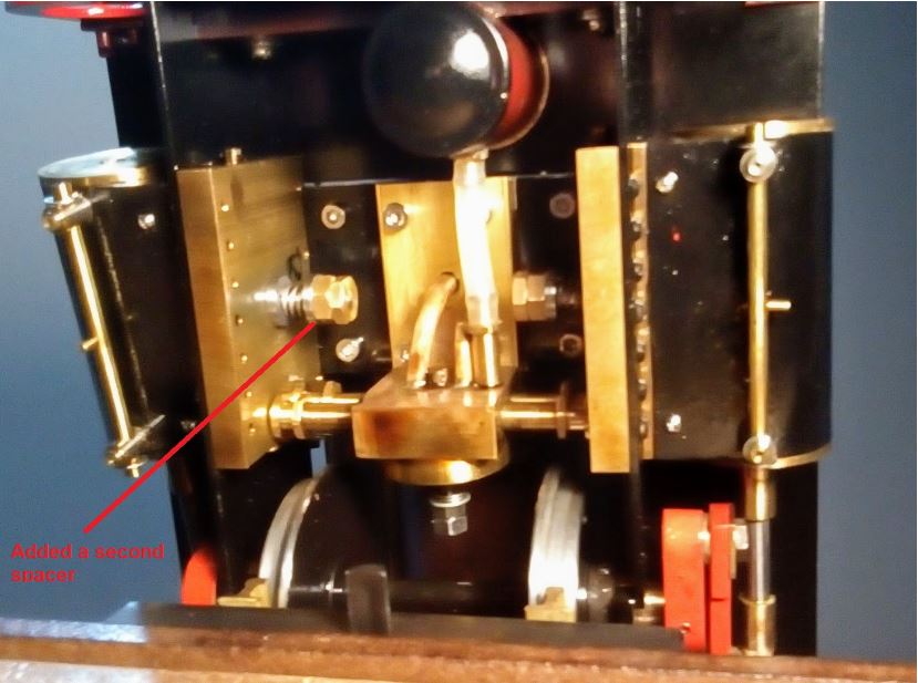

On the previous run when starting on the grade a large steam leak was found at the port faces, so I stiffened-up the trunnion springs using spacers, and this appears to have done the trick.
