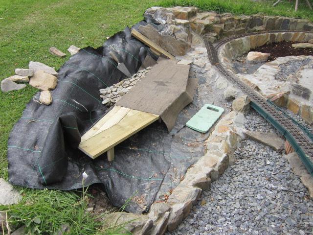

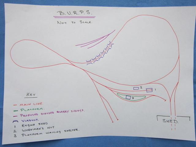

So, just perfect to begin one of the railways features which has been on my plans almost from the start..... The disused quarry sidings!
Below is the track plan which has been shown before, but gives you the idea of what I'm trying to achieve and where it is sited.
I have used the same method of construction for this as the running lines, mainly because it is so much easier to attach track to a wood base than concrete or stone. The sidings will be laid with '0' gauge track with most sleepers removed to represent light weight rail. Points will be home-made 'stub' type for appearance only as this is not intended to operate. The scene depicts two inclines feeding several storage sidings, all of which will be semi-derelict.

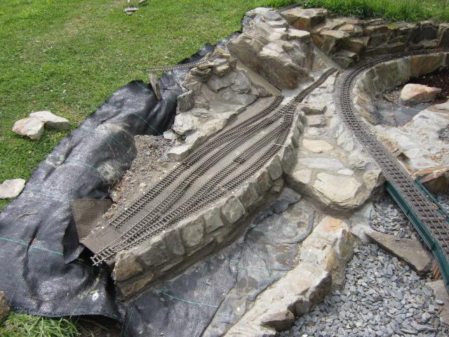

This was the stage I reached yesterday. By the end of today I had laid enough stonework to create a front as well as a rear stone quarry working with the two inclines in place. I will post pictures of the current state, perhaps with some track placed to show the idea.

Post by Peter Butler » Mon Jul 07, 2014 11:05 pm
Compare this picture with the one above to get an idea of the plan I am trying to achieve.
The two inclines with their tracks can be seen and the storage sidings laid out to show how many I can fit into the space.
Some more track will be added on the left hand side which would have originally connected with the main line (before closure) and feeder lines at the tops of the inclines to show where the raw material came from.
I need to make another 5 or 6 stub points but have worked out a simple way to do them as they are cosmetic only.

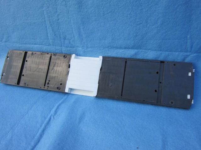

The weather here today has been wet so I spent the day working on my second Bachmann carriage.   I have spent enough time looking, thinking and planning how to do the conversion to centre balcony it was about time I began.

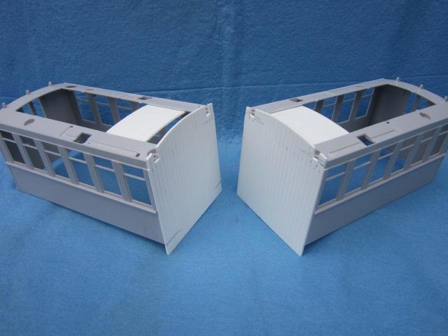

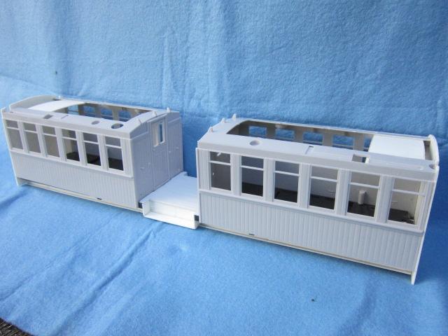

First thing to do was cut the thing in half.... no turning back now!
I decided to fit solid ends without windows...
Next job was to cut off the clerestory from the roof.....
Two bracing pieces are fitted to prevent the width altering when that too was cut.  In fact two roof sections were cut as each piece was longer than half the total length.  By removing the balcony ends but adding extra in the middle the overall length is about the same as the original, but the passenger compartments are reversed and the end doors now face each other.

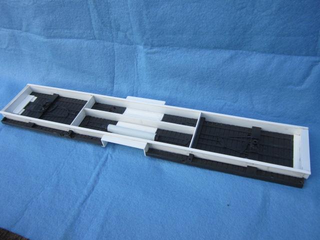

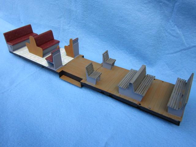

The floor section had to be chopped at both ends to make the new squared-off end panel fit, then the floor itself cut in half end an extension piece fitted to create the centre balcony and step.
The two units put in position on the floor section to try for fit.... and they do!

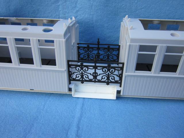

And finally (for today anyway) balcony railings put in for overall effect which I must say I am very pleased with....

Thank you Jim, I'm really enjoying this one now I have started.  Today I have put a 'canvas' sheet on the roof and strakes across, also fitted padded seats in the First Class compartment.  There will be wooden slatted seating in the Third!

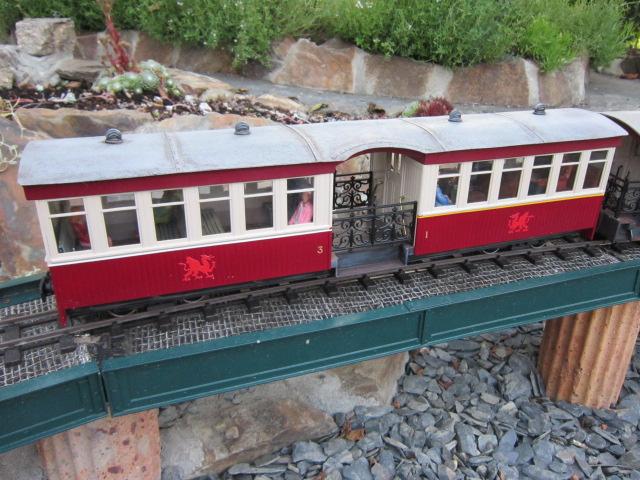

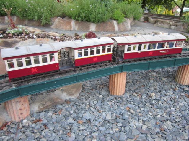

Well, back in circulation following a very pleasant few days with my pal and several bottles of red later I have managed to get back to my coach conversion.
The roof design is shown below with added headroom for easy access.
I don't know whether there is a prototype for this but I think it adds interest to the otherwise straight line. It also helps to strengthen the gap between the two passenger compartments and is strong enough to lift the coach.
A material covering to represent canvas, painted and weathered to show signs of wear complete the picture.
Seating arrangements are for First and Third class passengers. First having padded seats and wooden slat bench seating for the rest!
Coach sides are painted with rattle can acrylic paint in two colours. There is a fine vinyl stripe at waist height to define the class. Gold on the Observation, yellow on First and white on Third.
Naturally the line's logo, Red Dragon, appears on the coaches too!
Balcony railings are from dolls house fittings suitably cut down.
So that only leaves one coach to finish in another individual style.

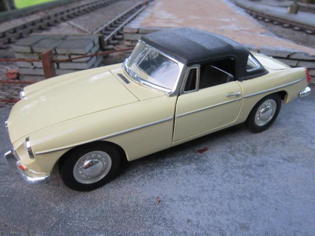

Another great find today!
A visit to a town with many antique and collectable shops had a road vehicle just right for my display.   Priced at £15, I managed to get it reduced to just £12...... bargain!   I probably would have given the asking price anyway as it is an unusual model I have never seen before.    Made by Corgi, die cast and right hand drive (for a change).
MGB, complete and in very good clean condition.
Just found one on ebay....... boxed and mint £85.00
