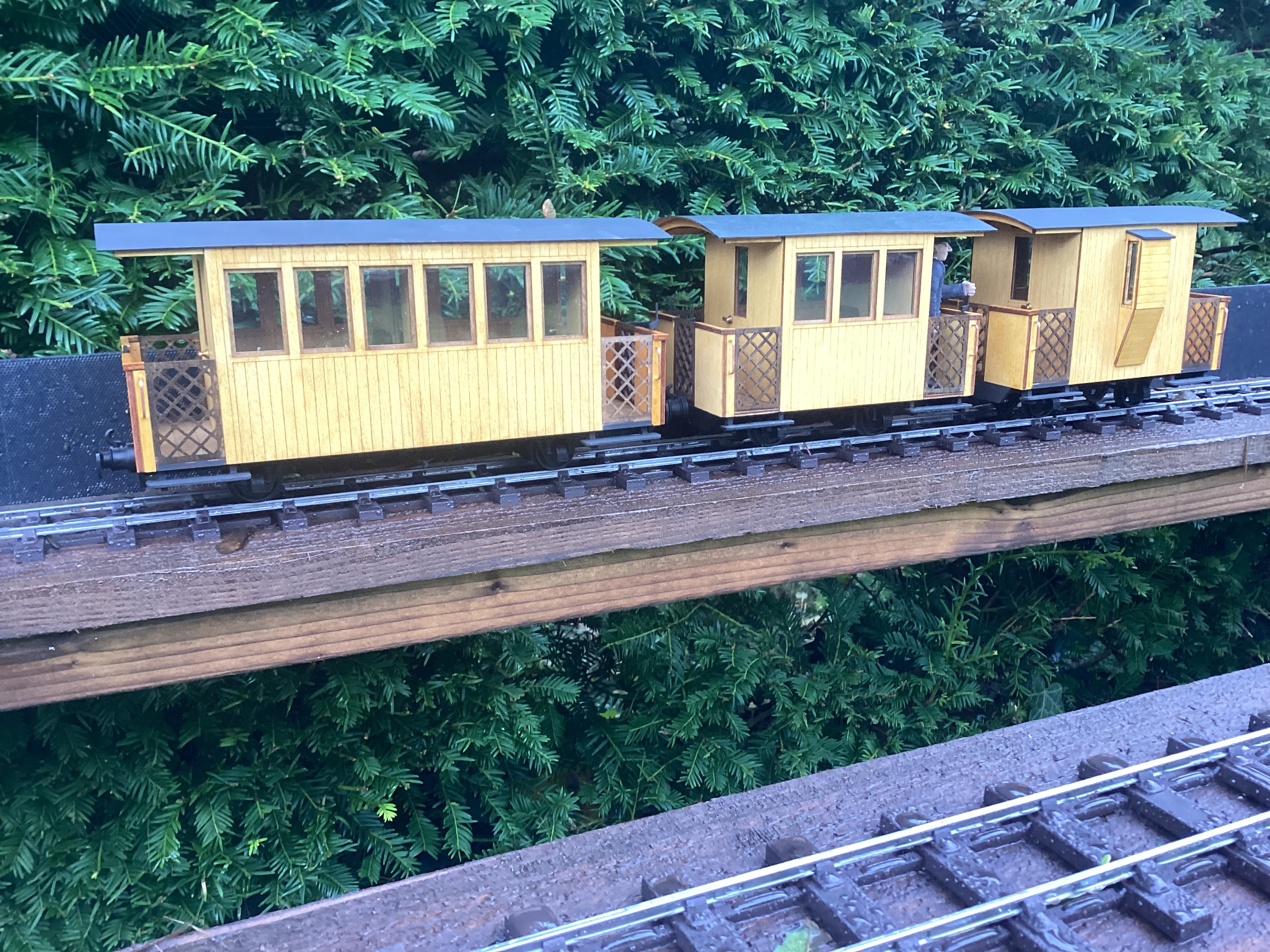

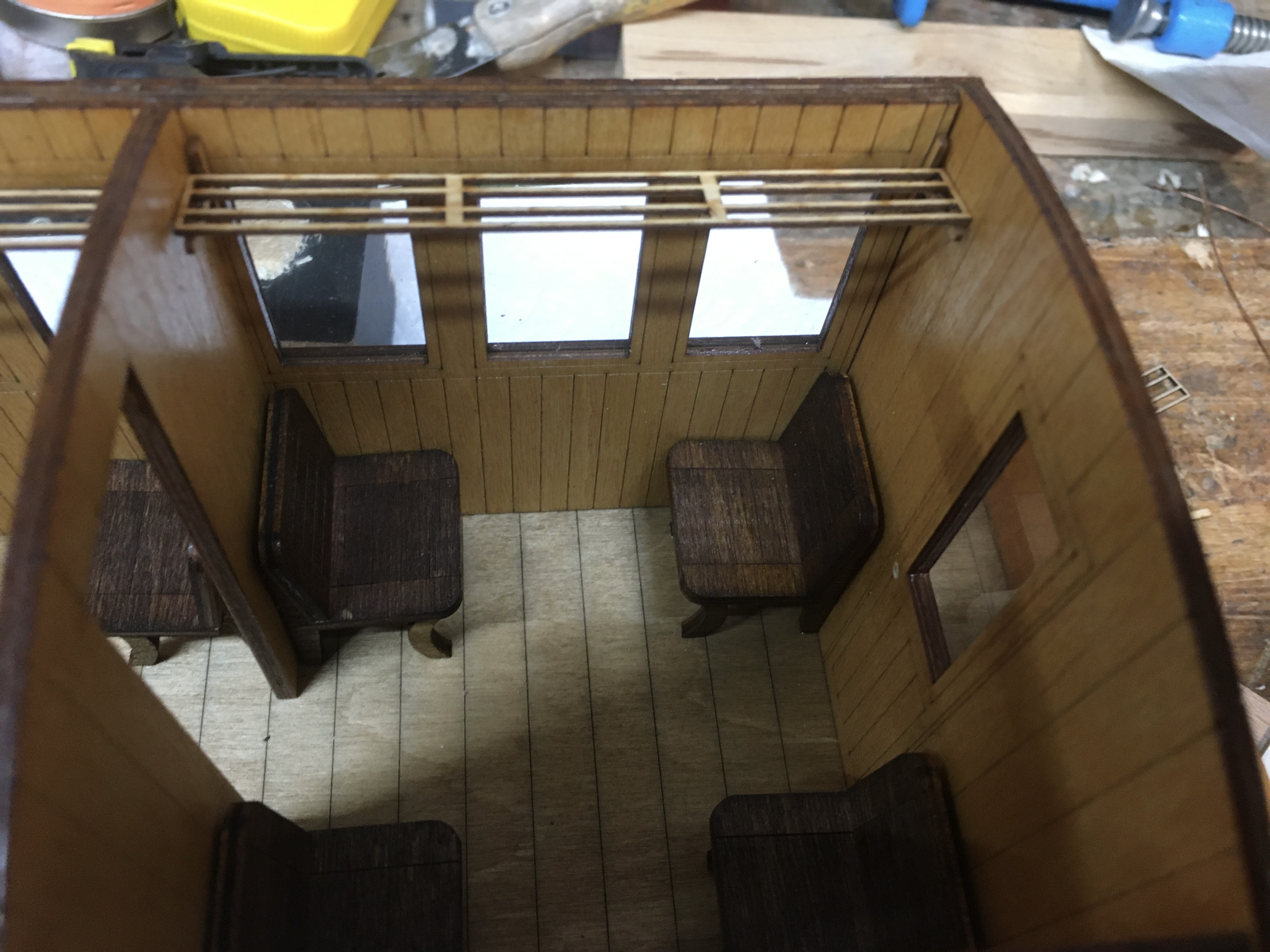

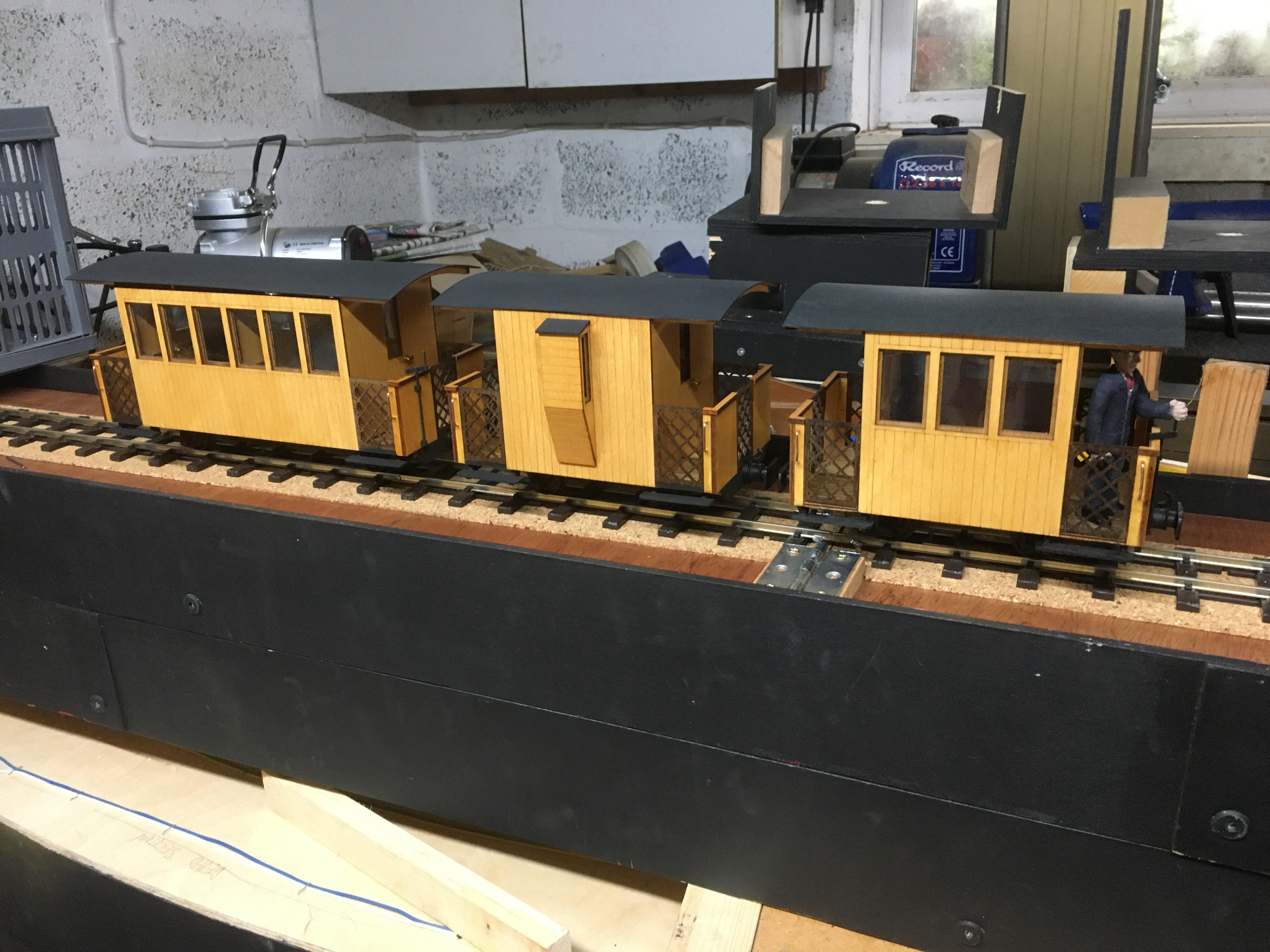

Luggage racks in the long coach being one fiddly task done today. The roofs were varnished underneath and painted with dark grey masonry paint on top (B&Q test pots are good value). chassis painted matt black. The lattice gates glued in.
Here are the two new coaches with the original
When we get a dry day I will take better pictures of them on the layout in the garden.

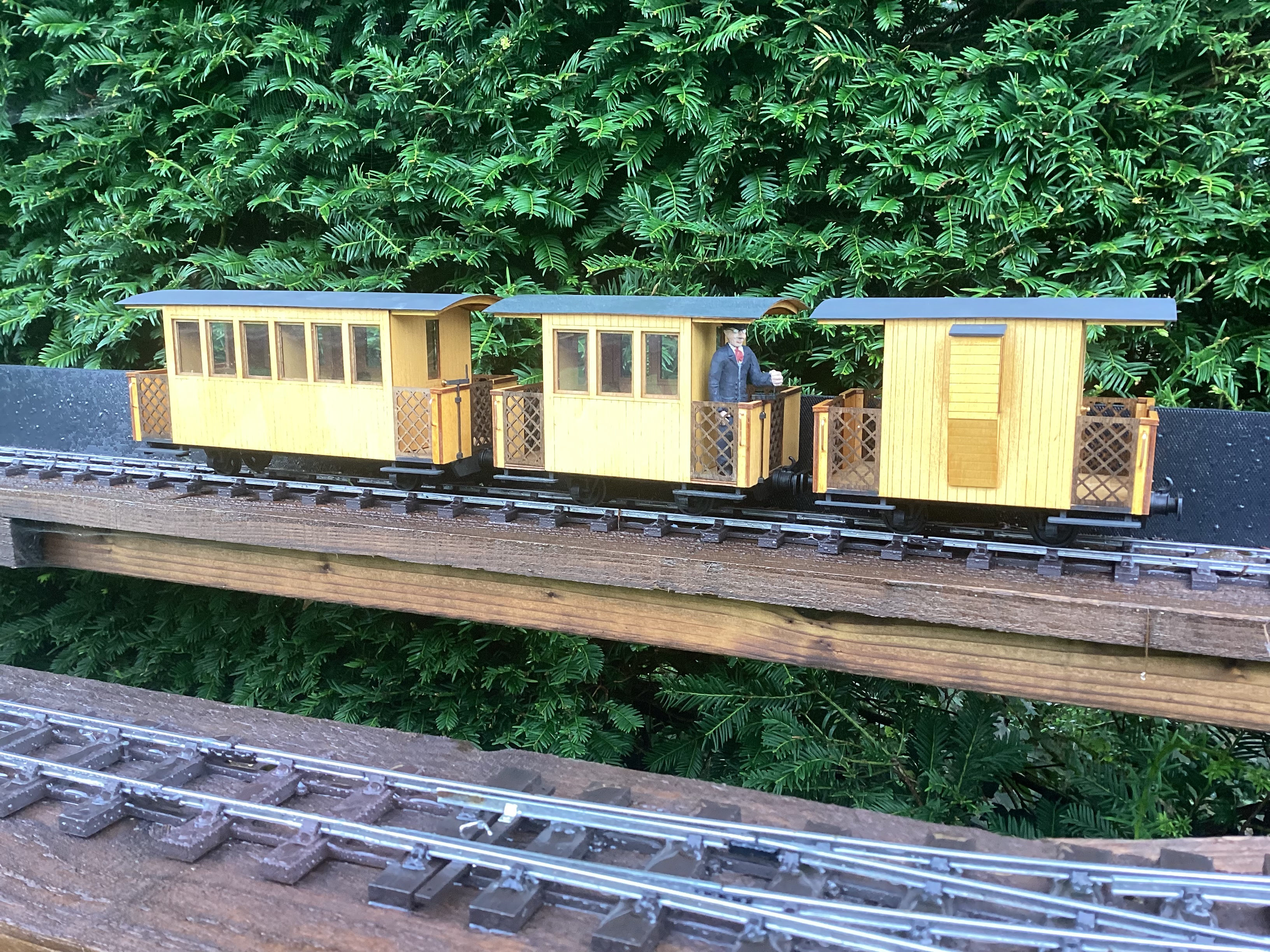

Before the promised heavenly deluge, due soon, I took a photo opportunity:-
I noticed in the workshop photo from yesterday that the roof of the longer coach was not sitting properly. It turns out that the luggage racks were in the way of the roof supports as I had placed them. I will sort that later having removed them for the photos.

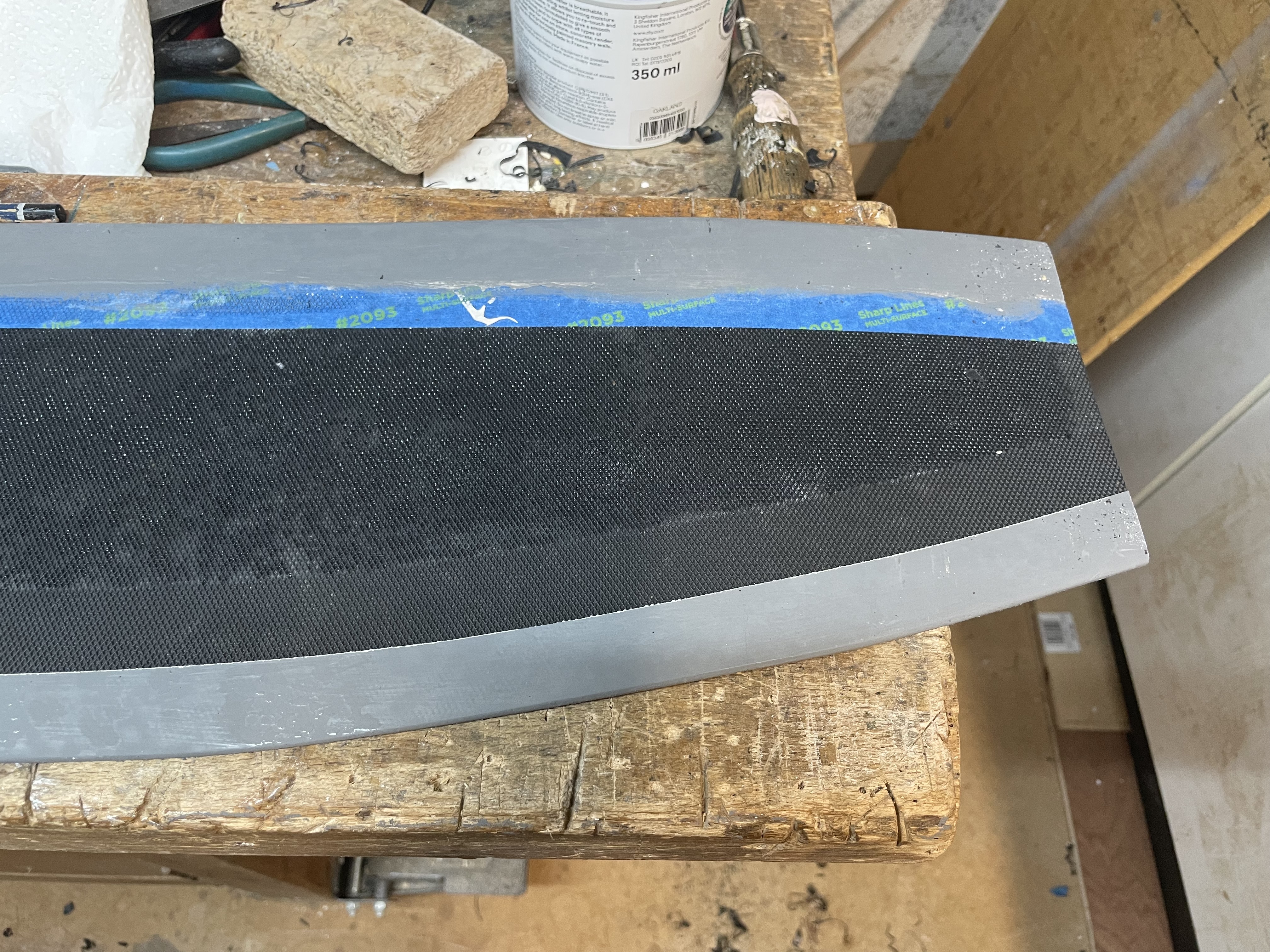

Some progress on the platform surface.
I bought more Cataloy paste last week and have continued filling and sanding the edge surface of the recycled plastic. I would not want to try using this stuff on a car! Three coats of grey masonry paint later and I have here removed one of the masking tapes to show before and after:-
I have cut a groove in the underside at each end where the ramp starts to make it easier to bend. It now needs fixing down and the individual stones indicated with a marked line but it's hammering down with rain just now.

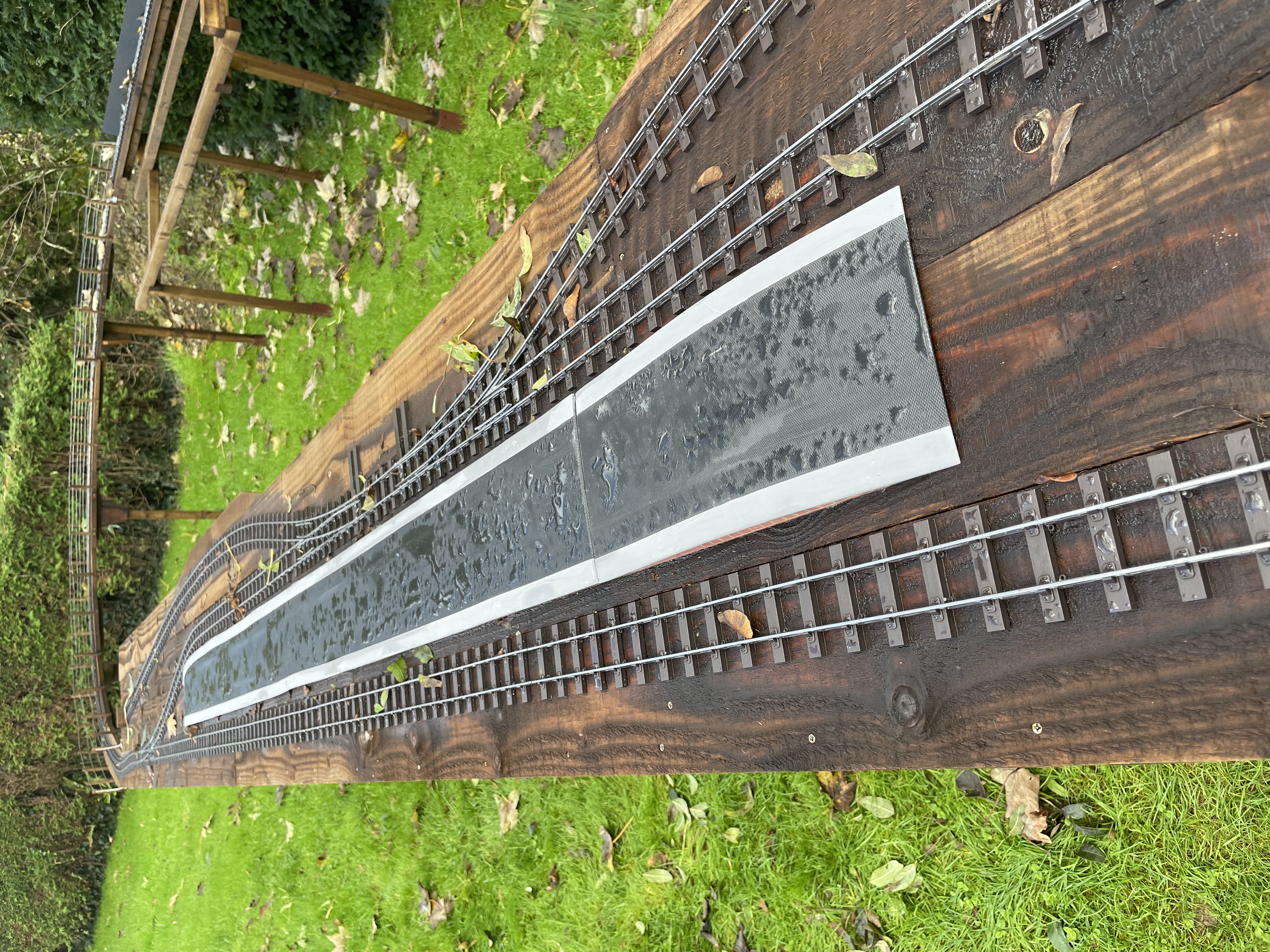

It eventually stopped raining for a while this afternoon so here’s a picture of the whole platform
