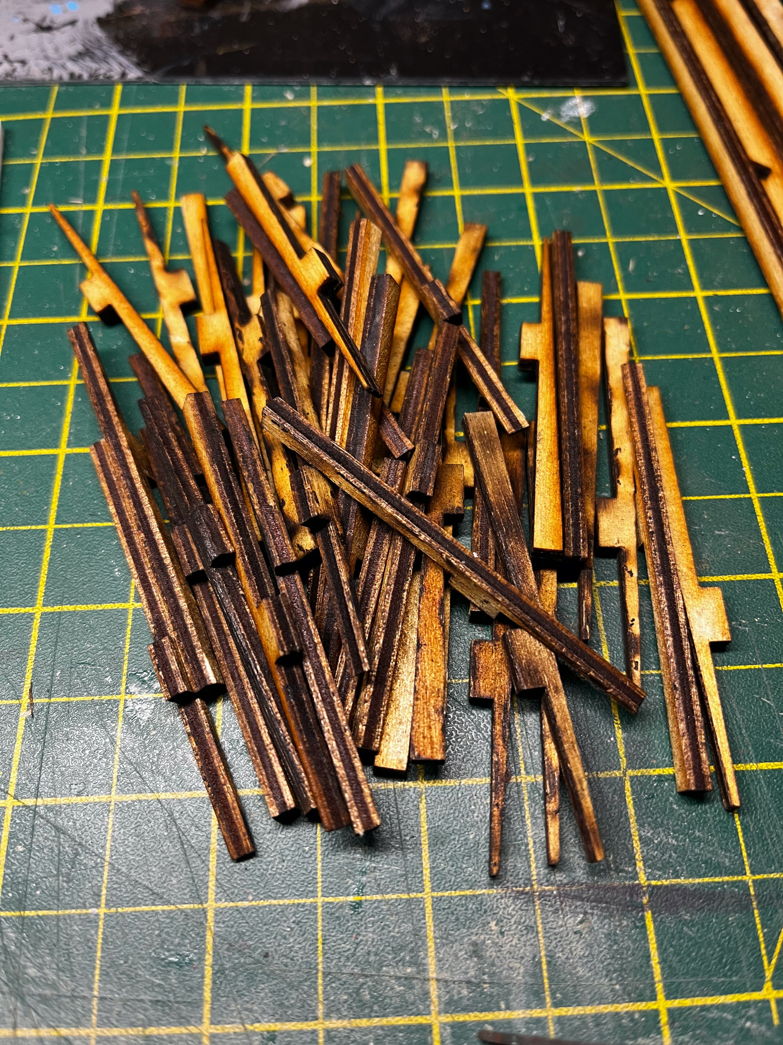

Anyway on to the build. After I opened the box I saw a lot of parts, a lot more than I usually get when I build a kit from someone and there were loads I can tell you. I laid them out, sorry I didn't take a photo of all the parts, read the instructions which were ok but they could have been a lot better, if someone with not to much experience of kit building would struggle I think.
Some of the parts..

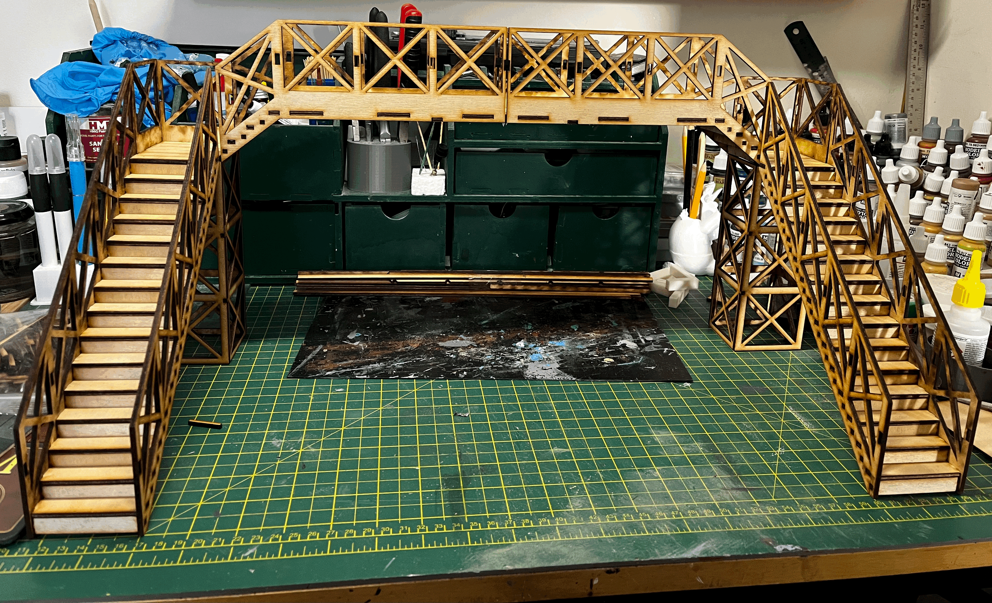

And put together dry on the bench.....

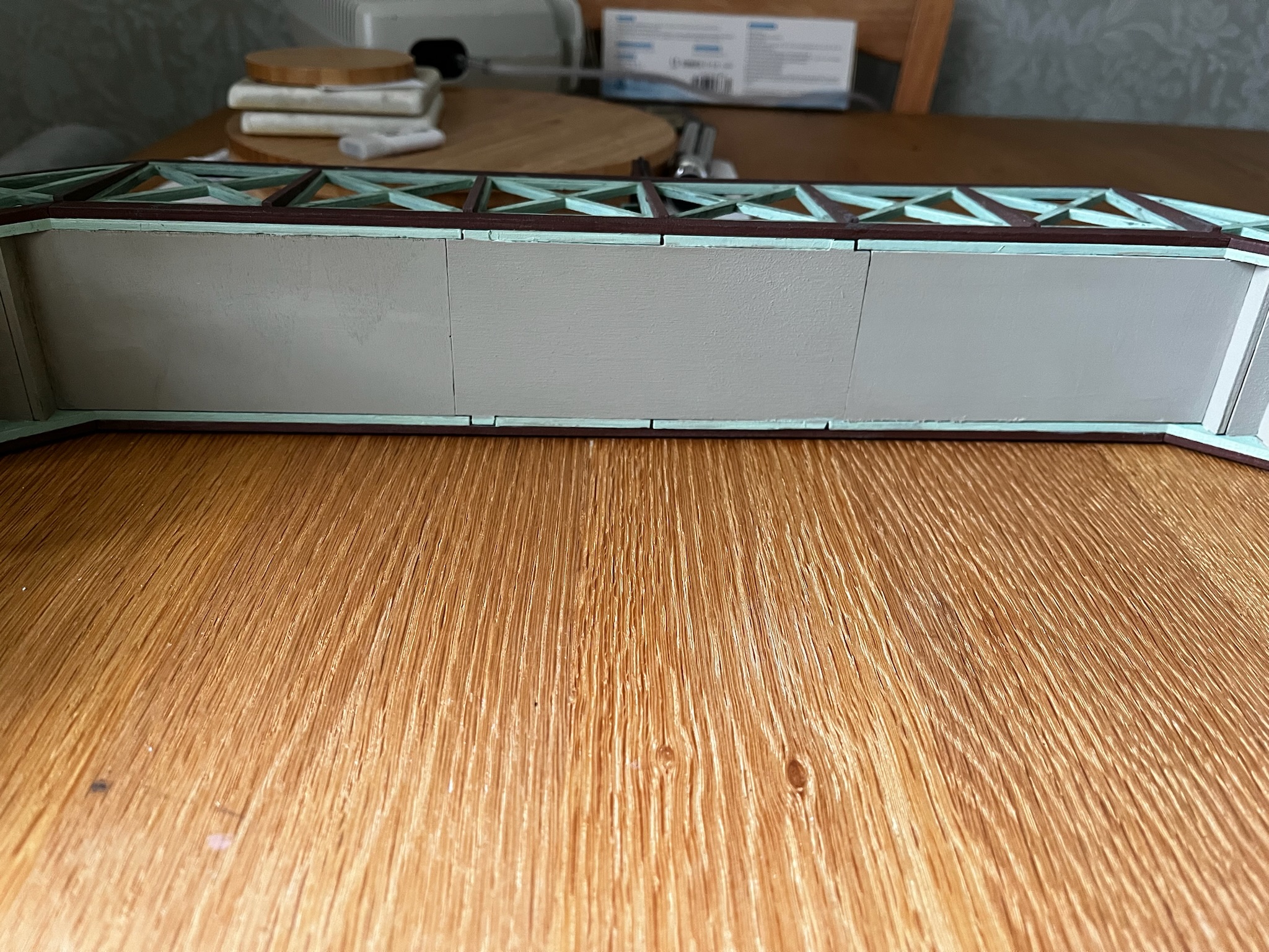

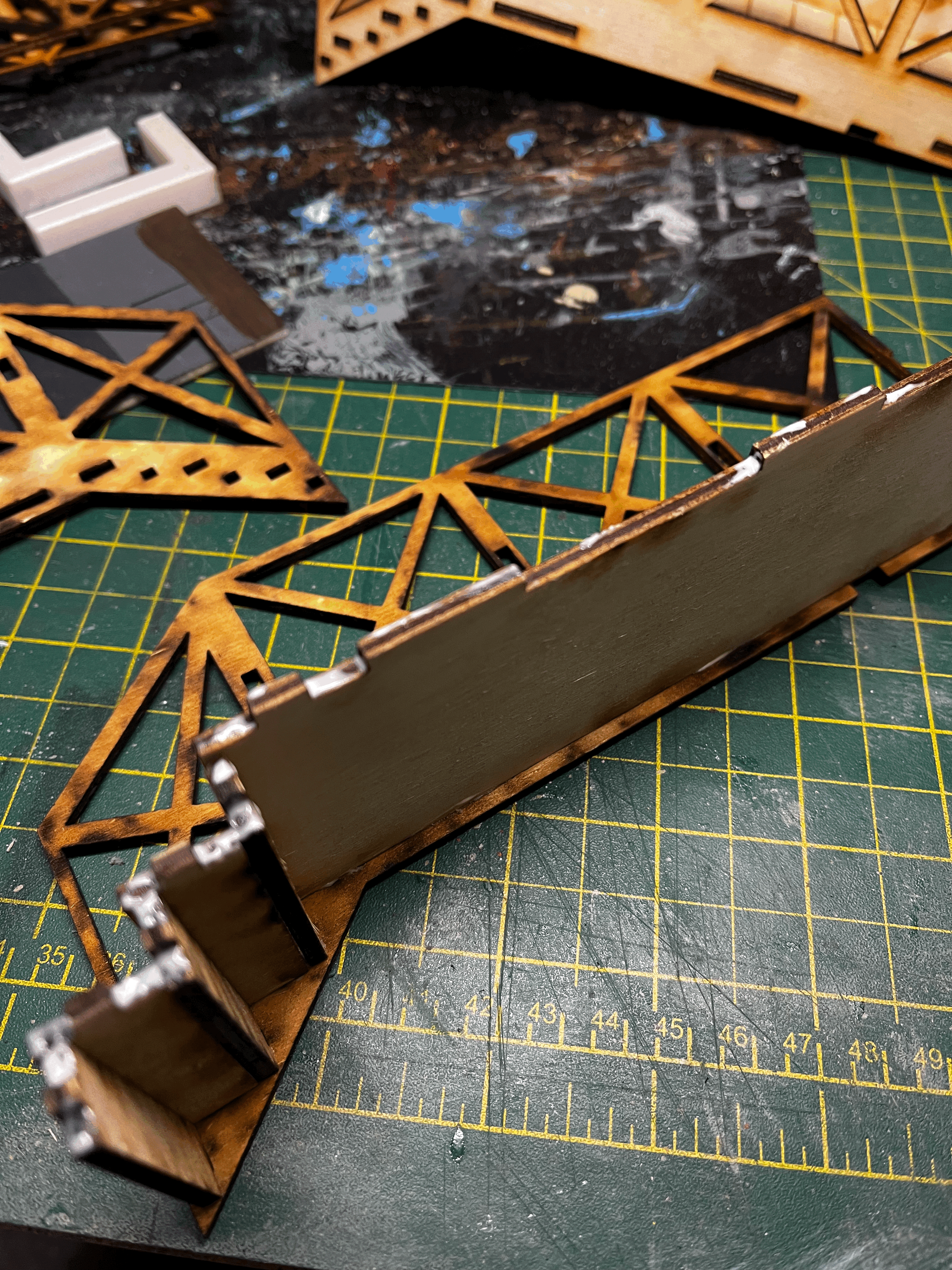

If you notice there are holes in the sides of the steps and the walkway. The straight part of the walkway was ok to hide because there is two lengths of wood that are just the correct length to hide them, but the short steps don't have anything to hide them which I think is not brilliant of the manufacture really. I cut some thin plastic sheet and glued them on to hid them. It was pretty much the same with the long steps, but there are some pre-cut lengths to hide them but there are poorly made in my eye....
The lengths of wood for the long steps sides. You can see that they don't match up and also the short pieces that are put along the sides of the steps don't line up either. I had to file them open a bit to fit on the side and consequently they don't look anywhere near great.

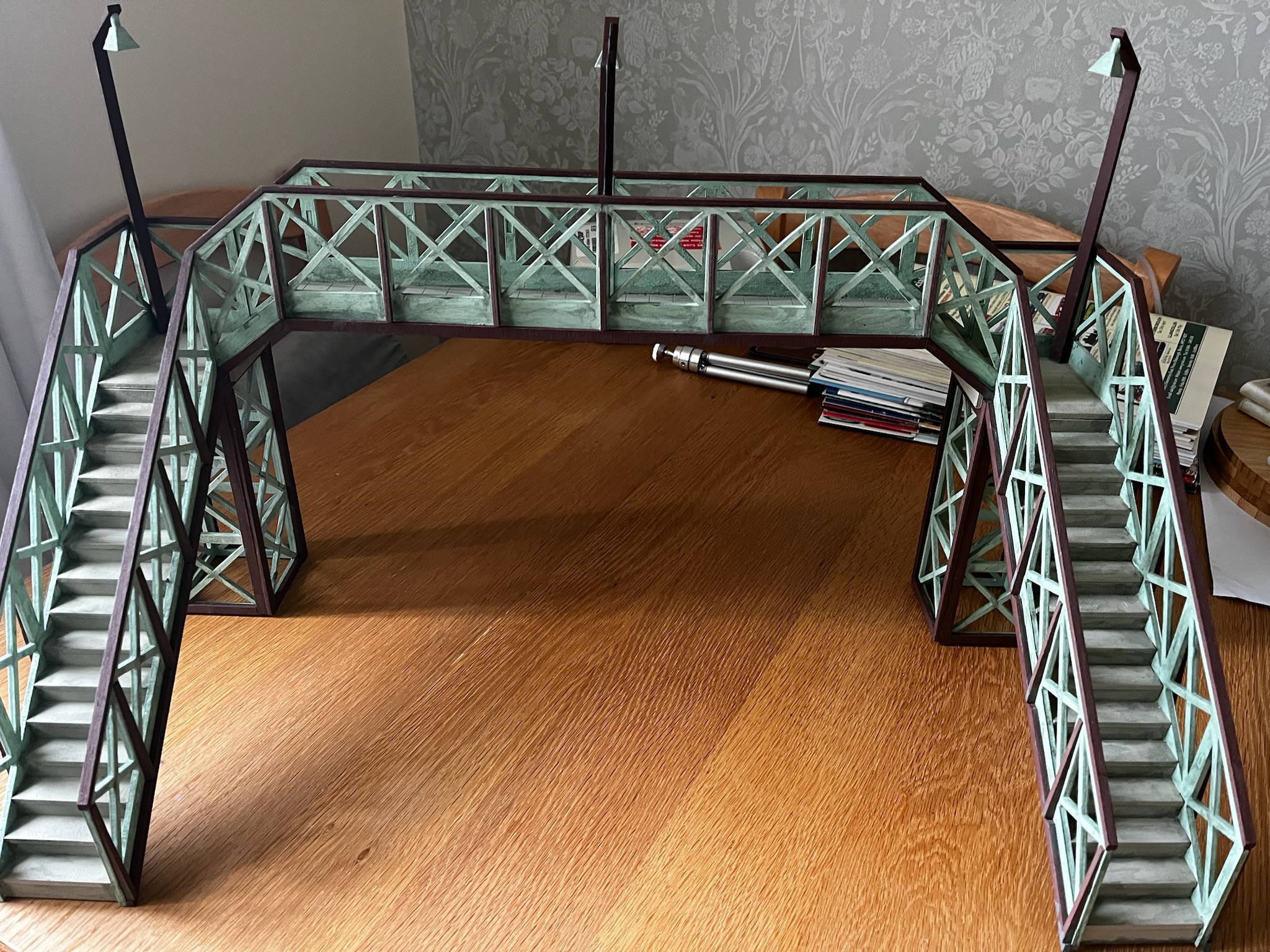

I did eventually get the Footbridge built and painted, that also took a little time to get somewhat decent because the heat that is used to cut the pieces must have been turned up a little bit to high, you can see on the parts that some are almost black, so getting the paint to cover them was a heck of a job, I had to make sure that the coats I had applied went hard enough for another coat to be put on.
Some of the parts..

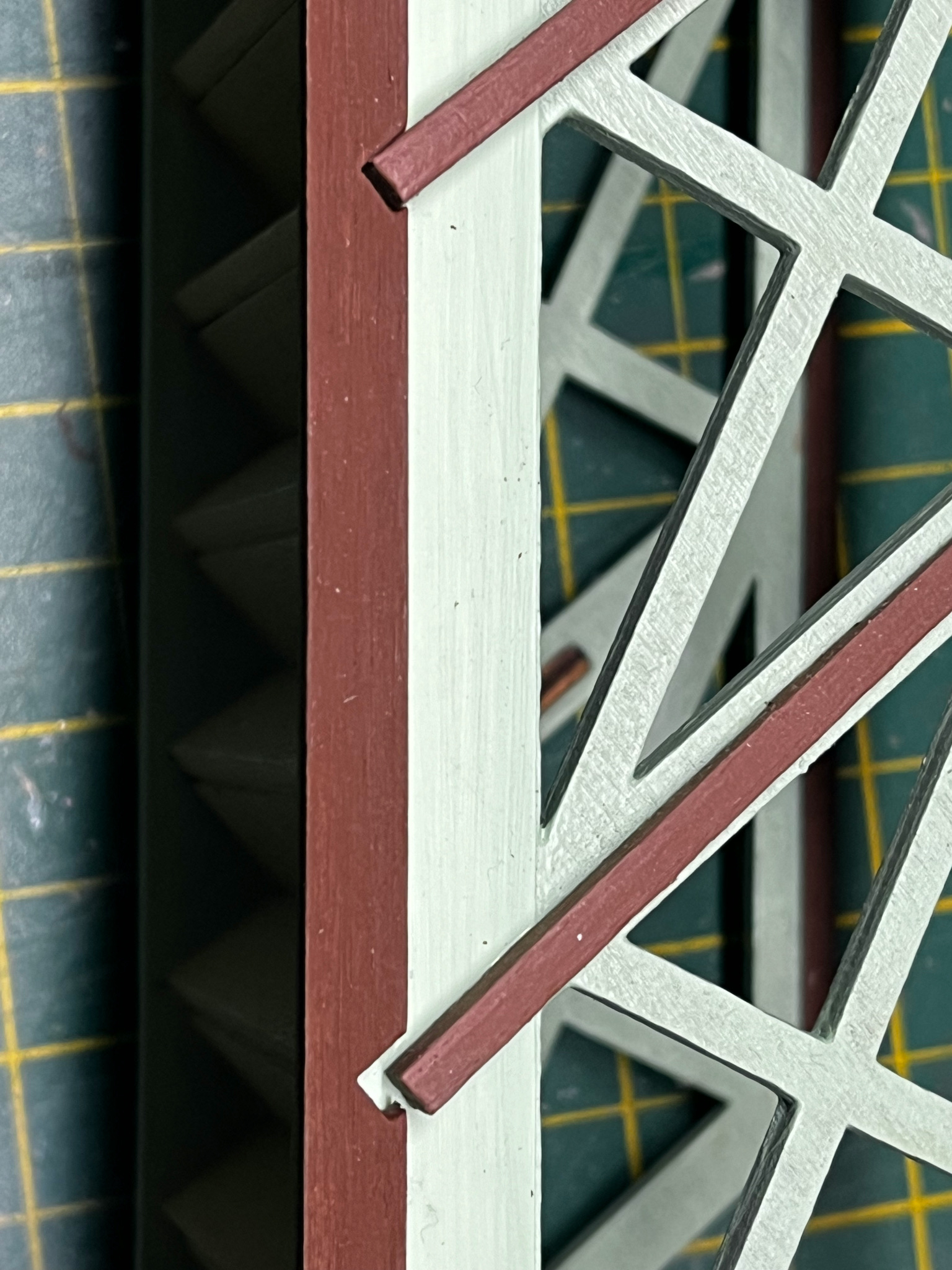

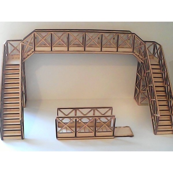

This is the manufactures site photo of the Footbridge...You can see even theirs leave the slots where the steps are fitted. Doesn't look great does it.

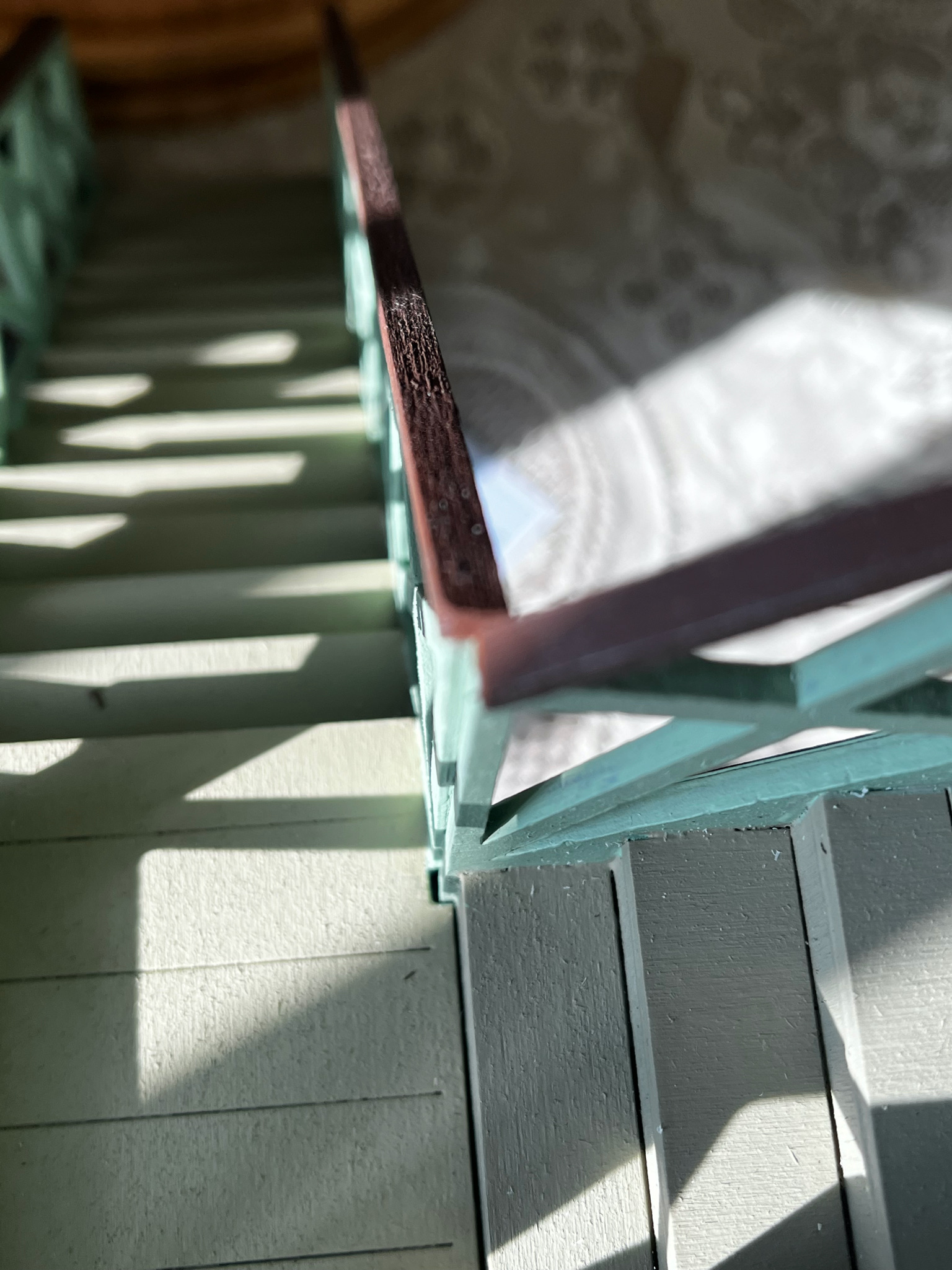

The painted Footbridge..

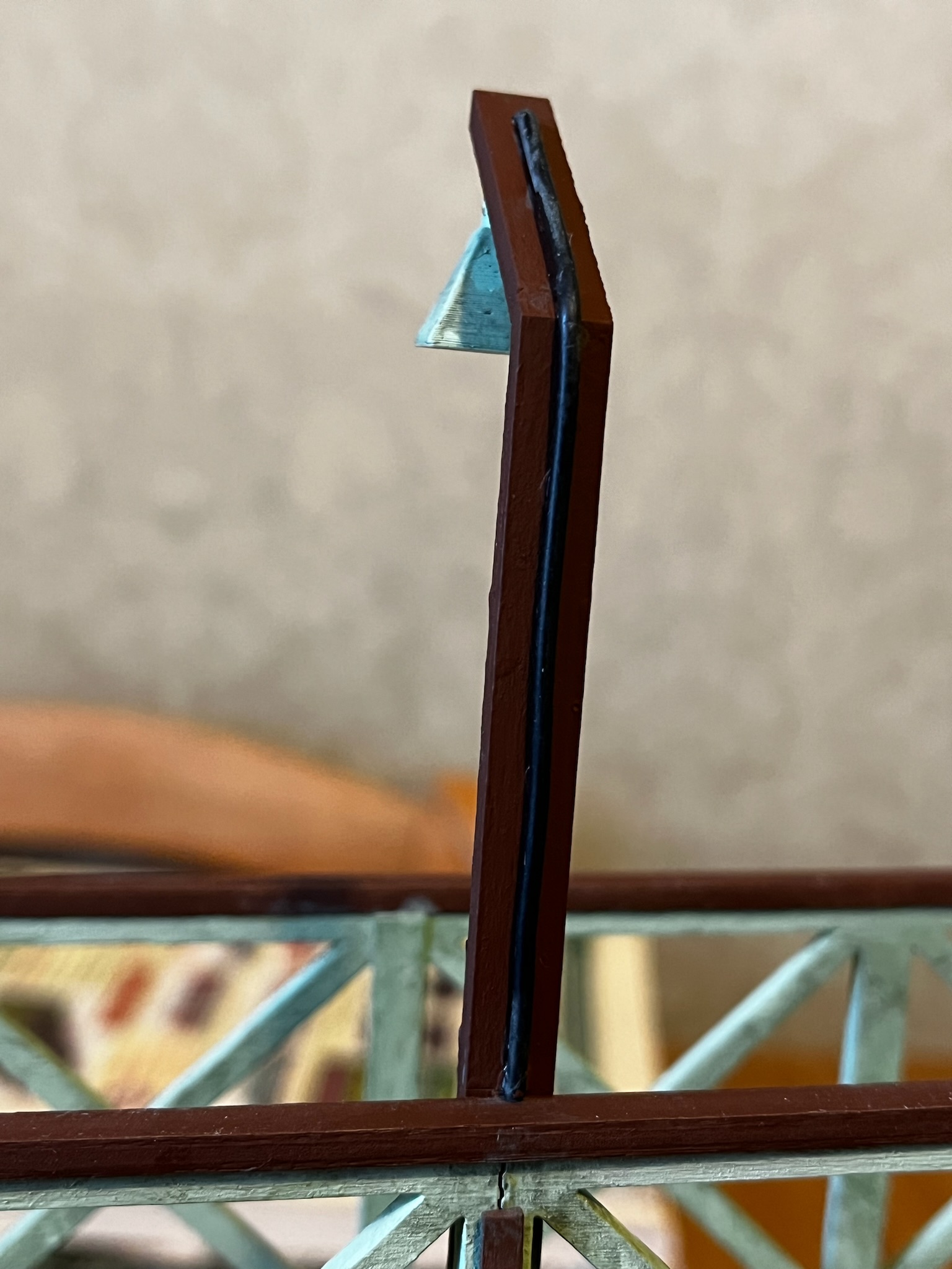

I made some false lights for the bridge, I thought it needed something else to give it a little bit of individuality....I also gave it a small amount of weathering, I don't think I have gone to far, but I hope you members will tell me honestly if it is, I can always tone it down a bit can't I until the real weather gets to it....

That sounds more like a challenge than a pleasurable experience Rod, and I bet it wasn't cheap either!
- Posts: 6028
Re: FINAL NEW FWLR LINE
You've done a cracking job on what sounds like a fairly duff kit, Rod.

There does seem to be a marked difference between your kit and the example..
I wonder if pressure to get everything cut and sent out for Christmas, meant running the laser faster, at a higher output?
I have had trouble painting over 'char' on laser-cut kits, and have not found an answer to the problem?
Some manufacturers say to sand it off, but if you do, the parts end up undersize.

Looking at the kit I would think that it has not had air assist running while the laser was cutting. Air assist tends to reduce the burn/charring to a minimum. Having recently aquired a laser cutter I now know how essential air assist is a what a major impact it has to the final results.

Thank you for all those kind response's, they are very much appreciated. I did want to be able to take the long steps apart because of the size of it, it would be need a huge box of some kind to store it over the winter months, but because the long steps don't meet with the top rails on the walkway I have had to glue them together and now it's very solid...
This is before I glued the long steps. Sorry about the out of focus....
I know that the sides of the long steps a square because I put my metal engineers square long them.
Haven't got a clue why they didn't meet. I was going to put the lamp posts there to keep them square, but they just made it really much too hard to get the walkway on, so that's why I put them where they are.
Thank you Philip, to be completely honest it is a bit duff. I did find a old Garden Railway magazine March 2023 and inside is a write up by Mark Thatcher, who many know is a regular contributor, I think he writes for the magazine, thatβs why I think he got one too build that was a little bit better and easier to build. You will see on the first and last page that there is no ugly slots that you can see. Makes one thinkphilipy wrote: Thu Mar 14, 2024 11:18 am You've done a cracking job on what sounds like a fairly duff kit, Rod.
Anyway even though it took me some months, my own doing with babysitting and other things to have to do, I am fairly happy with it and Anne said βif I wasnβt so much of a perfectionist I would have got it finished a lot soonerβ In a way so is right to a point, but I donβt think I am, I just like to see a build that looks right and it upsets me a little bit when we all work hard to get a build which makes us feel good about ourselves.
