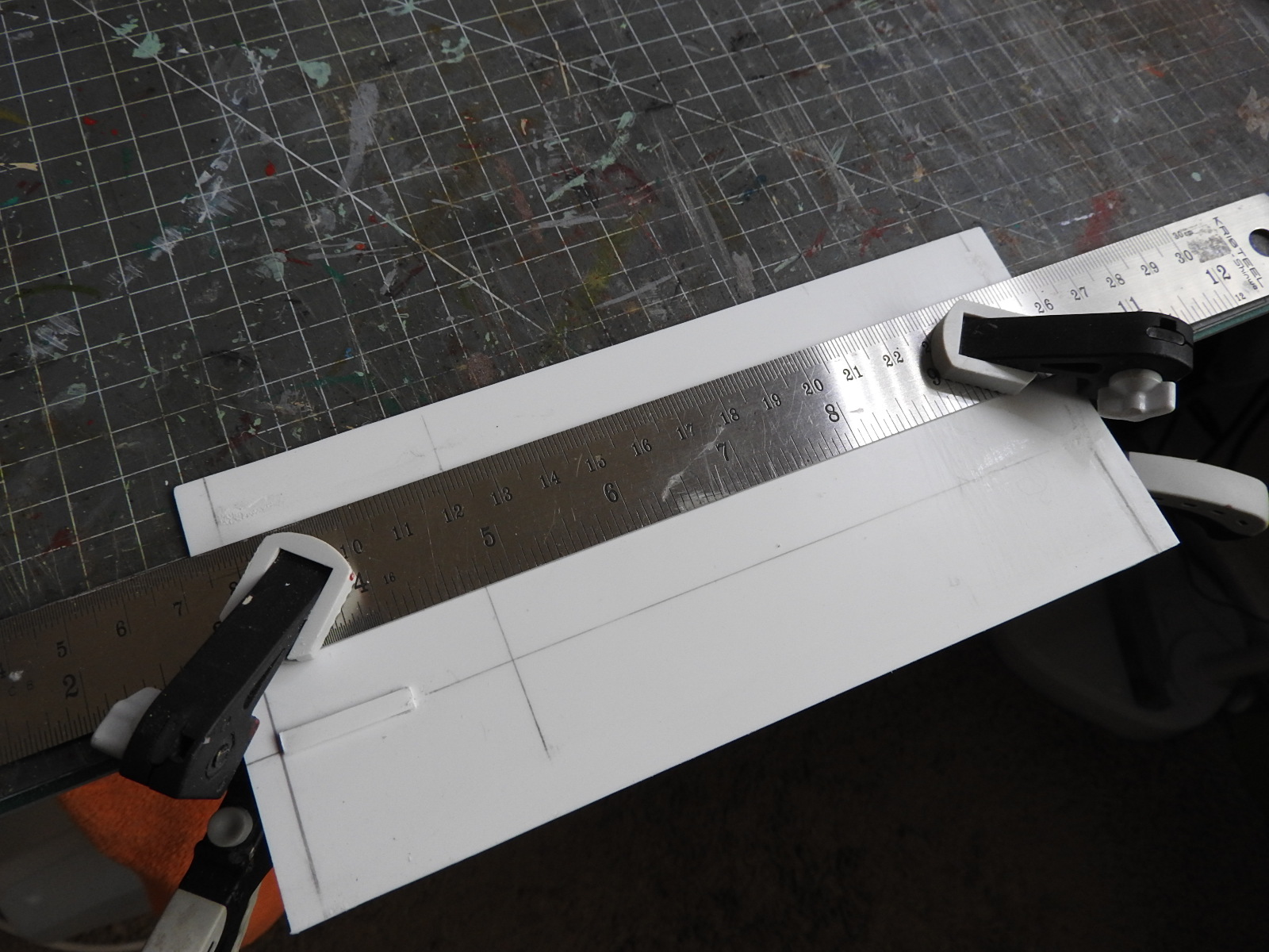

This is how I cut my Plasticard Rob, no matter how big the sheet is....
This is a scrap bit just to show you.

For oblongs and round, I use my cordless drill, it can run at very slow speeds, virtually stopped :lol:
The oblong is done by drilling four holes just inside of where I want the oblong, then it the same principal with straight cuts. For tiding up any rough bits on the card it's those files your other half has for their nails, I admit I use them too.... :roll:
