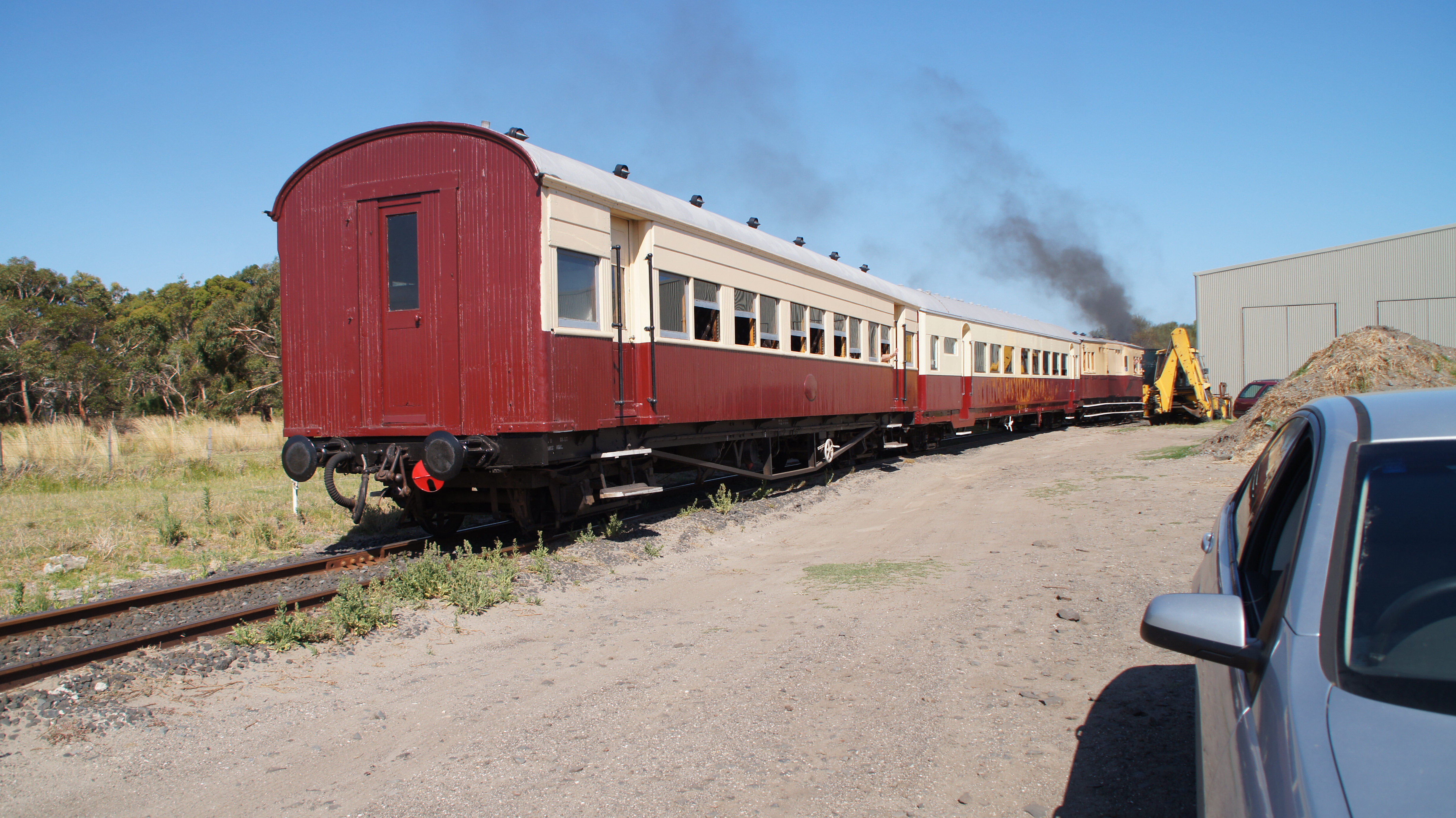

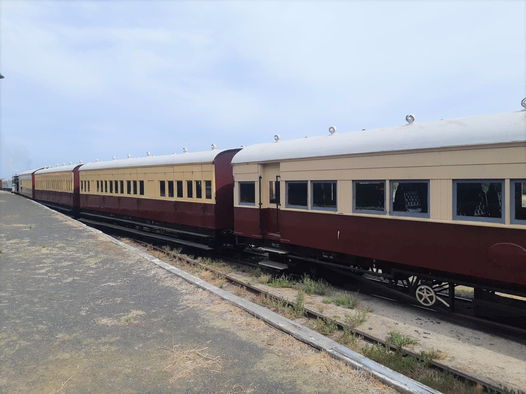

Thanks guys. The car being modelled is the one on the left which as you can see when photographed in the typical Victorian overcast weather is quite a dark red/brown. The creams vary from car to car depending on fading but I'm not as concerned by that.
When photographed in bright sunlight though its quite a bit brighter which probably matches what I've got not too poorly
Will do the job for a bit though having produced a few items of Australian stock I've completely given up on kitbashing or repainting proprietary stock now. They just cant substitute for the correct item really so it'll have to do the job until I can pull it back out of service for a tweak up.

The model certainly looks like a TGR BBL to me.........Tropic Blunder wrote: Thu Oct 27, 2022 11:14 am The car being modelled is the one on the left which as you can see when photographed in the typical Victorian overcast weather is quite a dark red/brown. The creams vary from car to car depending on fading but I'm not as concerned by that.
When it comes to the colour, are you aiming to replicate the Bellarine Railway paint scheme, or the late TGR scheme?
It looks like a reasonable match to the way it's prototype is currently painted, but if you want the model to match the late TGR scheme it would have carried when it arrived at Queenscliff, the colours should be bright red and deep cream. I haven't been on that side of the bay for decades, but looking at photos, the colours used on the two preserved X class diesels look close enough.

Thanks Graeme thats a good start! Im more aiming for the preserved scheme as I find the original TGR red and cream a bit bright for my tastes. But consensus seems like its close enough which is good enough for me. I've always had a bit of a poor eye for colours so thats reassuring at least.

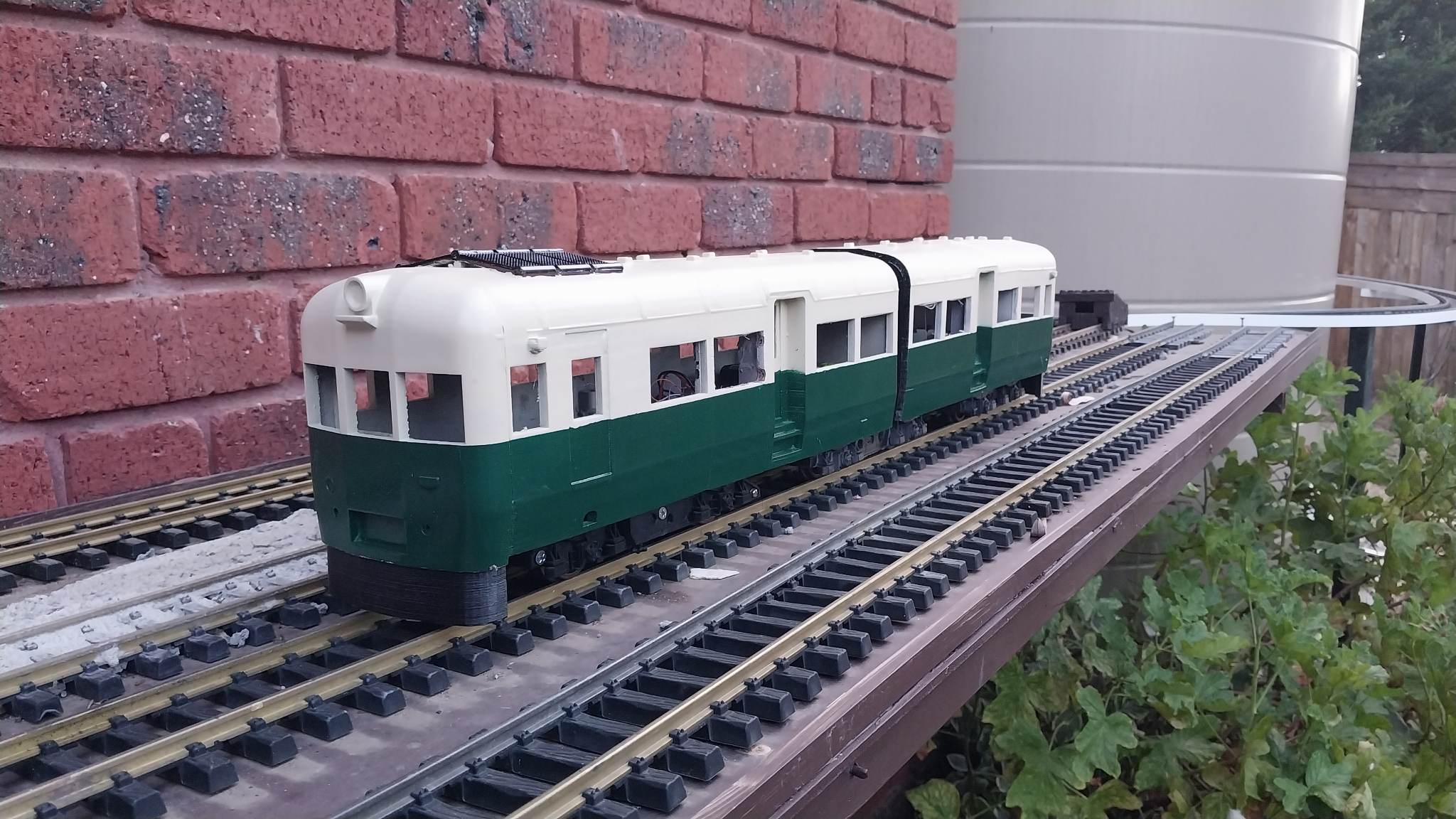

The DE seen here waiting for its next assignment. As its fitted with dynamic brakes its regular assignment is the mine run but its days in the sun will be soon over as its replaced by larger 6 axle power...
Following some excellent high frequency performances by the visiting Sentinel steam rail motor it as again put in perspective for management how a reliable diesel railcar could revolutionise passenger services on the line and so a concerted effort was made to finish the articulated DP

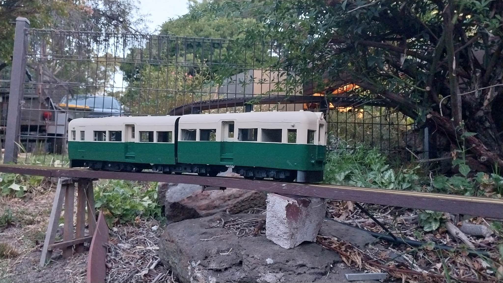

The Tasmanian government railways had a long history of using different varieties of railcars dating back to 1912 but are perhaps best known for the variety of different railcars from Commonwealth engineering which used power bogies from Drewery car company. Built from 1939 onwards They came in a variety of sizes and they and their matching PT trailers were a common sight around Hobart. I will confess I don't know much about how they were used but I believe they were designed to run in multiple car sets (DP, PT, PT, DP) in suburban service and I believe there were even a pair of trailers that had mail/baggage handling facilities. DP26-30 were the last ordered and were of a larger articulated design originally for use on the "Tasman Limited" They were replaced on those duties by loco hauled services and passenger cars to a similar design. Following a long and successful service life they were disposed of. Quite a few of the original single car DP's are preserved around the country and of the 5 Articulated units 3 are preserved. 26 at TTMS in Hobart and 28/29 at Queenscliff In Victoria
My model is based on Leon Kernans models available off thingiverse with some extensive "digital kitbashing" required. I cut the body of the regular DP available here https://www.thingiverse.com/thing:4401047 to the correct number of windows and end for the "trailer" end of the car and then rearranged the model of DP 13 available here: https://www.thingiverse.com/thing:4401047 to get the other end correct. Its not perfect and I'm sure length wise its not quite right but I'm happy with it. Alexander (Melbournesparks) Produced the power bogie for me using his usual method of axle hung traction motors the same as on his W class tram. At the moment it only has two axles powered but I will power the middle bogie to assist it with climbing my 1:30 grades. It currently has Deltang RC fitted as is standard with everything I run. This one will never get sound but I'll finish the interior and fix the windows once I finish my current program of passenger carriage printing.

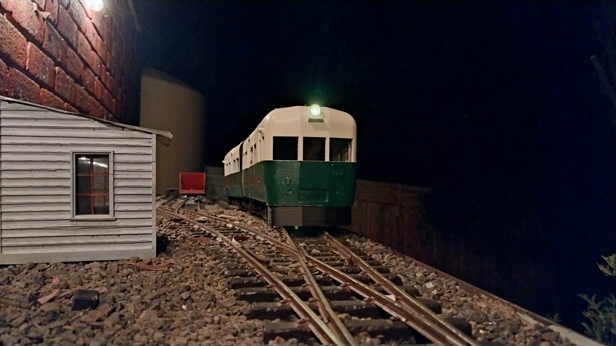

On a test run rolling down the hill from Marysville Stabled at Port Melbourne. Seems the port sheds have finally been demolished since we were last here. Now fitted with lights. There is nothing more on this earth that I despise more then wiring other then finding my grease gun has an empty cartridge. So when I started wiring lights into the DE I figured I should strike while the iron was hot. Literally. As there's no interior I didn't fit any lights inside it yet but that will happen at some point.

Quite like that railmotor, it's got a ton of character already. Never thought I'd say this (here in Aust) but it has been a weirdly short and cool Summer, hasn't it..
I recognise the paint on those points in the last shot..
- Posts: 7969
Very smart looking railcar

I was wondering if anyone would notice the points had changedOld Man Aaron wrote: Sun Feb 26, 2023 6:03 am Quite like that railmotor, it's got a ton of character already. Never thought I'd say this (here in Aust) but it has been a weirdly short and cool Summer, hasn't it..
I recognise the paint on those points in the last shot..![]()
- Posts: 1184
Tropic Blunder wrote: Sun Feb 26, 2023 9:31 am
I was wondering if anyone would notice the points had changedThe old aristo points had excessive wear on the check rails and frogs so everything would derail when propelling into a siding. Absolutely not ideal when its the main yard on your line. The Peco track is fantastic and the smaller rail height makes a huge difference. thanks for the opportunity to upgrade!
Yeah, that might be an issue! Did you get the Aristo used, or did you wear 'em out?
Thanks for taking the Pecos off my hands. Wish I could've put the money straight into 32mm replacements, but if memory serves, I think you ended up paying for my car's wheels being blasted and painted.

Very nice work on the railcar. Instantly recognisable.
- Lonsdaler
- Posts: 1506
- Location: North Yorkshire
That railcar is very smart, and strangely familiar - in memory, it might even have been from one of the Ladybird travel books (Peter & Susan? freeload on Dad's business trips
