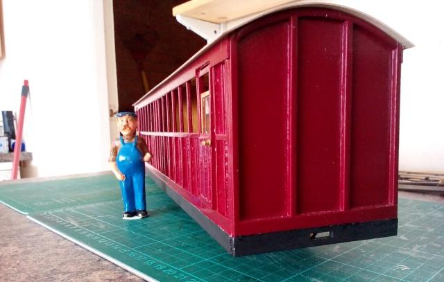

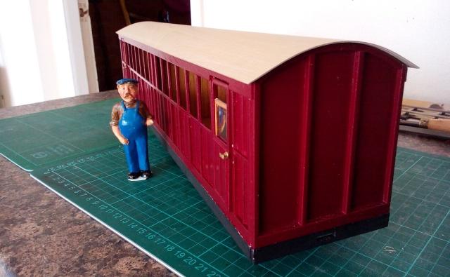

Hi all.

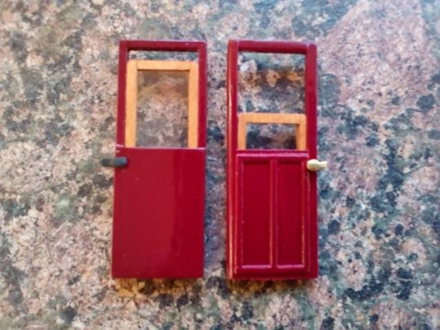

Frank the driver showing how the new coach is coming along. Doors painted, handles fitted and hung in place.
The Swift Sixteen door handles have a shift about 6/7 mm long which slots through a 2mm hole in the door and extends about 2mm beyond the back of the door. A small plate of thin brass is then made about 8mm long and 5mm wide with a 2mm hole towards one end for the handle shaft to pass through. This plate is then soft soldered to the shaft and filed flat when cool. I employed a piece of card here to stop me accidentally scratching the door paintwork. I then painted the latch black.
After carefully refitting the door and checking the operation of the latch I repeated the above on the other 3 doors.
This is a view of the front and back of the door

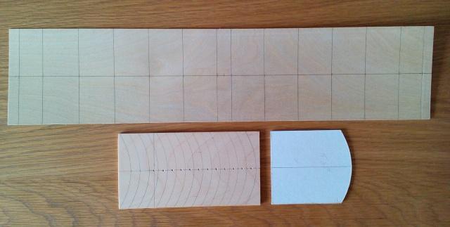

Now on to the removable roof.
I have cut a piece of 0.8mm ply to the size of the coach allowing 5mm extra at each end and 15mm extra in width to allow for the curve of the roof and to give a small overhang.
I have marked for 14 roof trusses ( always allow plenty to give strength to the roof) with the two outer ones being an exact measurement for the internal length of the coach.
I have then marked a line down the centre of the roof to allow for accurate centering of the trusses - see below.
I then cut a piece of ply the exact width of the inside of the coach to mark the roof trusses on to. ( Actually I had a piece ready from when I cut the ends and central partition.)
I drew a line down the middle to allow for accurate lining up on the roof when gluing the trusses and then used my card template that I used for marking the coach ends to Mark 14 roof trusses 10mm wide.
The last action was to mark and centre punch for drilling holes in the trusses for lighting wiring.

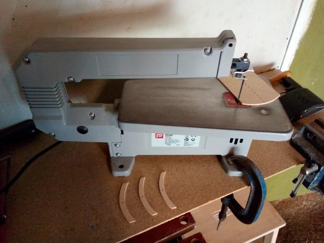

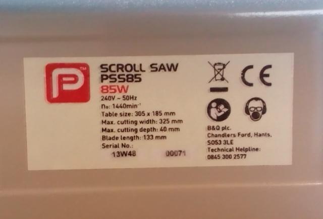

Hi Rob.
The saw was on the special offer stand in my local B&Q one day last summef at 29 pounds so i had to have it. It is their own brand ipresume and is not a high class machine but suits me fine. I think it is only 59 pounds full price
I clamp it down to hold it firmly and it doesn`t have an air pump to clear saw dust but i saw on the interweb where a man had rigged up a fish tank blower snd a length of piping and it worked a treat.
I had a problem with the plastic blade tensioner on the front top of the arm coming loose but i replaced it with a standard nut and adjust with a small spanner.
Overall then not the best saw i could buy but forthe money it does a good job.
David.

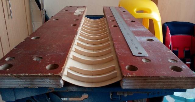

Hi all.
Spent time today gluing the roof spars onto the underside of the roof.
I have explained how i do this in a previous thread but in short i use the horizontal pipe slots that are machined into the jaws of my Workmate work bench to hold and curve the roof board while i glue on the spars.
I slide in the roof and slowly close the jaws, letting the roof curve gently downwards. I use the card roof template mentioned previously to get the curve i need to the roof. It is then a simple job to glue each spar onto the lines previously drawn onto the roof board.
4 things to remember-
1. Ensure the two end spars are positioned just inside the two end lines otherwise the roof might not fit on the coach.
2. Line up the centreline on each spar with that on the roof, for the same reason.
3. Use enough glue, especially at the ends of each spar to ensure the roof keeps its correct curve when the pressure of the workmate is released.
4. Leave the glue long enough to set and cure throughly, i suggest overnight.(not that i have ever had a roof try to flatten out again due to my impatience. Oh no.)
Can't wait till tomorrow to try it. Egg on my face if it doesn't fit.

That's looking really good, and you're right, the roof does fit very nicely indeed. Some of my earlier carriages could really do with their roofs taking off and lots of trusses adding - some roofs aren't terribly flush with the cant rail, and others have a noticeable dip in the middle...

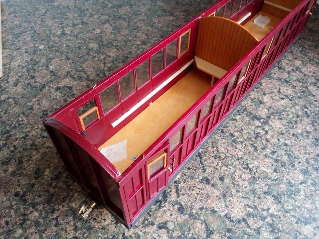

Hi all.
Latest update. Only 9 days left until it's commission date on the Disney Bridge Railway a week on Sunday.
Windows in. Individual panes in their own rebates.
Slaters chopper couplings fitted to match my other stock (height adjusted).
Roof covering added and painted cream.
Seating made. Pine bench seats to fit longitudanaly around the two areas.
Seating brackets fitted around the compartments.
To do.
Fitting seating.
NORTH WALES NARROW GAUGE name boards.
Paint touch ups.
Brake hoses fitted if they arrive in time.
Not sure about door steps. They were added later in life.
Final fettling.
Final update hopefully during next week.
