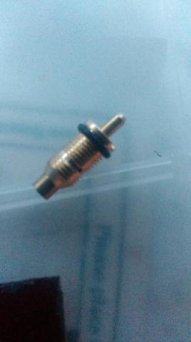

Well, ive hit a bit of a problem, i noticed the gas valve was leaking lots so i unscrewed it and realized that the one i got of trackshack is different despite looking to be the right one on the photograph on the website. http://www.track-shack.com/acatalog/Acc ... e-Z13.html
The one below is the track shack one and the bottom one is the merlin type.
it is clear the track shack one does not match up with the picture on the website, any ideas where i can get a correct one?

Have you tried it as in the photo it just looks like the new valve has a longer thread so may well still fit.
There are several different types of Ronson valves, Roundhouse and Accucraft use different fittings.
DLRdan
Post by DLRdan » Mon Feb 23, 2015 6:07 pm
It should still fit fine. I seem to remember the design of the valve was changed a little while back so the old type might not be avaliable any more.

As mentioned the Accucraft and Roundhouse valves have different threads. Accucraft use M5 x 0.5 thread and Roundhouse M4.5 x 0.5. I guess you have got M5 from Track Shack and should have the M4.5, but I'm just guessing as it is impossible to compare the valves on your photos without having them next to each other on the same photo.

Yeah it must be the 4.5 but it doesn't matter as it will fit my other loco, I will order one tonight , thanks for advice everyone
