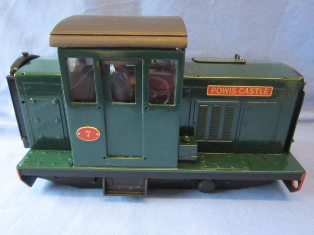

Today's progress report.....
The access doors and vents are now back on the loco. A new pair of cab doors were made to replace the originals. The reason behind this was to have a one-piece liner inside each side of the cab so that a single sheet of clear plastic can be used as windows. The window sheets have been cut to size with mitred corners so that each piece interlocks and supports the next without messing about with individual bits and the inevitable glue mess everywhere!
I am now working on the chassis and RC equipment which will fit inside a box unit attached to the chassis and will be removable complete.
Meanwhile I have sprayed a primer coat on the body and some of the small attachments I removed before. The primer is a dark grey
and I am tempted to leave it that way. Tomorrow I will shop around in paint stores to see if anything else grabs my attention.

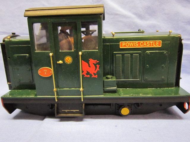

Well, Christmas is here and my Christmas Loco is nearing completion.
I decided to go with Big Al's colour scheme, which suits the loco well. Wasp stripes will be put on to the beams and lots of grime splashed on all over! Detailing is still to follow but the main body and chassis are well under way. The windows are fitted and the idea works well. Driver is in his cab just waiting to go for a spin.

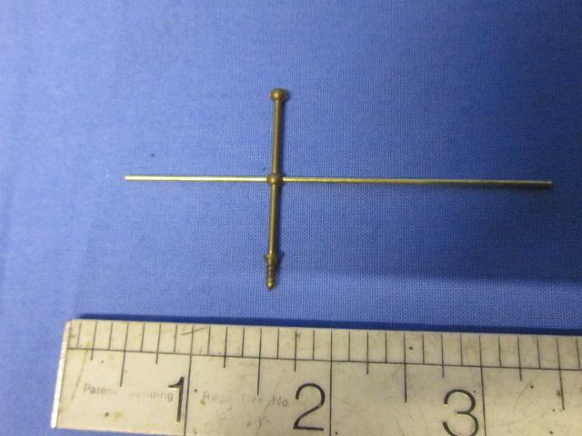

Further to my question about brass handrail knobs, I have had a rummage through my bits box and found some brass ships stanchions....
When drilled out to take larger diameter brass rod they can be cut into two short stemmed knobs which are then superglued into the body of the loco.
I have just looked at a model ships supplier on line and found single brass knobs for as little as 24p each (incl vat) although I don't know how this compares with Brandbright etc..?
Personally I think they are OK...
What about you?

Post by MDLR » Mon Dec 30, 2013 10:47 pm
They look fine................. and I'm all for furtling in the "might come in useful one day" box and using what you find there.

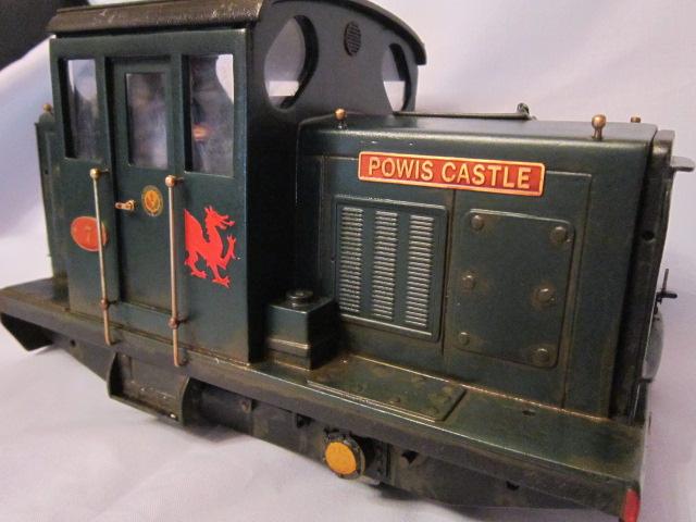

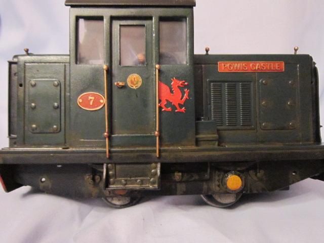

Post by Peter Butler » Thu Jan 02, 2014 10:43 pm
Apart from a few details, the loco is just about complete.
I have gone with the grime finish as it makes it look well used, as I'm sure it will be!
I need to finalise the handrails as I have run out of brass rod and the local supplier has been closed over Christmas...... some people treat it as a holiday!!!
Also, buffers are to sourced and fitted along with brake hoses which I have but not yet fitted as they would be too vulnerable sticking out on their own.
The radio control gear is fitted and working and it runs slowly and I expect it to pull a reasonable weight as I have filled the short bonnet with lead and the other with the battery pack etc...
