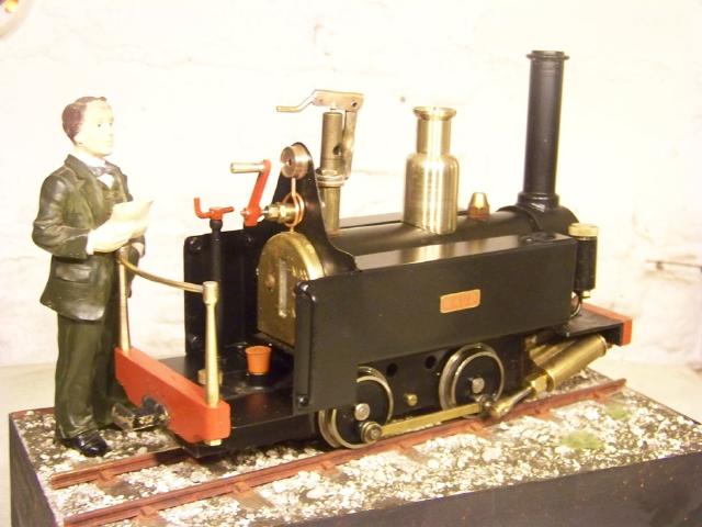

Latest progress - started cutting out the new footplate, still got a lot of filing to do! This is cut from 3mm steel plate which should give a bit of extra weight...

Well it's over a year since I posted anything on this thread - for most of that time Maud has sat on the shelf above my workbench. A few weeks ago however my nine year old decided that she would like to spend some time in the workshop with me learning to use some of the tools etc. We needed a project to work on and Maud was an obvious choice. We changed the original plan slightly and used more of the original Mamod parts. Maud is nearly finished, just a few more details to add so here's a couple of pics......

Interesting to see that you still have a riveted boiler back plate, obviously been very lucky not to have had a sight glass plastic failure yet.

Maud on test this morning....... terrible sound quality, but she ran very well, happily managing six circuits between water & meths top ups. Next job is to increase the fuel capacity .

I like that very much :D Love the Heywood look to her too - meths fired?

dougrail:80269 wrote:I like that very much :D Love the Heywood look to her too - meths fired?
Yes, meths fired standard MSS burner. I fitted a brass baffle plate between the frames at the front and blanked the two side vents in the frames which has improved performance massively. It could just do with a larger tank............but I'm working on that.

I like your gentleman's estate loco.Is the regulator dummy?I can't see a steam pipe coming from it.

The regulator is fully functioning - it's not very easy to see the pipe in the photos, it's a standard MSS valve with a new handle.
