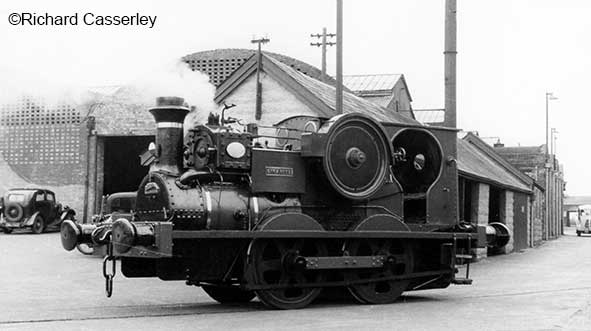

Excellent. I'm now tempted to construct an over-type loco. One was used on the Aveling & Porter sidings on the Aldeburgh branch at Leiston so it would be nostalgic for me to see if I can find a three foot gauge version for the PLR

Wow! Brilliant to see you bringing it into service. I really love an overtype. For many years I was invovled at the Garratt Works Museum steaming Sirapite up and down a tiny bit of track - happy days.
Looking forward to the next up dates.

Compared to 807, Sirapite is quite huge.
