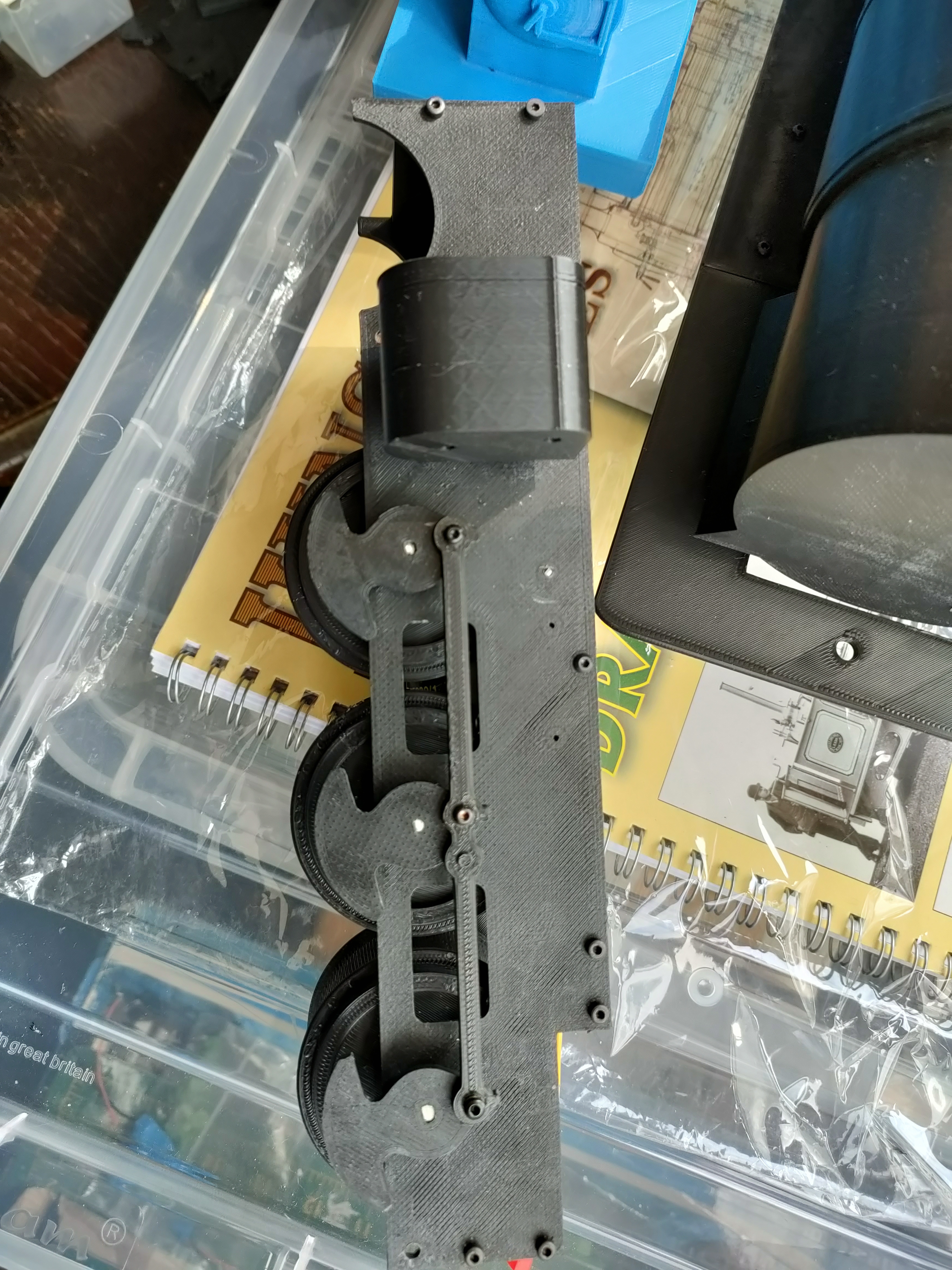

So I thought I would do a test print of one of the drive bogies, still to print some of it, but everything bolted together quite nicely. It's big, considering it still has a leading and a trailing bogie to add to each end. Anyhow, I waffle, this is it as if earlier today.
The other chassis is a Victoria chassis just for size reference.

Well a couple more test prints done, one power bogie is roughly in the right place, the other hasn't been printed yet, but it's getting bigger. :shock:

Looking very tidy! :salute:
Given the natural tendency to "load up" a Garratt with a long train, would it be worth beefing up that worm/sprocket motor mount?

Old Man Aaron wrote: Fri May 26, 2023 2:24 am Looking very tidy! :salute:
Good spot :) I have already had to change the motor mount configuration as it was indeed a little flimsy for what it needed. As yet I have not printed the new parts and it still needs a little more CAD work on that area, but I do think what I have in mind now should work better. :thumbup:

It is getting heavier and the prints are only "light" tests prints at standard quality of 0.2mm and only 25% infill rather than the 0.12mm and 50% infill I usually print final models.
I have some more work to do on the power bogies now as I have realised that the boiler touches the motor bogie and needs a certain amount cutting away on the power bogie to allow for the boiler which goes below the footplate and fouls the swivel action. I think we all knew this was going to be a long and somewhat tedious project with lots of amendments being done along the way. But it's still great to see a thought and plan start coming to life 8)

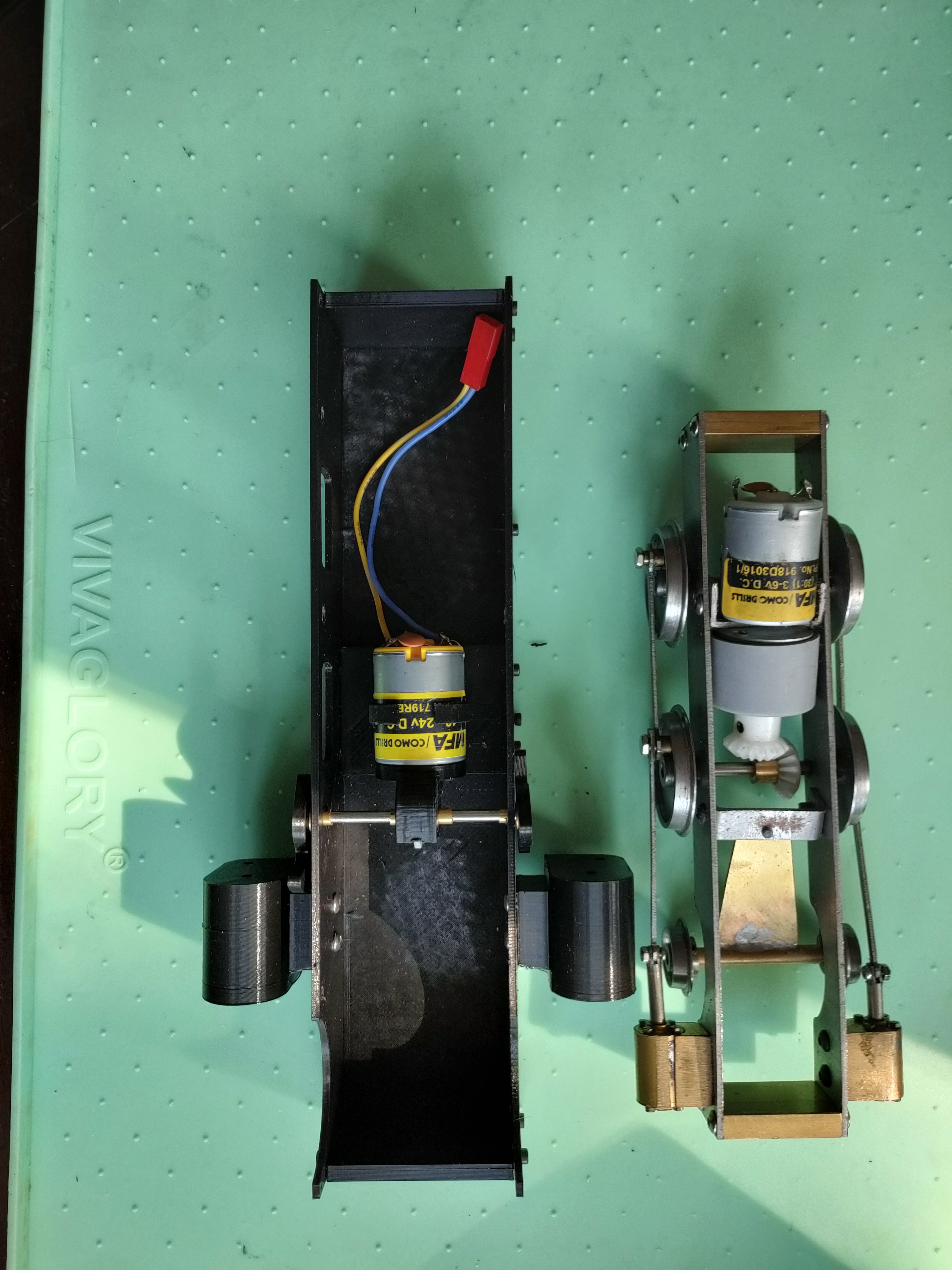

Absolutely, it's very easy to take what I have so far, make a couple of small adjustments and change it into something that's more useable, and repeat :thumbup: I have a new power bogie printed, just a case of getting the time to make the axles and put it all together. The axles are being milled at the ends so it's already pre quartered and the cranks match too, so in theory the quartering should be non existent :D

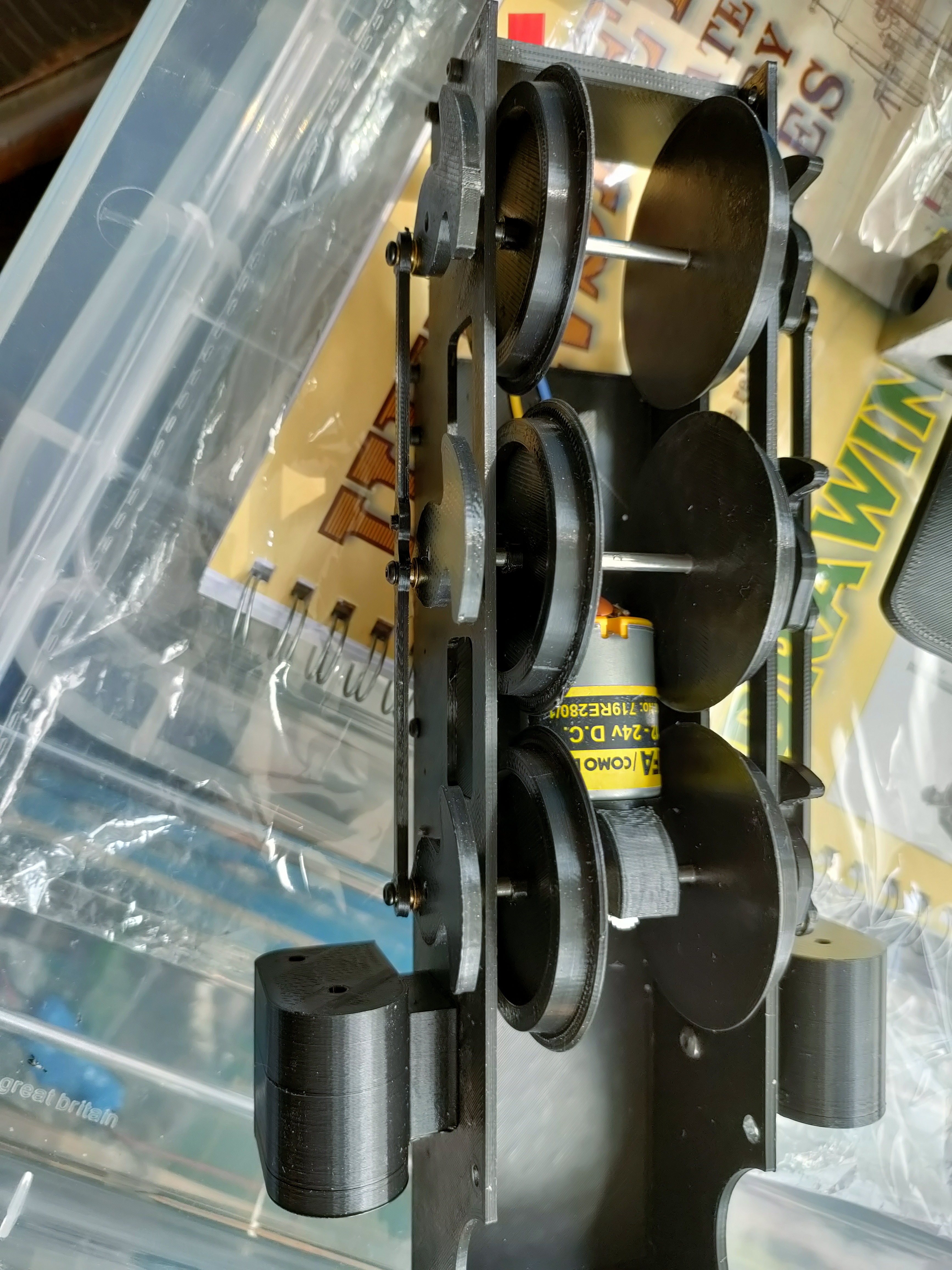

A little progress was made on the garet. One power bogie with drive fitted, the other waiting to be completed when time allows.
Note the axles have been milled to get the quartering spot on and the cranks were made with the appropriate matching hole :thumbup:
