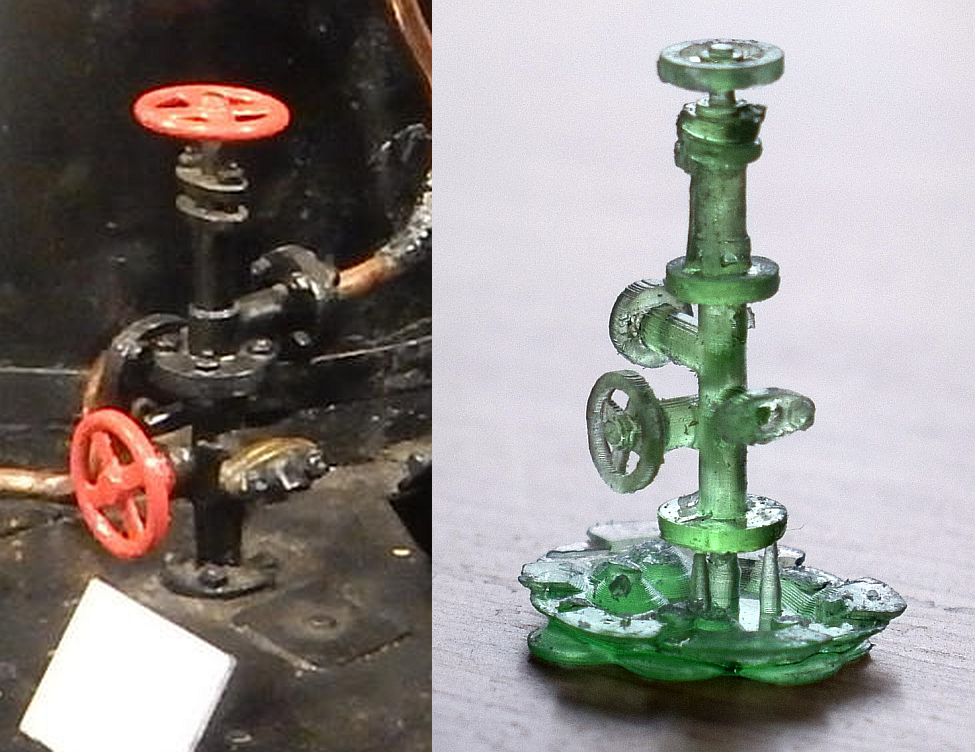

I must admit to being a bit chuffed (!) with this resin printed injector for the DW. It needs a bit more cleaning up but hopefully that will be easier to see once it has some grey primer on it:
pqr_de_winton injector.png (1.16 MiB) Viewed 12836 times
Posts: 7969
Re: New project. Guess what it is....
Post by ge_rik » Wed Nov 23, 2022 7:18 pm
Wow! How tall is it?
Posts: 6032
Post by philipy » Wed Nov 23, 2022 7:25 pm
With the base removed ( obviously!), its 18mm top to bottom.

philipy wrote: Wed Nov 23, 2022 12:55 pm I must admit to being a bit chuffed (!) with this resin printed injector for the DW. It needs a bit more cleaning up but hopefully that will be easier to see once it has some grey primer on it:
Very nice!

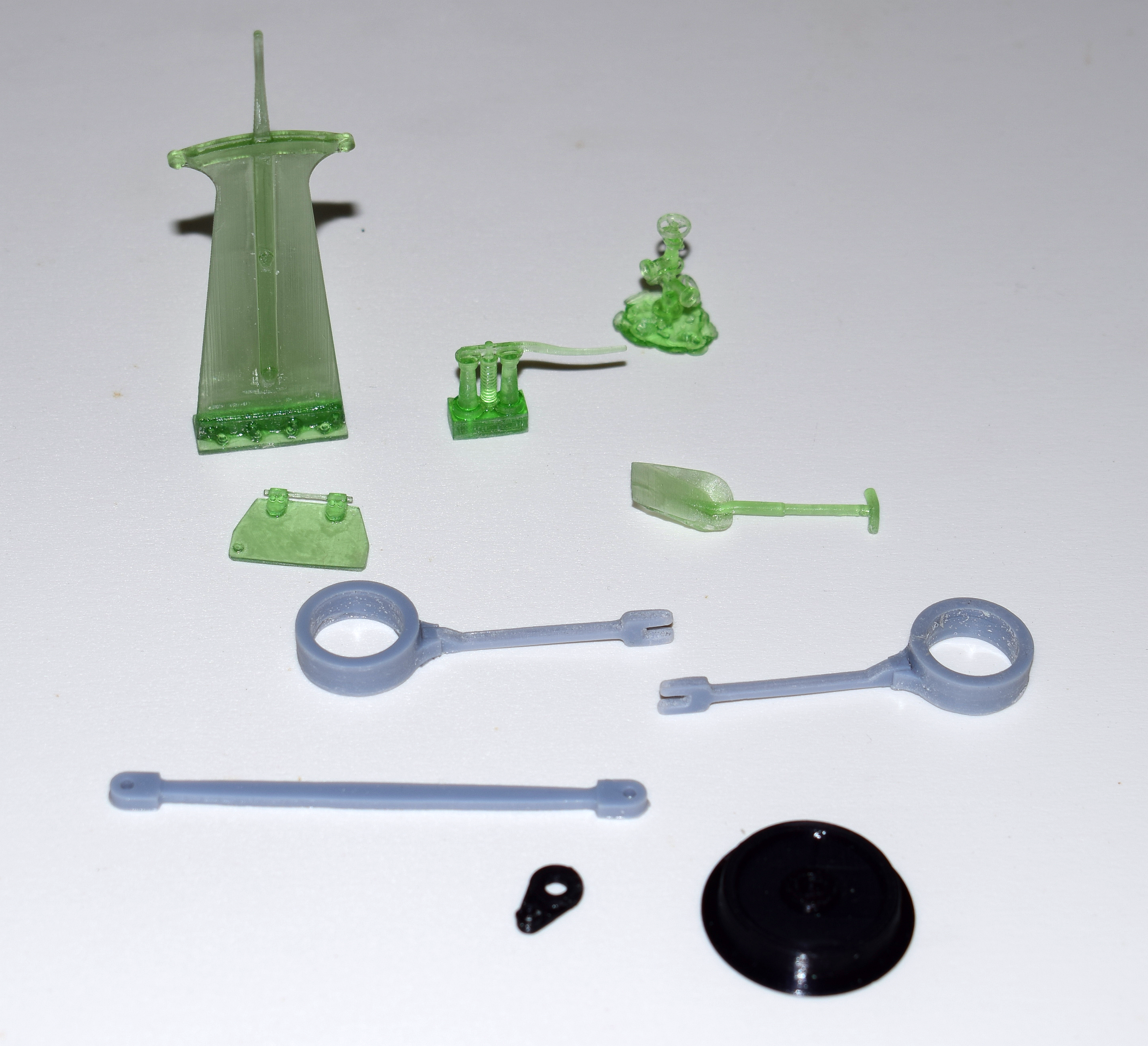

Some more small parts;
I redid the injector because I realised that I had missed one of the connections, and also the handwheels looked a bit small. Then:
Reversing lever, Safety valve, Stokehole cover, Firing shovel ( Don't know what they actually had but there must have been something), two eccentric rods, coupling rod, one of the wheels, and one of the cranks.

You're getting quite good at this!

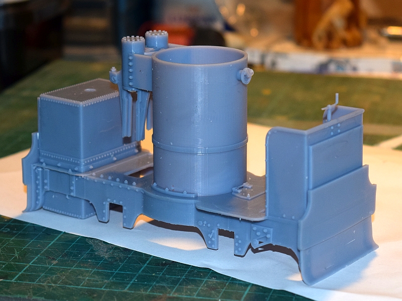

There has been a long hiatus caused by all sorts of non-railway issues, plus the fact that I wasn't very happy with the way my DeWinton was going, so the bits have all sat in a box for the last 4 months. Anyway, a few days ago I forgot about what had gone before and collected together all the individual SketchUp drawings of the components and assembled them into one complete drawing.. stl'd it...sliced it and resin printed it as one complete all-at-the-same-time model. It took 9 hours and this is the result:
The original print actually had the arms of the regulator as well but I accidentally broke them off whilst I was cleaning the supports off.
I left the water tank filler off so that there was a resin drain hole and also didnt include the boiler top and chimney for similar reasons.
Posts: 7969
Re: New project. Guess what it is....( De Winton)
Post by ge_rik » Sat Apr 15, 2023 11:55 am
That does look good. Resin? Did it require many supports?

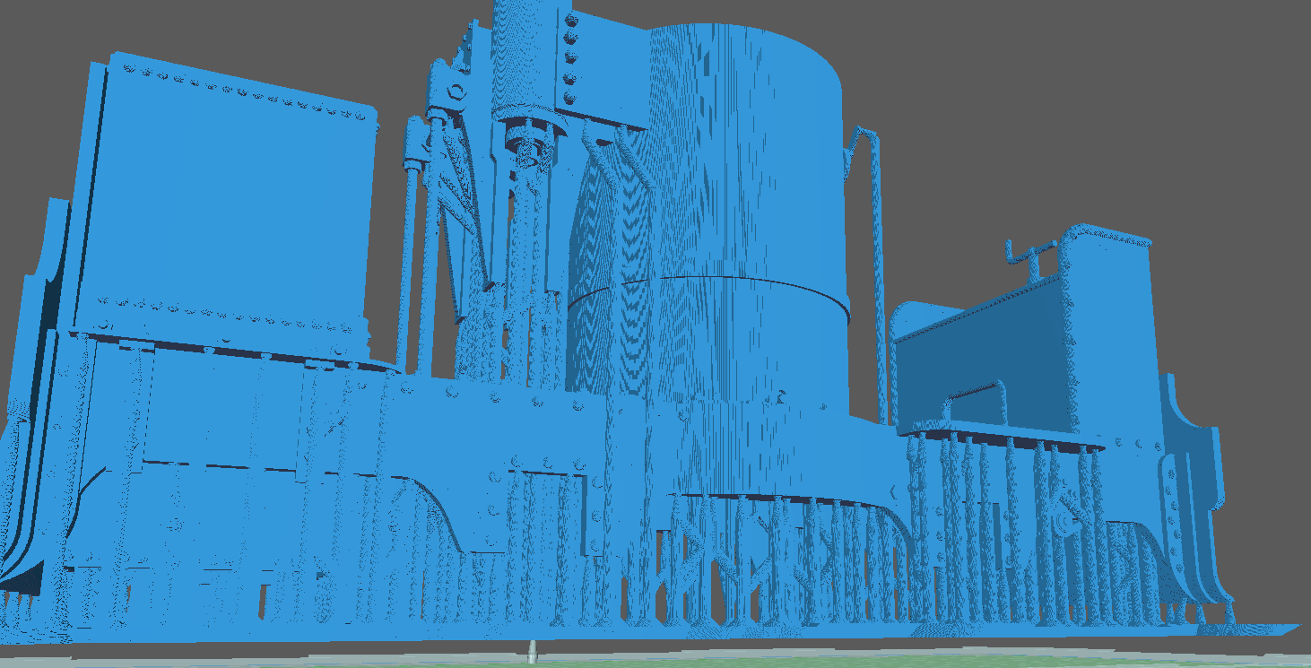

Printed it upside down with a raft on the buildplate, so the supports for the visible flat areas ( Footplate, tank top, etc) are hidden underneath and that does look a bit of an uneven mess. I'm never sure how much support to place on a flat surface like that
I did think about taking a pic as it it came off the printer but didn't want resin all over the camera so didn't bother.
This is a Chitubox reconstruction of the sliced file, fwiw:
