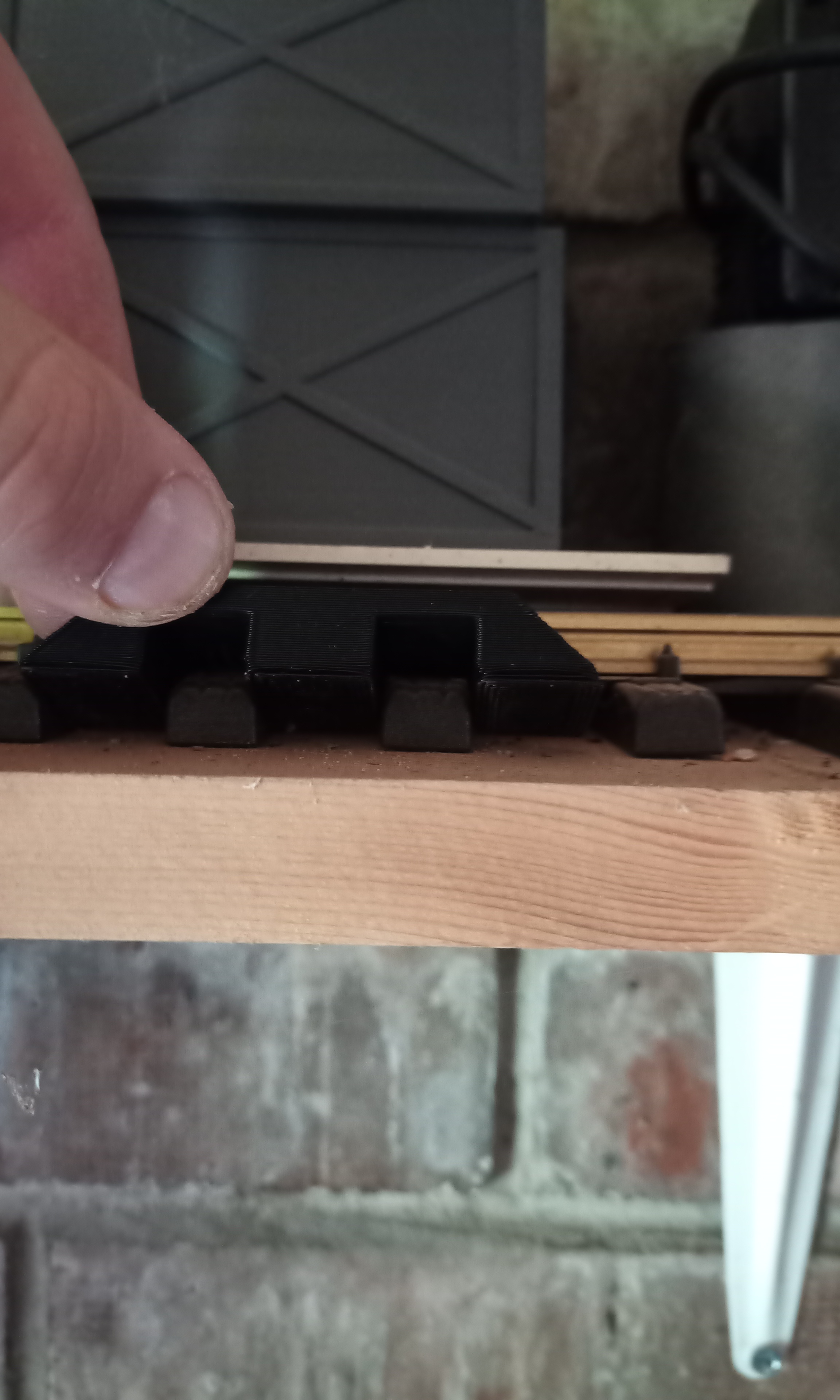

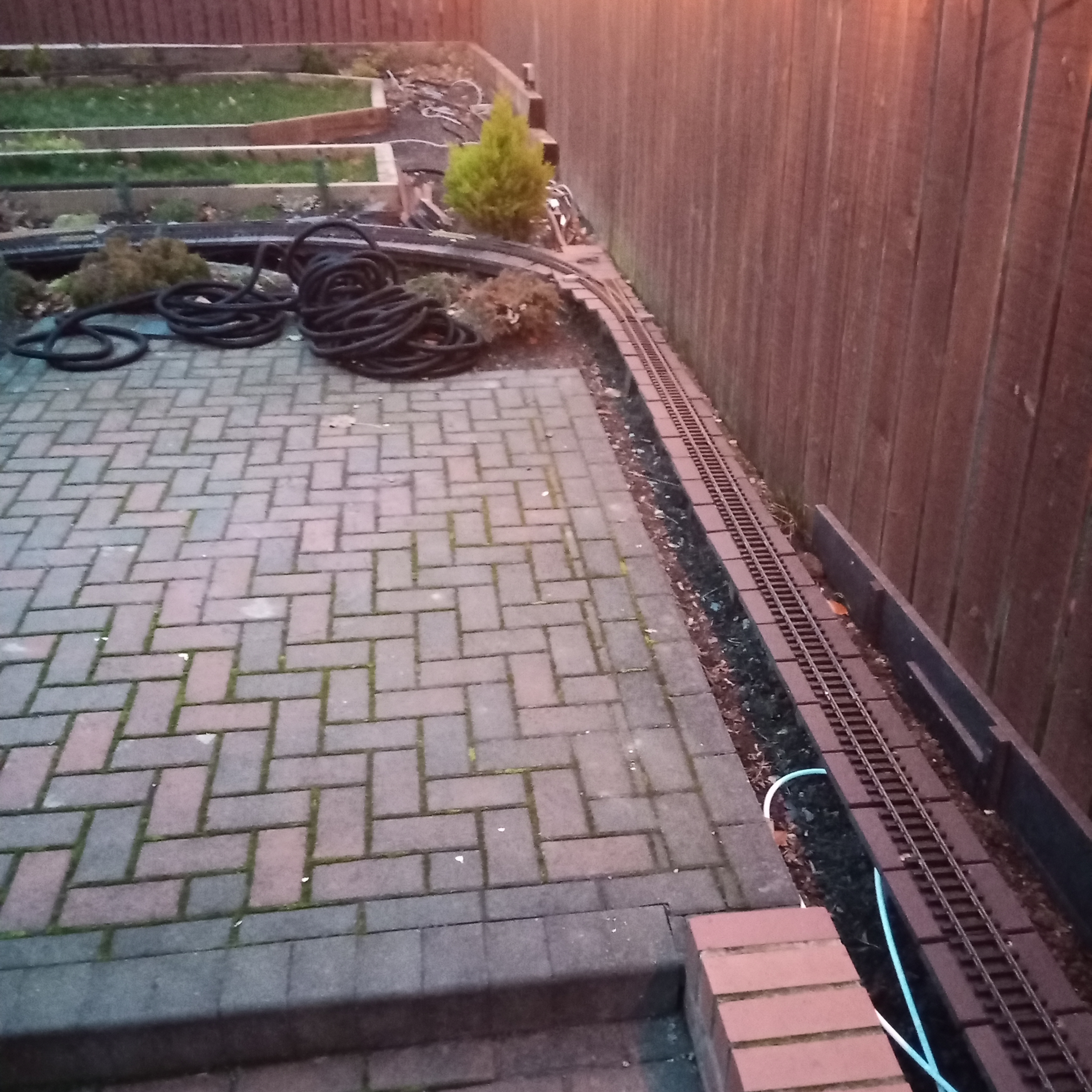

3D printed some spacers for fitting the boards on top of the runners
The gaps allow wiring to come through as close to where its needed so all hidden
Track then sits on top of that, still to come up with a good way of securing down without directly screwing it to the boards. I think i'll end up designing printing some kind of brace that goes over a sleeper (or two) and then the brace is screwed down.

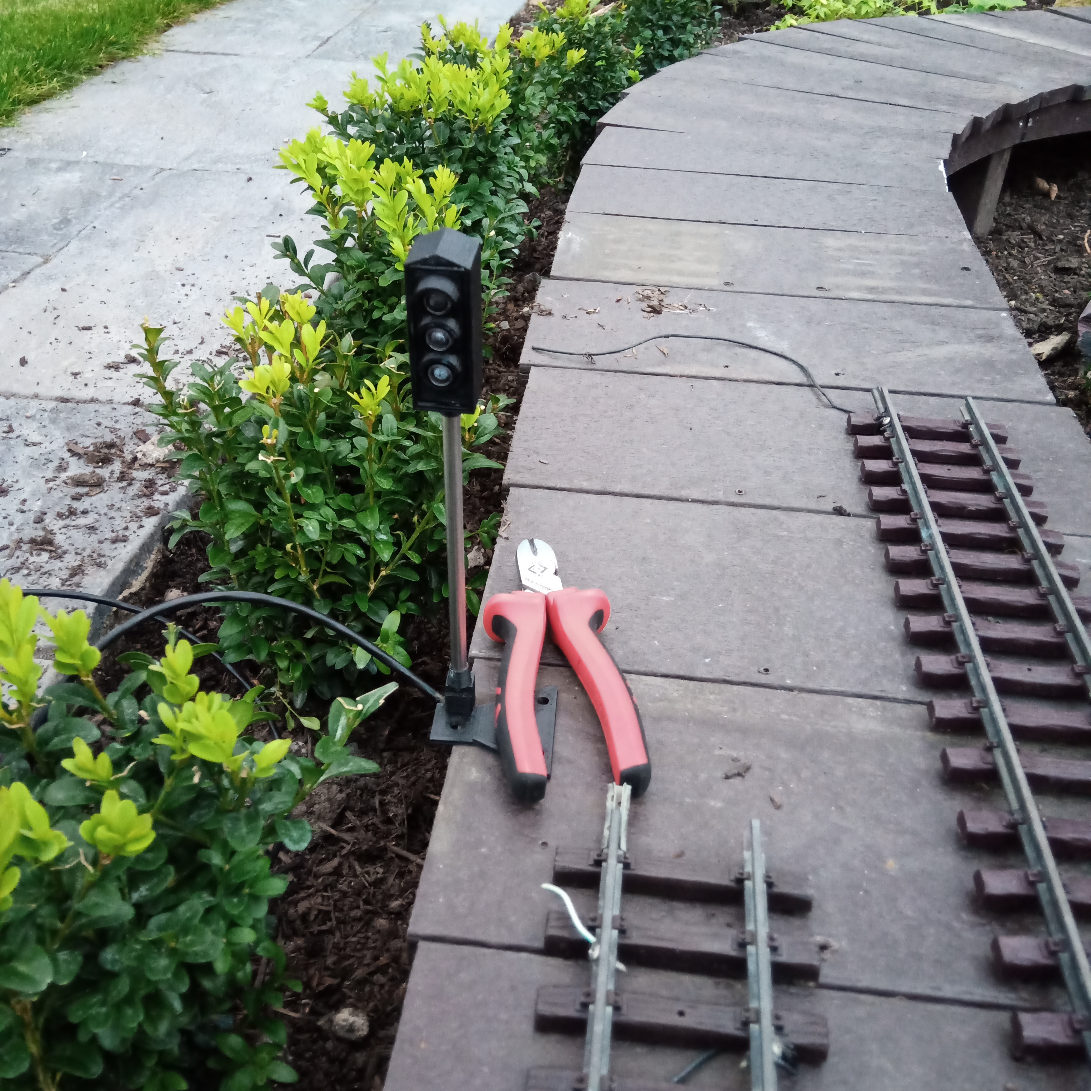

Tested 3D printed signal for fitting

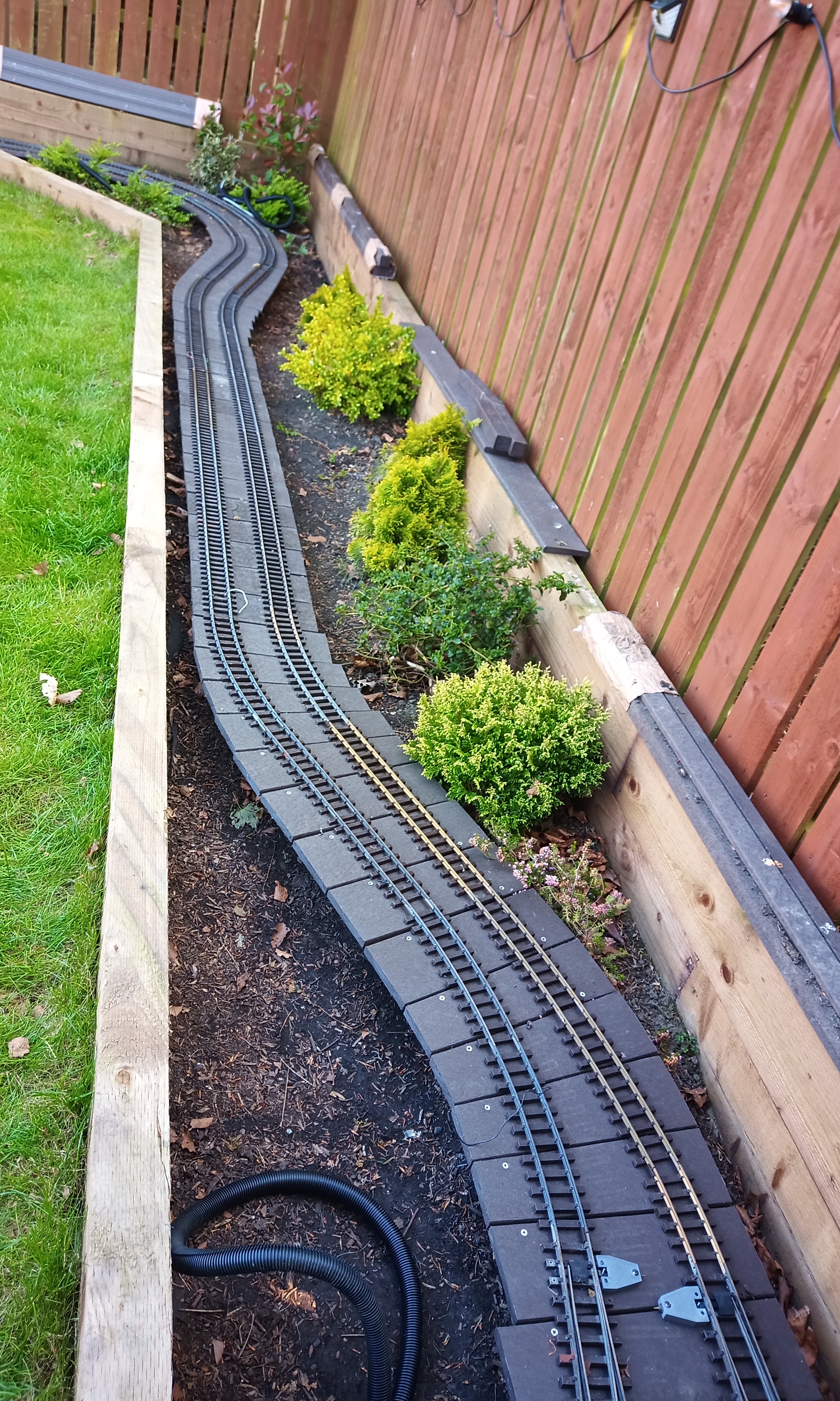

The smaller loop returning to the garage and the junction towards the main loops is complete and working
Also, all wiring and air lines are contained inside this split conduit fastened under the road bad but well above ground level

So to give a brief update on this, the initial loop that was completed is still in place and was covered in ice and snow for a few weeks solid recently.
I powered it up this week and the Allegra went straight round first time without issues or any track cleaning.
Very happy with the new trackbed and cabling so far and will be rolling out to the rest of the garden as i go when the temperatures get up a bit.

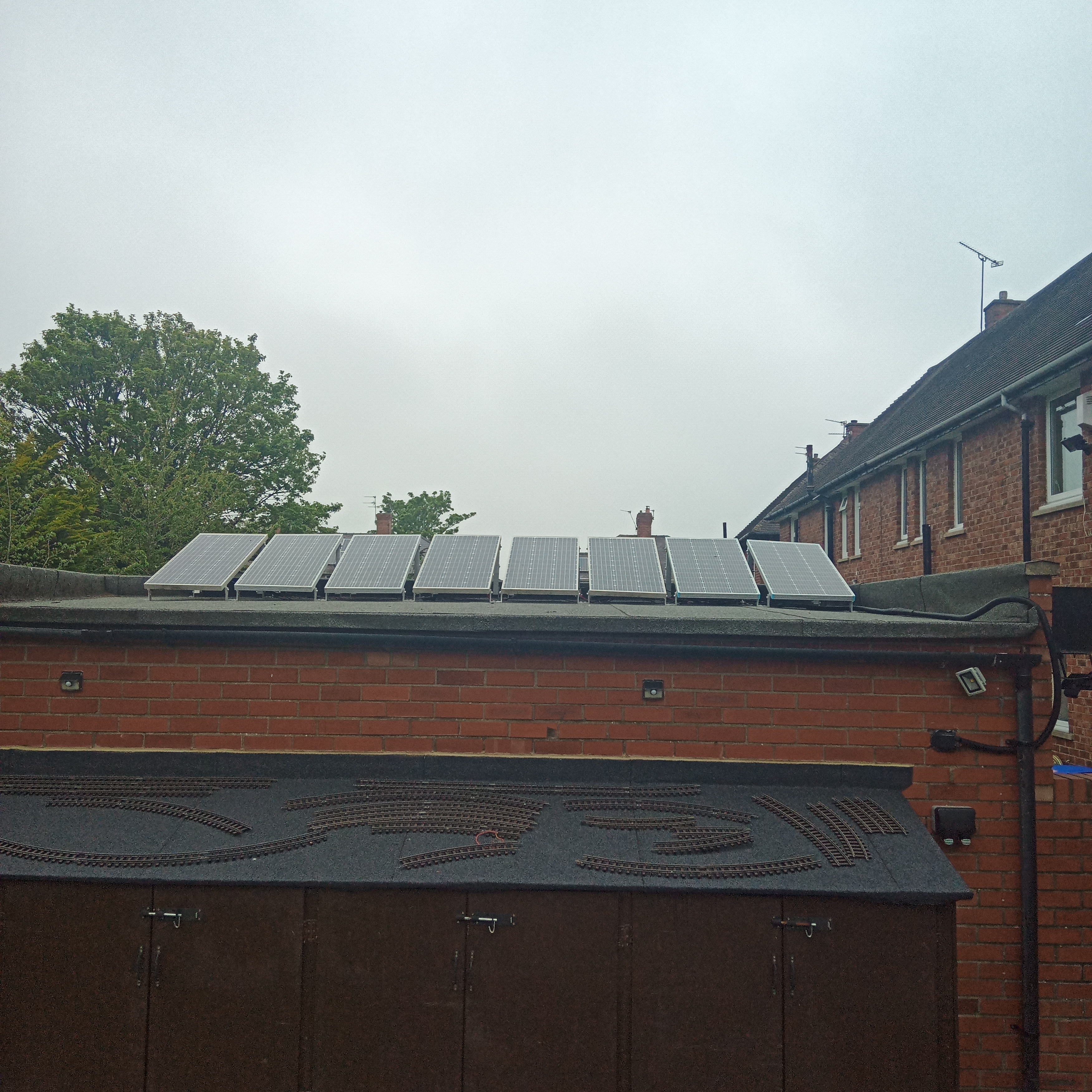

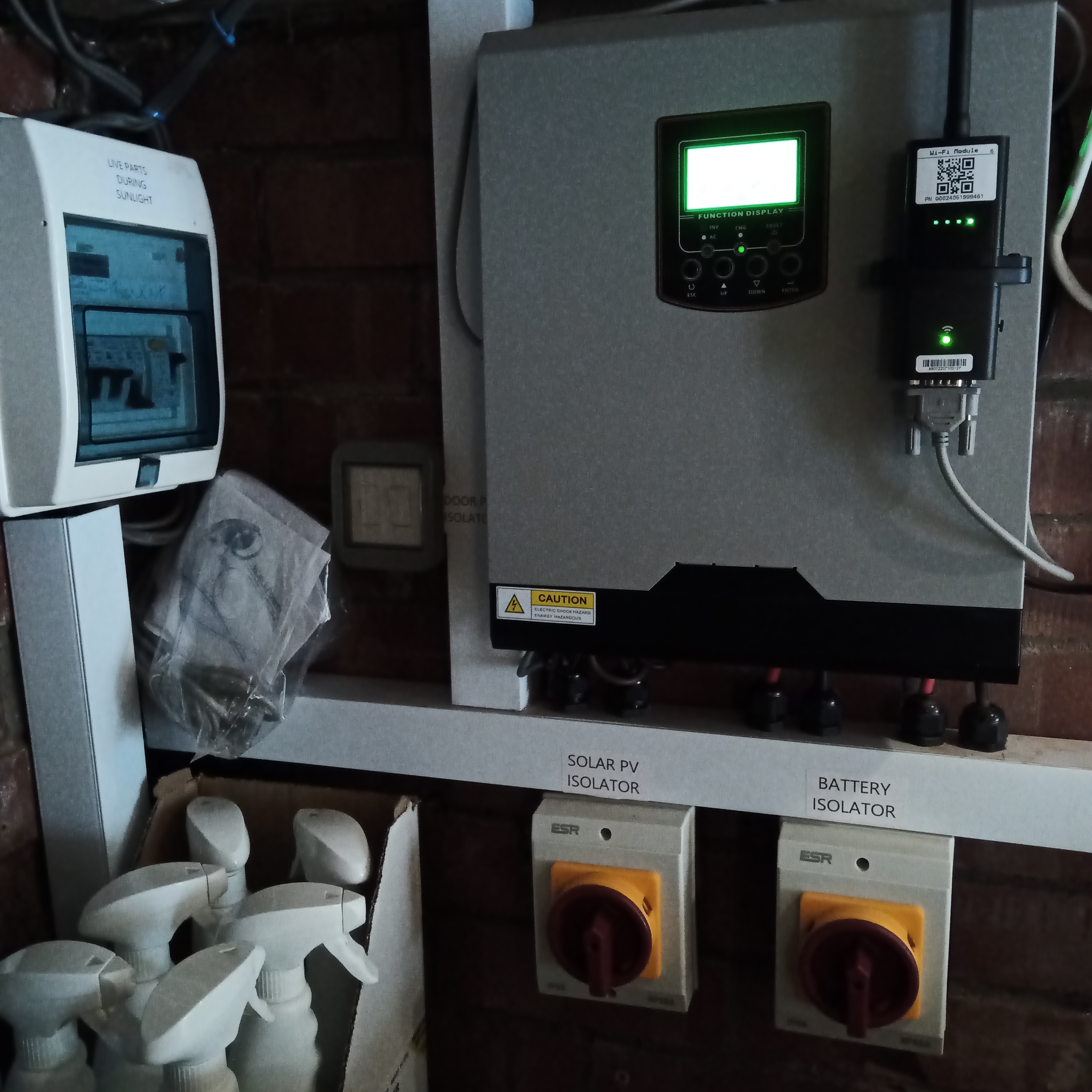

A slight diversion away from actual railway progress to convert the whole garage to a solar island system with mains bacckup.
800 watts of solar into battery storage.... Now thats up and running on with some railway progress

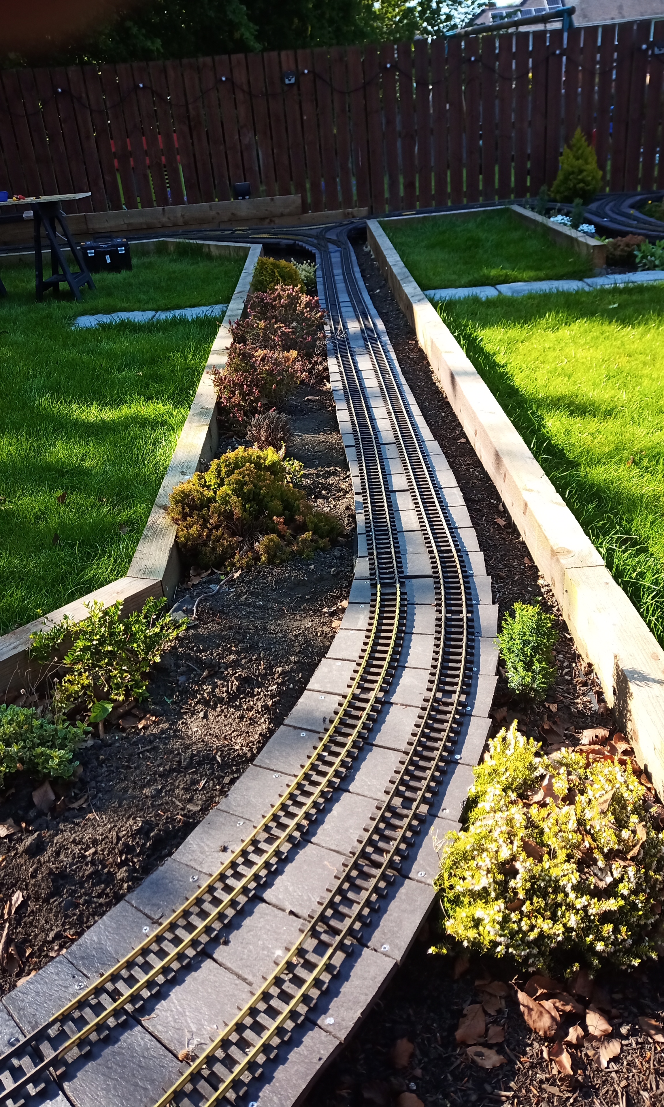

Post by stevenfitch » Wed May 24, 2023 8:20 pm

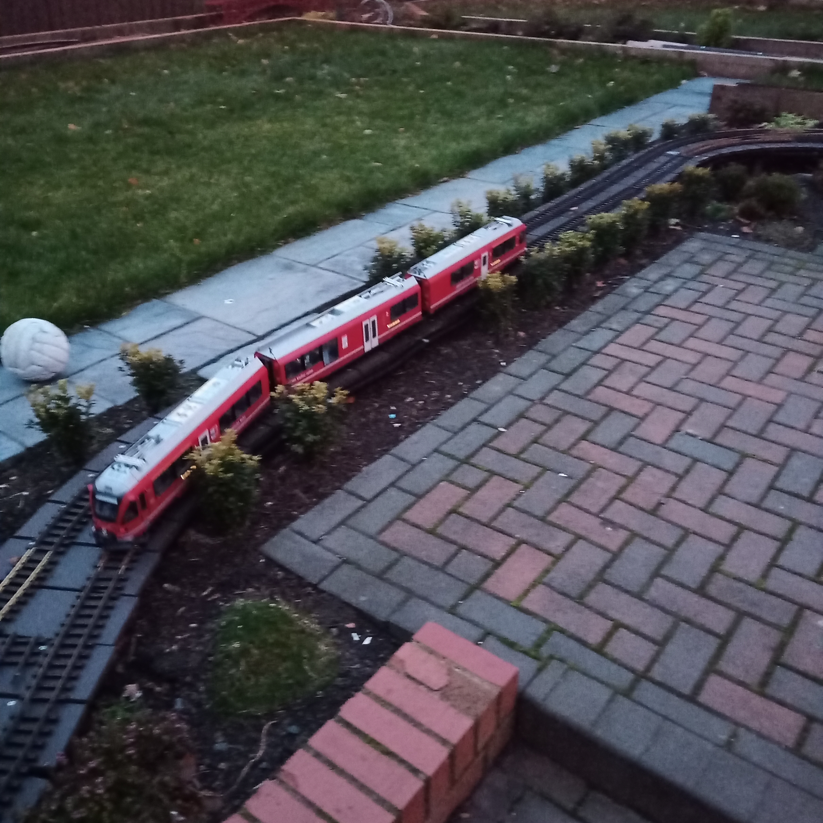

A bit more progress with road bed complete and track laid out.
Next up is connecting wiring for block sections and finishing off the pneumatics for the points.

Re: New Beginning for 2022
Post by Andrew » Thu May 25, 2023 8:20 am
ge_rik wrote: Wed May 24, 2023 8:45 pm That junction looks tasty! 👍
That's exactly what I thought!
Can't wait to see some trains making their way through that!

Post by stevenfitch » Sat May 27, 2023 1:00 pm
Andrew wrote: Thu May 25, 2023 8:20 am
As you wish...

Captivating to watch. Do the train movements follow a prescibed pattern or is there a random element as to which train moves next?
stevenfitch
Posts: 223
Location: Northumberland UK
Post by stevenfitch » Sun May 28, 2023 11:40 am
ge_rik wrote: Sun May 28, 2023 8:23 am Captivating to watch. Do the train movements follow a prescibed pattern or is there a random element as to which train moves next?
They were running on some pre-set looping schedules which activate each other but can also push a couple of buttons to just run at random.
Post by Andrew » Tue May 30, 2023 9:26 am
Brilliant stuff, thanks for the video!
I agree with Rik, it must be great to watch sit back and watch the trains roll by. I particularly like the shot about 5 minutes in, where two trains arrive in the yard from different routes and run parallel for a while. I'm quite taken with that three car EMU as well...
