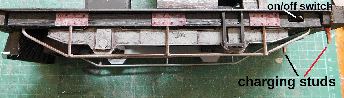

Now there was the frames and everything else under the baseplate…………….
From experience I know that everything down low needs to be STRONG or the first derailment will rip something off. So I avoid glue and anything flimsy. It’s screws and metal where possible.
I drew what shape I wanted for the ‘curvy’ frames to scale, then cut it out and stuck to 2mm styrene.
(BTW, I buy all my styrene (plasticard) in 5’x3’ sheets). Then it was down to the bench grinder for a few minutes and a few more minutes with a file and the shapes were cut out. Then all the ‘fancy’ edging etc to finish up with using 0.5mm styrene.
Unfortunately I had placed the wooden ‘underframes’ too far inwards so that I had to contact glue and nail these curvy outside frames on the outside of the timber and that meant the air tanks and truss rods and king pins and other paraphernalia were too far ‘out.
So I added another 10x5 mm wood and covered with 2mm styrene, to bring them out far enough to allow the truss rods to line up with them, outside of the ‘curvy’ frames.
I made the truss rods and king pins from 2mm brass rod. I decided I wanted a more ‘back woods’ cab so I covered the sides with 0.5mm styrene which I scratched with a hacksaw blade to simulate wood grain. Spray painted brown and then washed grey acrylic over it.

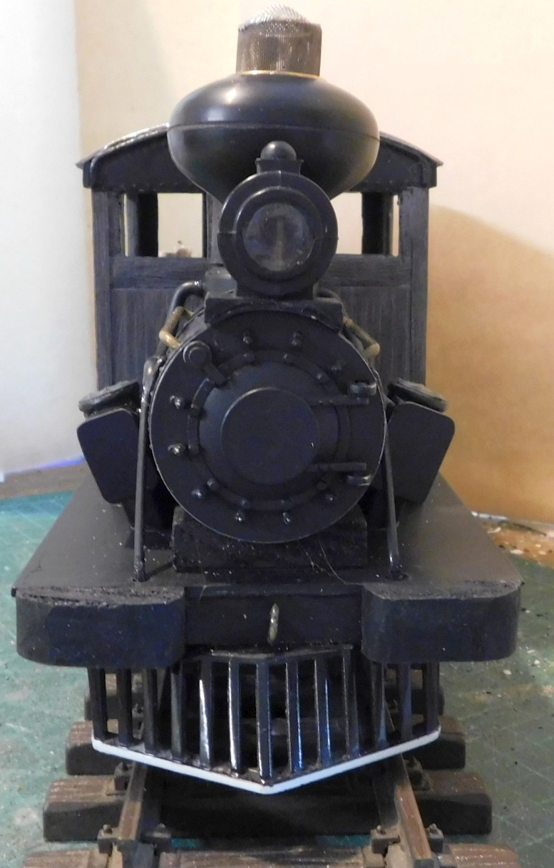

Progress continues and there is actually something to see.
So it was back to the boiler. I wanted to add as much detail as possible before I glued it to the baseplate.
The headlight came from the original Bachmann loco that provided the boiler. I had to lower the mounting and move it forward to overhang the boiler to clear the balloon stack. I tried a yellow led but it needed 20mA to be seen, so I used a warm white led with a couple of pieces of yellow cellophane around it to give a more ‘keroseney’ look. It runs at just 3mA – those white leds are super efficient. (The circuit that I use requires a very low current less than 5mA)
I haven’t decide on a rear light yet. I think there should be one but I don’t have one similarly shaped to the headlight. And then where would it mount? On the bunker or the top of the cab?
Back on the chimney, for the top ‘ember catcher’, I tracked down a small conical mesh ‘strainer’ from an old kitchen water tap for the top. I had some really fine brass mesh ‘stashed away’ and used it to form the cylindrical part. I turned a groove in the plastic to fit the brass ring I used around the mesh and then epoxied in place. (Whatever the plastic is, it sure smells when turning it, but at least it didn’t melt.)
The cylinders are part of a pen barrel. I used balsa used for steam chests covered in 0.5mm styrene. End caps are styrene glued over steel washers to get true circles. The bottom, angled ends were filled with cork (it was easier to cut circular) and are screwed from below and epoxied to the base.
The air pump is from the same pen barrel which had ‘grooves’ already there! Not quite prototype but good enough for me.
Some 240V electrical wire became the steam pipes to the cylinders and some leftover handrails from various loco builds we re added.
Because of my hatred of bells on locos – bells belong in church towers – I left the bell support in place but removed the bell !
And I decided it would be worth the effort to make the front of the cab from (styrene scribed) wood to match the cab sides and get rid of the porthole windows. That meant filing the rivets and other details off and covering with the scribed and scratched 0.5mm styrene as described previously.
Then I decided that a corrugated iron roof was more in keeping with a bush loco appearance, so I used my usual method of using take-away aluminium baking dish and a paper corrugator, glued on with silicone sealant.
To simulate rust, I sprayed the aluminium brown then sprinkled swarf from around my drill press and lightly sprayed again to hold it in place. The swarf had bits of wood, metal and plastics. I had seen others use sea-salt but I had none. Then when dry, I sprayed grey and then later brushed off most of the swarf.
