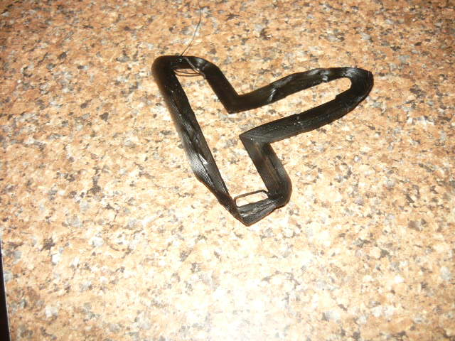

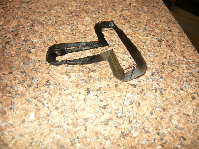

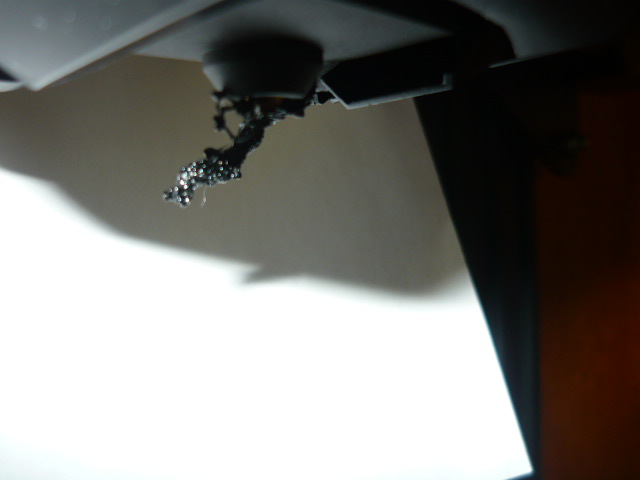

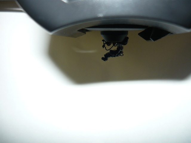

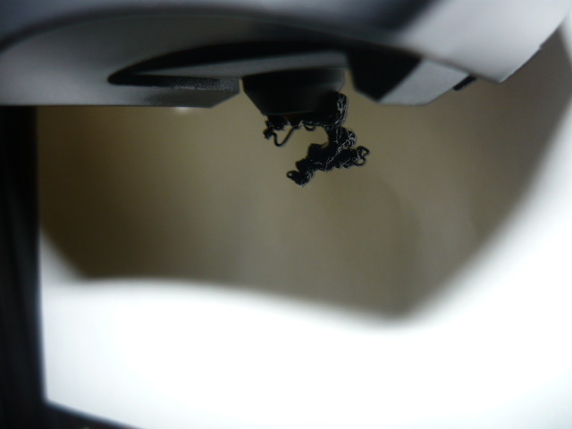

Post by GAP » Fri Oct 15, 2021 12:20 am
As requested a few pictures of the nozzle with the PLA build up.
This is after about 5 passes after the start of the print. there was nothing on the plate except for one pass down the side.
Out of over 20 attempts I have managed to print 3 items successfully so lack repeatability is a major issue here.
This is another attempt it started out as a brim then curled up and tangled the nozzle

Post by philipy » Fri Oct 15, 2021 6:14 am
Looking at the split on the LH side of the leg of the T on the last picture made me wonder about the print speed you are using? If it is too fast, particularly on the first layer, it may not have time to 'stick' either to the bed or itself?
My software suggests a default speed of 50mm/sec but I find 60mm/sec seems to work well.

I could always slice one of my files for your printer and send you the sliced file ready to print, yours is the Ender 3 V2?
I think my biggest issue is that I am doing something wrong setting the Z end stop I am going to go right back to the start again and set it again.
The files I am printing have come from Thingaverse and I have only imported them into tinkercad to combine and orientate them on the bed so I do not have multiple print files.
Yes my printer is an Ender 3 V2
I have copied a tinkercad link to the file I am trying to print via PM. Called "Comp Bogies for LGB"
Do not think the slicing is an issue as I have successfully printed files using Creality Slicer but happy to have another set of eyes run over it.
The BL touch is a last option if I cannot get the manual levelling truly correct, sort of a fine tune.
