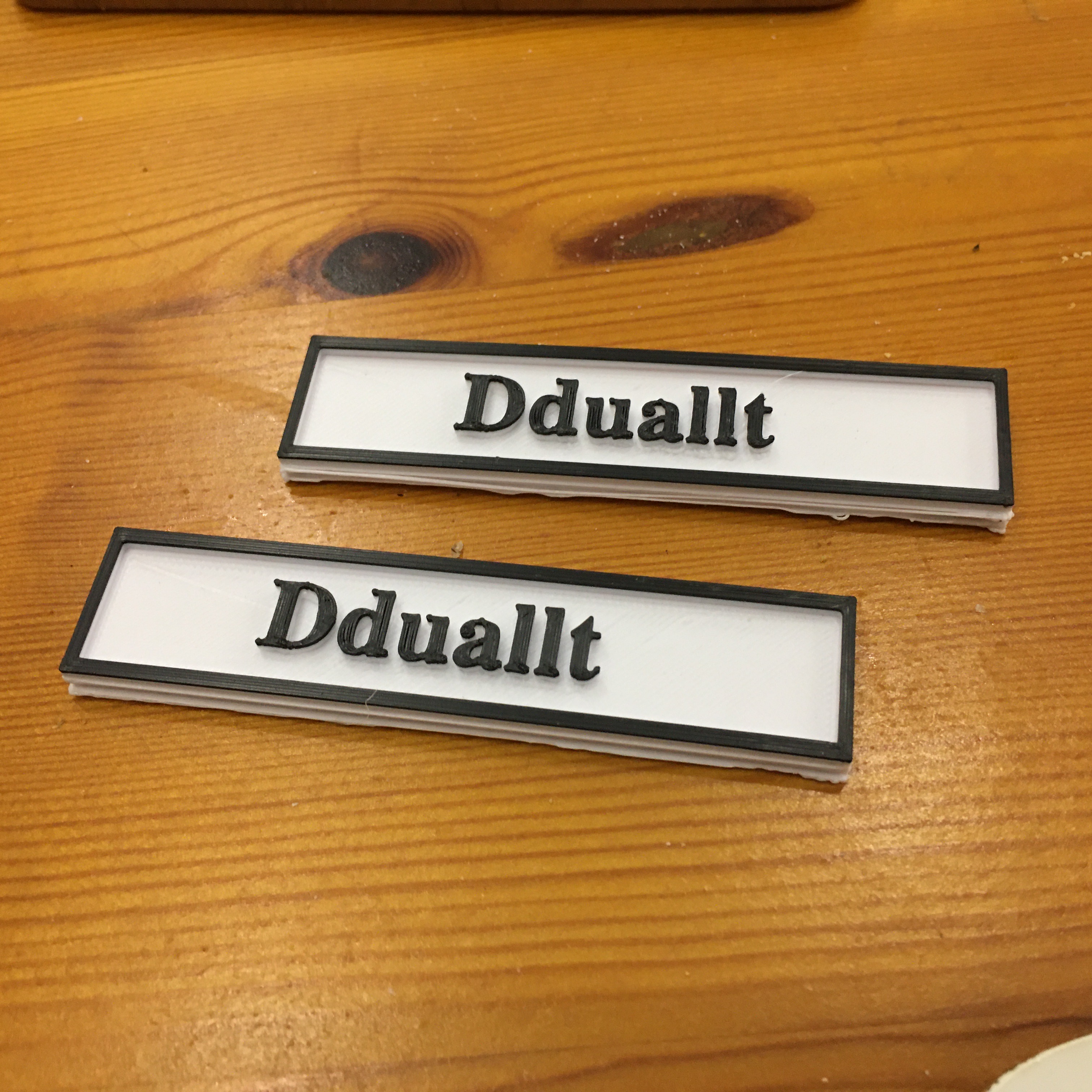

I have been preparing ancillary fixtures to go with the station building. I have noticed that the station name boards which I printed over 2 years ago are looking a bit tired. Not the plastic itself - but the white paint I had used to fill in the background. So I have tried something to see if I can get around that for the future.
I have never tried printing in multiple colours before but this seemed like a valid reason to try it. So most of the sign was printed in white filament, and the embossed lettering and the surround printed in black filament:
That was an easy way to get clear crisp lettering! I think that should avoid paint fading - as long as the filament does not fade.
Re: Dduallt Station building
Posted: Tue Oct 26, 2021 6:21 am
They look excellent Trevor.
I've never tried 2 colour printing, although I bought a 2 head machine deliberately so I could, but never really had a need in reality. Unless it is simple black and white like this, most of the coloured filaments are too bright and garish for reality.
Posted: Tue Oct 26, 2021 9:29 am
by Trevor Thompson
I agree about the filament colours being unsuitable for our needs - but in this very limited way I can see the advantage of a two head machine.
