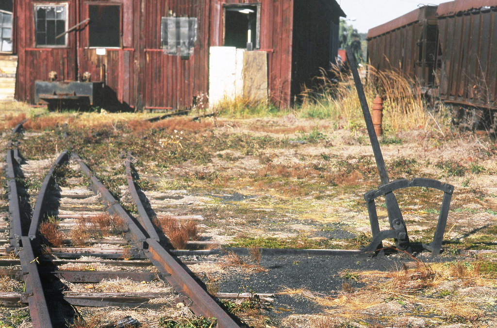

Can anyone advise where this stub point turnout is please, thanks?
David

Spaeker I believe what you're talking about is called a stub switch/ stub pointsspaeker wrote: Thu Aug 05, 2021 8:08 pm
I did make my own system added a moving flexible joint ( just one). Worked fine but this cannot be the real world solution ?
google earth doesnt come anywhere near close enough to see.
ciao spaeker

Wee Georgie Wood railway in Tullah, Tasmania. 2' gauge. I believe they're ex mining tramway somewhere, probably Mt Lyell?DafyddElvy wrote: Mon Jun 26, 2023 6:12 pmCan anyone advise where this stub point turnout is please, thanks?
David

These stub points cannot be trailed.
A friend has two of that type on his 5" gauge layout.
Another driver wanted to pass from the siding onto the main line.
Was going fast and did not check the track (and point positions) ahead.
One point was in the wrong position and she and her loco ploughed into the ballast.
No damage to the loco...but to her pride.
