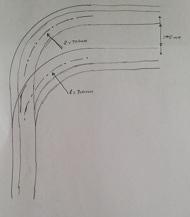

A quick sketch of the tramways test track, if trams can run on this they should have no problems in the garden.
A friend is knocking up a templot track plan for me so I can start progressing some track, albeit indoors on the test track.

I would have thought the inner radius should be smaller than the outer radius, or at the very least the same radii, so I am surprised to see this the other way around :)
Jimmy,
Both radii are the same. Originally I thought about a conventional curved turnout but quickly realised that would be a bit of a pig to build and this arrangement is more in keeping with tramway practices and keeps the switches on the straight, the only fiddly bit is the obtuse crossing switches.
At least in 1:22.5 scale I'll be able to hold the turnout components with my fingers which should also make things simpler.

DafyddElvy wrote: Tue Jun 15, 2021 7:46 am A quick sketch of the tramways test track, if trams can run on this they should have no problems in the garden.
David
Is that for dual gauge track? Having the common rail swap sides in the set of points is an interesting feature! I guess this way you could use two independent point blades for each gauge?

The turnout design came about because of the need for dual gauge track with the wider gauge rail on the outside of centre, I considered a number of different options, one not particularly sensible, and even one option with four rails in the single line section, the sketch was the best compromise I could think of.
At the moment I haven't even given operation of the turnout much thought, the outer curve is fairly simple, switches are either all set for the outer curve or they are not, the inner curve is going to need a wee bit of thought, if I was using DCC it would be simple but as I want to operate this in the same way I'll be operating things in the garden it needs some thought.

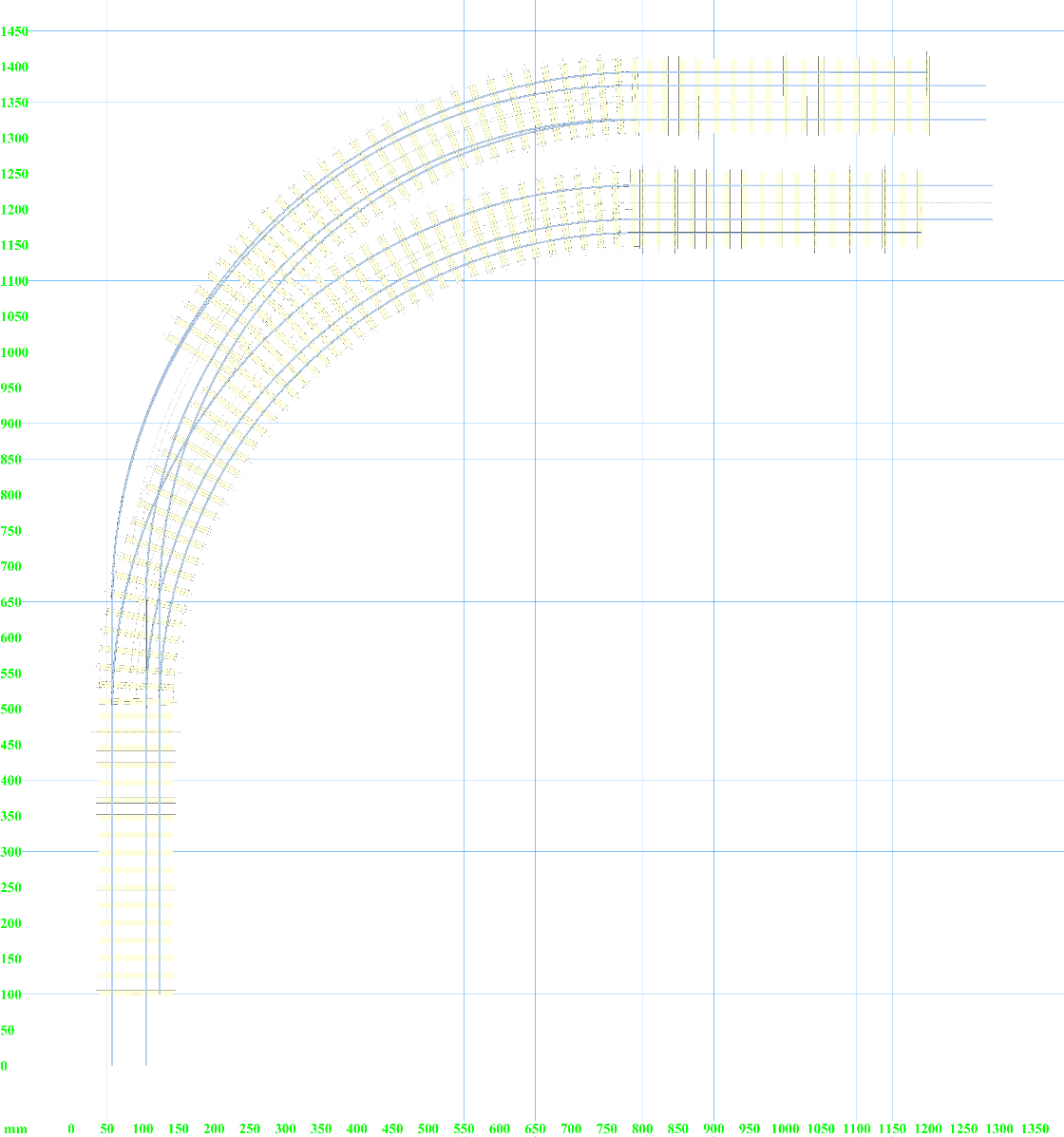

After some to and fro'ing I have a design which works, all I need to do now is build the baseboard to build it on.
It was the cleanest design I could come up with with the minimum complications such as switches doubling as check rails.

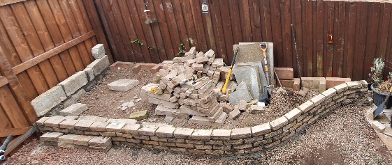

Post by DafyddElvy » Mon Jun 19, 2023 7:42 am
It's been a while since their was any great progress toward actual having a garden tramway.
Just now my body feels like I tried to destroy it, buy I now have the first 4 coarses of bricks and internal blocks laid for the flower bed cum return loop. All bricks and blocks have been recovered from old raised flower beds that I de- constructed, and cement/concrete all mixed by hand in a barrow, hence I'm aching like I've never ached.
Anyhow, all bricks and blocks for the final 3 coarses now cleaned and ready for laying and the whole thing has to be filled with dirt I kept when excavating for the new lower level slabs seating area, yep I've been doing other work to keep domestic harmony, well almost domestic harmony most of the time.
Picture was taken Saturday evening when I stopped as I was reminded to feed my wee pal, and myself.
From the end of the raised bed will be a 4m long viaduct, of a varying height as the ground falls away, down to an acute angle in the fence where there will be some form of rocky feature about 2m high. As I want two datums for the viaduct, the rocky feature will be the next challenge after the raised bed.
What happens after the rocky feature has yet to be decided, as I look for inspirational ideas.
