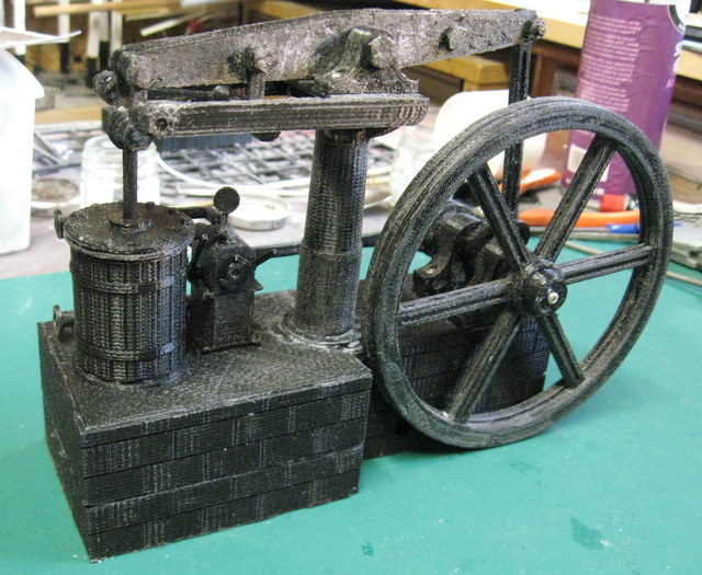

Post by ge_rik » Tue Aug 25, 2020 6:06 pm
Still working on the roof of the Boneworks but, while waiting for the ridge tiles to print out, I put together the beam engine.
I haven't bothered too much with the finish as it will be located inside the engine house and so only partially visible. Of course it still needs painting but I wanted to see how it worked with a motor. It's still a bit too fast, so I'm going to investigate slowing it down. I have one of those miniature geared motors so might remodel the motor housing to take it instead of the bog standard 3v motor.
Posts: 6033
Re: Bone Works
Post by philipy » Tue Aug 25, 2020 6:20 pm
Thats good Rik.
As you say, a bit fast, at that speed it lacks the 'majesty' of the real thing. If you are using a 3v motor, what is it like at 1.5v?
Posts: 7971
Re: Bone Works
Post by ge_rik » Tue Aug 25, 2020 9:42 pm
philipy wrote: Tue Aug 25, 2020 6:20 pm Thats good Rik.
Hi Philip
I'm powering the 3v motor from a single 1.2v rechargeable cell ..... so not got much leeway left.
Posts: 1184
Re: Bone Works
Post by Old Man Aaron » Wed Aug 26, 2020 12:29 am
ge_rik wrote: Thu Aug 20, 2020 12:32 pm That's useful info, thanks Peter.
Seconded. I'll bet the edges of my cut pieces were a bit painful to look at with experienced eyes. :lol:
Rik, that engine's coming up nicely. Must agree regarding the speed. I've seen videos of live steam beam engines running on air at such speed, that one half-expects them to fly apart. Looks very wrong, but I suppose is one way to test the build quality! :bom:
Looking forward to seeing your revised drive arrangement.

gregh
Posts: 622
Location: Sydney, Australia
Re: Bone Works
Post by gregh » Wed Aug 26, 2020 6:25 am
stupid question time...
I assume that big round vertical thing is the cylinder. If so how come it has a big hole in the side?
RE the motor speed, if the gearbox idea is too hard, how about an electronic solution? An esc or PWM using a Picaxe.
Greg from downunder.
Posts: 7971
Re: Bone Works
Post by ge_rik » Wed Aug 26, 2020 8:05 am
gregh wrote: Wed Aug 26, 2020 6:25 am stupid question time...
Yup, it is the cylinder. The designer of the kit seemed to think it was a good idea to make the cladding removable so people can see the piston going up and down. Not sure why.
I've sent off for a Pwm motor controller for £2.85, which seemed good value.
Posts: 6033
Re: Bone Works
Post by philipy » Thu Aug 27, 2020 4:06 pm
Rik,
I was just browsing Thingiverse and I noticed this comment on the beam engine, "Just for information, If you have an old Braun electric tooth brush laying around, the motor from it fits perfectly into this Beam Engine." Don't know if that might help?
Posts: 7971
Re: Bone Works
Post by ge_rik » Fri Aug 28, 2020 8:25 am
philipy wrote: Thu Aug 27, 2020 4:06 pm Rik,
Thanks Philip
I tinkered around with one of those tiny geared motors (I bought three of them a few years ago - just in case). I tried connecting it via a pulley to the end of the crankshaft but struggled to get the tension on the belt right - too tight and the friction on the shaft increased too much, too loose and it slipped.
In the end, I drew and printed a cradle to hold the motor inside the original motor clip. The speed from the motor shaft alone was too slow, so I found a wheel off a cheap plastic toy which gives a far better speed when bearing on the flywheel. I've had to move the position of the motor mount but I'm now much happier with the speed - slow and ponderous. I might increase the speed a little by adding another cell and then use the PWM controller to fine tune it.
I'm just painting the model, so will make a video when it's done.
