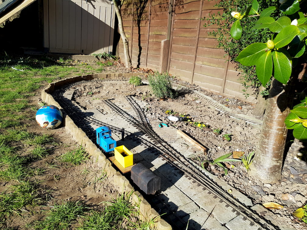

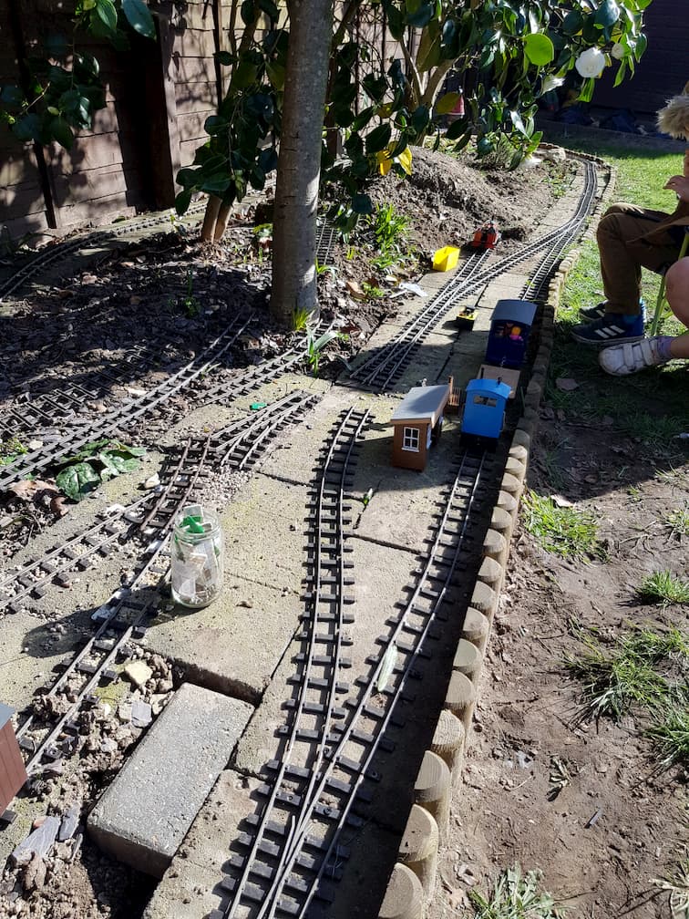

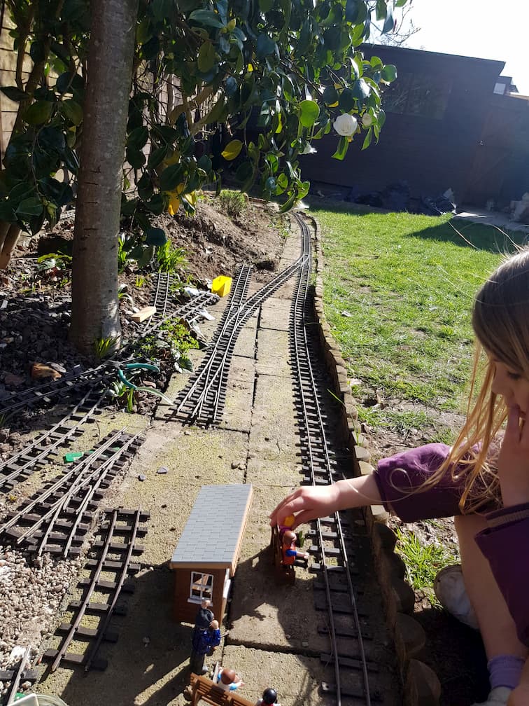

The first job was always to get the loop tidied up and relayed. Previously there had been a play house in the middle of the railway, this restricted the first point as I didn't want the kids jumping over it. With them growing out of the house we opened up a little more space.
Then I wanted to re work some of the blocks. They had been put down in an excited hurry last year when the ground was quite hard.
Then with a few facebook posts to the 16mm group, I agreed on this plan.
The Y point in the foreground really helped to widen up the track and make room for a nice island platform. Also softened all my transitions and bad track joins that I slightly forced before.
Then the little people had to try out their new station arrangement.. I hate bending flexitrack! But I got it to work!
That should give us enough room for a 4 coach train and a loco now. Ideal to run round for the return trip to the terminus.

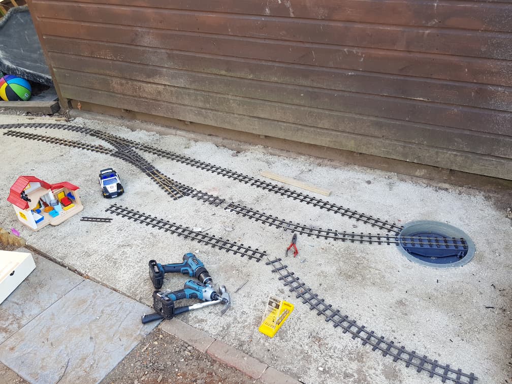

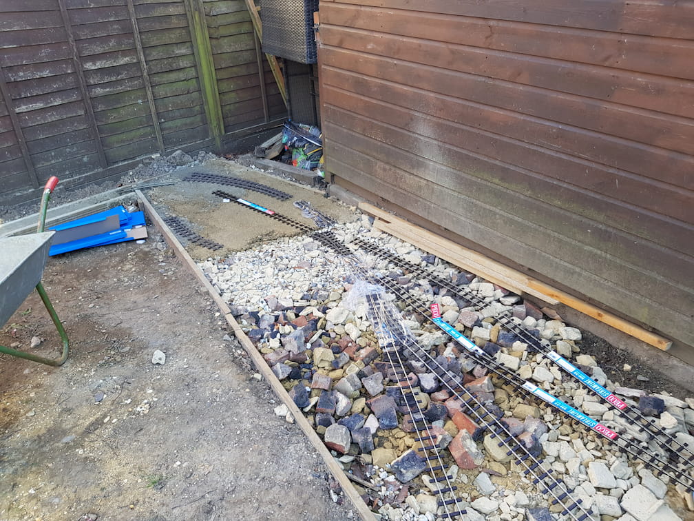

Been cracking on with the build, and running some trains. The through station has been put back together and the sidings added back in this week, so all up and running.
This was our works train caring the screws to sort the track out and secure it down.
Then we started laying out the track in the new station area as it's half cemented in. The job will be to get the track plan finalised so I know where the turn table will sit. The current thinking.. Two main lines to the turn table, this will have initially one platform on the shed side, but space to add one on the other (for busy market days).
The kick back siding for the engine shed, coal, water etc. Gives me a nice space to develop and a view blocker for the train to pass behind.
Then the front two just general sidings for whatever they want to be.

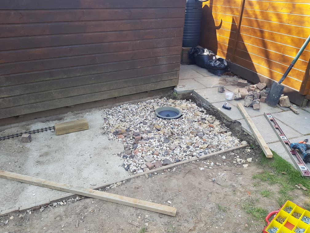

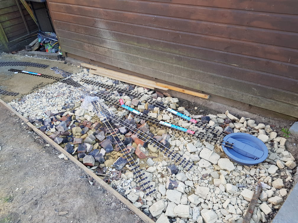

It was a busy last couple of days for the pw gang on the GRR. The management had been pondering for weeks on the best way to set the turntable into the station area, also setting it in would be the final decision on where it was staying. They had been pondering over track plans for weeks, moving things around, deciding what would be best, but finally a decision was made.
The back line will be where the new station will be built, leaving plenty of room at the front of the sidings. Easier to reach to uncouple trucks if the yard is at the front.
A larger hole was dug out where the table is to be sighted, then a brick placed into the hole on a bed of sand. Then the painful process of levelling the table.
Finally once the team were happy a quick mortar mix was made to set the brick into the ground.
That was it, the table position is set! To move it now would involve more ground work, so it's not going far!
That was left overnight to set. The following day the table was attached to the brick, with a couple of drain holes added on each side into the ground to let the water out. Then the area was levelled in the same manner as the rest of the track area. It's actually looking quite good now!
Then 2 mixes of concreate to set the whole area in and we have a completed track bed! Finally.
The final push was challenging work, needed a couple of medicinal pints of ale to help with the aches and pains. Next job will be a little bit of a tidy up. I want to set a couple of paving slabs into the ground next both stations as these are well trodden areas that now don't get much grass, I've also got some edging to put back. Then maybe chuck some grass seed down and see if the area will grow again! It's come a long way from the sandpit. Just need a garden centre to open so I can plant a few flowers!

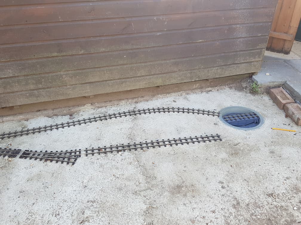

The turntable went quite well! We left it a couple of days for the concrete to set, then ran some tracks onto it as planned.
I took a step back and realised this wasn't going to work! I wanted the station to sit at the back by the shed, hiding it a little. Clearly the rear track had drifted to far back. I lifted it and tried again with the track going into the middle of the table. Maybe the table should have been further forward? Too late now.
Looked pretty good at the second attempt.
My new loco under build sat on the new table.. But that's another story!
