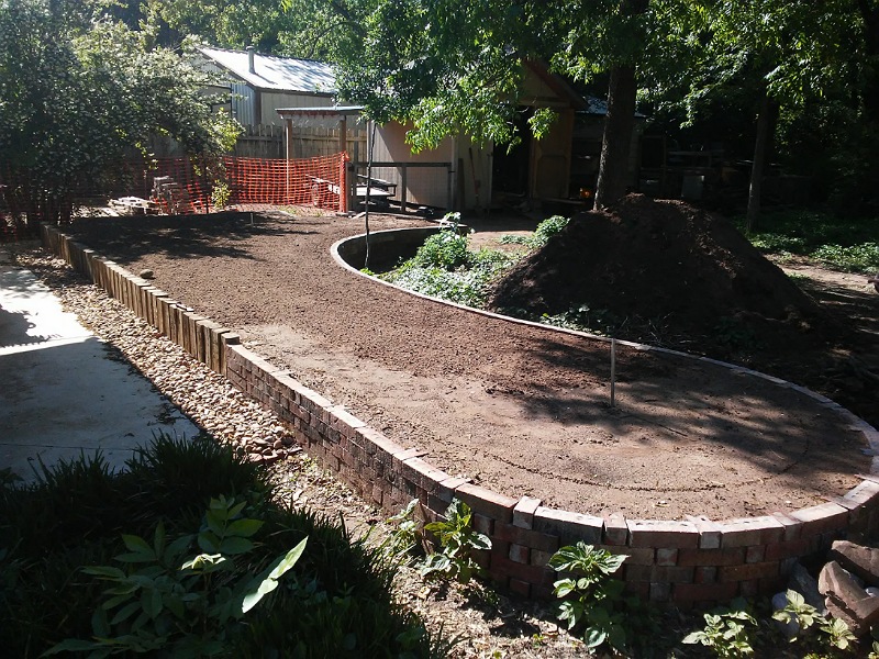

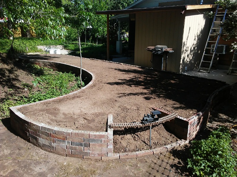

Post by Dwayne » Fri May 08, 2020 11:58 pm
More progress as I've completed the first and larger of the two raised portions of the layout. Views looking inward from each end.

Post by philipy » Sat May 09, 2020 6:28 am
That is an impressive looking structure Dwayne, well done.

philipy wrote: Sat May 09, 2020 6:28 am That is an impressive looking structure Dwayne, well done.
Absolutely!
It looks a lot bigger than previous incarnations? Looking forward to watching progress...

Dwayne
Re: The Two Dogs Mining Company
Post by Dwayne » Sun May 10, 2020 7:39 pm
Thanks all.
@Andrew... yes, it's a bit larger. This portion is roughly L-shaped and is about 30' long x 15' wide. The second portion (to be built) will be about 10' x 10' and holding a return loop which is separated by a gap (Oak Valley) by about 8', necessitating a bridge.
@JimmyB... yup. After spending considerable time cleaning the bricks of old mortar, I simply laid them on the ground. My soil is sandy loam and stable. I poured dry mortar down the holes before hitting with water to set it. Behind the bricks I dumped the old mortar chippings to help with drainage. The soil that is in place currently will be covered with rock and aggregate as I'm going with a dry "desert" theme. Trying to keep plants alive in our summer heat is a PITA. Lack of vegetation should also help with maintenance.

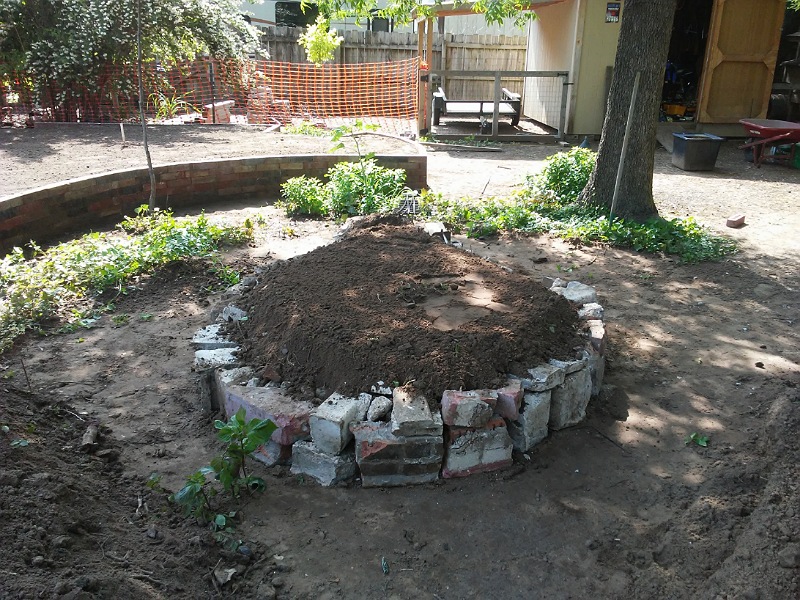

Post by Dwayne » Tue May 12, 2020 4:43 pm
Pulled together the rubble that will be the core for the second portion return loop. Tossed on some dirt. Need to prep more bricks to construct the final shape.

Post by Dwayne » Mon May 18, 2020 12:38 am
Some progress on the layout as a few hours were spent working on the second portion of the railway with the setting of the first course of bricks for the complete outline.
