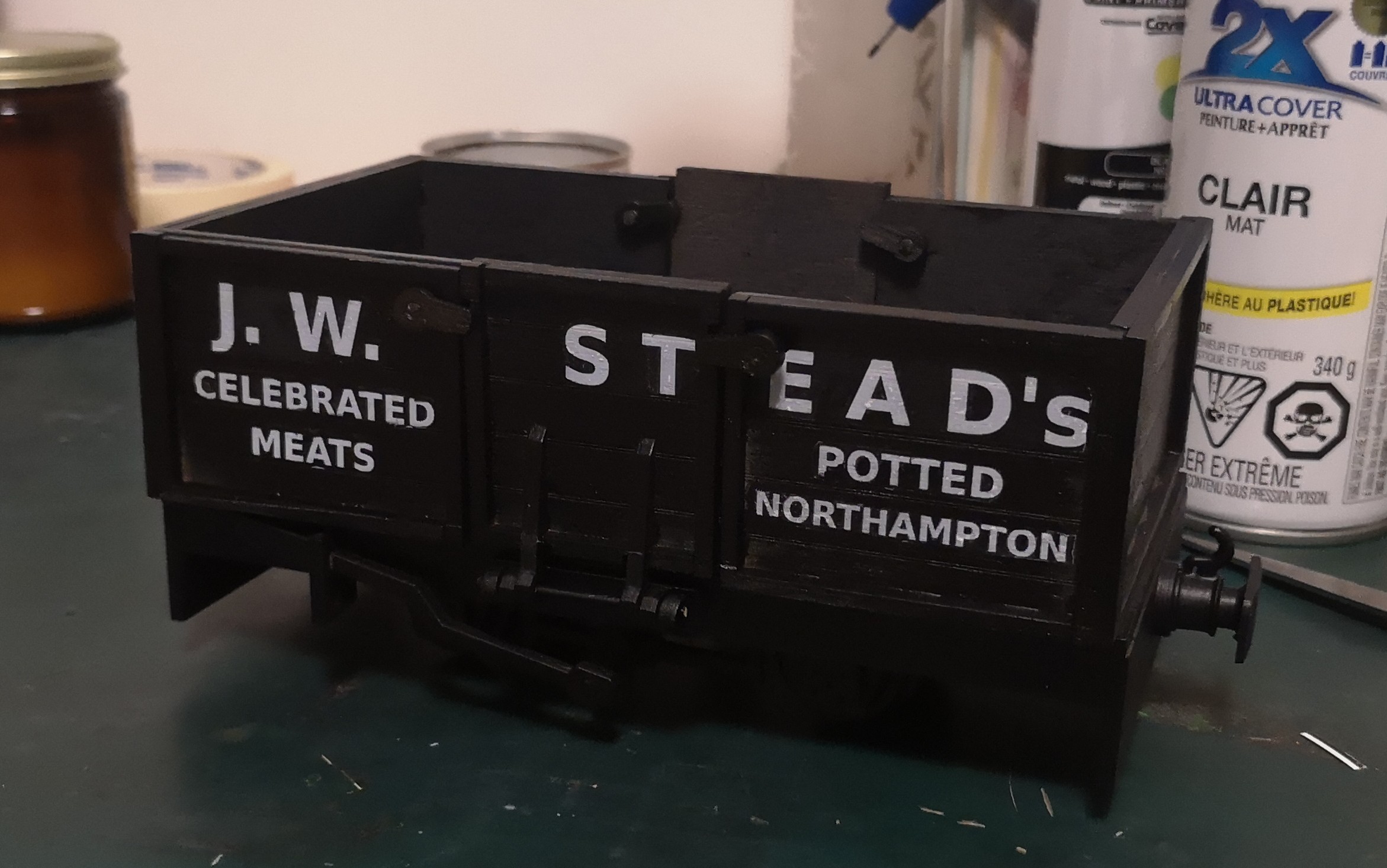

Well, I think it came out pretty good for my first try.
Wagon basecoat is satin black. Lettering is a black background laser-printed onto white waterslide paper, then matte-clear coat over the top to seal the transfers. I did find the black ink tended to rub off the transfers very easily, so that the transfers looked quite tatty by the time they were applied & dry. However, a black sharpie is very much your friend here, as it was very easy to touch up various spots before clear coating.

That is looking good, well done. If the lettering does rub you can always touch it up again. :)
Re: Applying custom lettering?
Post by tom_tom_go » Mon Jun 24, 2019 8:21 am
If the lettering rubs off in places it will look authentic!

That looks very nice, I'm going to have to get some white transfer paper now and have a go myself.

This only works well on black painted wagons, though.
I tried to do much the same with some yellow lettering on a green background but try as I might I could never get the printed green on the transfer to match the painted green on the railbus sides.

philipy wrote: Mon Jun 24, 2019 12:01 pm This only works well on black painted wagons, though.
This is true. I'd like to make up some data markings for some grey box vans now that I have the technique down. Need to find a grey sharpie... :?

tom_tom_go wrote: Mon Jun 24, 2019 8:21 am If the lettering rubs off in places it will look authentic!
Right. Trouble is, with this method, it isn't the lettering that rubs off, but the black surrounding area, hence the sharpie to touch up. If I go over the lines with the sharpie & encroach on the letters, that's just wear & tear... ;)

big-ted wrote: Mon Jun 24, 2019 2:24 pm I'd like to make up some data markings for some grey box vans now that I have the technique down. Need to find a grey sharpie... :?
It wasn't uncommon for a railway to paint the wagon no, load, tare, maintenance dates, etc. lettering in white on black patches, especially if the wagon was painted a light grey. That way you can keep using a black sharpie for touching up. ;)
Art supply shops sell marking pens in a wide range of colours, but like inkjet printers the ink is fairly transparent and the chances of finding a pen that matched the paint would be somewhere between slim and none. There are opaque paint pens available, but the colour range is very limited.
Genius! :D
