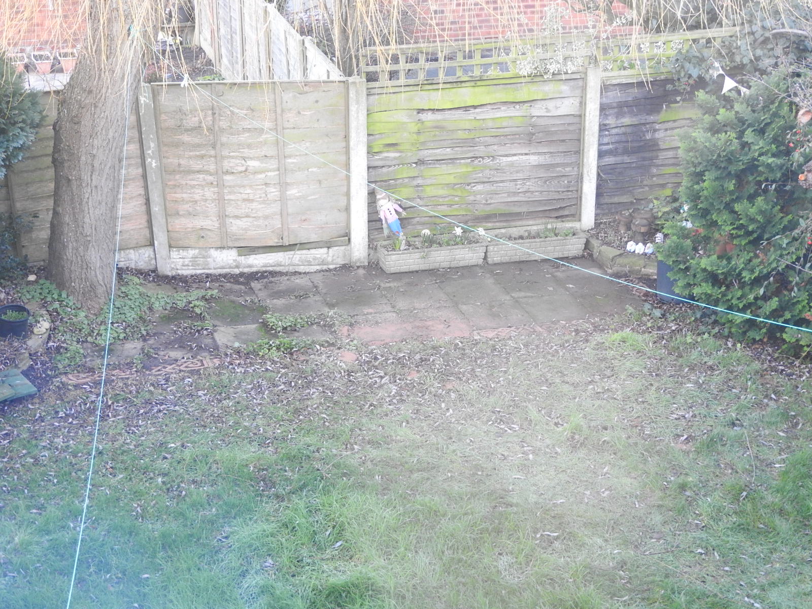

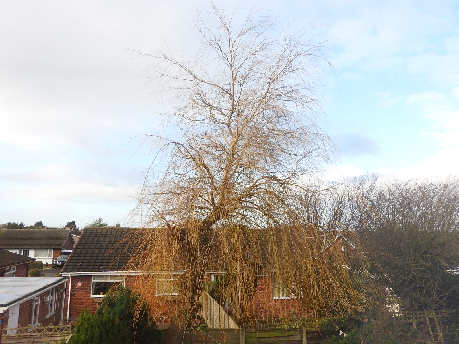

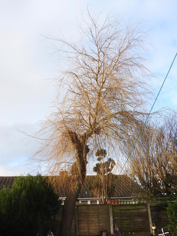

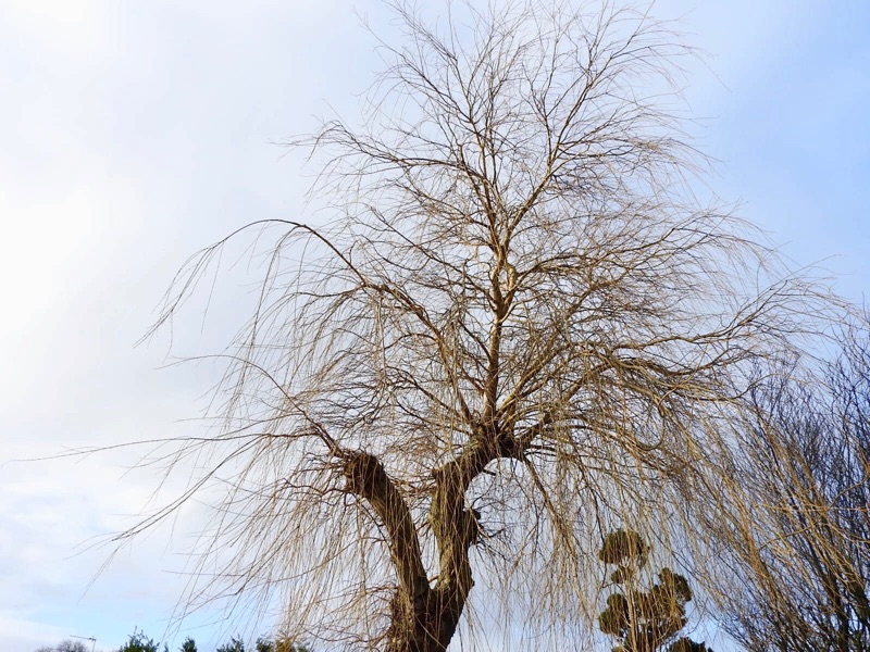

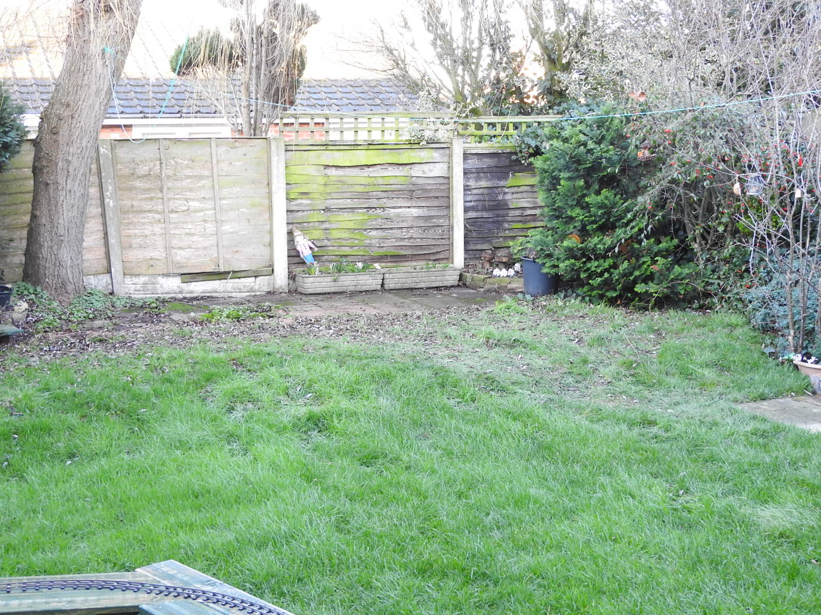

The Willow tree, that's been a bane of the line and the garden is hopefully coming down tomorrow.
The tree,
So has it's being took down, I have had to take up part of our line.
Not a real problem however, because Anne wants me to extend the line at the top curve.
So when the tree and the weather warms up, there will be a slightly longer line at the top curve.
The tree,
