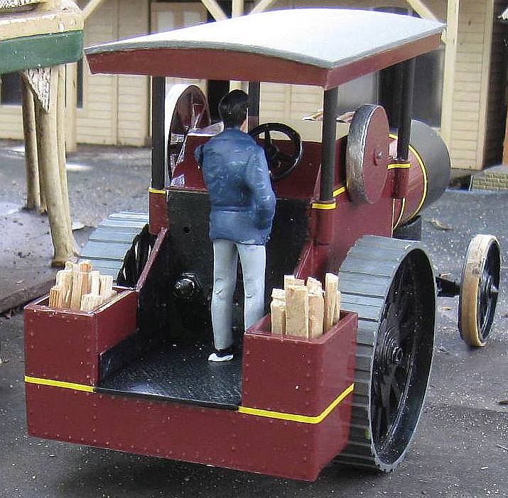

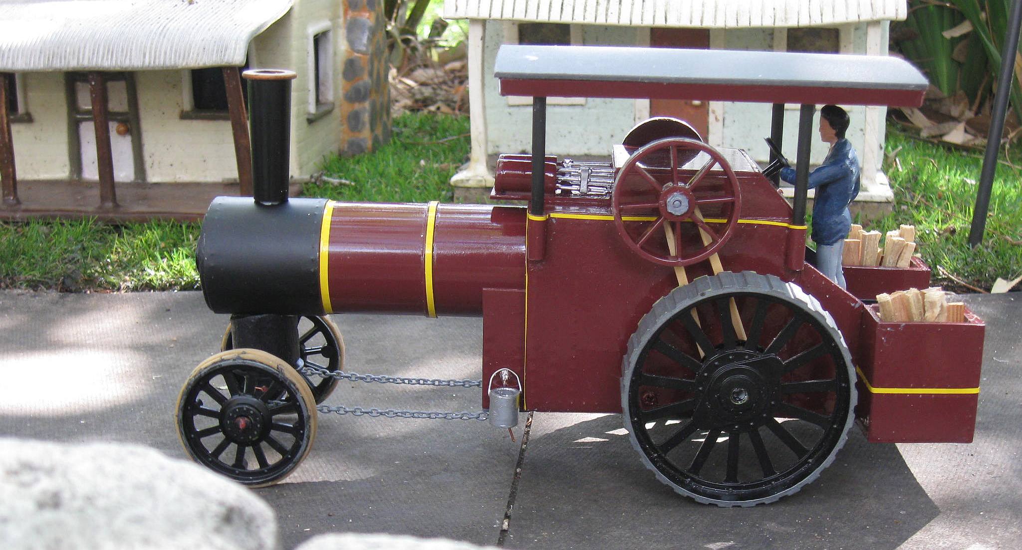

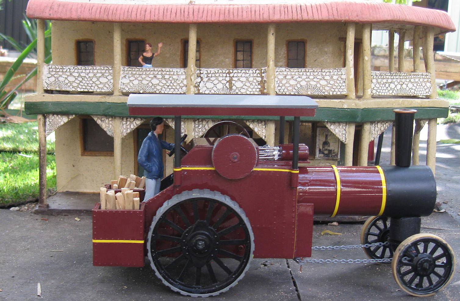

I have now finished the painting and added a few details,- many more could be added, but I doubt Iβll bother.
I added some weight up front and glued rubber bands around the front wheels to get steering grip.
And used chains for the steering. I need to loosen off the steering to keep the wheels on the ground! I think the chains are too tight and hold the wheels up.
A rubber band drives the flywheel from the main axle β it may not be prototypical but adds some movement to the model.
The positive charging stud is the tap holding the bucket (I use small alligator clips and small studs for my battery charging points on all my locos.)
You might notice that the driver has suffered a work place injury and lost his hand β soon to be replaced I hope.
The on/off switch and neg charging stud are on the backplate.
The young lady on the pub verandah looks impressed.

Re: Building a radio controlled (electric) traction engine
Loved the video Greg, it was a bit steep that hillβ¦.
Think the wheels need a pivot of some kind to keep them both on the ground on uneven surfaces donβt you think. In the full scale ones they have them donβt they..

It was working fine before I added the chains.FWLR wrote: Thu Apr 26, 2018 7:36 am Loved the video Greg, it was a bit steep that hillβ¦.![]()
Think the wheels need a pivot of some kind to keep them both on the ground on uneven surfaces donβt you think. In the full scale ones they have them donβt they..![]()
I've loosened off the pivot screw and will see tomorrow if that helps or whether I need to loosen the chains as well. I did try today with both chains loose and I was surprised that it ran straight BUT everytime it hit a small bump, the steering wobbled around and then came back straight - a very unprototypical look, so I tightened them again.
Maybe if I loosen just one side.
As to the hill - the wheel was slipping on the axle which may have contributed to the 'fail to proceed'.
