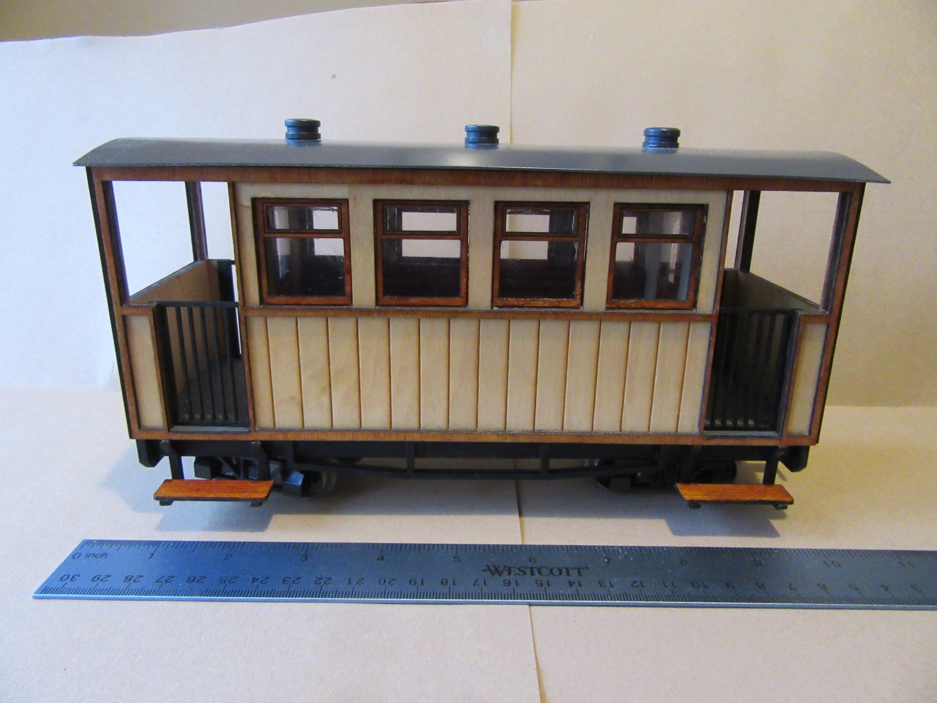

Great loco and I love the coaches - totally scratch built? Have you anymore piccies of those?

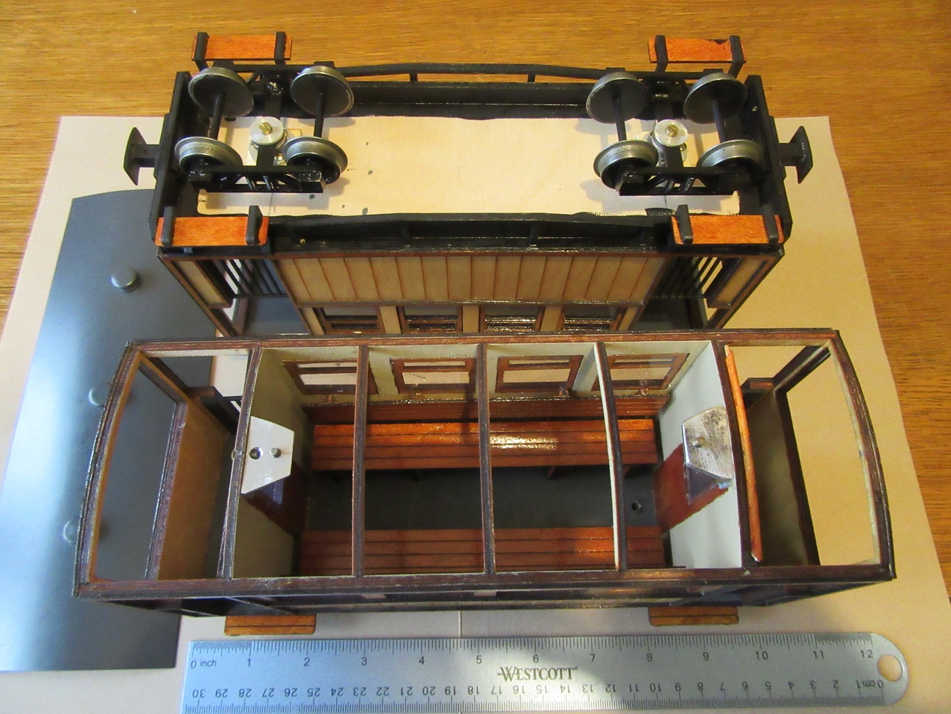

Thanks the coaches are kits made by Andel models.Originally four wheel but they would not go round our tight curves so we fitted them with bogies.The roofs i made out of thin brass sheet fitted with home made lamp tops.I don't have any other photos but will try and add some tomorrow.

The coaches are kits from Andel models, who unfortunately seems to no longer do business. We managed to grab a few kits, including a guards van, flat truck and these coaches, they were all nicely designed kits. The included wheels were plastic, and the original kits had 4 wheels. We soon realised that this would not be a good combination due to the changing gradients and tight setrack curves on our line, so both coaches were fitted with IP Engineering metal bogies which greatly improved running. The old wheels and axles can then be used for more rolling stock!
The roofs included in the kit were scored plywood. I decided to replace it with a brass roof, but found the weight at the top made the coach unstable and difficult for smaller locos to pull, so the material was changed to aluminium. The roof is removable so I can add figures or lighting at a later date, and is fixed by brackets on the inside, with holes in the floor to fit a long screwdriver.
With regards to cheap kits, I think most of our models are made from MDF or ply kits from various manufacturers, Andel, HGLW, IP Enginnering, Phil Sharples, etc. I think they are fantastic value and perfect for adding a little bit of your own touches to. We also have an Essel Engineering chassis awaiting a body, while the cheap kits don't hold a candle to it mechanically, you can buy three locos for the price of one chassis!

Thanks for the photos of the coaches - I also have gradients and tight curves so I'm also looking at bogied coaches, and like you, they need to be fairly short.

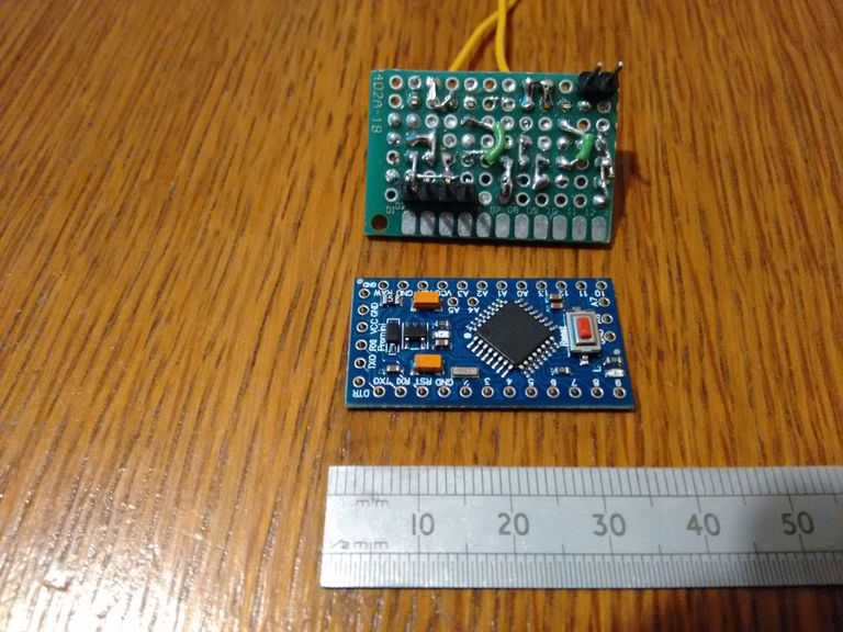

The resistor at the top is to try and limit the current/power through the speaker, and there might be a resistor and capacitor on the output of the tiny85 before the transistor to do a bit of filtering. I'm definitely not an engineer (as I'm sure anyone who knows this stuff can already tell) but I am pretty certain that I'm missing some components that are recommended for more reliable or 'proper' operation. Ah well, it seems to work just as it is, so it'll do for now.![]()
Intrigued by this circuit. A problem I've been having with simple sound circuits is overcoming a silent pause each time the sound loops back to the start. Just wondered whether this was a problem for you and how you overcame it - or whether it's not an issue with the sound sample being so short.

The sample was edited to sound acceptable when looping on a PC before being flashed to the micro. The t85 has 8K of flash, and the sample rate is 8kHz, giving a maximum of 1 second of audio. The code on the micro is very simple, two timers are set up, one to output a fairly fast PWM signal on the base of the transistor and one that triggers an interrupt at 8kHz to load the next sample value from flash into the PWM output. When the micro reaches the last sample value, it just loads the first one again and continues, so the quality of the loop transition in this case mostly depends on the quality of the sample itself, not so much the hardware. One way to get the loop to sound a little better I found was to cut the sample at zero crossings, as it tended to have fewer glitches.ge_rik wrote: Wed Aug 09, 2017 7:40 am Just wondering if this ought to be on a new thread ......

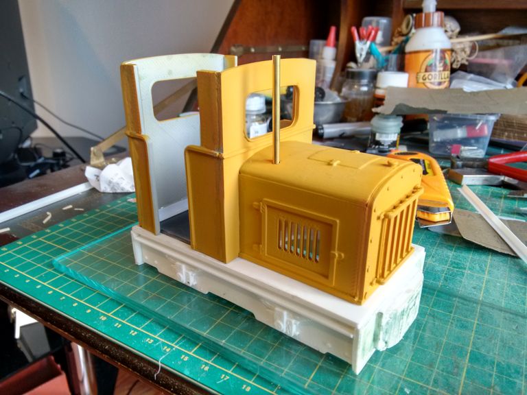

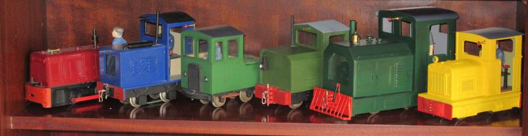

Another year, another new electric loco project!
This one has been 3D printed on my son's printer, user arockStone on thingiverse put up the files for this for free: https://www.thingiverse.com/thing:2109286 so many thanks to him.
It starts off as a kit of parts, here it is straight off the printer: The parts are a little rough. The printer is not perfectly dialed in, on reflection it might be better in future to print the body in larger pieces, perhaps layer lines will be easier to smooth compared to bumpy solid top infill.
The parts are simply glued together, sometimes using plastic angle for extra strength. The panels are filled, sanded and smoothed to try and increase the surface quality. Parts like the horn and exhaust don't make sense to 3D print, traditional modelling materials are just easier. The filler primer used was a yellow colour, it seemed to fit the loco quite nice so it was decided that the final colour would be yellow.

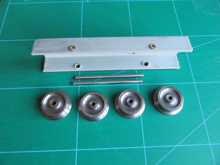

The original design called for a basic chassis from IP. An attempt was made to make one from sheet metal, which resulted in failure due to the metal twisting during machining. The model files include a 3d printed one, and this seemed to work quite well. Brass top hat bushes were heated and then pushed into the plastic chassis with a drill press, resulting in a smooth running chassis. The wheels were turned on my Myford lathe, with the help of some homemade tools to speed up the process.

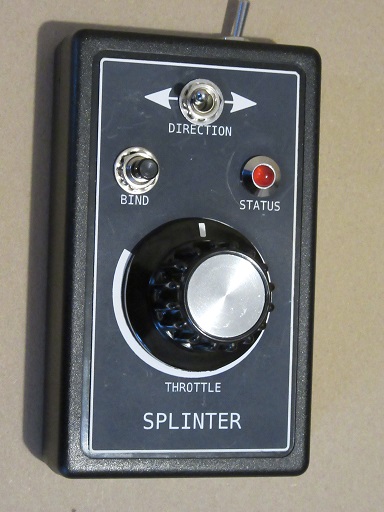

We had a spare Deltang receiver, but it decided to start acting up not wanting to bind. And alternative was made by my son. This consisted of a cheap commercial receiver, and an arduino clone and hacked together motor driver board that fits on the arduino. The battery is a 2000mAh lithium polymer one. It is an extremely tight fit under the bonnet, the lipo fits snugly along one side of the engine compartment, with the other boards on the other two sides and the motor in the middle.

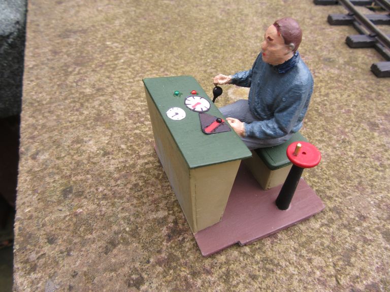

An interior was constructed from mostly wood, with a few bits of paper drawn on and stuck down for a control panel.
With a few extra details and a coat of paint I think the loco has come out quite well. Material cost was quite low, maybe Β£3-4 of plastic, and Β£15 for receiver gear, and a few pounds more for the various other bits and bobs.
I am well pleased with how the chassis turned out. It is one of the quietest running engines we have, the drive is barely audible over rickety wagons, although it does exhibit the typical rattle that worm driven engines seem to have when running in reverse.
The electric engine shelf is starting to get a bit full, I still have an IP lister and Essel chassis to build... more space needed!
