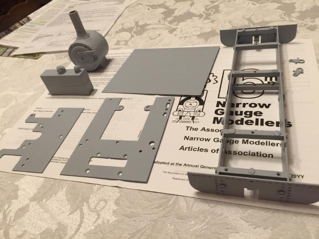

Post by Steve » Sun Feb 07, 2016 4:14 pm
Yes it starting to look like something.
Steve
Post by Steve » Sun Feb 07, 2016 4:17 pm
It might slow down a bit now, the Permanent Way department has requested all staff help for a small project.

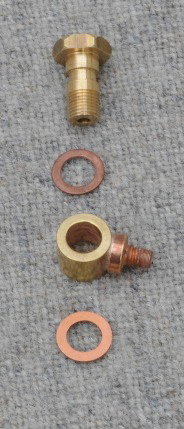

I am in need of the following items
Picture from Victory manual
thread needs to be 1/4 x 40 on the side on the ring
5/16 x 32 on the main bolt!
Where could I get these from?

Post by TonyW » Tue Feb 09, 2016 6:47 pm
Steve:116153 wrote:Where could I get these from?
They look like the steam turret parts off a Millie, so Roundhouse should be able to supply.

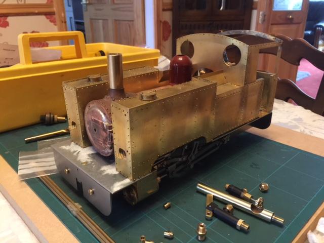

Post by Steve » Sat Feb 20, 2016 8:51 pm
Just a quick update
Released from PW dept but I have promised to help when the temperature warms up.
The Banjo is from a RH millie BUT the side takeoff is 3/16. They sent the ring with a hole and a fitting from the end of the T super-heater pipe. A bit of silver soldering and a quick pickle and its looking good.
The 2 plates have been scraped and new ones cut.
Just fitted rivets into 1 buffer beam, the other 1 to go.
Hopefully get some painting done tomorrow.

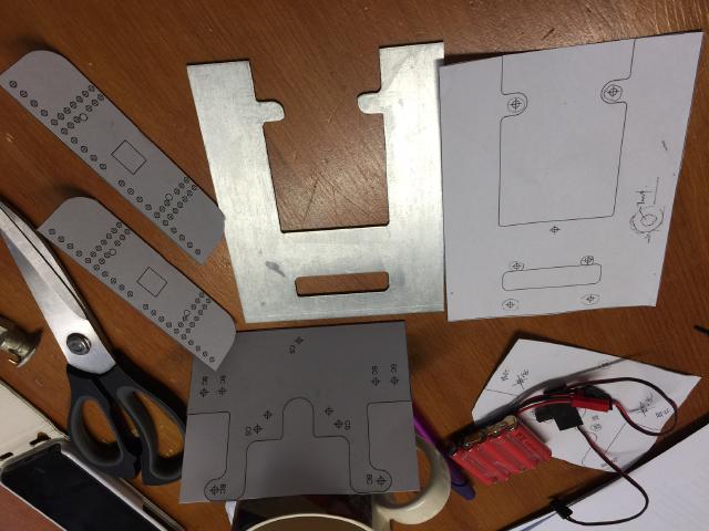

Post by Steve » Sun Feb 21, 2016 11:38 pm
Printouts stuck to metal before drilling
Buffer beams being riveted
After Etch Priming and baking
The large plate is for sampling the colours

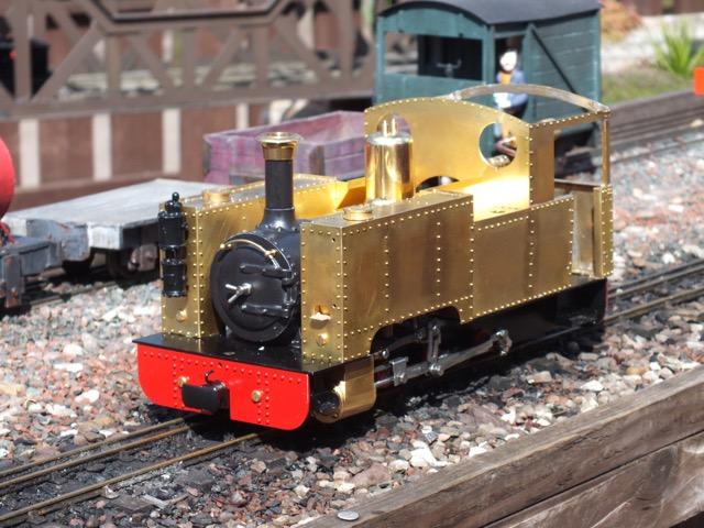

Post by Steve » Thu Apr 28, 2016 9:27 am
First Outing

swiftsixteen
Post by swiftsixteen » Thu May 19, 2016 9:50 pm
LOOKS FANTASTIC !!!! :thumbup:
Seeing somebody alter my kit to suit their own requirements and getting it to look right is a very satisfying thing for me :D
Keep up the good work and don't forget to make a fillet piece over the boiler on the spectacle plate ;)
Rob,
Swift Sixteen.

swiftsixteen
Post by swiftsixteen » Fri May 20, 2016 10:15 pm
How about making some 10mm (or so) packers to lift the boiler ???

Post by Keith S » Sat May 21, 2016 9:10 pm
swiftsixteen:118174 wrote:How about making some 10mm (or so) packers to lift the boiler ???
I agree, that would look great. You could even incorporate some dummy firebox cladding at the rear to make a scale-looking back head.
