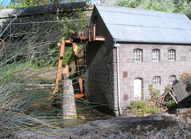

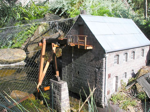

Dan has known for a while that every time he stepped out onto the catwalk to adjust the sluice gate, one day he would end up in the wheel or in the lake!
The timbers were well past their use by date.
As the wheel needed a complete replacement, the opportunity was taken to renew the associated timber work with new Merbau which should see Dan out.
As for the wheel, don't know where we are going with that, probably end up building again from scratch. Still investigating!

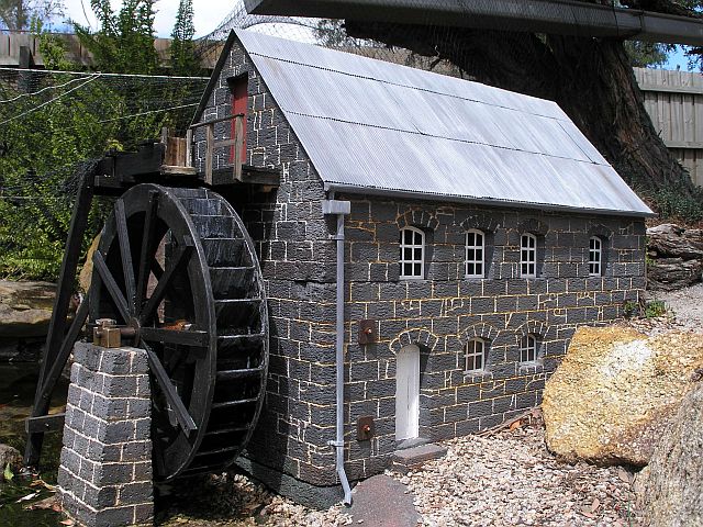

The Mill building sits just to the left of the water tank at Nayook Peter. I built it using Hebel blocks (Autoclaved Aerated Concrete ) 100mm thick sawed down the middle to give me 50mm wall thickness, painted "bluestone" colours then scratched in the mortar joints. Milled out window and door recesses with Acrylic windows and timber doors.
It normally looks like this with the wheel fed by a sluice box that re-directs water from the waterfall on the hill behind it. Timber framed roof, galv. iron nailed on then covered with my own corrugated iron sheeting.

Wonderful looking model Grant. Love all the details such as the downspout and the reinforcement bolt heads.LNR wrote: Fri Feb 02, 2018 11:42 am The Mill building sits just to the left of the water tank at Nayook Peter. I built it using Hebel blocks (Autoclaved Aerated Concrete ) 100mm thick sawed down the middle to give me 50mm wall thickness, painted "bluestone" colours then scratched in the mortar joints. Milled out window and door recesses with Acrylic windows and timber doors.
What material did you use for your corrugated iron? It looks very good.

Aluminium beer cans Rik. (18-20 of them) cut annealed and corrugated. Wouldn't do it again, that's why I get the aluminium sheet rolls from a craft store.
Also saves the Pong going through the house during annealing, from burning what ever it is in the coating on beer cans. I have a pet hate (hope I'm not treading on anyone's toes ) of corrugated roofs on models done with individual sheets. If you look at an iron roof, you can't see the vertical sheet joins, only the horizontal ones. I roll the sheets as long as the ally comes to have less joins.

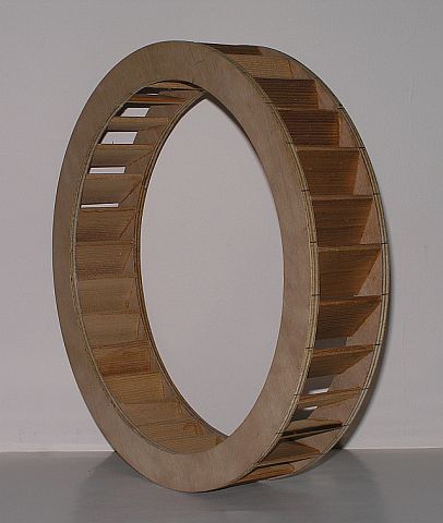

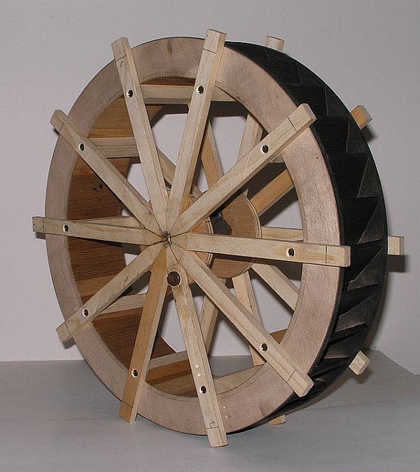

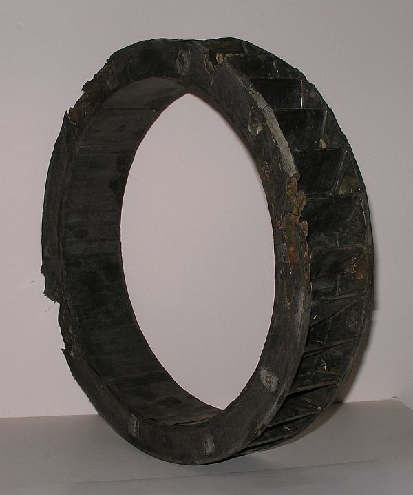

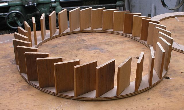

After 8 years and three months, and not using marine ply, this is what the old millwheel looked like.
It still worked, but for how much longer! The spokes and hubs were useable although I chose to make new ones fixing
them to the wheel in a different way so as not to have holes in the marine ply rims. The cedar belly and paddle planks
were all as sound as the day it was built. The wheel under construction. This wheel should be more powerful as it will hold more water before spilling it at the bottom. Just got to cut the spokes to length, tidy up some steel work, and give the wheel three coats of resin, and Dan should
have his new wheel delivered soon.

The weathered 'old' wheel looks so realistic. You should find a space for it to gradually moulder somewhere near the mill

Wonderful work as ever Grant.... the old wheel has lasted well and looks so good it deserves a place of honour to preserve it.

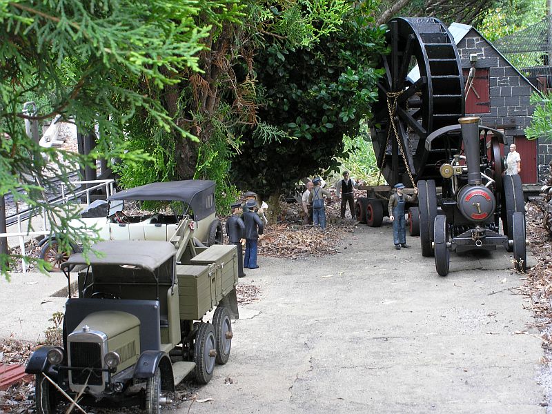

DELIVERY for Mr. D. HEALY.
Dan got his new Mill Wheel delivered this morning. It actually left the manufacturers three days ago, so spent some
time on the road with clearance problems etc. There were on-lookers, (not much happens in a small town, this was the weeks entertainment!) and all went
according to plan. Dan has quite a backlog to get through, and can't wait for the wheel to be rigged and running.

Re: A Quiet Sunday
Another great looking tableau, Grant. Not only do you have a good eye for detail you seem to have a natural instinct for composition. Are they going to jury-rig some sort of derrick?
- Posts: 1887
Re: A Quiet Sunday
Thanks Rik, I had in mind replacing the engine with the Thornycroft, running out the winch over the top of the wheel. Then with men climbing the paddles adding weight and paying out the winch, and so rolling the wheel into position.
Impatience got the better of me, I really miss the sound of the wheel.
- Posts: 5713
Re: A Quiet Sunday
That is a beautifully composed piece Grant..... lots of workmen and nothing happening, all standing around, scratching their heads and saying to each other.... 'OK, so it's arrived..... what do we do next?'
